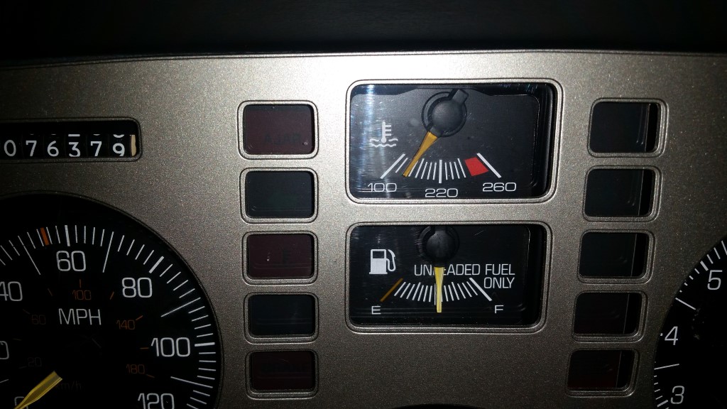

I started the fiero to make the engine warm, DAMN so much smoke from the exhaustpipes.. white/grey smoke.. I hope its just condensed water, because it have been raining fro weeks now.. it also smell like the cars did when i was a kid.. probably because it have no cat, and more or less all cars here have that nowadays.
Anyway, I never got the engine really warm, the temp meter is REALLY strange graded, with 7 marks between 100 and 220 ? but it stop two marks over 100, I guess it should be in the middle at 220 ? ..I'm not much into farenheit, but that should be slightly over 100 degrees celcius.

I forgot.. even after the testdrive I disnt manage to get the temperature higher.. anyone know why ? the termostat ? anything else ?
I also felt the hoses on the radiator, they where both warm (in and out), same with the hose beside the thermostat housing..
here is a pic of the temp meter..

Let the engine run until the cooling fan comes on. Look at the temp gauge and use that point as 235 degrees F if you have a standard 195 thermostat. I would first look at the temp gauge sending unit in the corner of the trunk side head, just below and to the right of the ignition coil. It will have 2 green wires. Replace that temp sensor.

You do still have a thermostat, right? It almost seems as if someone removed the thermostat, or the thermostat is failing open. Of course, it's nice to connect the data cable to see what the computer shows. To check the thermostat, WHILE THE ENGINE IS COOL, just open the cap on the thermostat housing. Do not loosen the bolts on the housing. You can remove the thermostat easily with your fingers.

Cooling fan, it never came on, i was running it for maybe 20min standing still with the front hood open, but it nbever started, i figured that was because the temp never came up..
I have no idea what thermostat I have, but on the reciept I got from the old owner when he installed the tuning chip a thermostat was included with that,so it probably changed the temp (up ?) ..I noticed that its very easy to remove it on those cars so I can open it and see if it say anything, and maybe try if it works too (using boiling water), but I noticed they where pretty cheap so I can also buy a new one to be sure.. Is there ANY reason not to buy one with standard temp ?
