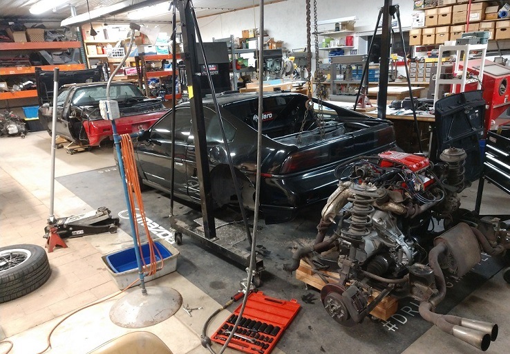

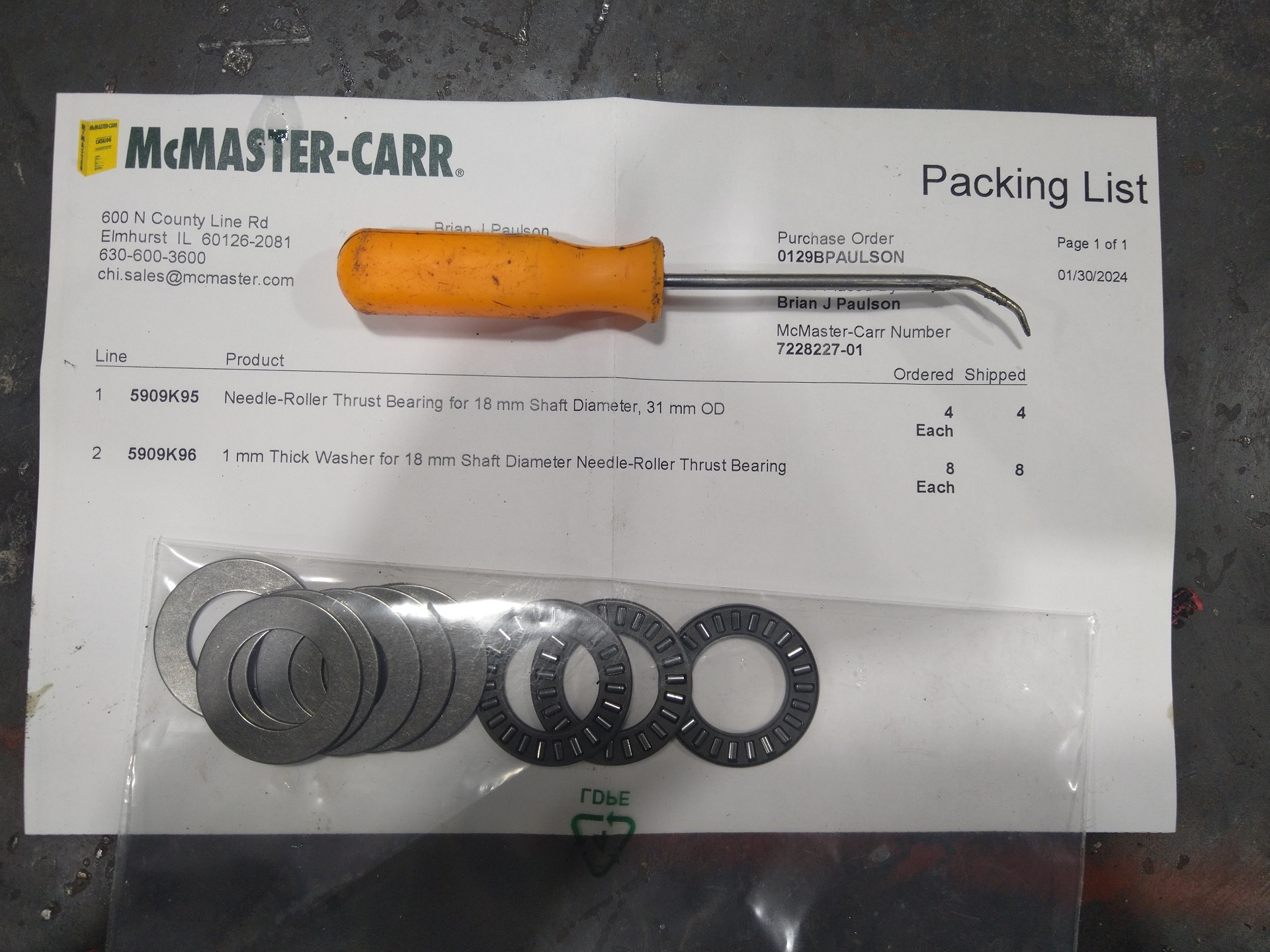

I pulled the trans out of my other Fiero to get the input shaft bearing fix done. This car was out for almost two years because of that.

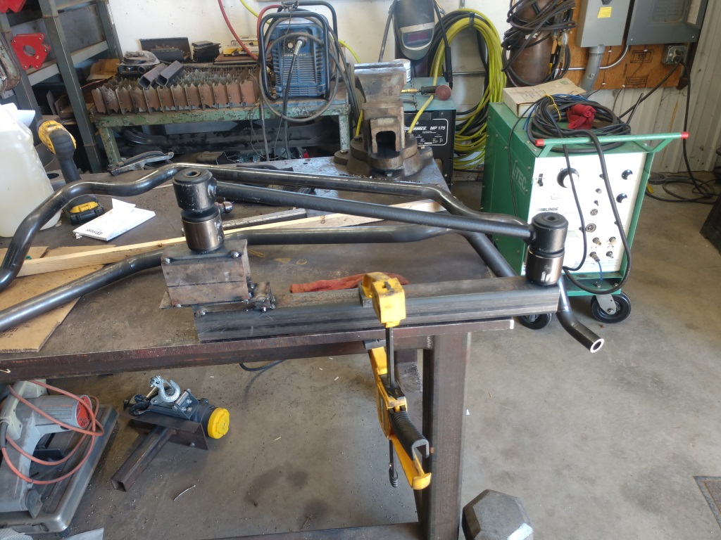

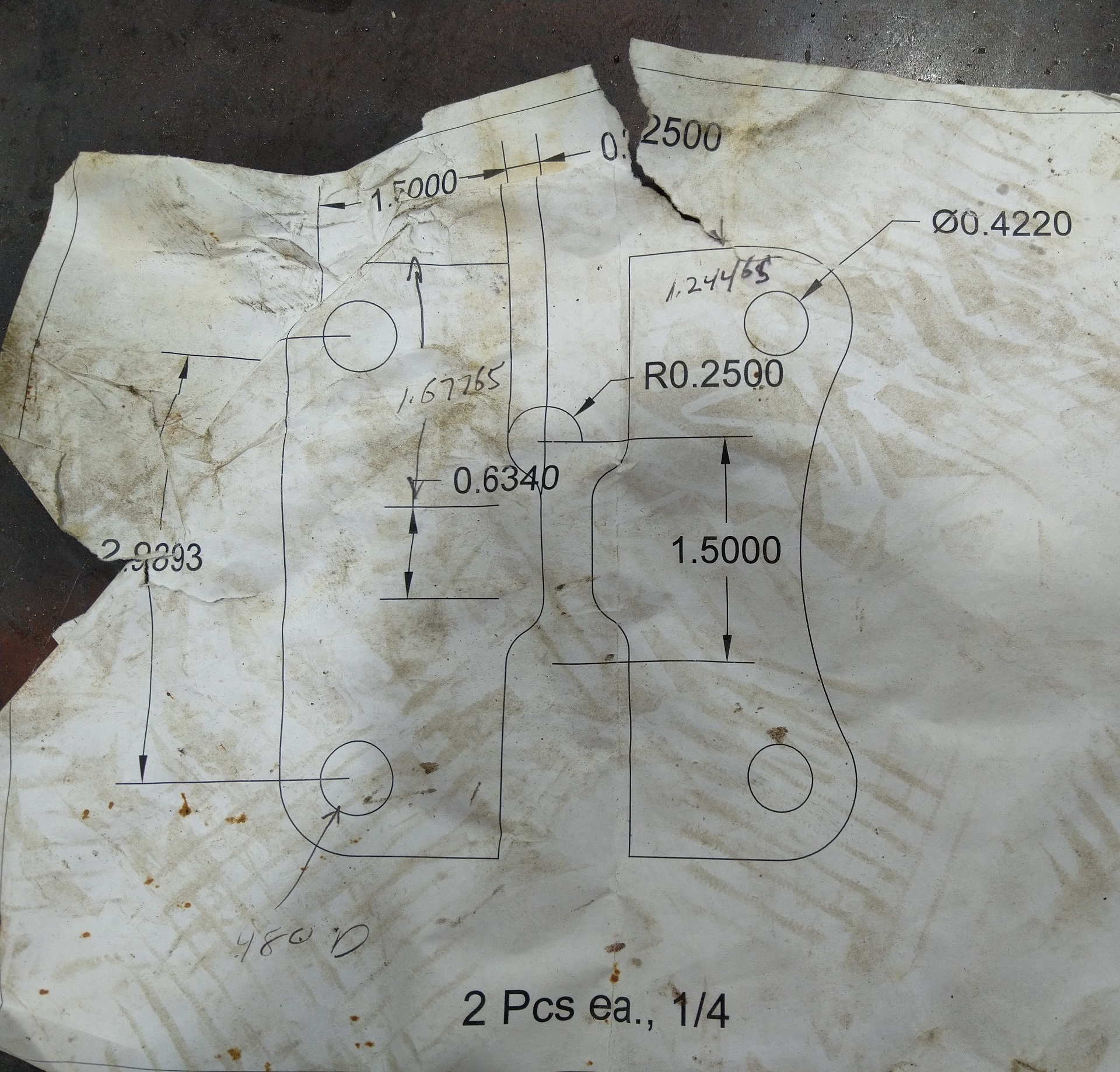

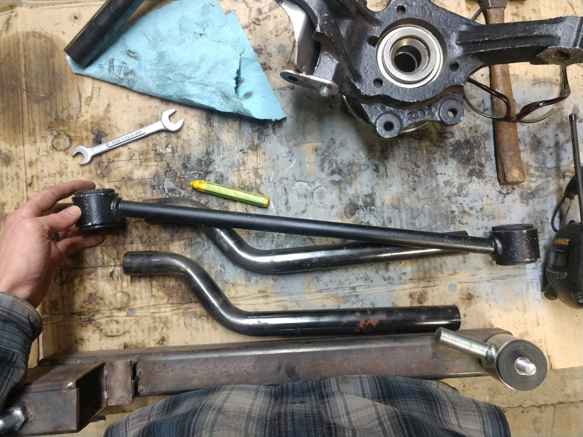

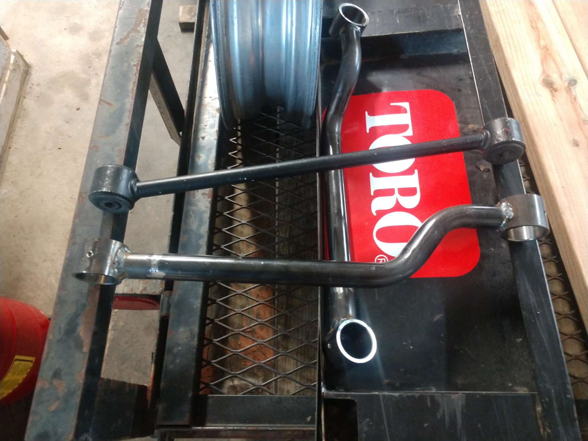

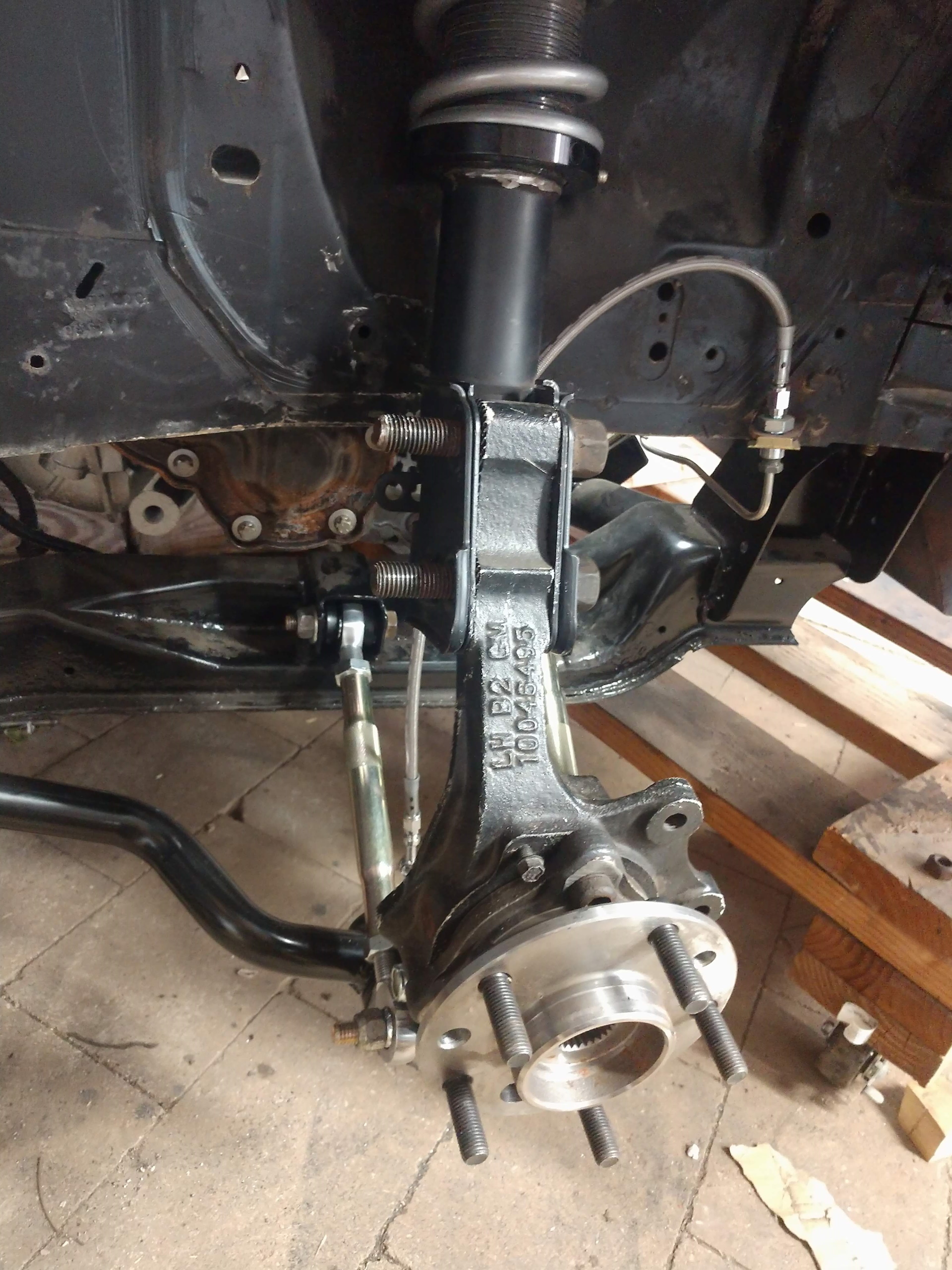

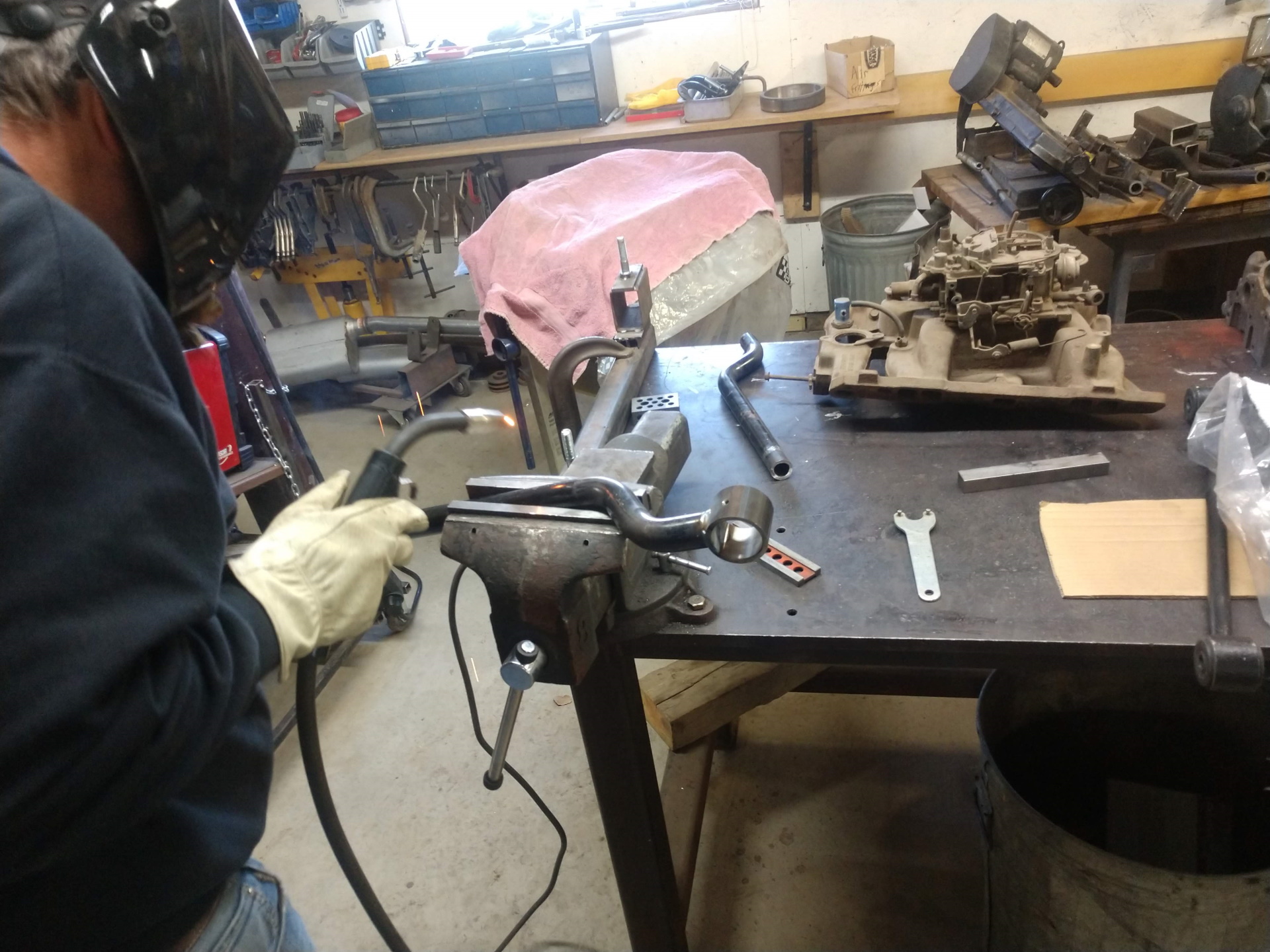

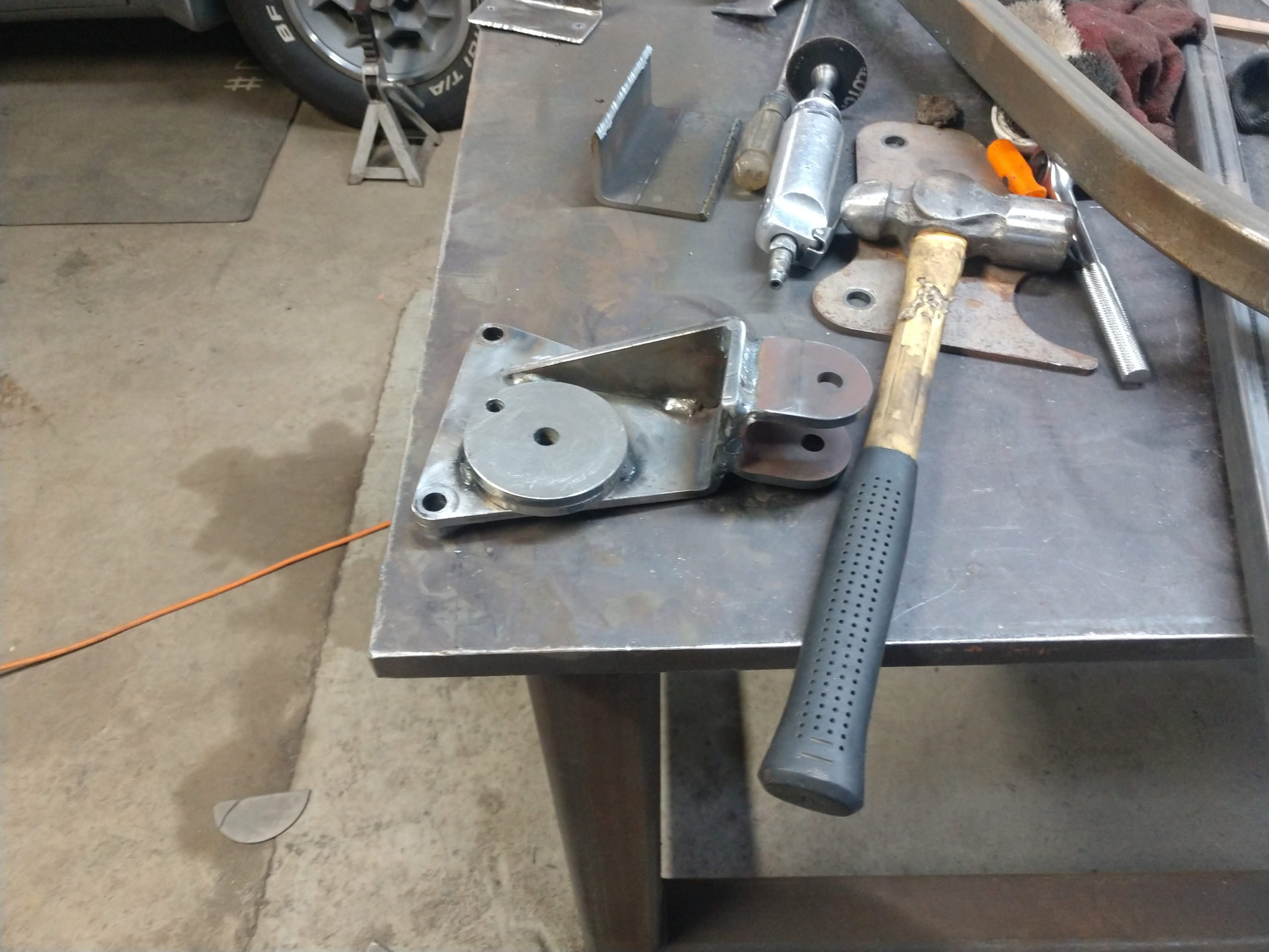

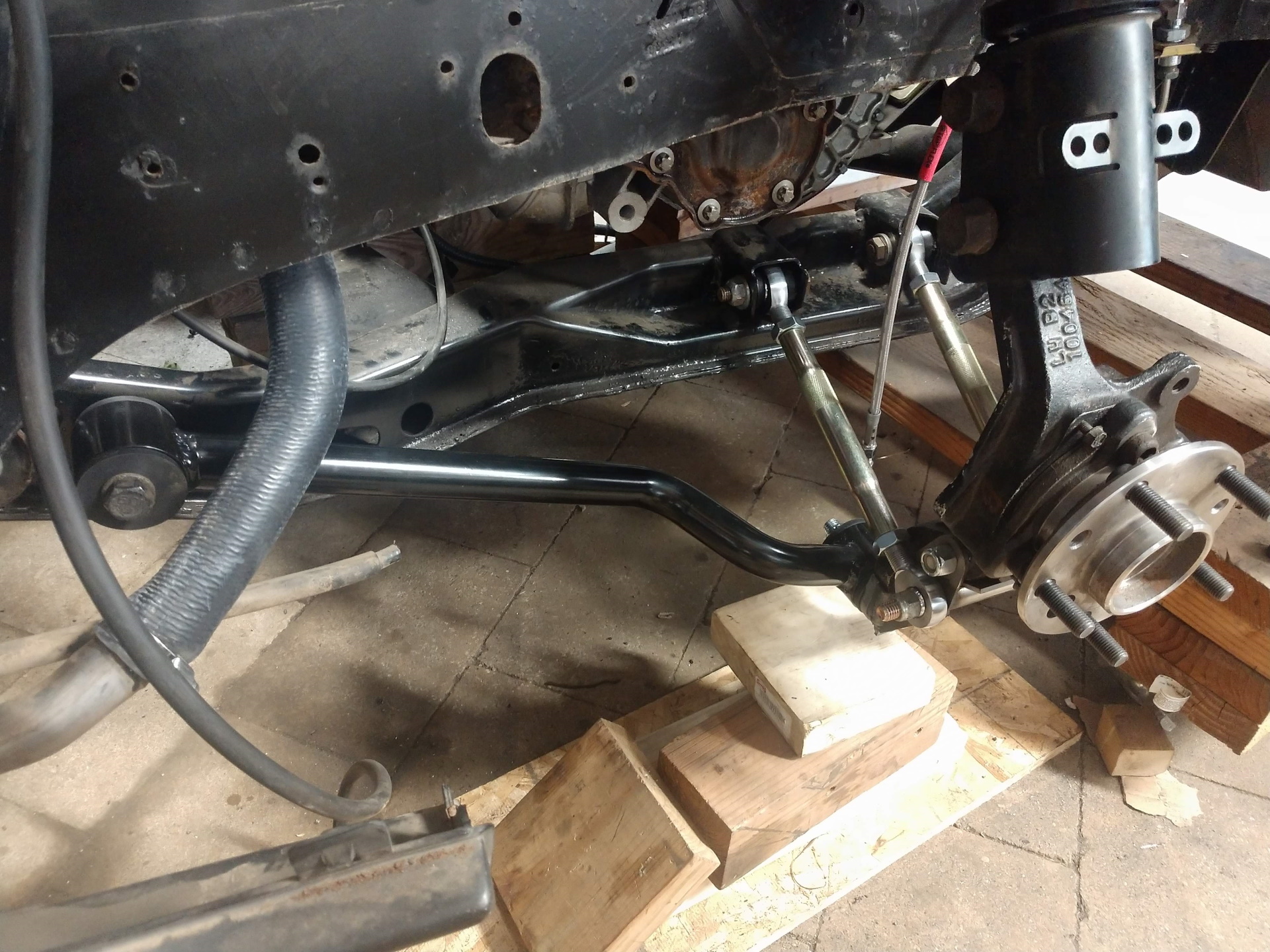

Here are my lateral link relocation brackets, I told my dad what the goal was and he designed them a little different than Fieroguru's.

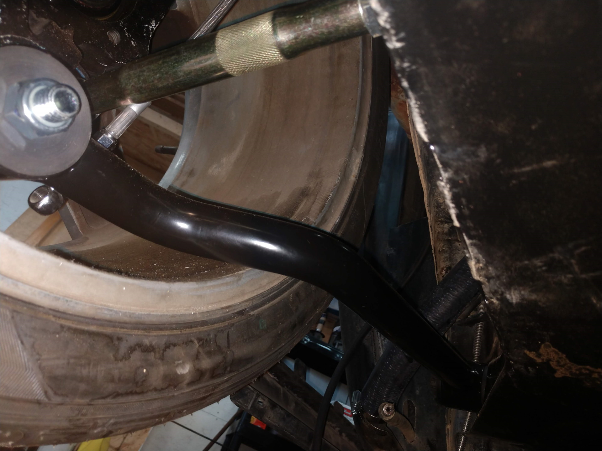

We are taking some scrap sway bars and making the forward link? not sure on the name. But it interferes with the rim. You can see in the pic that it will bump in toward the car and then turn and go forward.

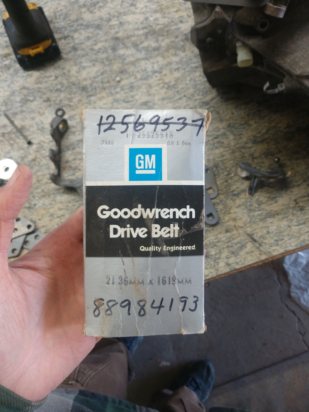

For part number reference. this is the belt that I ended using.

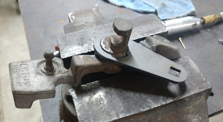

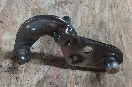

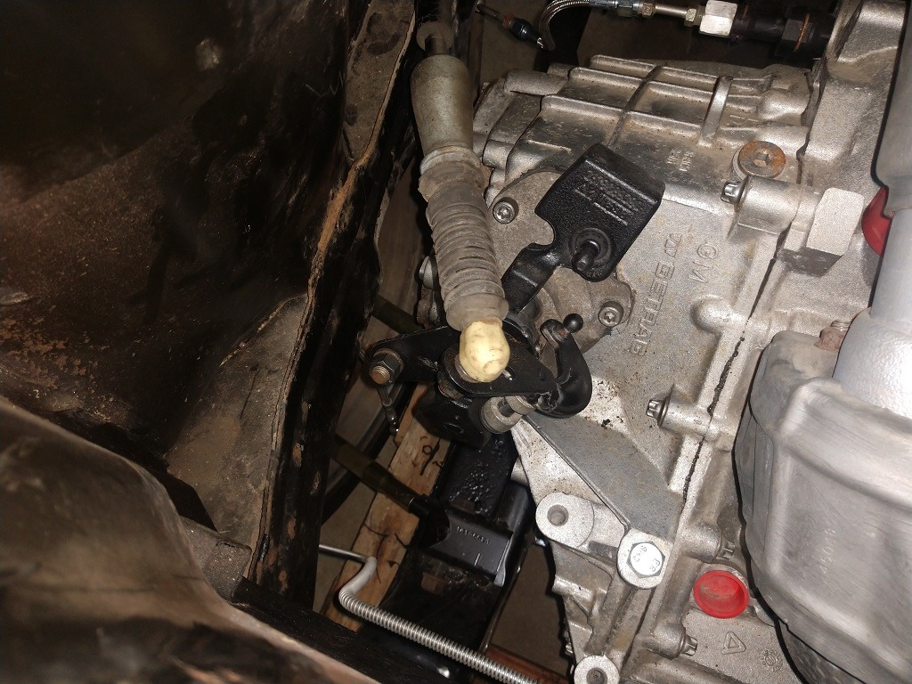

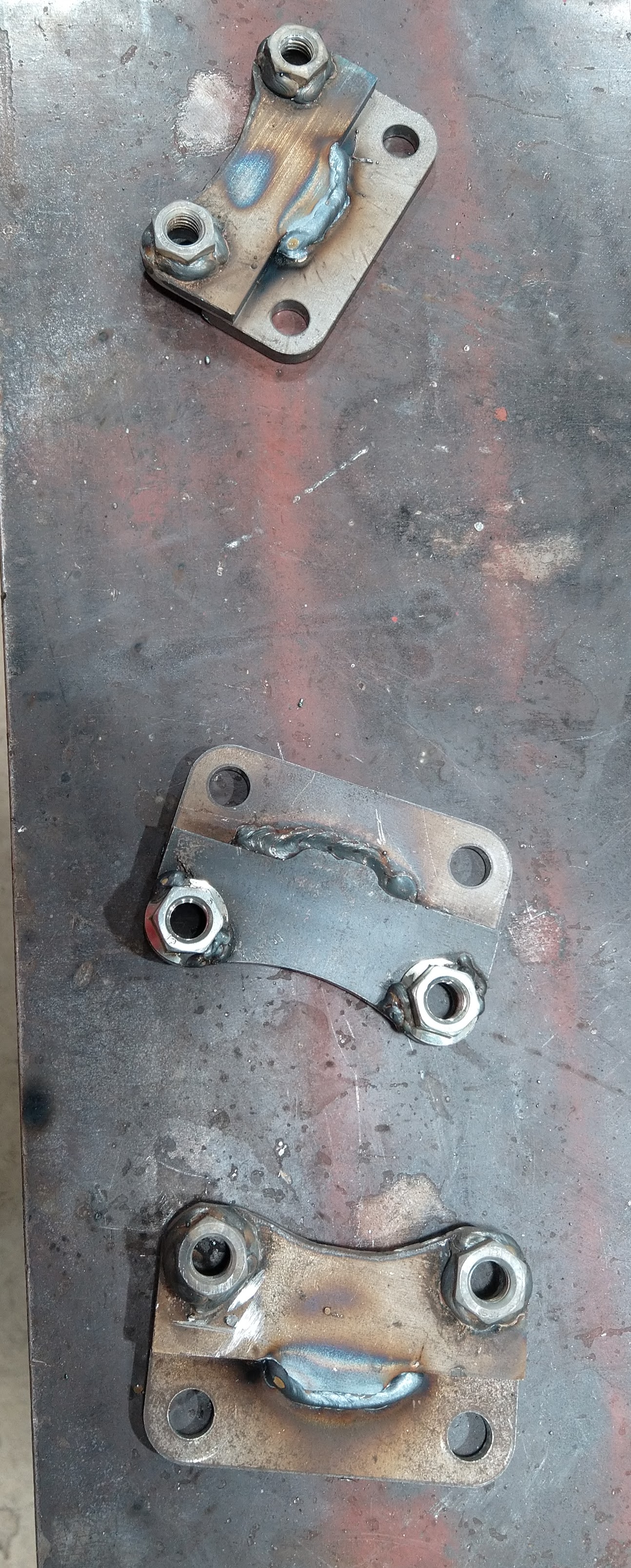

I started making a bracket for the shift and select cables. Here is the relocation of the select ball.
And the shift ball
In the car.

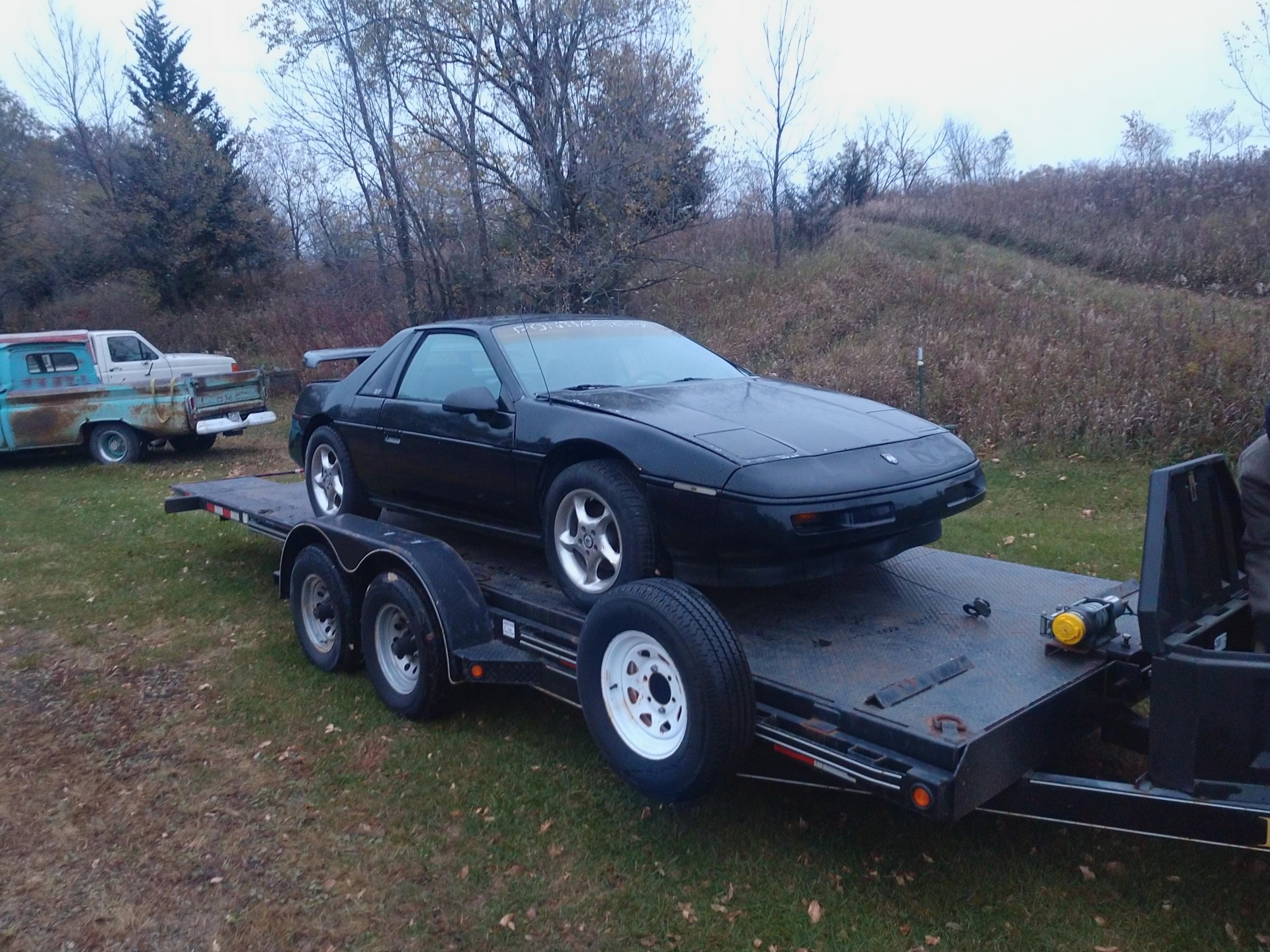

First, I bought this fomula with no title. I know someone dumped $15k into it with NOS and new interior and SS fuel/brake lines and more. Then was neglected, broken into, and sat on a farm with no title for years. I should be able to get the title, as i found the registered owner after some research.

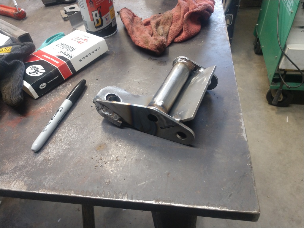

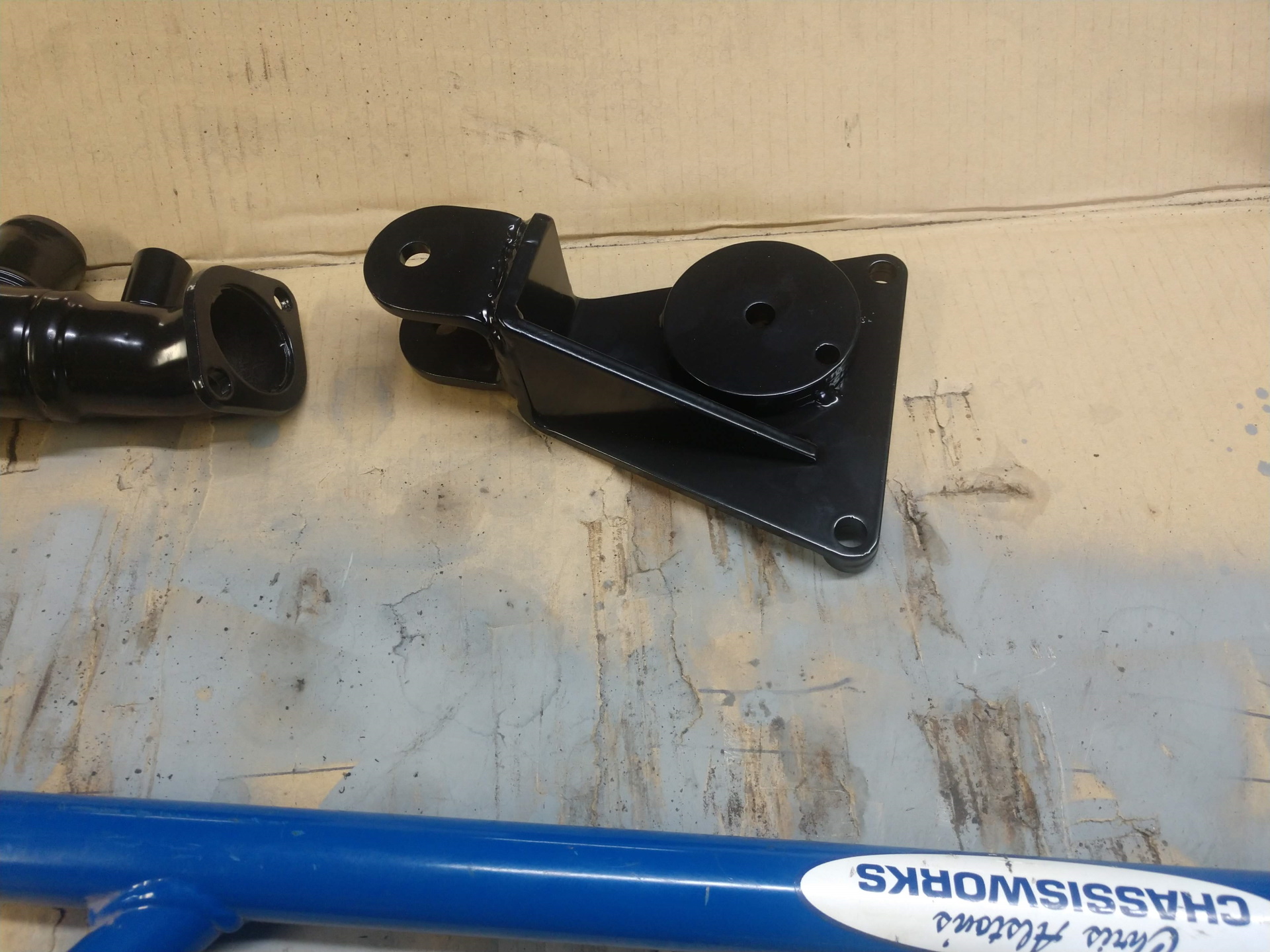

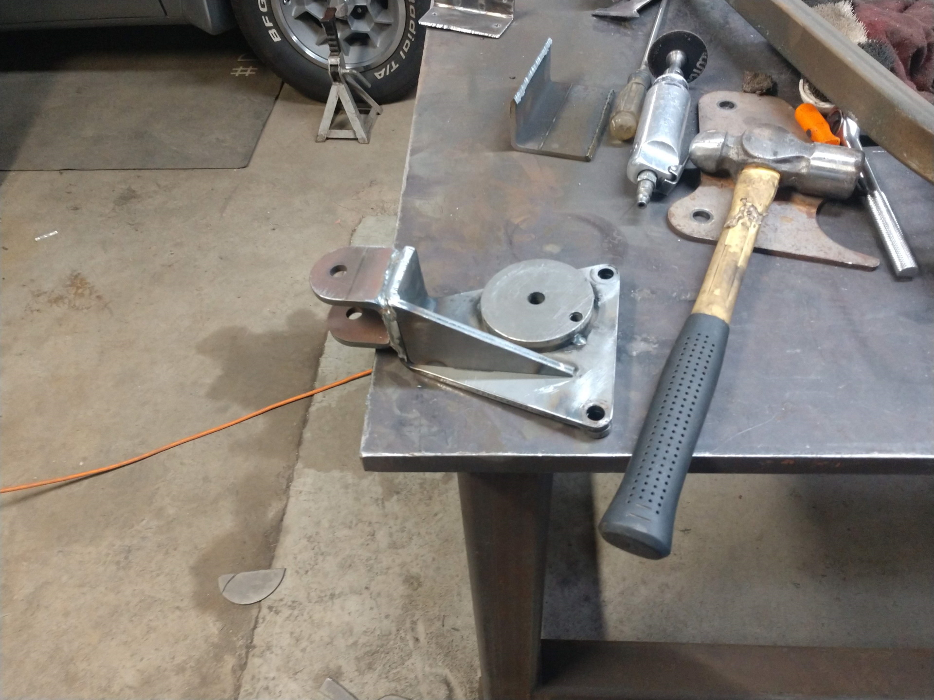

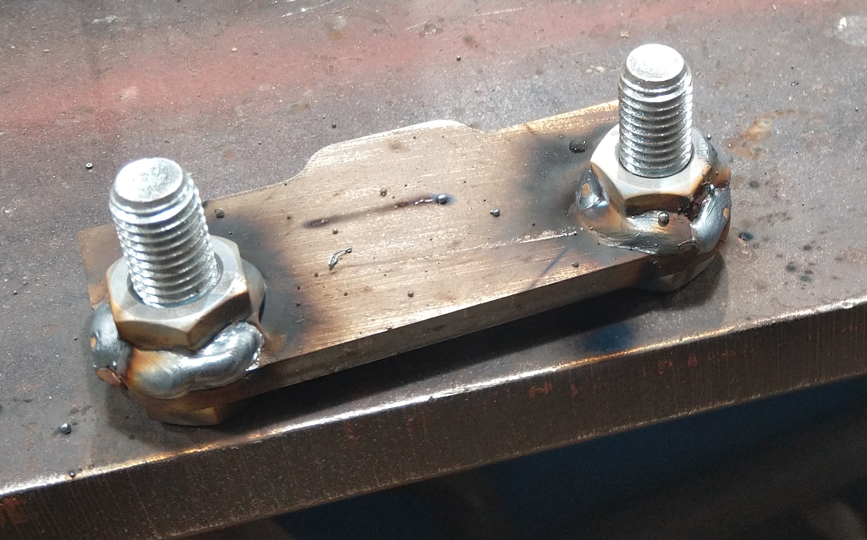

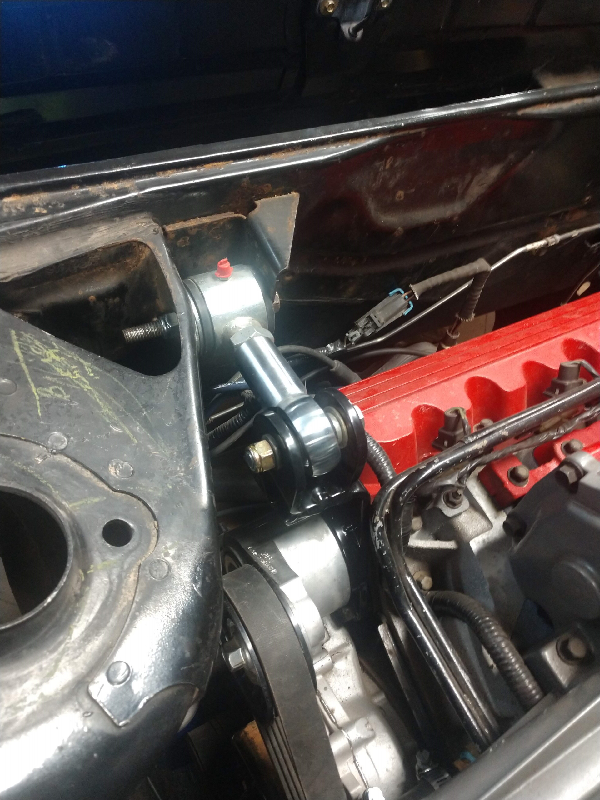

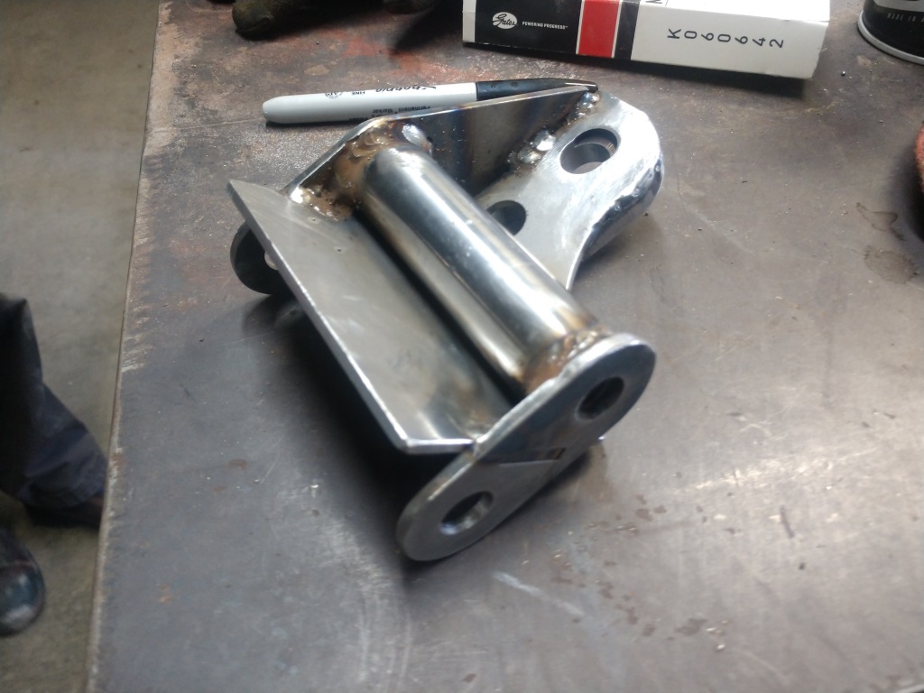

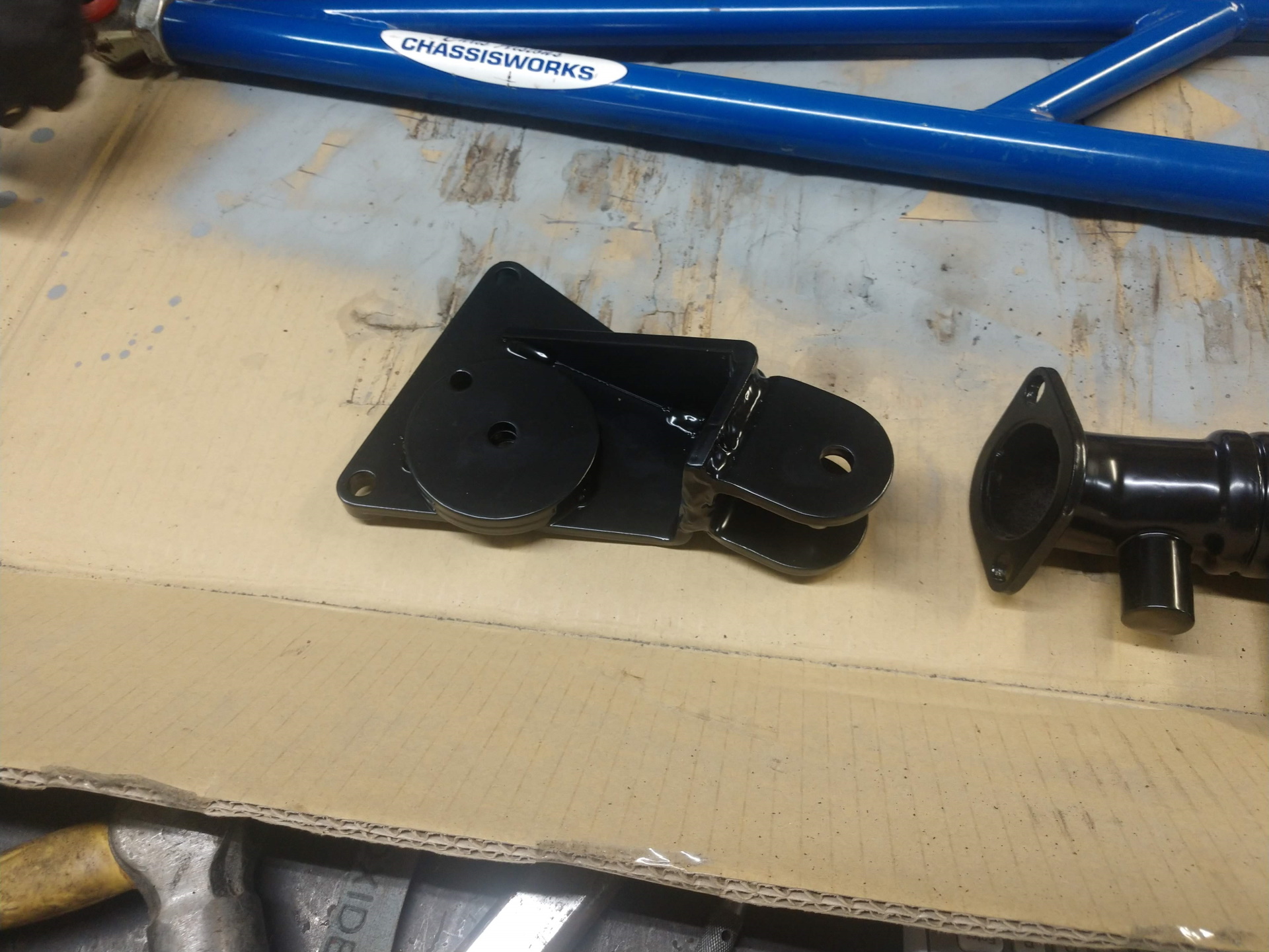

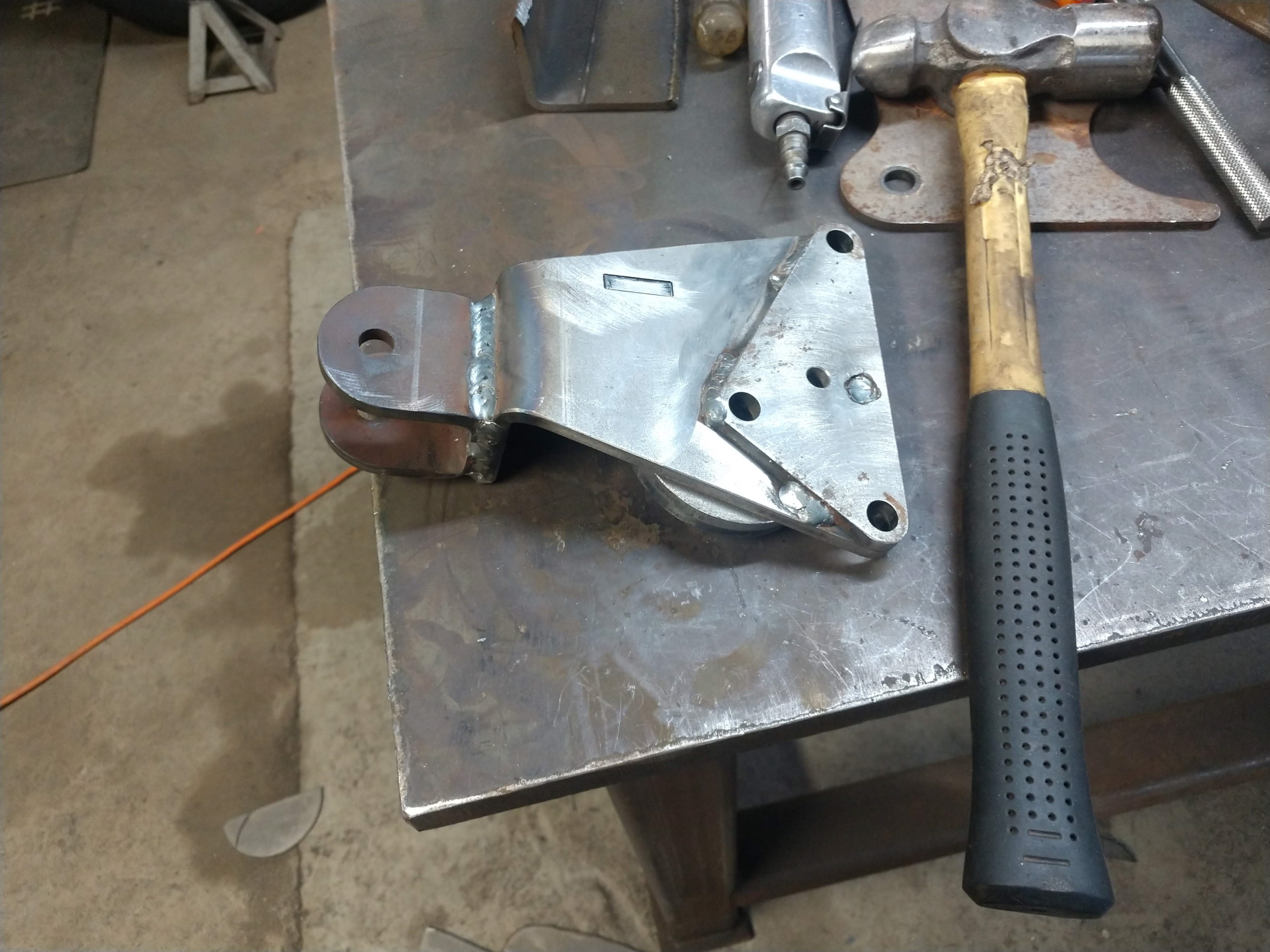

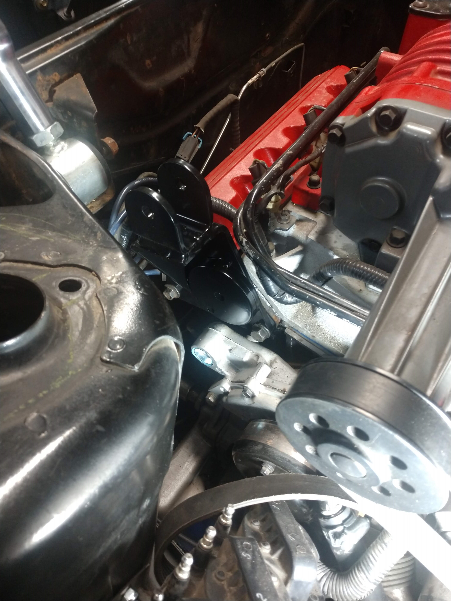

My tensioner/ dog bone mount. I might make some more to sell, but i would need to know what brackets they used for the engine, as mine were of my own design. I could sell it with the top part not welded and you could fit it and plug weld it.
Powder coated
Installed

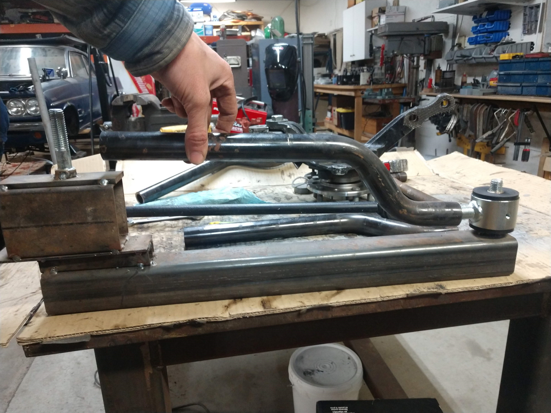

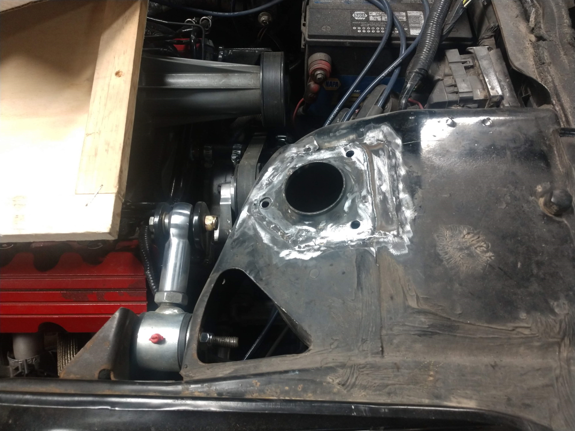

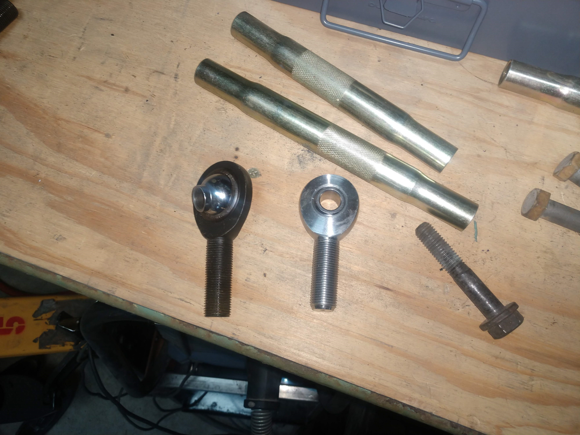

I used FieroGuru's tube idea to bring in the rear wheels. I found that the and links were for rock crawlers and not very durable. I went with some heavy duty ones from QA1. I can get the part numbers if anyone needs them.

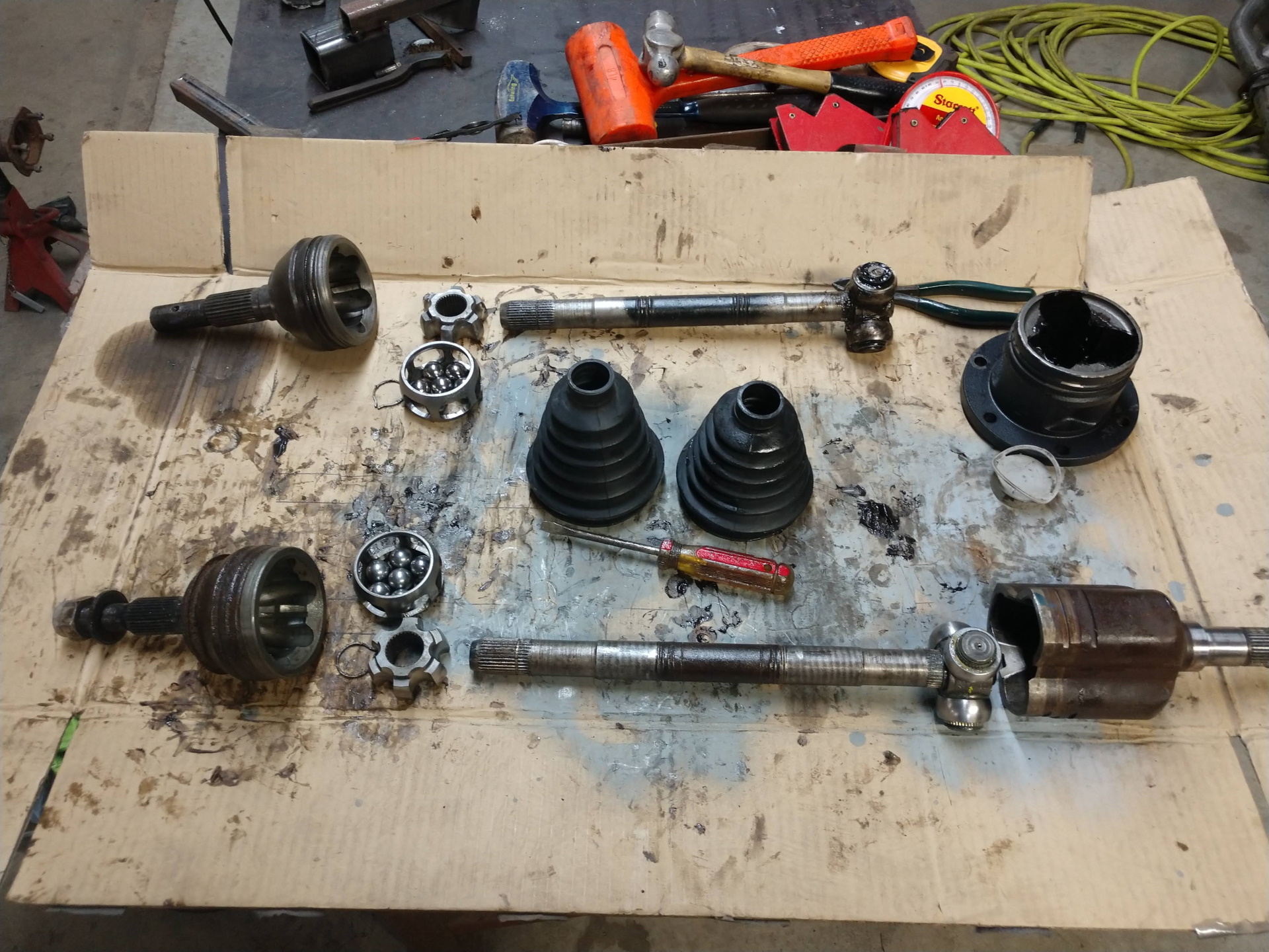

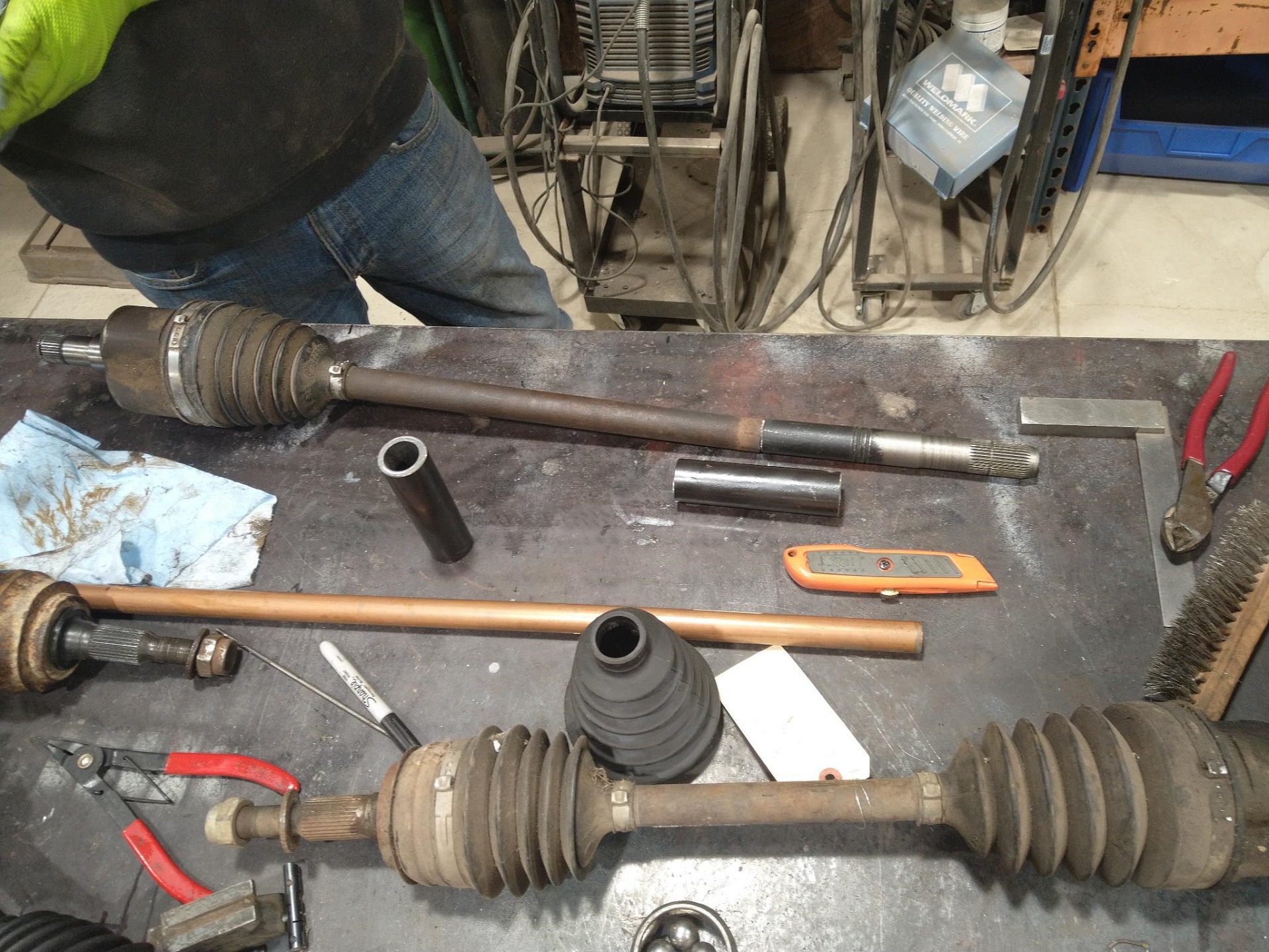

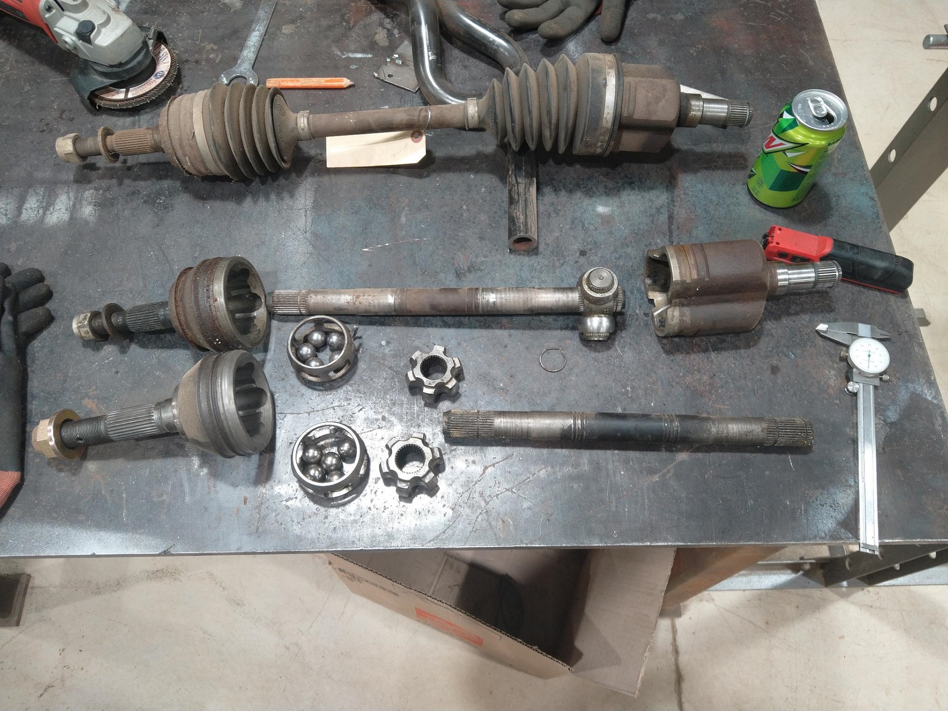

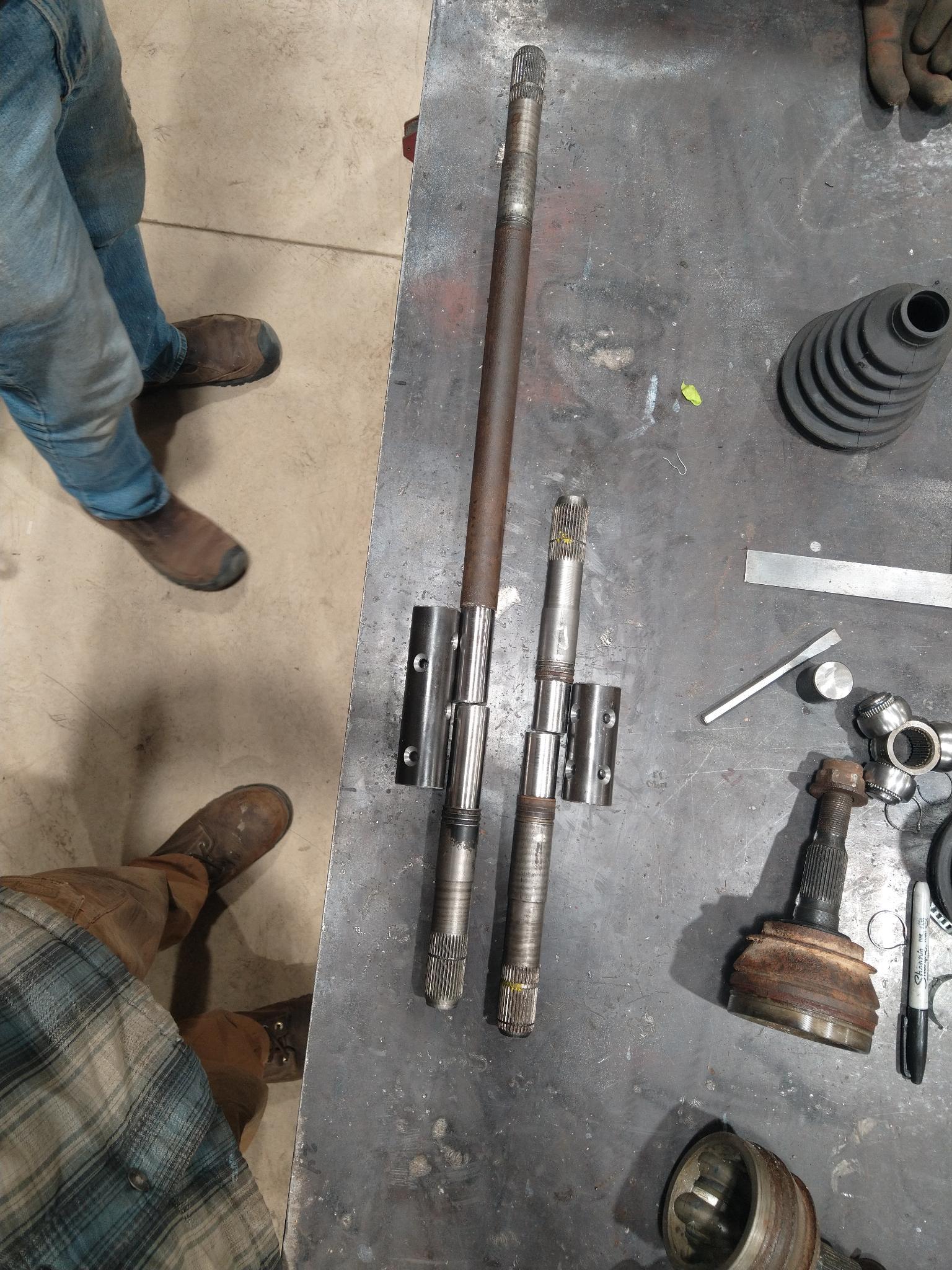

CV Axle fun. I think i am going to try to weld them and if it brakes i will order custom axles. The splines for the fireo inner and the S10 outer dont work.

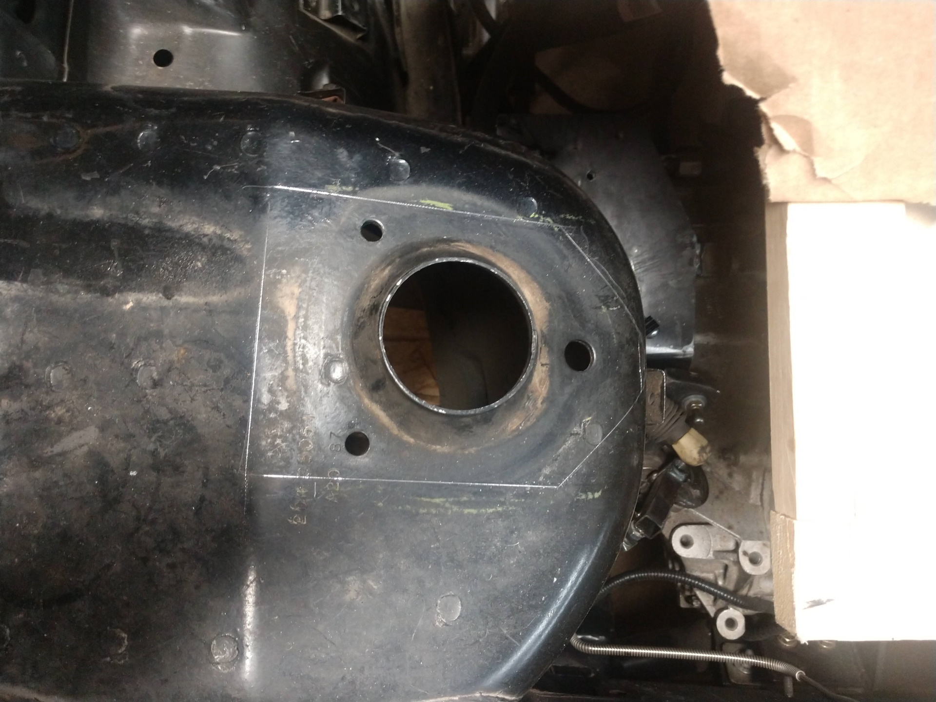

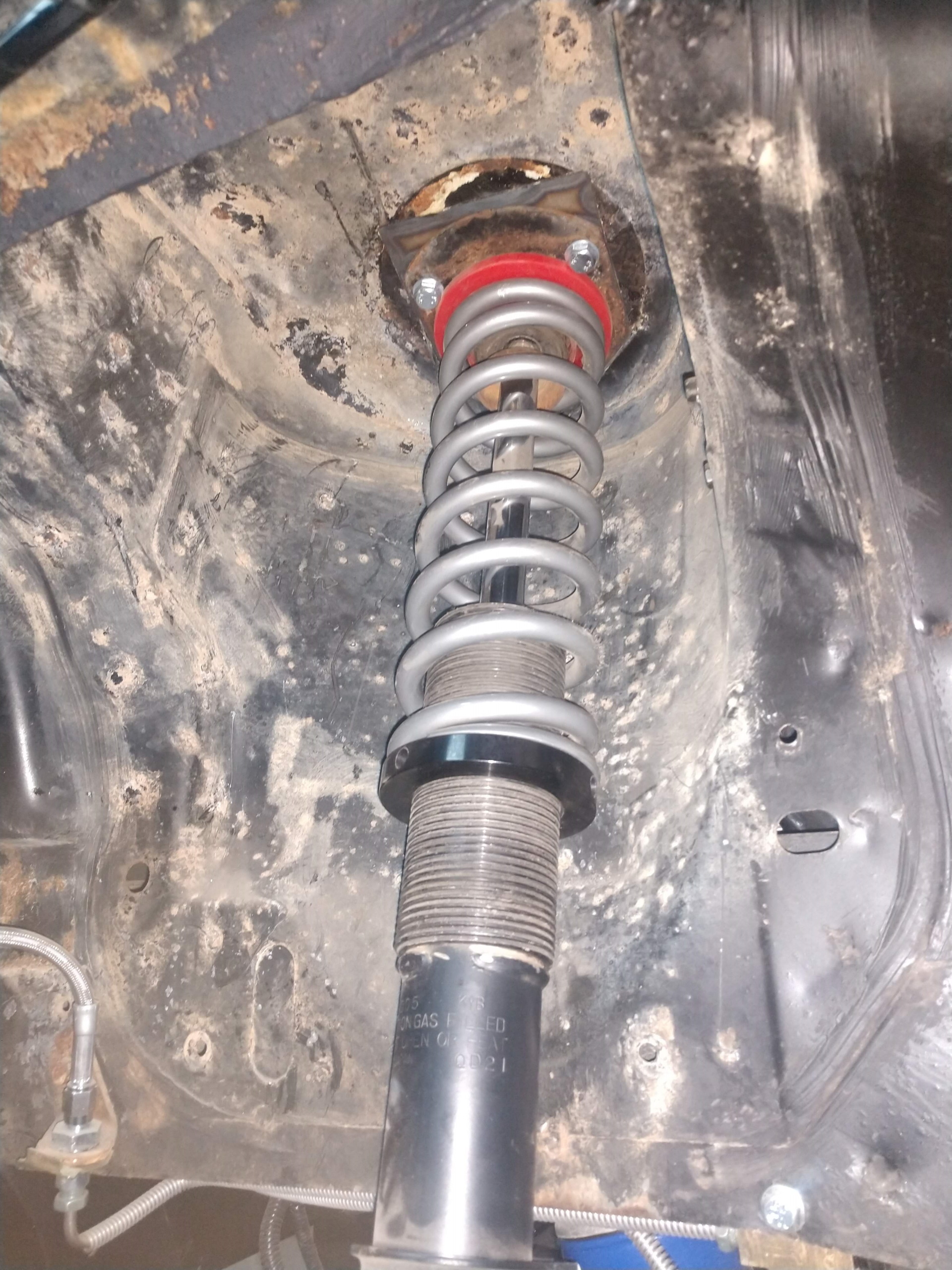

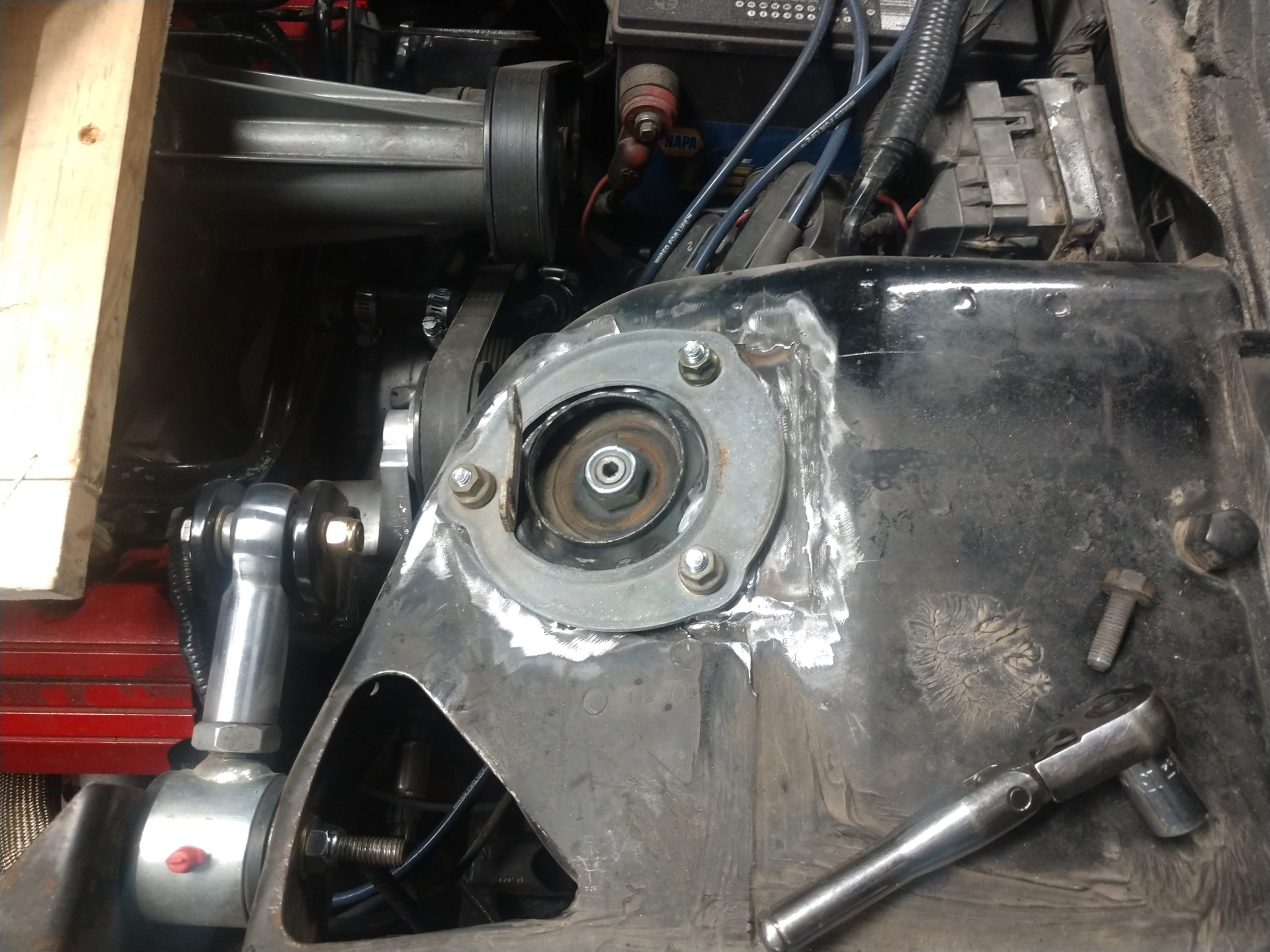

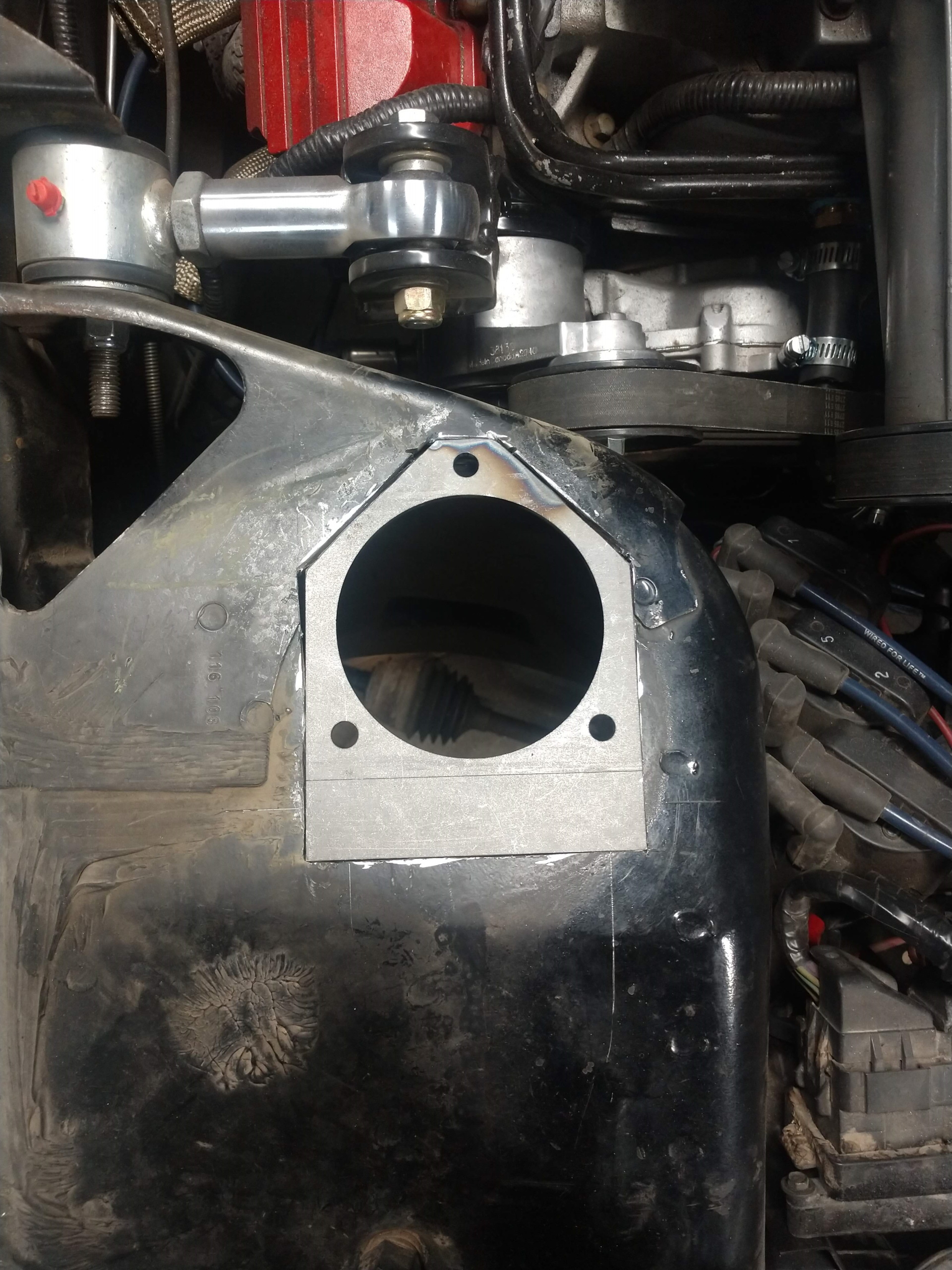

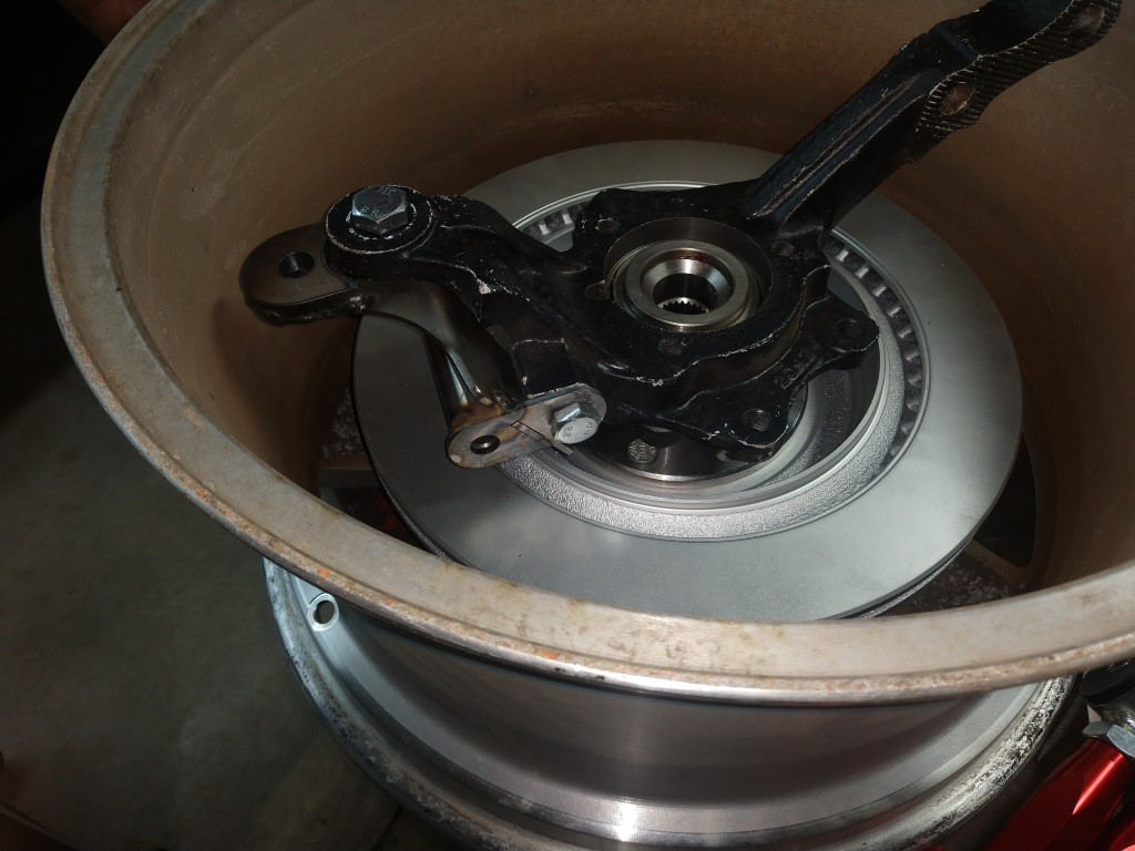

I had to bring in the strut tower mount 1"

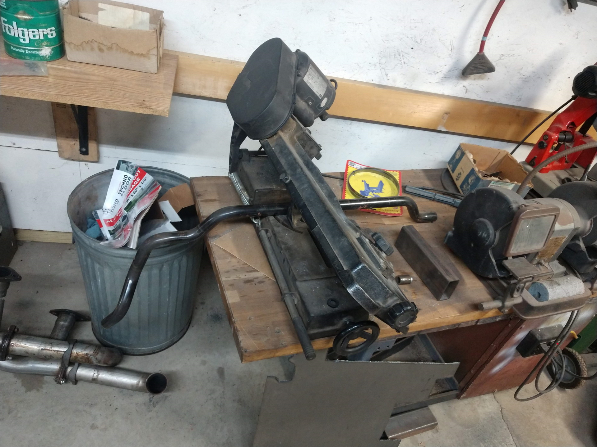

The rear wheels were too wide to clear the rear suspension bar (i cant remember the name...) So my dad grabbed a few scrap sway bars from the dumpster and i made new ones that will clear.
 Yea i know the strut is on backwards....
 thats better

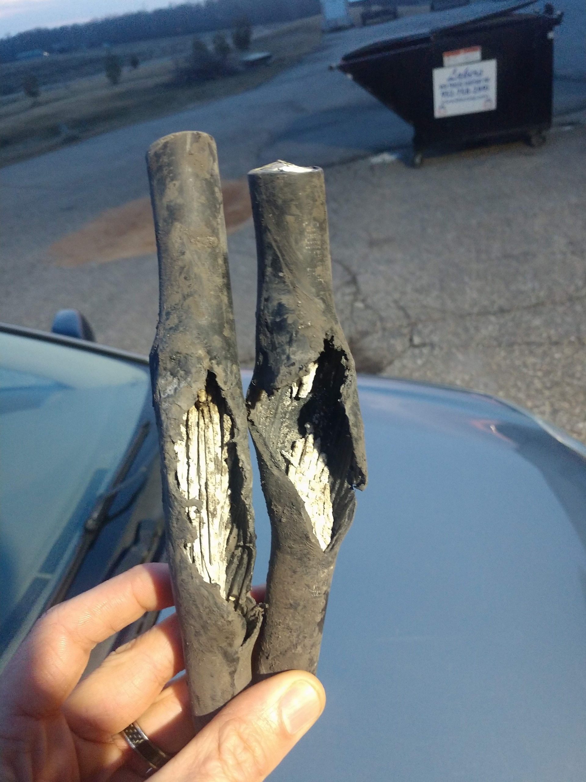

And the ISP is bringing in fiber this summer and hit my 600 amp service with a shovel last fall. When the spring melt came, the aluminum disintegrated.

I took the inner cups and shaft from a 88 manual fiero and the outers from a early 90's S10. I tried to get them so they are in the cups deep, but not to bottom out.

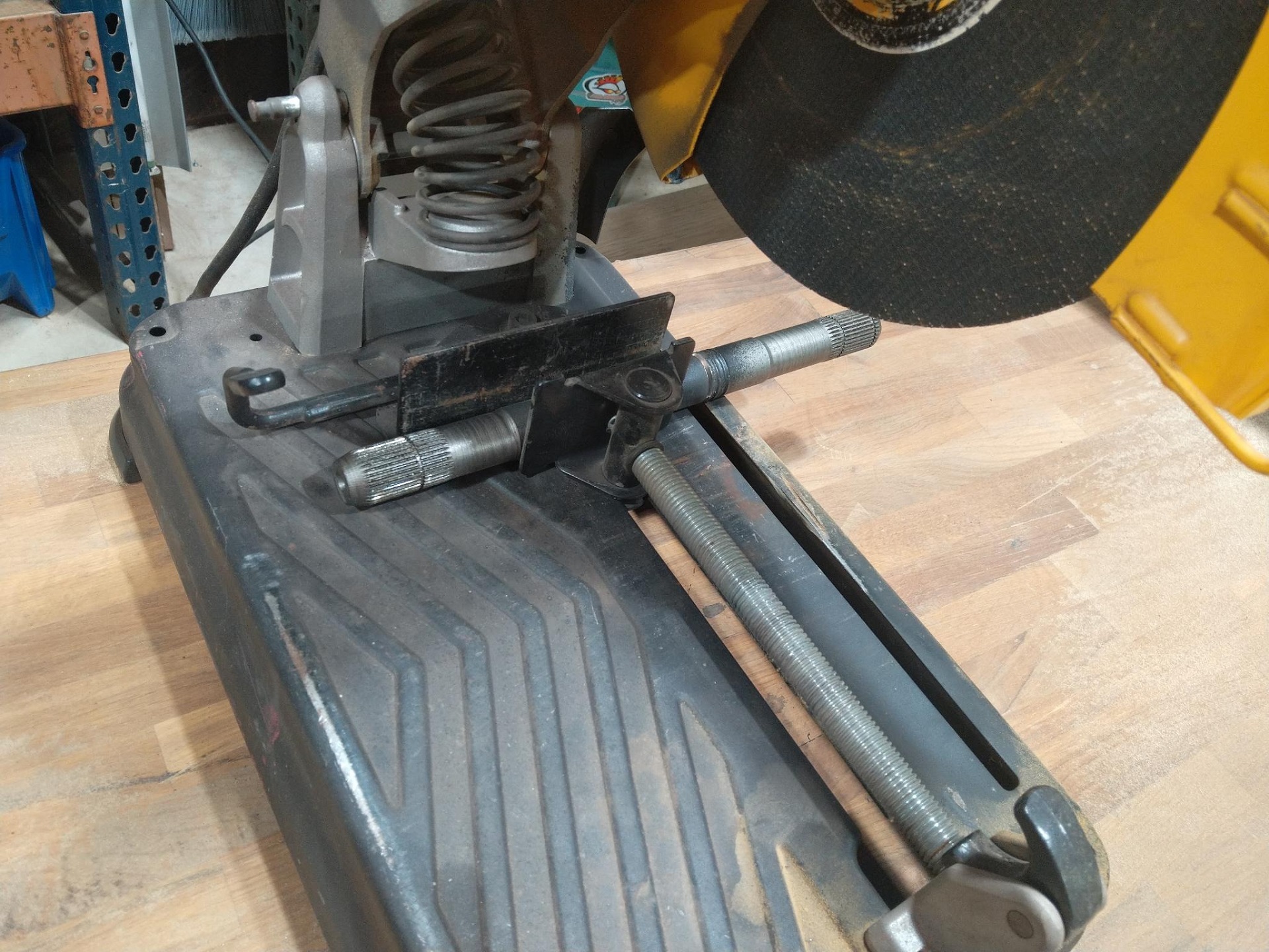

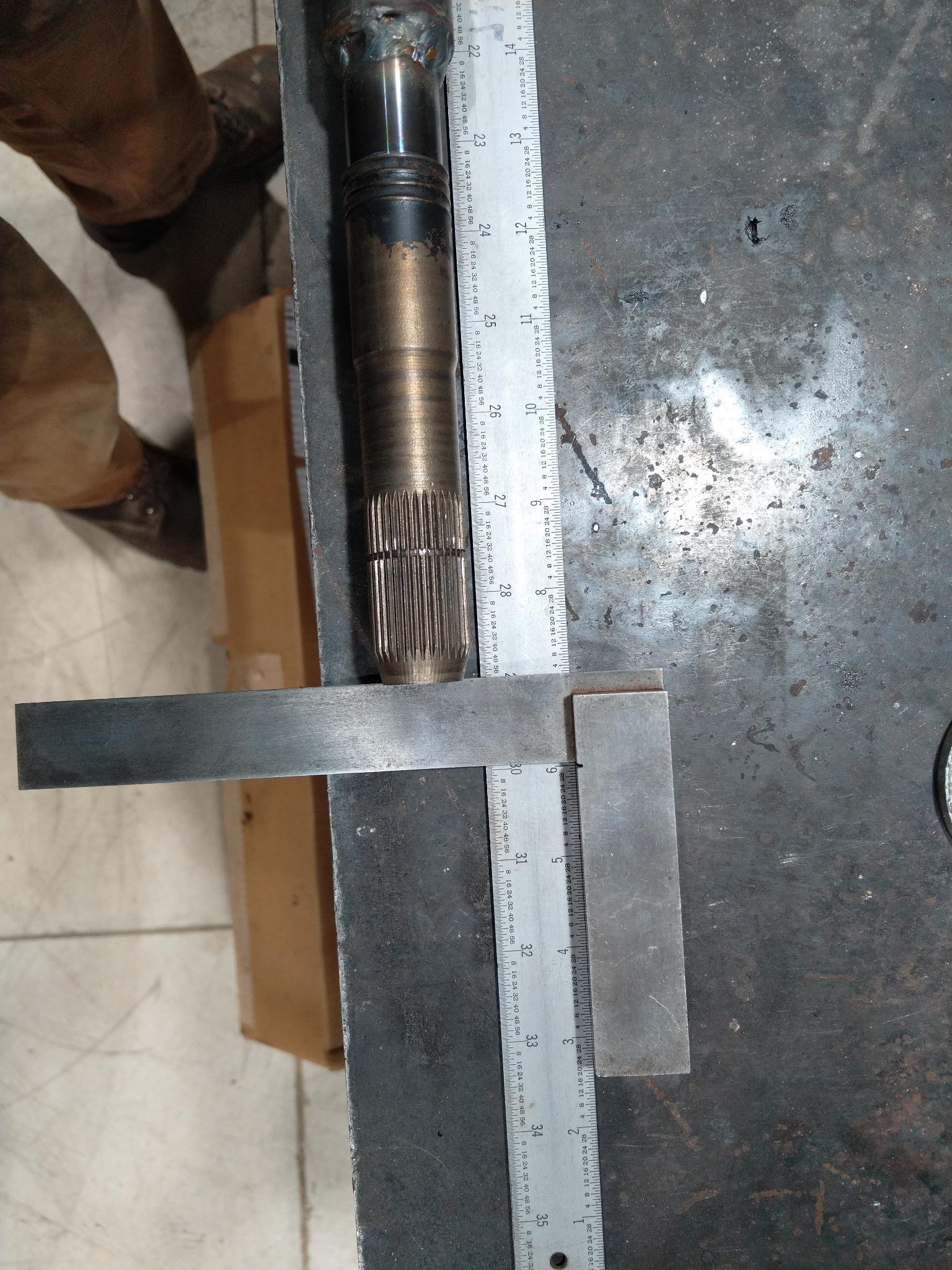

I had a machine shop turn down the axles and center the inside of the tube. The tube is actually from a scrap sway bar at QA1.

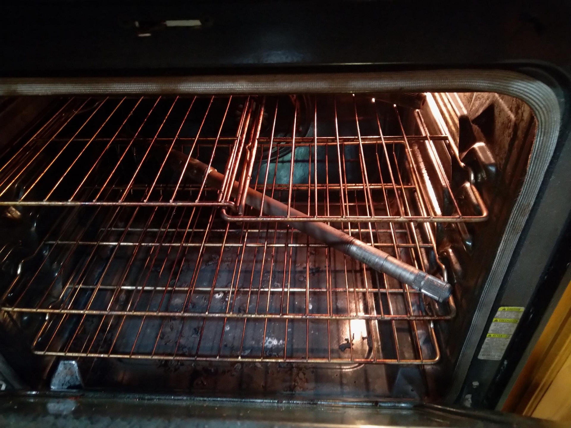

I am not sure it helped, but I threw it in the oven after welding to let it cool slowly.
Drivers side
Passenger side

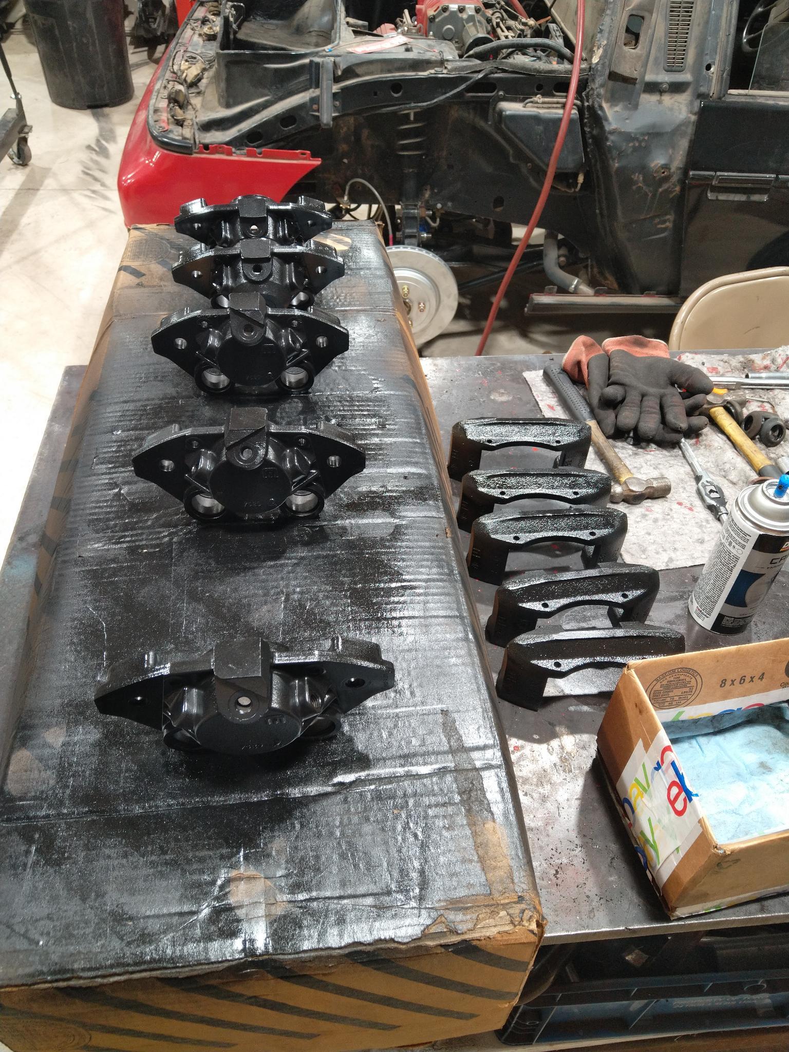

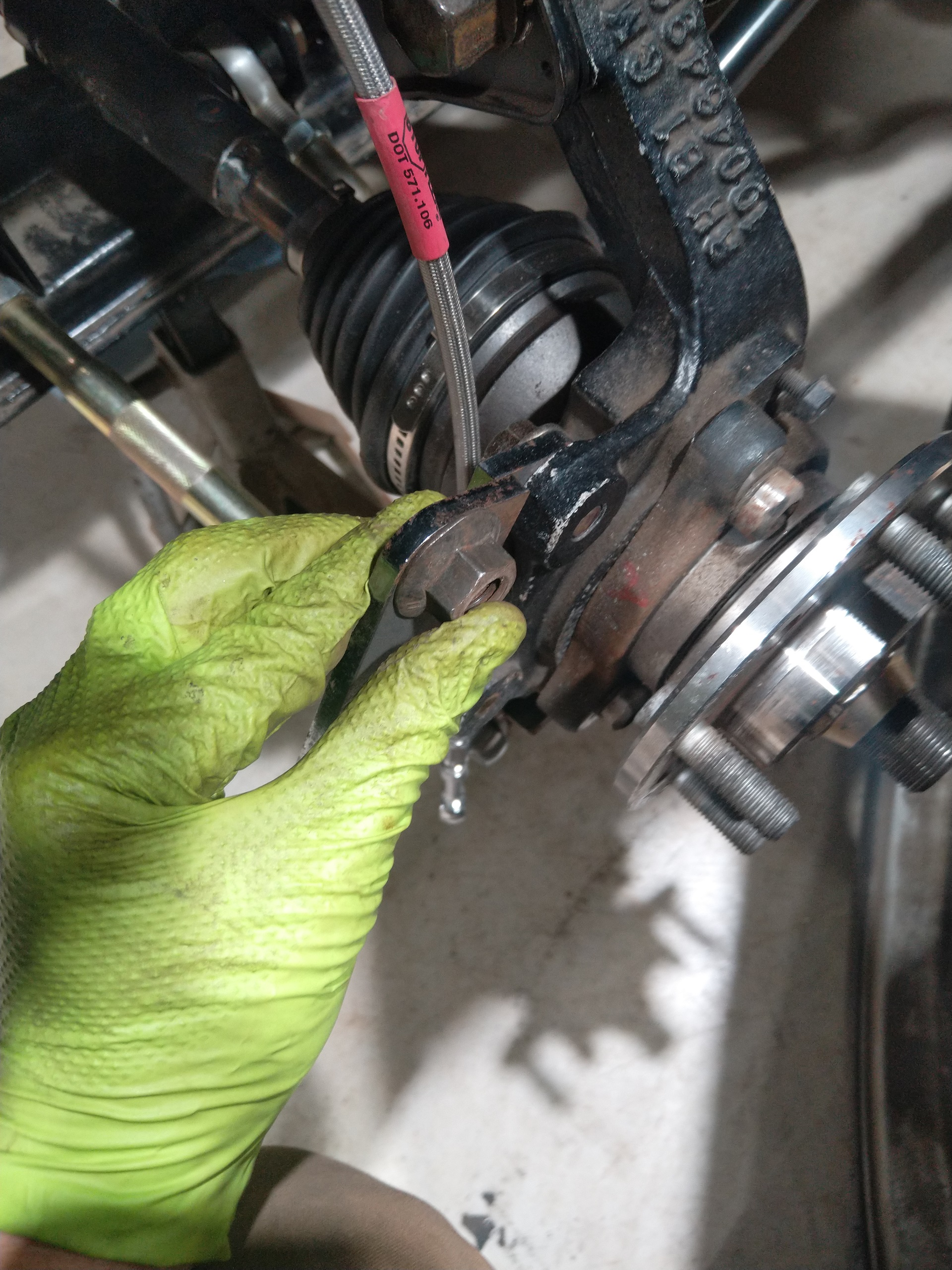

Brakes I found a few extras from the parts are I bought awhile ago.

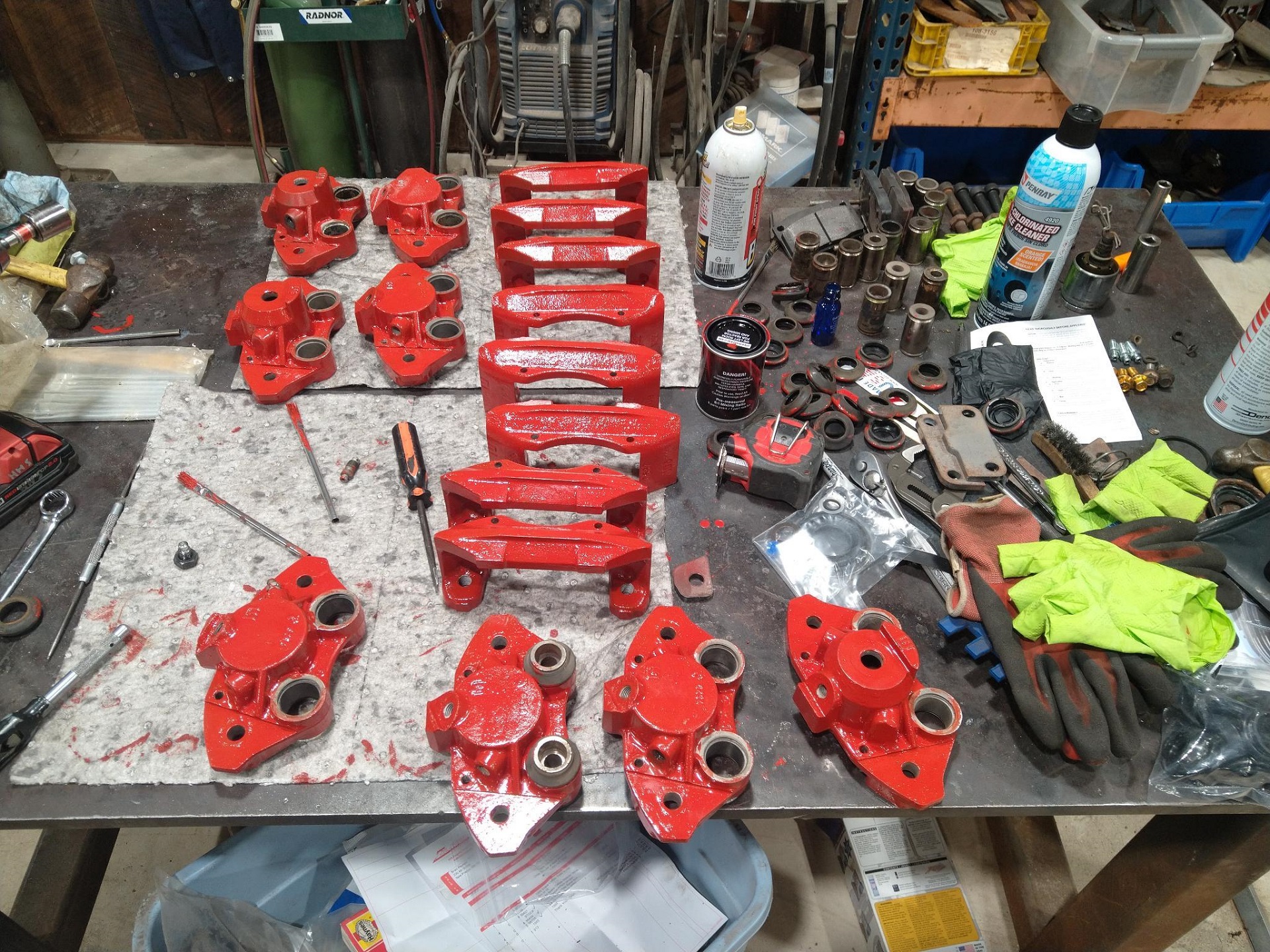

I decided to do my stock 88 fiero brakes too.
I found that the rear inner seal was bad in 3 of 5 rear calipers. I found a guy in FL that had a few extra kits. I also have the formula fiero that probably has bad seals.
paulsobj
APR 19, 09:58 AM

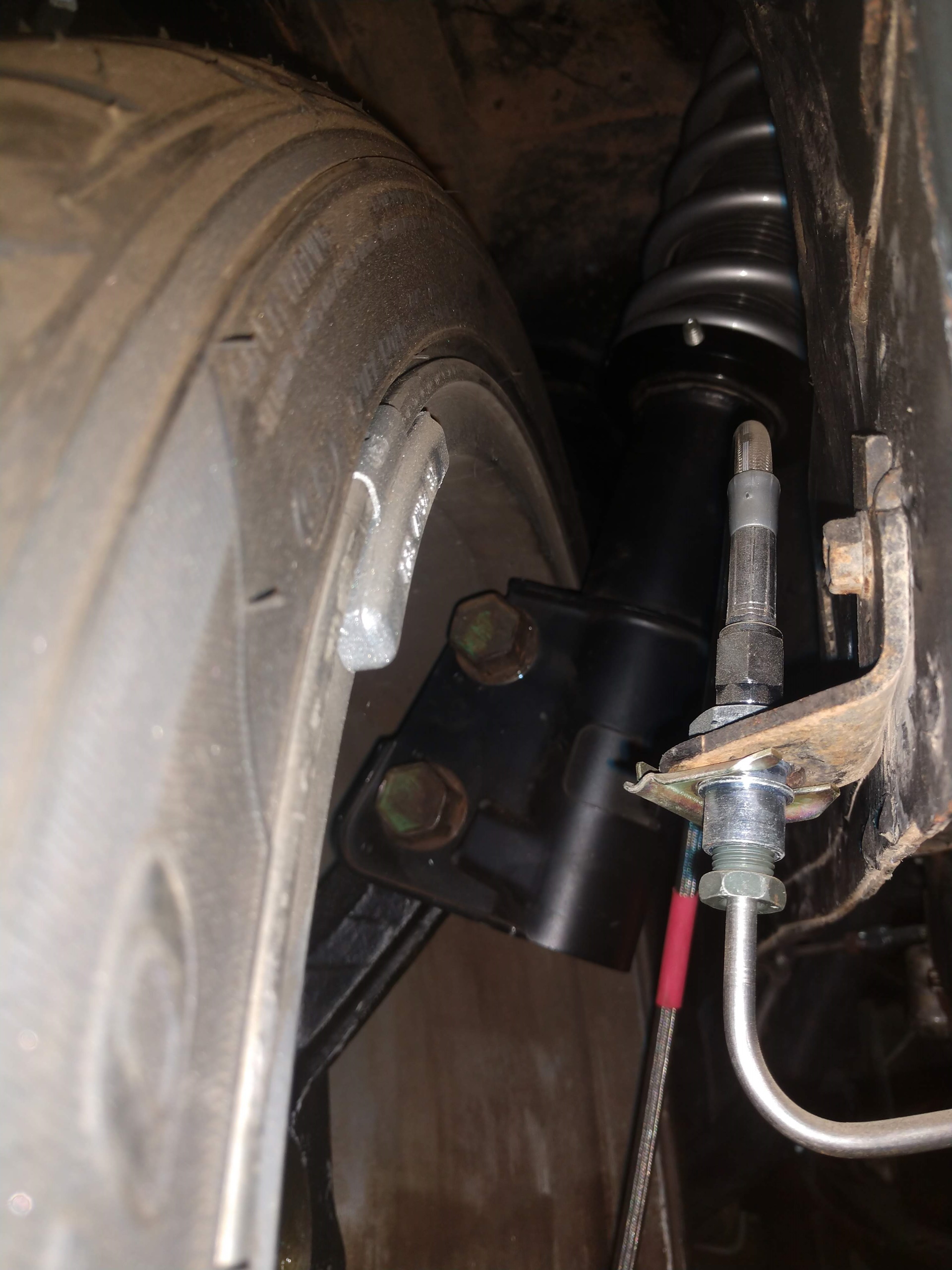

I found that disassembling the inner pistons the ball bearing (three balls isn't really a bearing) were prone to cracking upon reassembly. I bought some very close ones that just needed to be turned down a little.
Here is some pictures of the brackets for the breaks.

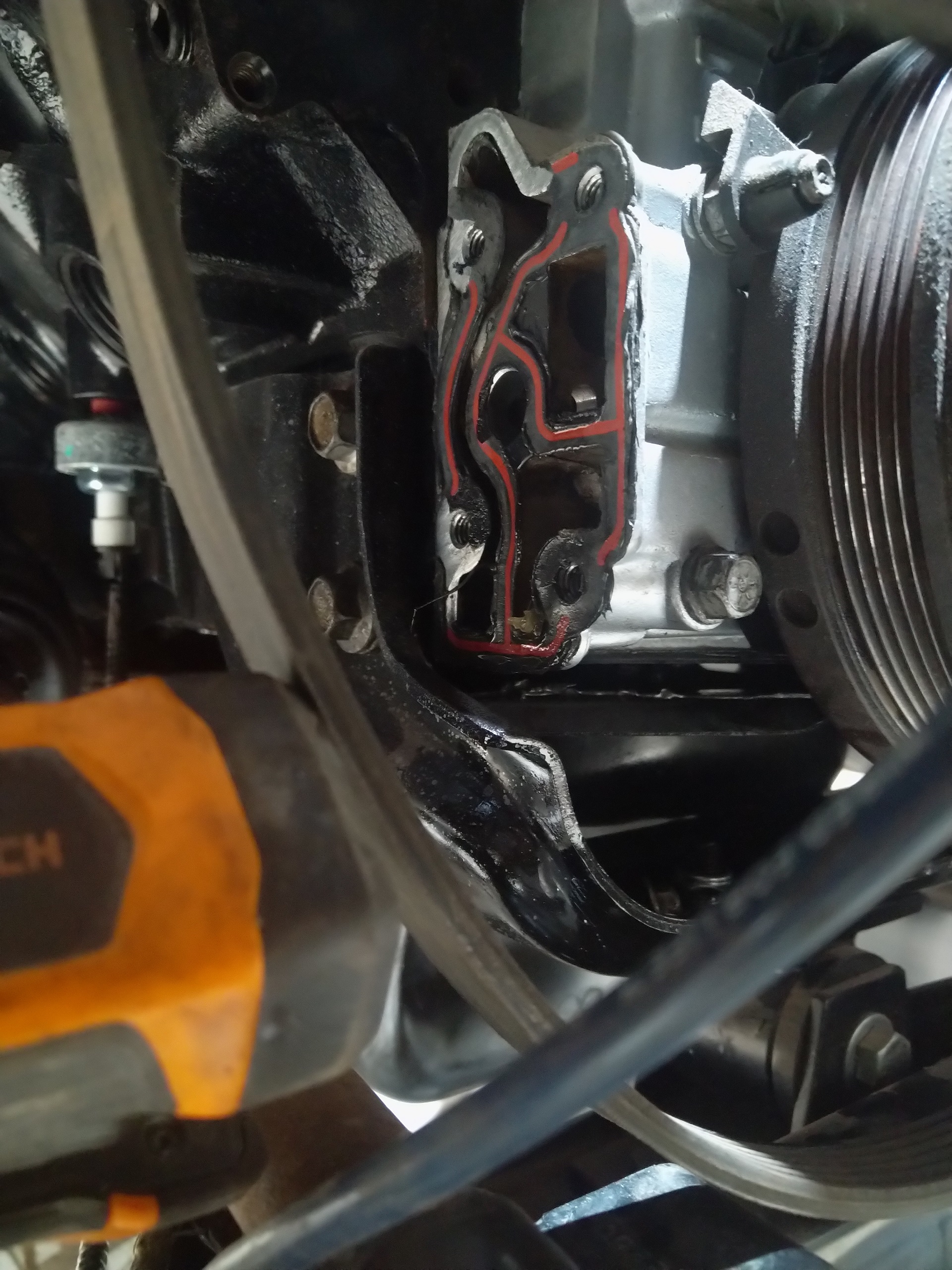

I then had decided to bleed the coolant. I had the engine running then noticed no oil pressure. I tried filling the engine with 9 qts, to get the level high enough to be in the oil pump, but it didn't work. I tool off the oil filter adapter bracket and the oil was dripping out. I was about ready to pull the timing cover to inspect the actual pump. But I had someone mention the high pressure oil relief valve. I found that I had not installed it. I bought the ZZP kit https://zzperformance.com/p...lume-kit?zCountry=US

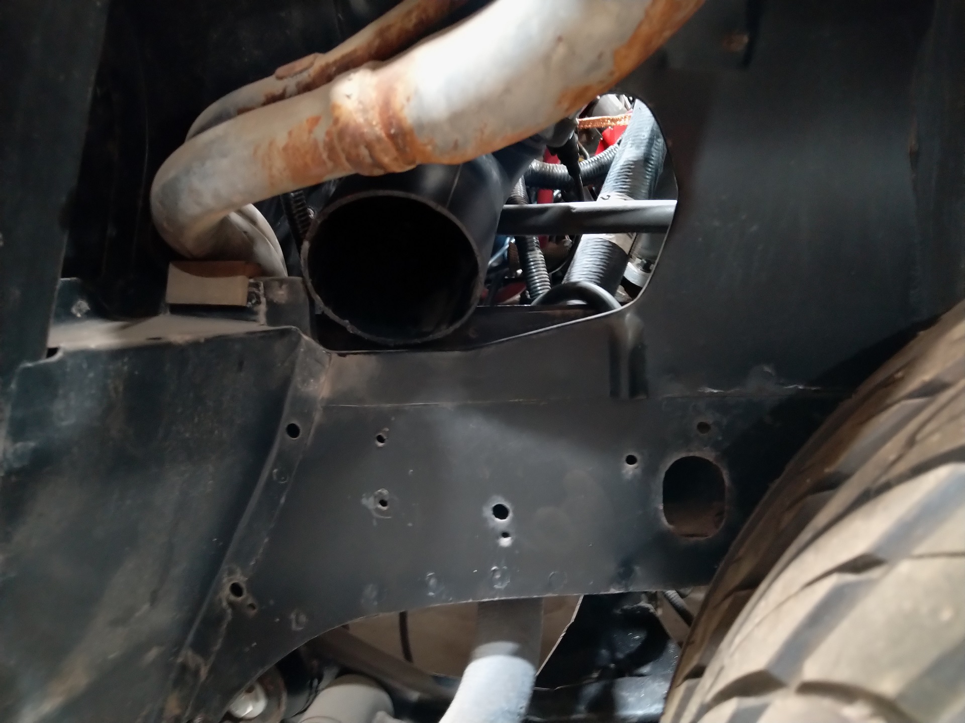

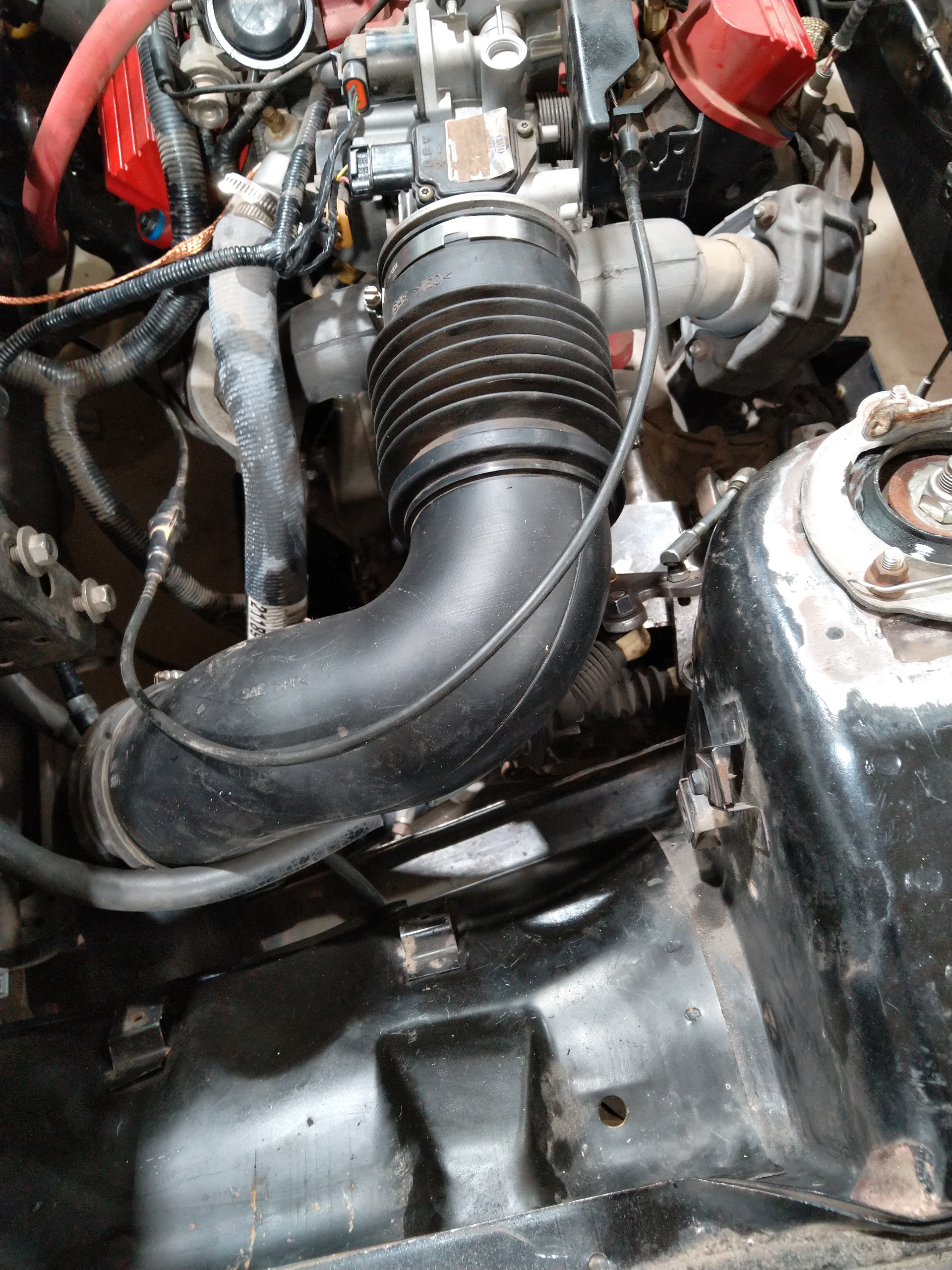

Intake installed. GMT800 (1999-2006 Silverado/Sierra 4.3L) air induction tube cut to fit, using a K&N filter mounted in front of the left rear wheel in that space behind the inlet grate. K&N Universal Clamp-On Air Intake Filter: High Performance, Premium, Washable, Replacement Filter: Flange Diameter: 3.5 In, Filter Height: 7 In, Flange Length: 0.875 In, Shape: Round Tapered, RU-3130

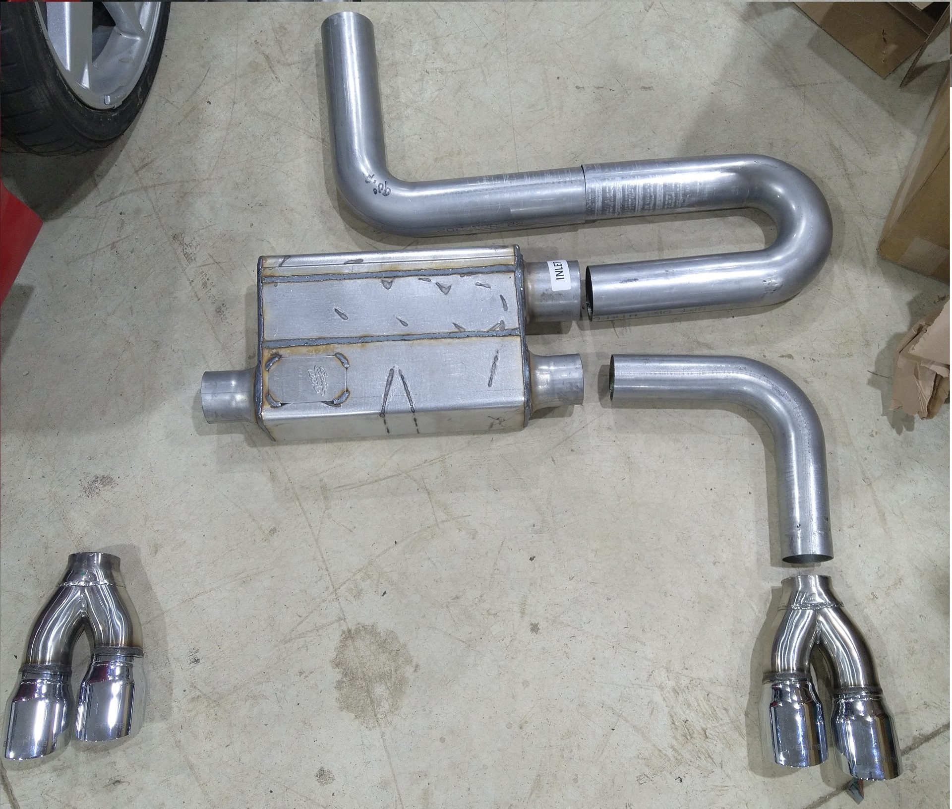

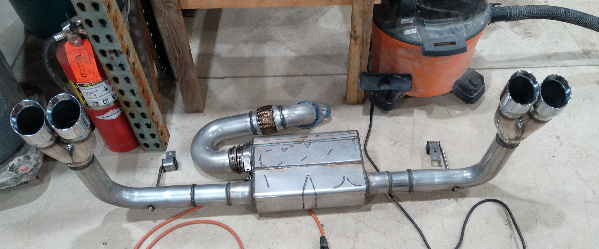

Exhaust.

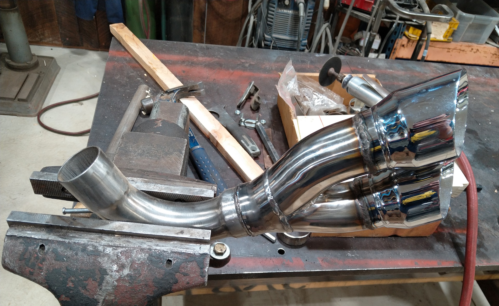

I am doing 3" into muffiler and dual 2.5" to splitters. The stainless tips are 2.25, so I am cutting off the 90 degree bends.
Parts list from Spintech. I forgot one 90 degree bend, that you can see.
It was $700 labor to get this done at Midas in Shakopee, MN
 I will be doing exhaust wrap next post.

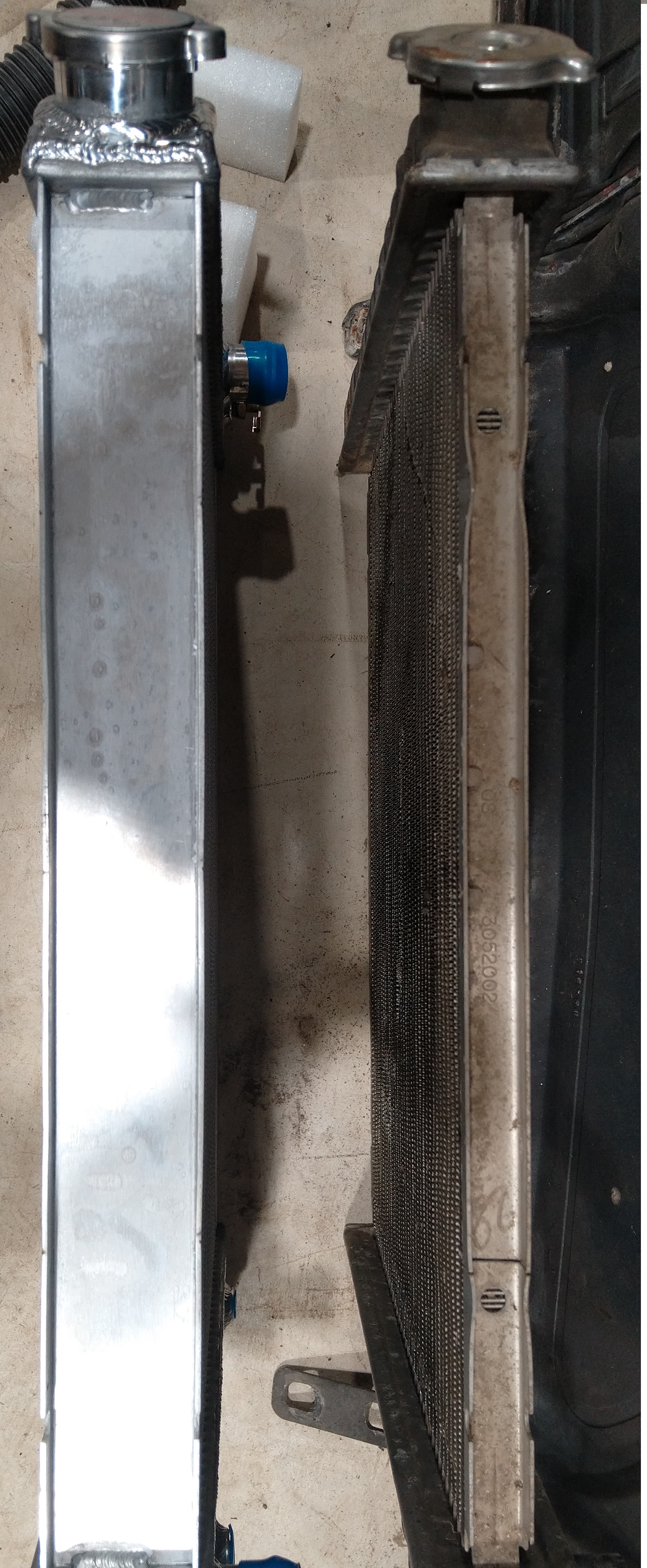

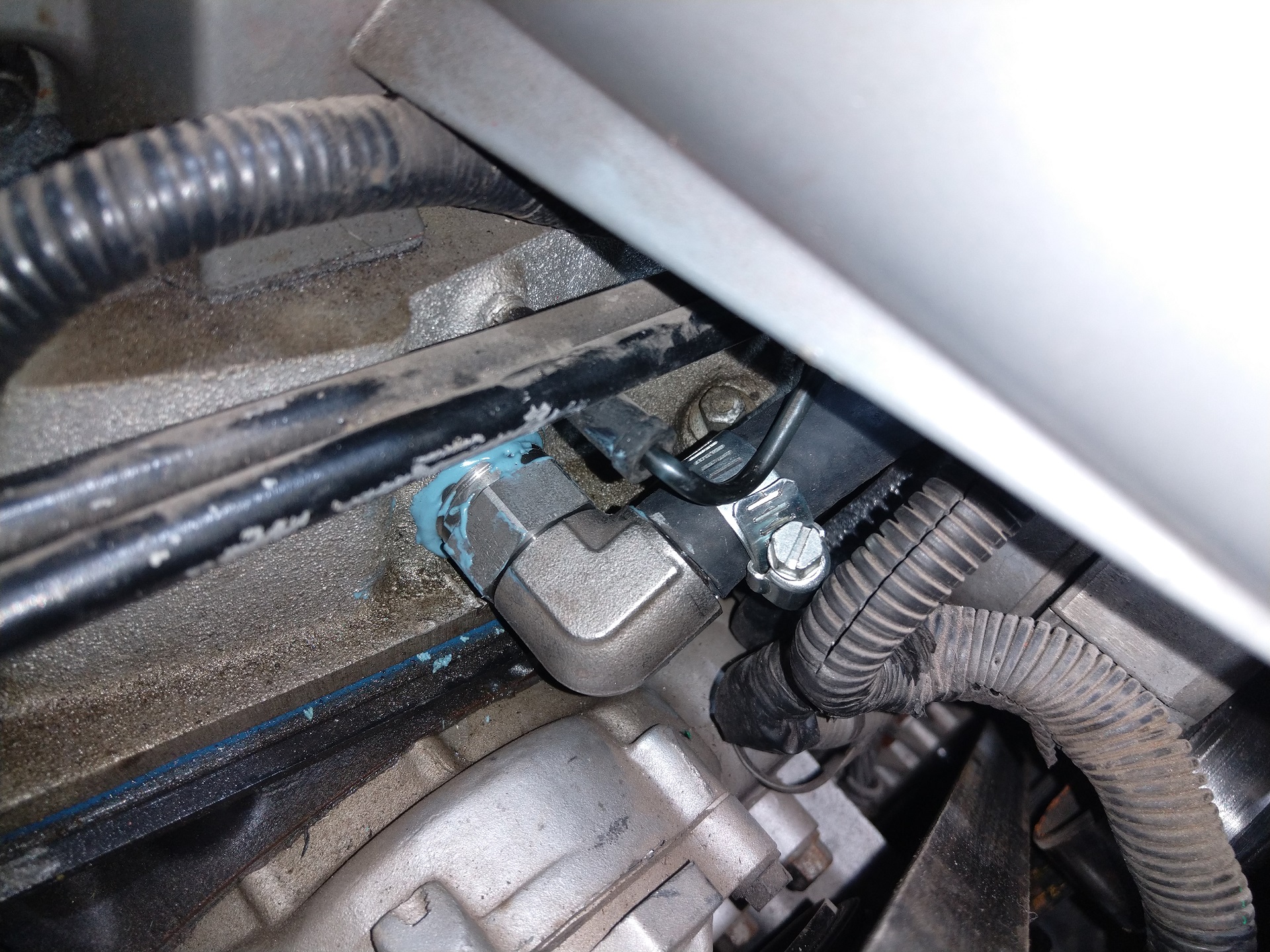

The coolant update. I changed to this 90 degree swivel off the LIM. It was not cheap and I almost didn't get it.
Installed.
Looks much better.
