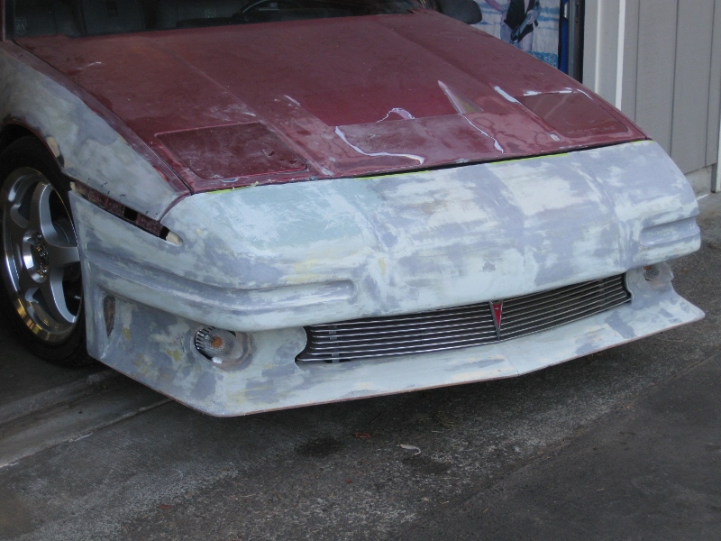

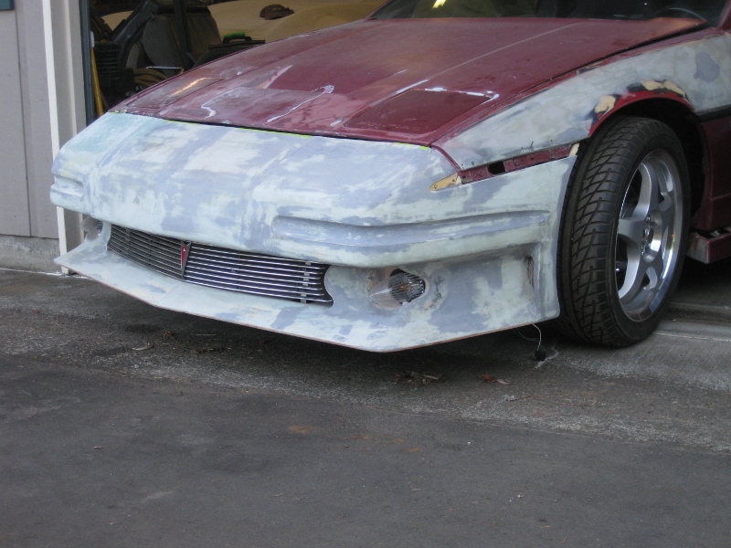

bjc 350
JUL 12, 12:57 AM
Been a looong time since I posted anything about the mini wide body. But this evening I had to pull it out of the garage to be able to access the attic area of the shop. So, while out I snapped a couple photos of the nose concept minus the fiberglass. Almost ready for glass but I probably said that a year ago. It will be finished, once the rental house gets its facelift and the lawn edge stones get placed here at home, and on and on.
