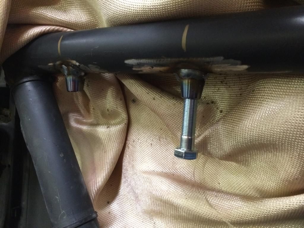

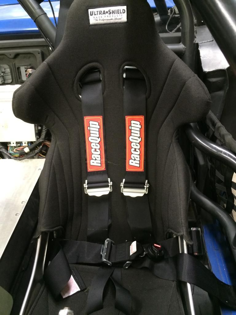

I was unhappy with the shoulder harness mounting so since I had to install a new harness anyway I decided to rework the mount system. I welded in a couple threaded bungs that will allow for very easy harness upgrades in the future.
All done!

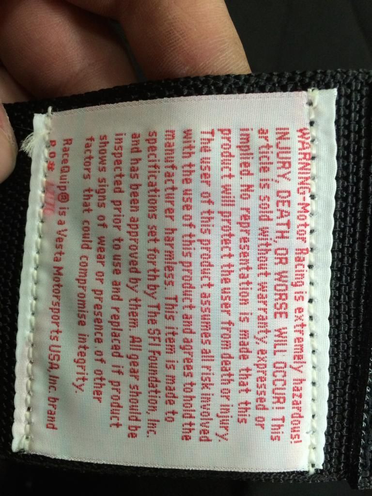

Apparently injury, death, or worse will occur!

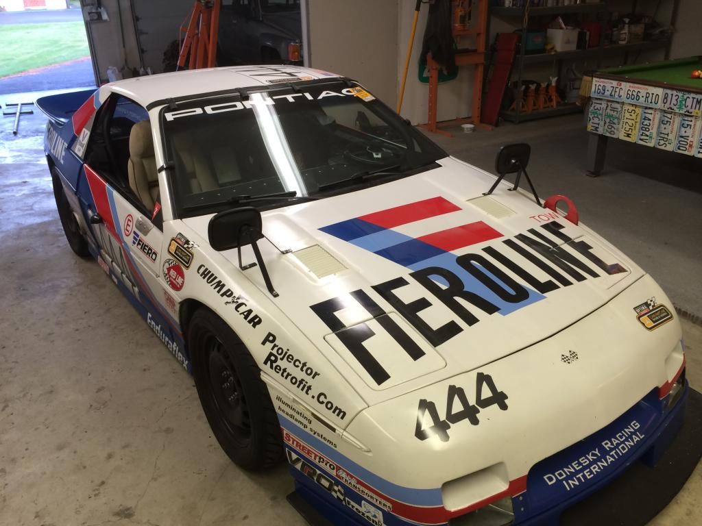

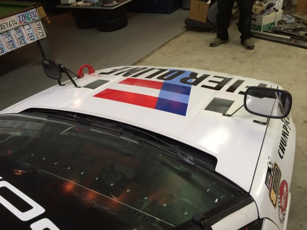

We got our splitter painted and installed for good, believe it or not I can stand on the lip. Hopefully it lasts through the next event!

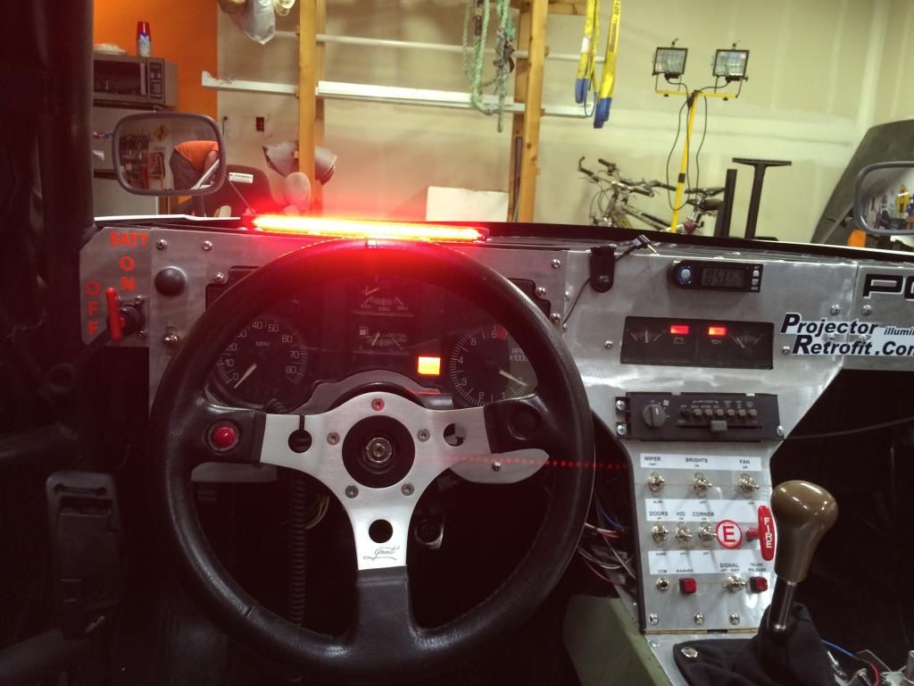

Next I focused on the master caution light, Team Pontiaxed did most of the leg work but getting the oil pressure light to trigger it proved a bit of a trick to make work. I also wanted to get the flashing shift light working and am very happy with the results!
I put a little video together demonstrating the function of the master caution light. I think its safe to say that my drivers will have no excuse for missing an oil pressure temp warning!

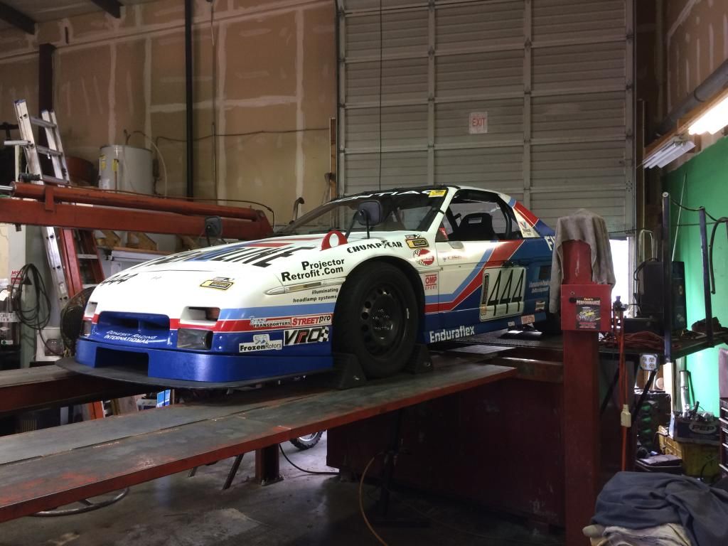

We dynode the car with the new engine today and are very impressed.
167 HP 204ft.lbs. of torque at the wheels... Not too shabby, with lots of room to grow in the future we hope.

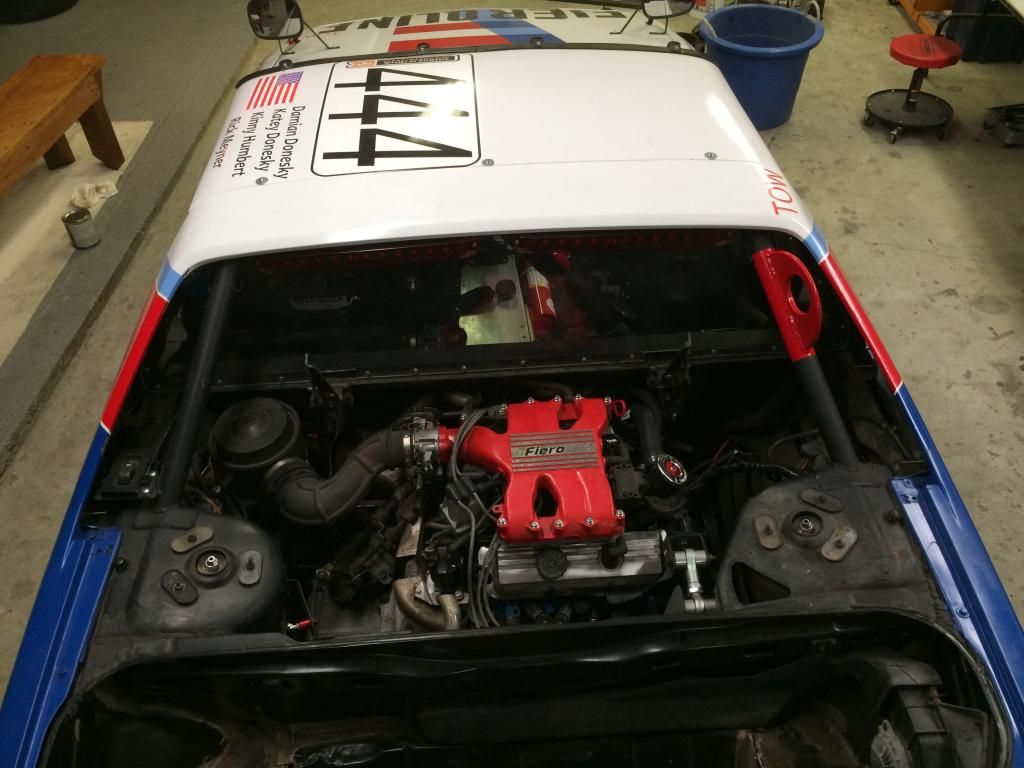

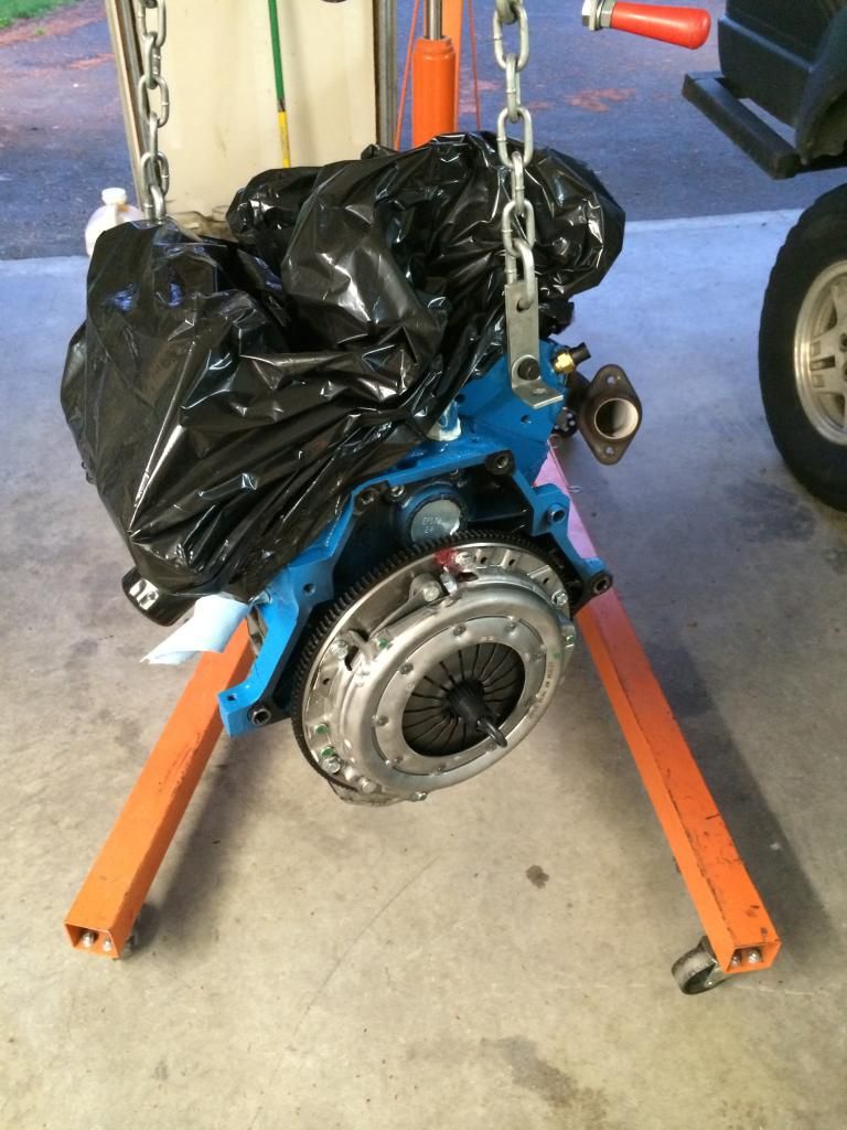

I finished up the engine build, I was not going to get too specific online but the cat is out of the bag...

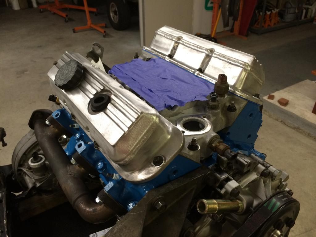

The roller rockers required more height inside the valve cover, luckily I have a plethora of fiero parts and sacrificed a couple sets of valve covers to make one set a quarter inch taller.
f
The valve covers work great and when the time comes I will be building a set for my turbo car as well...
I also installed an adjustable fuel pressure regulator so I had a bit of control over the fueling and could dial it in
I buttoned the engine up and prepared to swap it into the car.
I did the engine swap in about 5 hours working by myself, we estimate that if a major component failed on either my car or the Pontiaxed car we could swap the entire drivetrain in 2 hours or less and keep racing.

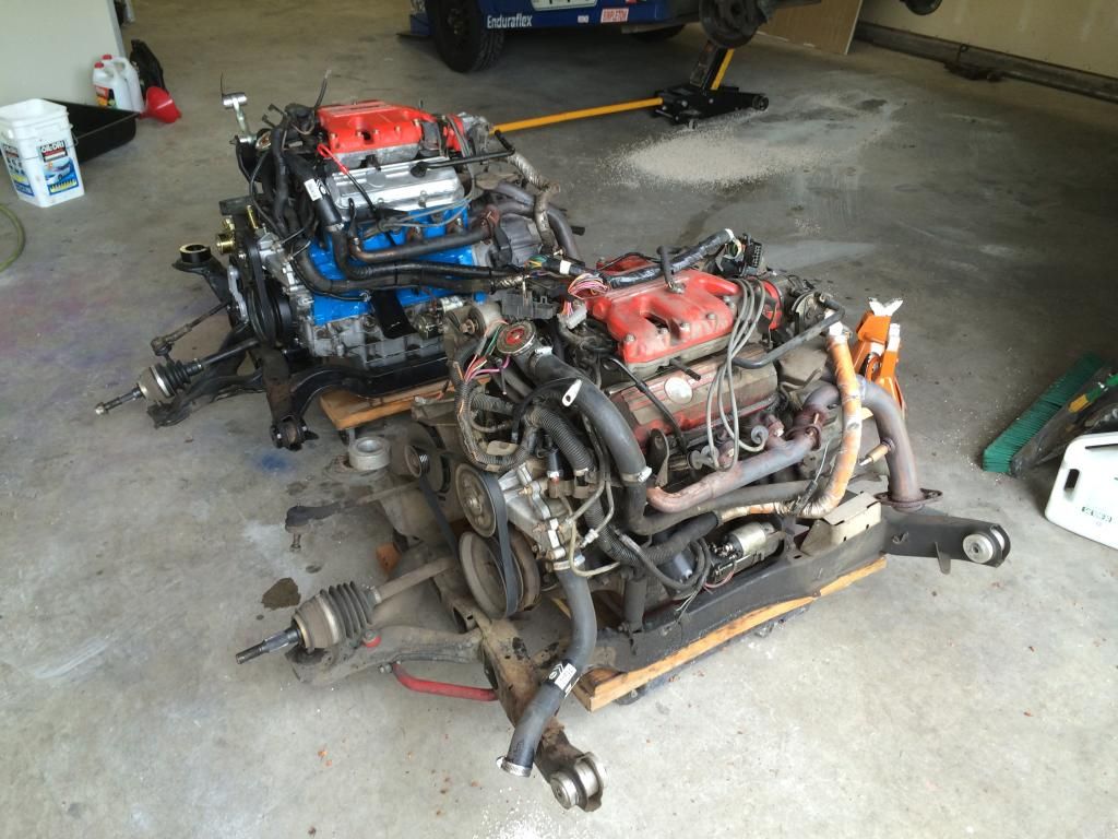

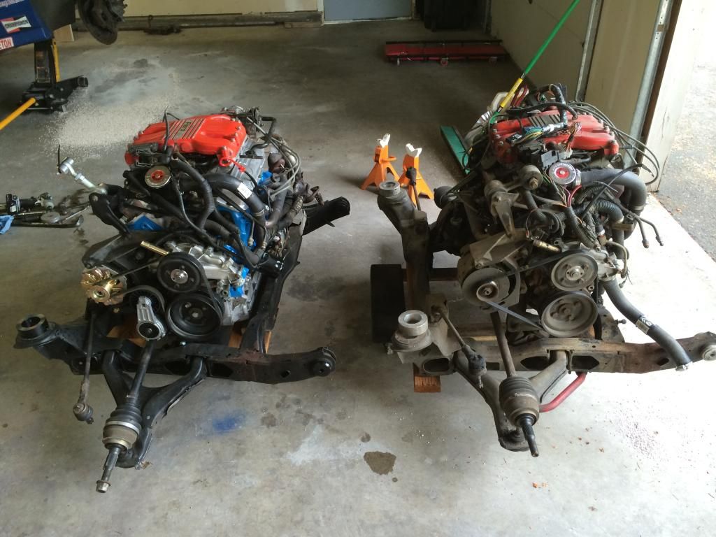

Here is a quick comparison of the old and new drivetrain.
Note the Dodgerunner belt tensioner, a very nice addition to any v6 fiero. Eleminates belt squeal completely and self adjusts for the life of the belt.

The day came, we strapped her down to the dyno and gave her hell, I only got 300 miles on it but you know what they say about breaking in an engine like you plan to drive it...
We are very impressed with the numbers to say the least, we were able to adjust the fuel pressure regulator using the sideband o2 sensor on the dyno and it is running very well on the stock engine management with 19 lb injectors. We also optimized the timing. 166 hp at the wheels and 204 ft lbs of torque is outstanding for a 3400 with fiero intake, exhaust and heads... As for as the intake and exhaust go, we have plans. The engine should give us a bit more...
This test mainly was to prove that we were not leaning out and damaging the engine or anything, it would suck to blow it up next time out.

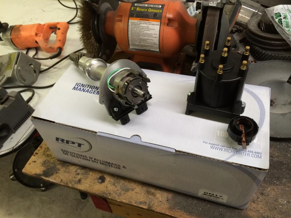

I also took the opportunity to install a new Richporter distributor, our OEM distributors are very ugly and we hope to have a better chance of making it through race weekend with this one. I did reapply the thermal compound to the ICM since it was a little dry, other than that this looks to be a very nice piece and it is all new. Car is running great on it and we hope to not have any issues, I do have a spare OEM ignition coil in case we have issues with this one.
