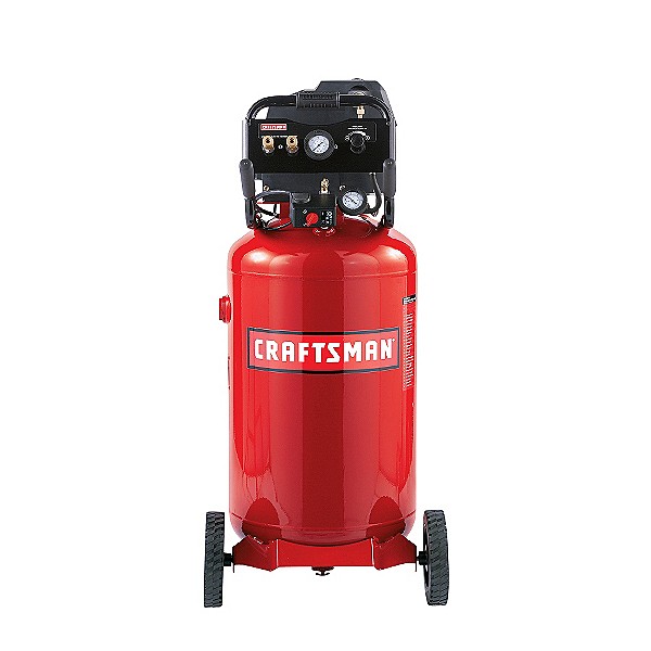

One thing with the blast cab.. they require a *LOT* of air to use.. I have a craftsman 6hp 33 gallon compressor.. and with my blast cab running full bore I can maintain 90lbs of pressure in the tank..
A little pancake compressor or a "portable" one won't be able to keep up with the cab.. you'll find yourself constantly waiting for the compressor to build up pressure again.
Oh.. one other thing.. get a canister line filter and put it as close to the compressor as possible.. I have mine in between the air hose and the blast cab inlet. You'll be surprised how much water that thing will collect (I have another line filter at the compressor too). Water and Alum Oxide (or whatever medium you use) don't mix.

Thanks DataCop, we'll do that. We're setting up the cabinent in my BIL's barn and he has a big compressor, so we should be all set. Thanks for the advice and kind words all.
