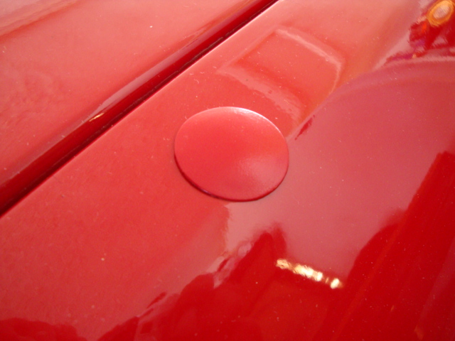

Here's another rather inexpensive mod that I did a while back. I wanted to modernize the look by "deleting" the antenna. But I didn't want to mess around with filling and repainting the fender when the original paint is in such great condition, and I wanted it so that any future owner could still easily revert it back to original status. So I removed the antenna, and bought a plastic plug from the local hardware store. I had to trim the bottom of the plug a little bit, and then I painted it with a GM red that was a close match.
Then I bought a new-style, one piece antenna (I think it cost like $14.00) and mounted it in the trunk area, right above the spare tire. The antenna is insulated from grounding by two small rubber-coated brackets. Then I simply ran the cable through to the radio. Since I have an updated stereo, I no longer needed that to use the adaptor on the original old antenna cable.

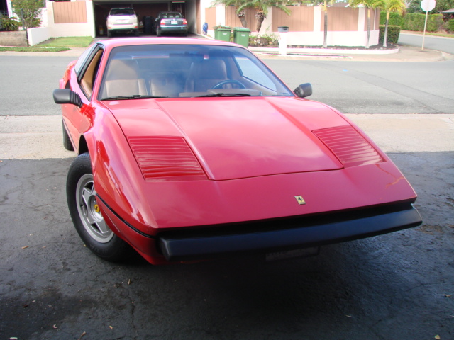

From this distance, you cannot even tell the antenna was there. I think it just gives the Mera a simpler, cleaner look without the antenna. (This is an older pic where I still had the Ferrari nose badge and wheel center caps.)
And if the next owner wants to put the original antenna back in, all he needs to do is remove the plug and screw the original antenna back in. FM reception through the hood is still okay, at least for the channels I like. I mostly listen to CDs anyways, so reception is not a real issue.
