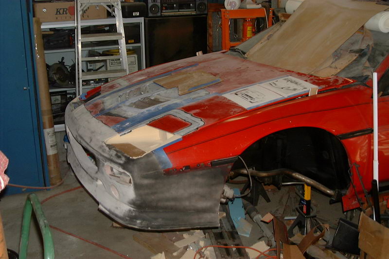

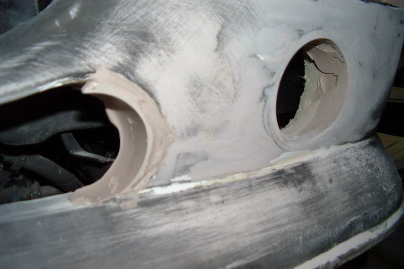

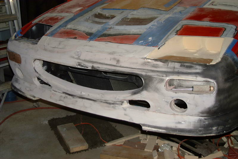

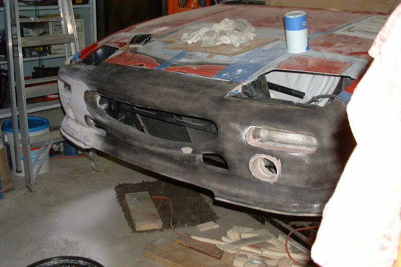

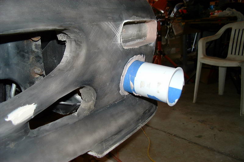

Update: Started reshaping the light fittings and the bottom vents so that they are round, not psuedo eyeballed. Used a cake frosting container as a mold.
Used a slightly smaller container for the vents.
And lots more sanding.
It bothered me the way the headlights had worked out previously, so I thought I'd give it another try.
Any thoughts? Suggestions?
Bob

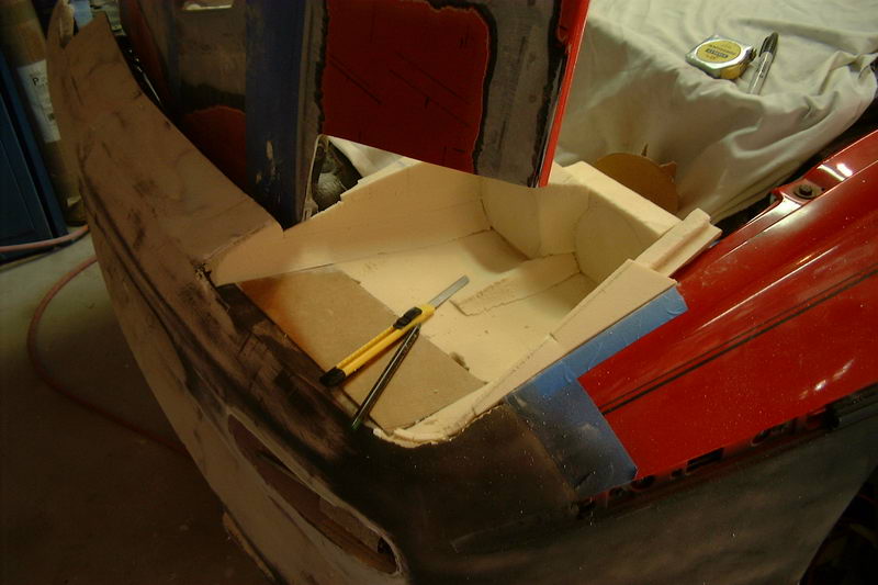

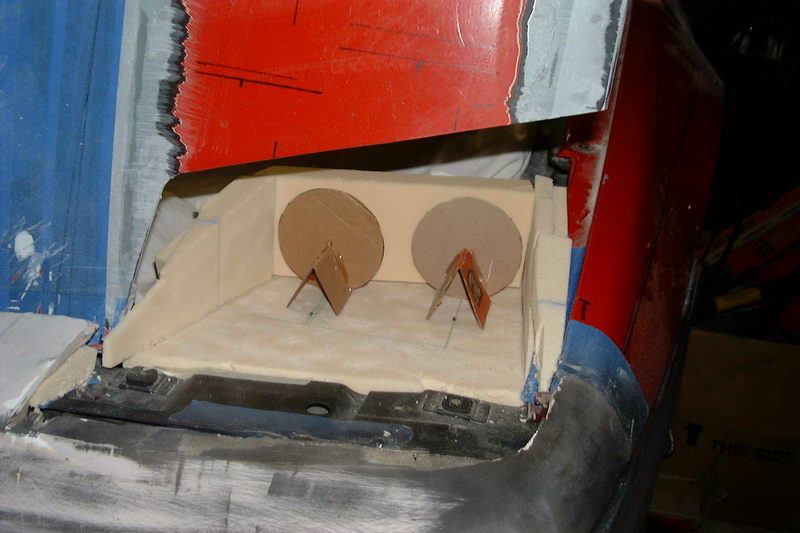

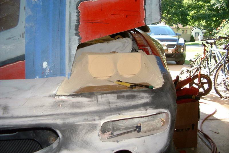

Well, since you asked... It just looks like to me that the nose with the integral headlight buckets wil be a problem to install. The front most fender bolts are obscured by the headlight buckets. If I might suggest:
 Making the headlight buckets separate from the nose, maybe along the black line, and making an overlap joint for them to mate to the nose, (like shown in section A-A) Use the forward vertical edge of the fender as the location for the horizontal joint line. That carries the natural body line over to the assembly you're making.
Just my $0.02 worth..
My only other suggestion would be to hurry up and finish this amazing piece of work, make some molds, then parts, and allow me to be your first customer! I like what I see here...A LOT![This message has been edited by randye (edited 09-19-2009).]
RCR
SEP 20, 07:19 AM
Randye: Thanks for taking the time to draw that up...To be honest, I did go over that scenario a dozen times. The issue I preceive is the seam. I didn't want the seam under the lens, and sealing the lens is that more difficult if the bezel is multiple pieces. I have the same problem If I try sealing the lens to the fascia at the front lip.
Food for thought though... As for mounting, I was thinking of adding a point that goes through the fender, up above the bezel.
Bob[This message has been edited by RCR (edited 09-20-2009).]

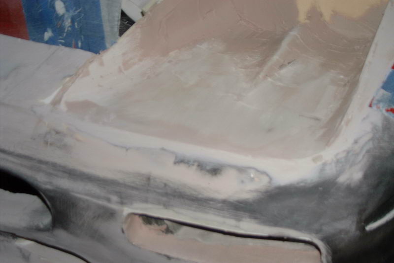

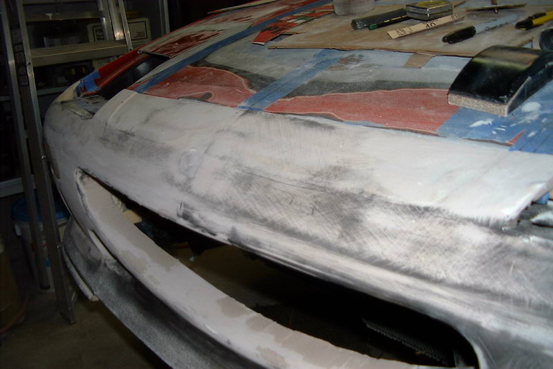

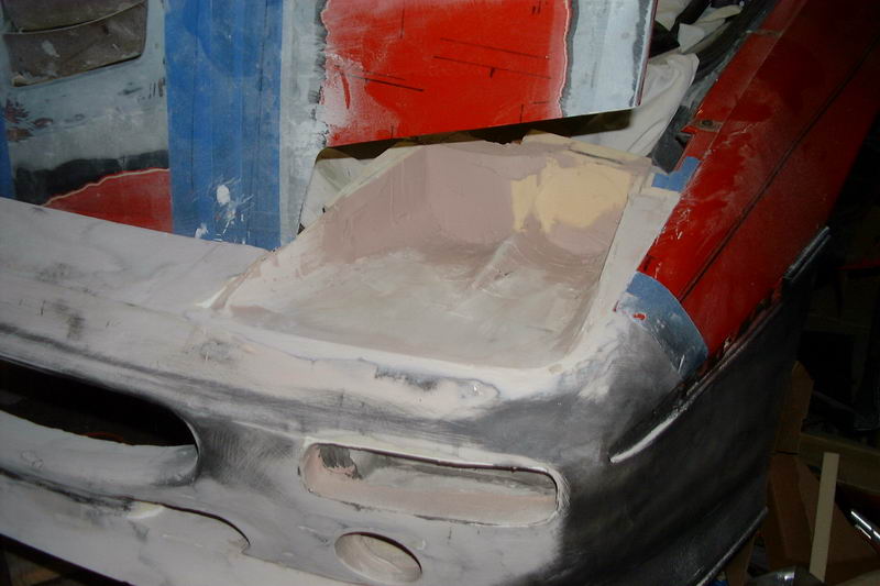

little update...Been filling and sanding the new headlight pod. Lot's more to do.
I think I've figured a way to do either a one piece nose that integrates the pods, or seperate it right at the seam. This picture shows the bottom seam after sanding. The seam is about 1/4" above the body line. I plan on routering the edge down to the body line. This will give me a lip to mount the lens that goes right to the edge of the body line. The depth will be about 3/16 or the thickness of the Lexan. If I want to seperate the pieces, it will be done right at the body line. At least that's how it will work in my head.
