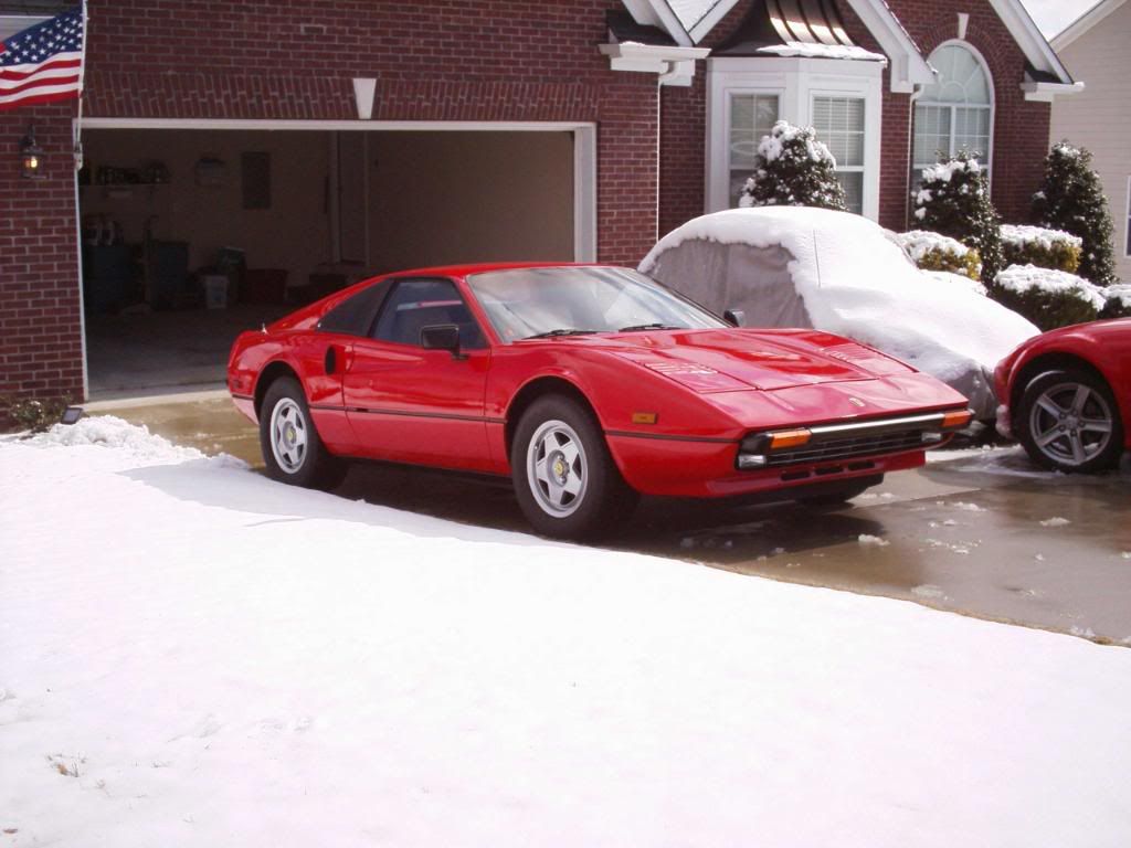

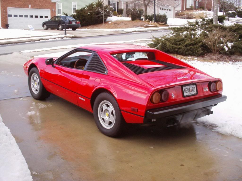

Its been a while since I posted any pictures of my Mera and I was in the mood today so what the heck.
My solution to the lowering issue was to just use a slightly taller tire. I fills in the wheel wells nice.
hnthomps FEB 15, 05:15 PM
I also use 60 series tires on my F308 rebody and it works fairly well on a 15 inch rim.
Nelson

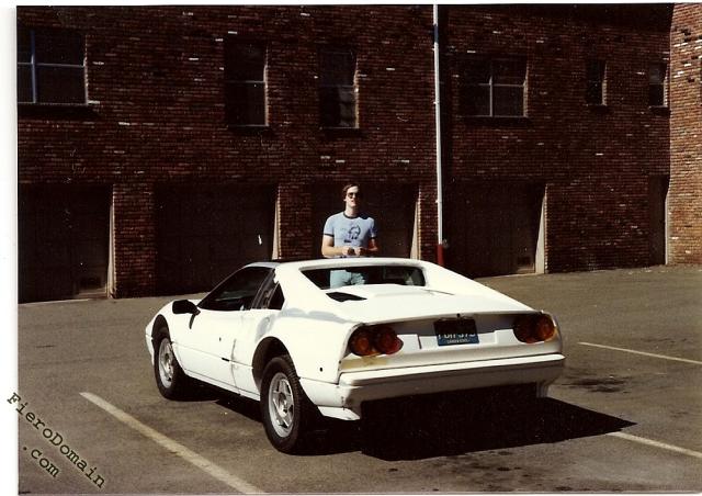

batousai666 FEB 16, 02:42 PM
01-05-2008 01:57 PM
The wheels are the Cromodora wheels that were on the 1988 Meras. Jim Sutter bought up all remaining stock. Tires are 245/50R15 front, 265/50R15 rear. The front light cluster (driving lights/parking lights/turn signals) are OEM Ferrari parts, as are the side markers (all removed in these photos to make sanding easier. Tail lights are Mera surplus. The back-up lights are in the lower rear grillwork.

Summer/fall 1990. Here I am keeping 3M stock prices up by going through a LOT of 220 and 400 grit sandpaper. The fiberglass was good, but like all fiberglass body parts, there were pinholes.
1) Apply putty
2) Sand
3) Repeat
