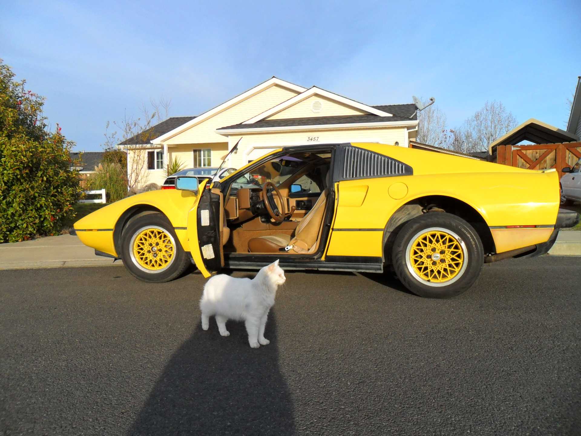

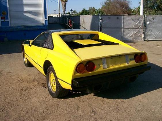

The sills on my 1987 MERA were painted a GM black (similar to what was applied to the inner door frame) although the donor Fiero color was a metallic red. The picture below is the best I have.

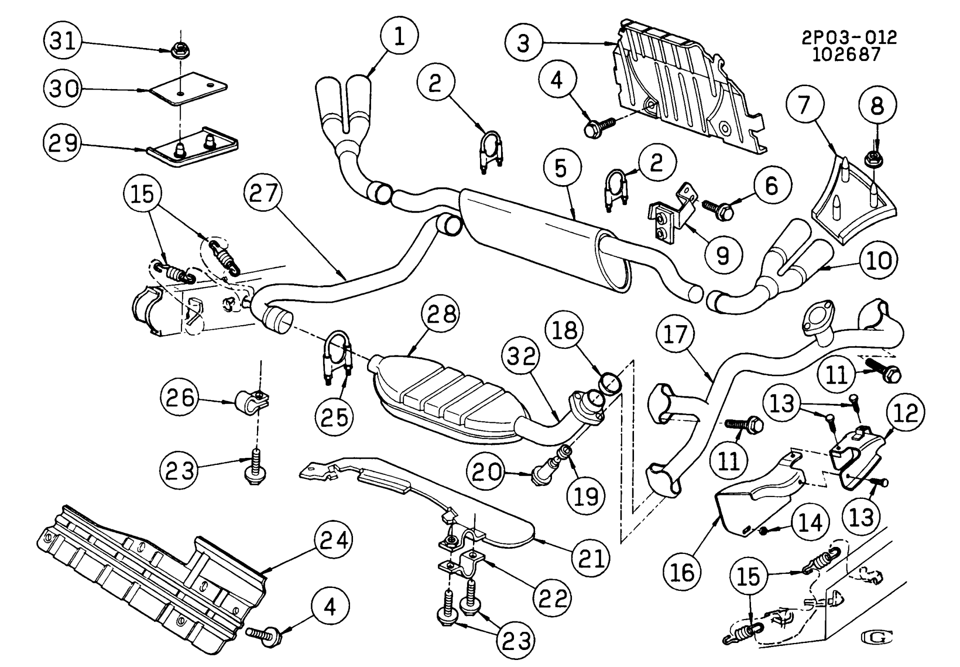

Here's the parts diagram for the V6 exhaust.

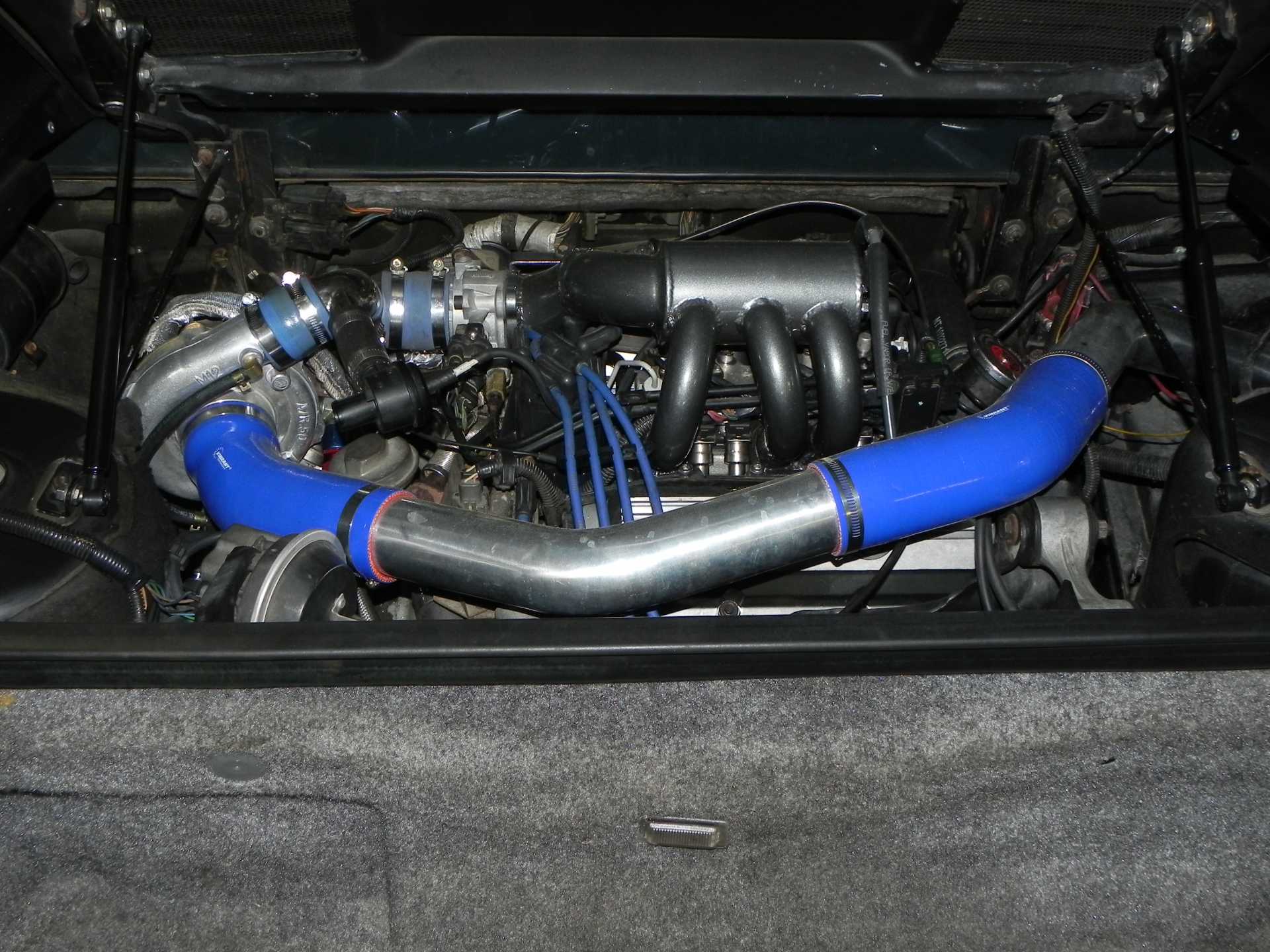

What Rodney sells are the Mera equivalent of parts 1 and 10 on the exhaust system diagram. They need to be specially shaped to fit through the Mera bumper. I am not very familiar with the Miller Woods turbo setup, but do know that my 3.4 push rod turbo Mera (1987) did not have any exhaust system mods around the muffler area. This is what the engine side of my turbo setup looks.

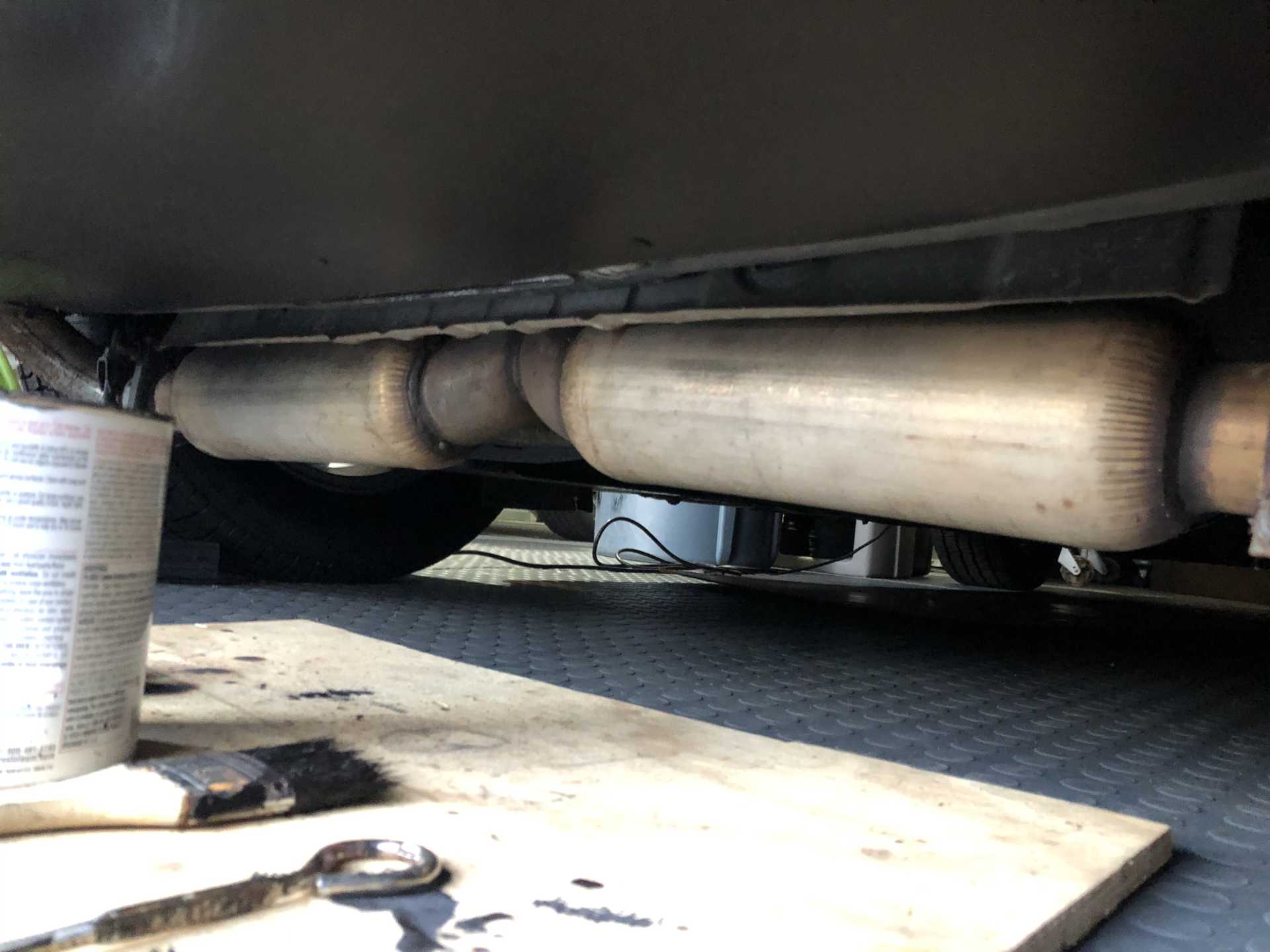

Texture? Or smooth. I have areas that have a rough surface, and some smooth areas....
Also: I don’t think my exhaust is stock. It doesn’t look like the schematic, unless 88s were different[This message has been edited by swing69 (edited 03-05-2021).]

You are correct, most/all of your exhaust is not a stock Fiero assembly, and does not have the MERA tailpipes as illustrated in Larry's earlier post.

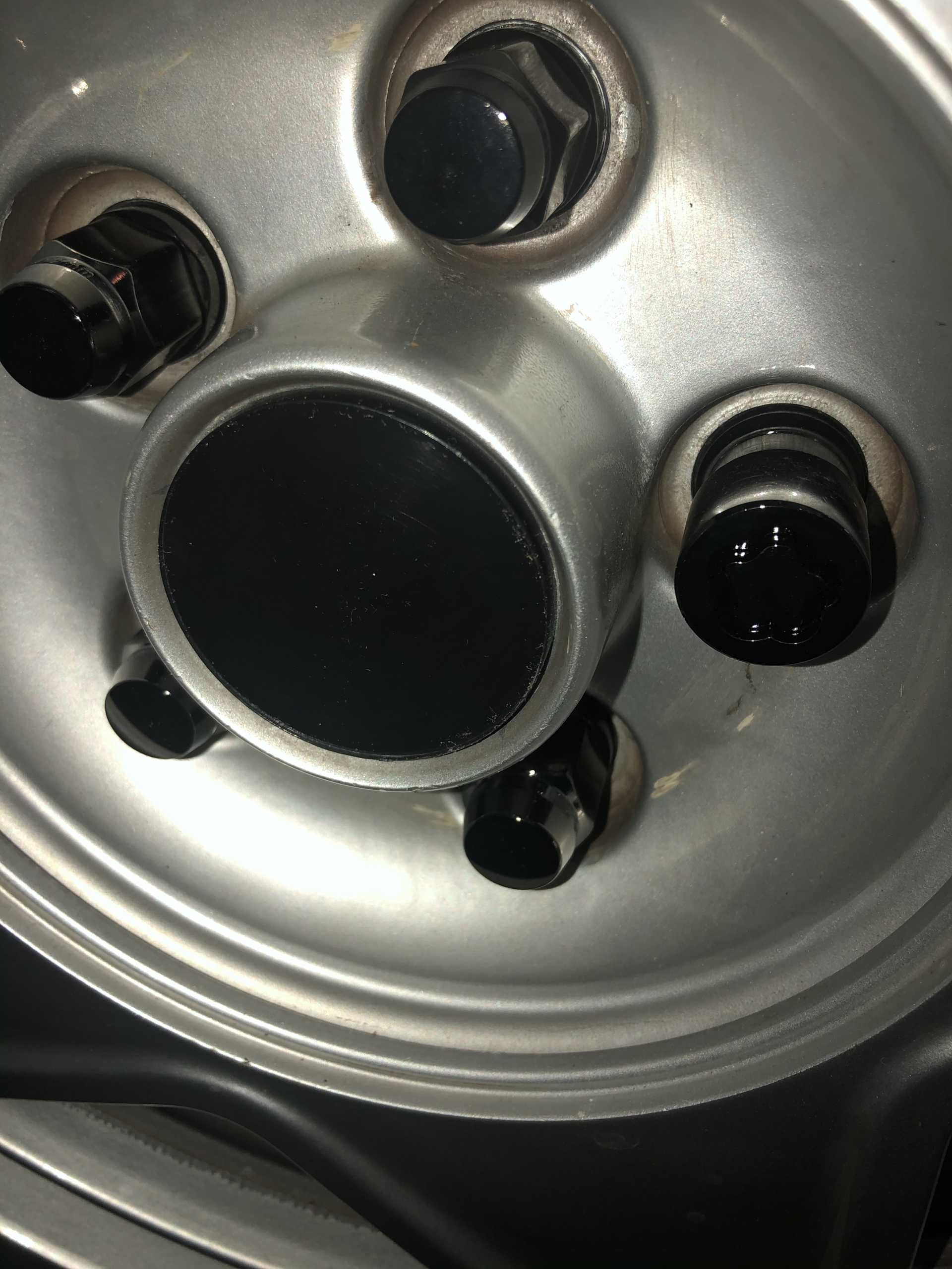

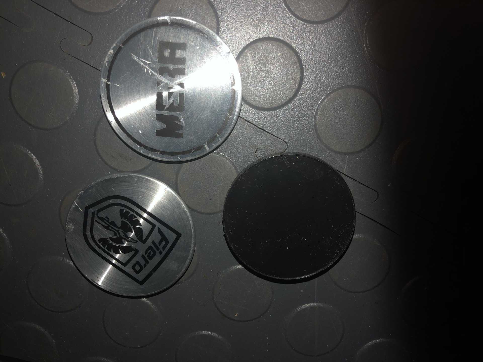

 [img]http://images.fieroforum.com/userimages/swing69/060 2C67B-7CCC-432B-8DCC-978635B7905B.jpeg[/img]I bought some black plastic centers to make some custom centers for the Chromadoras. The ID is right, OD slightly smaller.
Also swapped out chrome lugs for black Mcgards. If you do this, seap out the lug wrench as mcgards are smaller than the stock lug nuts!
Also: under the MERA stickers of the stock ones were MERA and Fiero transfers. I guess 87-88 centers of stock Fiero and MERA wheels are the same[This message has been edited by swing69 (edited 03-06-2021).]

If you are speaking of the stock wheels on a Mera you are correct. The Chromadoras were an option in 1988 and the small center cap is slightly different than the stock diamond pattern wheel. If you are in a hurry, silicone will keep the small stock centers locked in place for quite a while.
