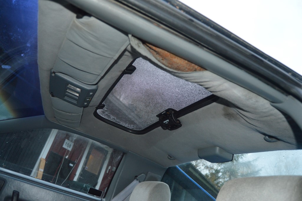

I took some photo of it yesterday, I probably should post it, not very nice..
Repulsiv OCT 18, 03:36 PM
This is how it look like, it actually look better in the photo..

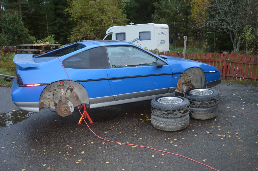

..And this is how the car look right now..
I booked a time witth he tyre-guy next week (thursday), thats why the wheels are off, and I will try to change oil and filter before that.. then I might be able to do a (illegal) testdrive, becaue I haven't driven the car at all yet..
I also talked to my dad on phone today, and asked him about the gearbox, he said it was NOT that hard to shift before, so probably some oil in the right places will fix it.. I sprayed 5-56 on the joints I could see, hope it will work.. otherwise I have to do something more serious.
