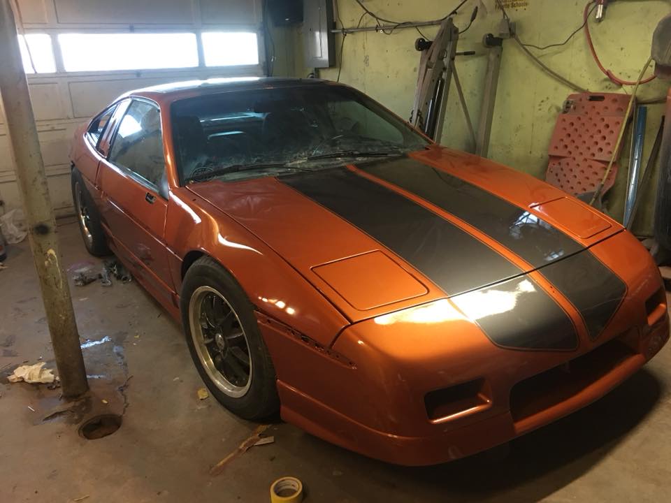

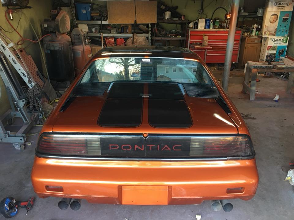

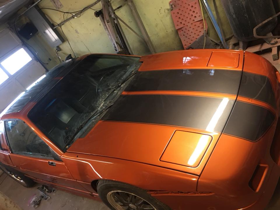

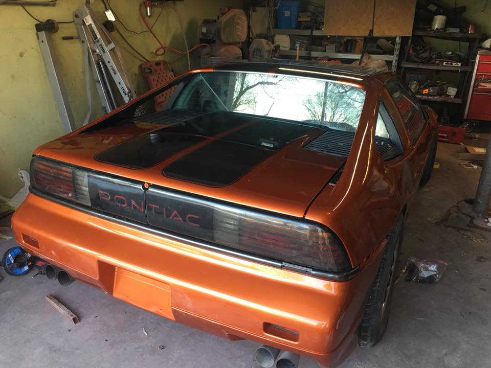

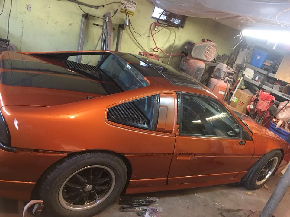

Not to get off Topic but while the car is back at SCHWA Motorsports with the owner, I moved on to Marty's car. It is an 86 SE converted to GT, It obtained some damage from a parking lot accident. With the Insurance Check he brought the car to me for an overall body restoration. I did a Full Panel off like I do with everything that comes in the shop. I thought the car was in decent shape when it came in but looks can be deceiving.

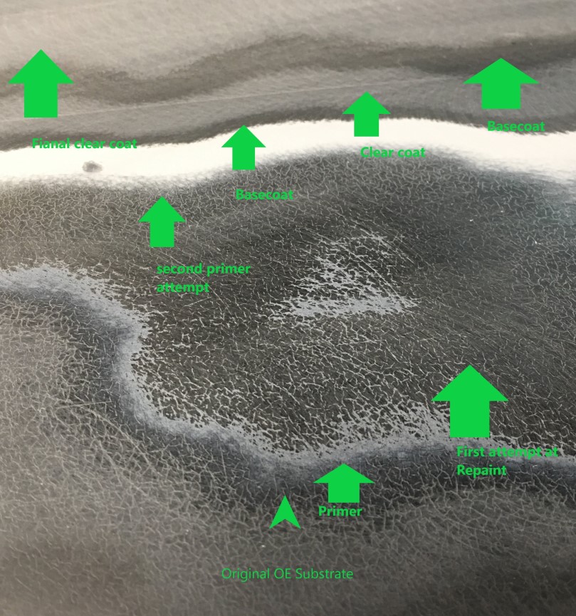

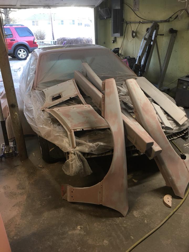

Once I Got it disassembled I started in hard and heavy on the prepwork and this is what I uncovered
Looking at this picture this is what I can only assume what happened. The original paint started to chicken scratch and delaminate. The owner who apparently had very minimal to no experience decided to just buzz and prime. Low and behold it came through the paint. Rinse and repeat, and repeat.
Very poor workmanship in my opinion. Me being the perfectionist that I am I knew that I had to take all the existing material down to at least OE sealer. Just a side note Covering the problem will not fix it :/.
I then Primed and blocked. Repeated a few troubling areas that popped up after blocking
320 Dry block then up to 600 wet block for a pristine Finish

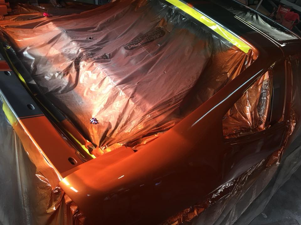

And now for the fun part
I am using all GM colors, starburst orange from the corvette and a Charcoal with a bronze Metallic.
I laid out my stripes and painting the side trim the charcoal.
Still in the process of putting it together but its looking great so far.

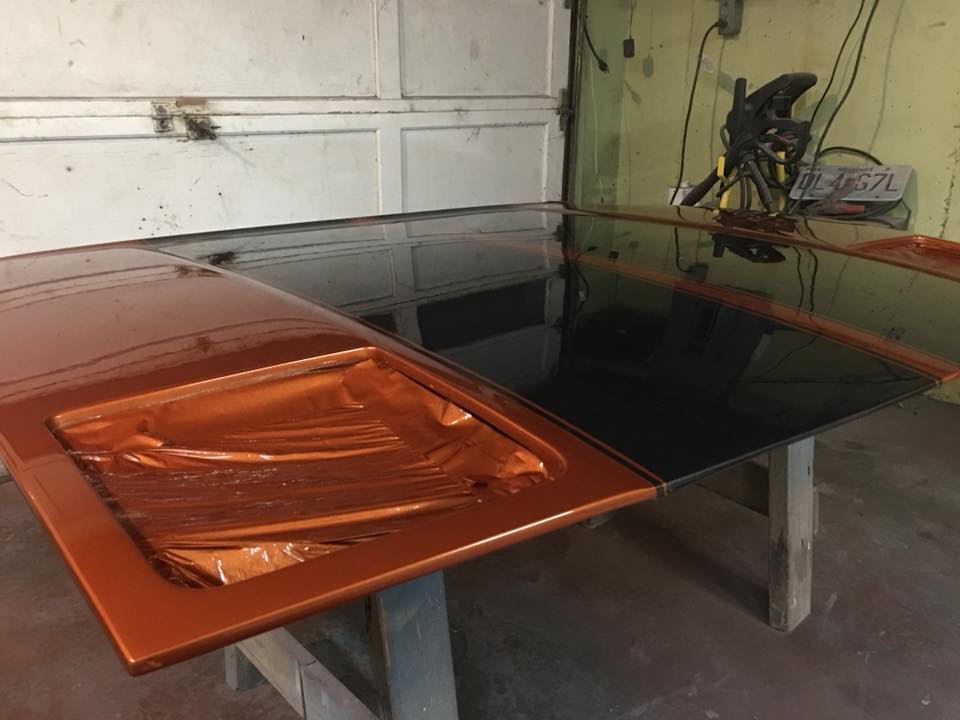

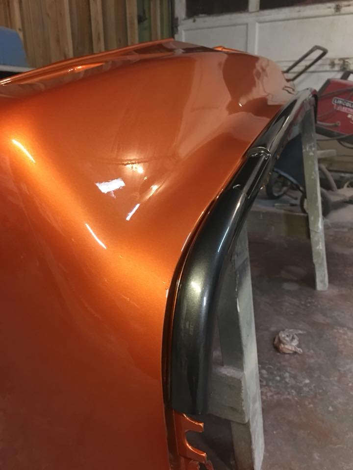

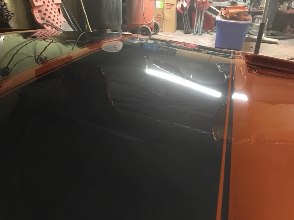

AWautoworks FEB 09, 04:44 PM
I need to get some opinions on the inner sails. The questions is should i paint the inner sails orange to match? I will be painting the vents the Iridum Gray Metallic as well so keep that in mind
