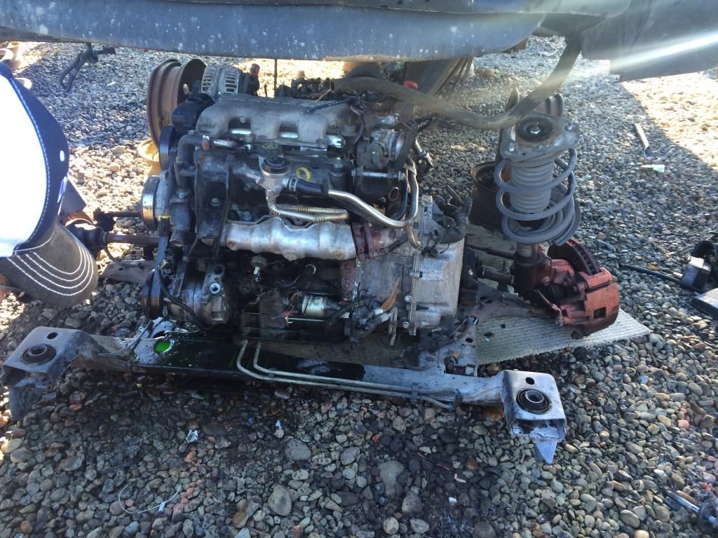

Last but not least, we spend the day pulling a 3400 out of a 2000 Pontiac Montana. The stock drivetrain held together but we are hesitant to push it too much more for fear of having some major problems at the next race. This engine will let us start fresh and should give us a nice bump in power as well as be dead reliable. The roller cam will be much better for endurance racing.

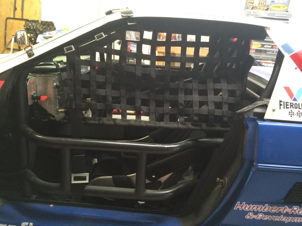

One of the issues we had at tech inspection during our first race was the hole at the front of the window net. I talked with seatbeltsolutions.com at the SEMA auto show and the agreed to make me a custom Fiero window net. I think it turned out very well and don't see us having any issues with it in the future.

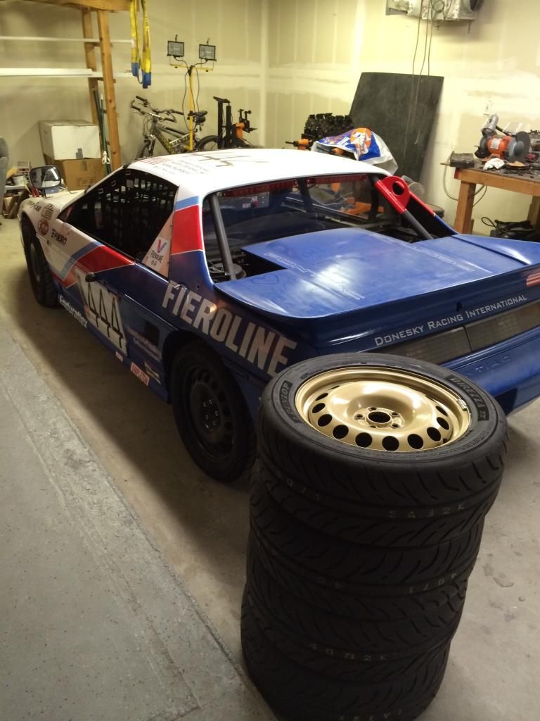

Last weekend I was going to autocross my red car but Justin Parcher with Team Pontiaxed convinced me to take the race car and Im glad I did! I had just gotten the car out of storage and it was nice to get it out and stretch Miss Fierolines legs a little.
Backing both ladies out of the shop bright and early Sunday morning.

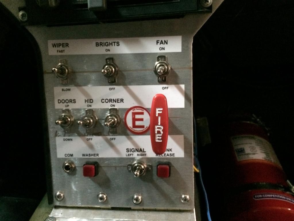

The next requirement to make the car legal this year is fire suppression. I finally received the equipment and wasted no time getting it installed.
It installed very easily but I did need to order more tubing, the 17 feet it came with were not quite enough.

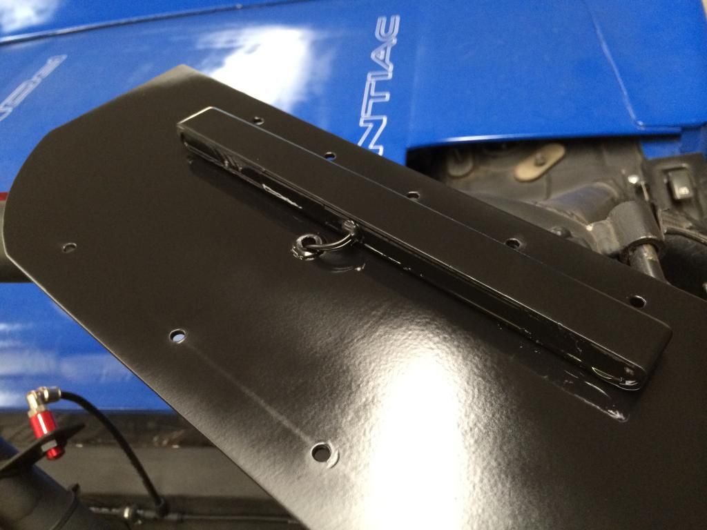

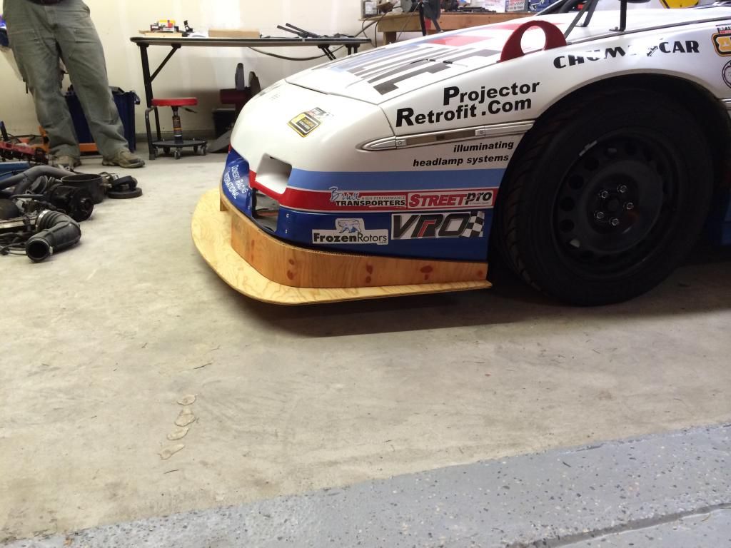

The co-owner of the car wanted to work on the aero a bit, this is the first attempt at a front splitter/spoiler, this in conjunction with a big extractor vent on the hood should help stabilize the front end of the car. We hope to refine it and develop it as we keep racing.

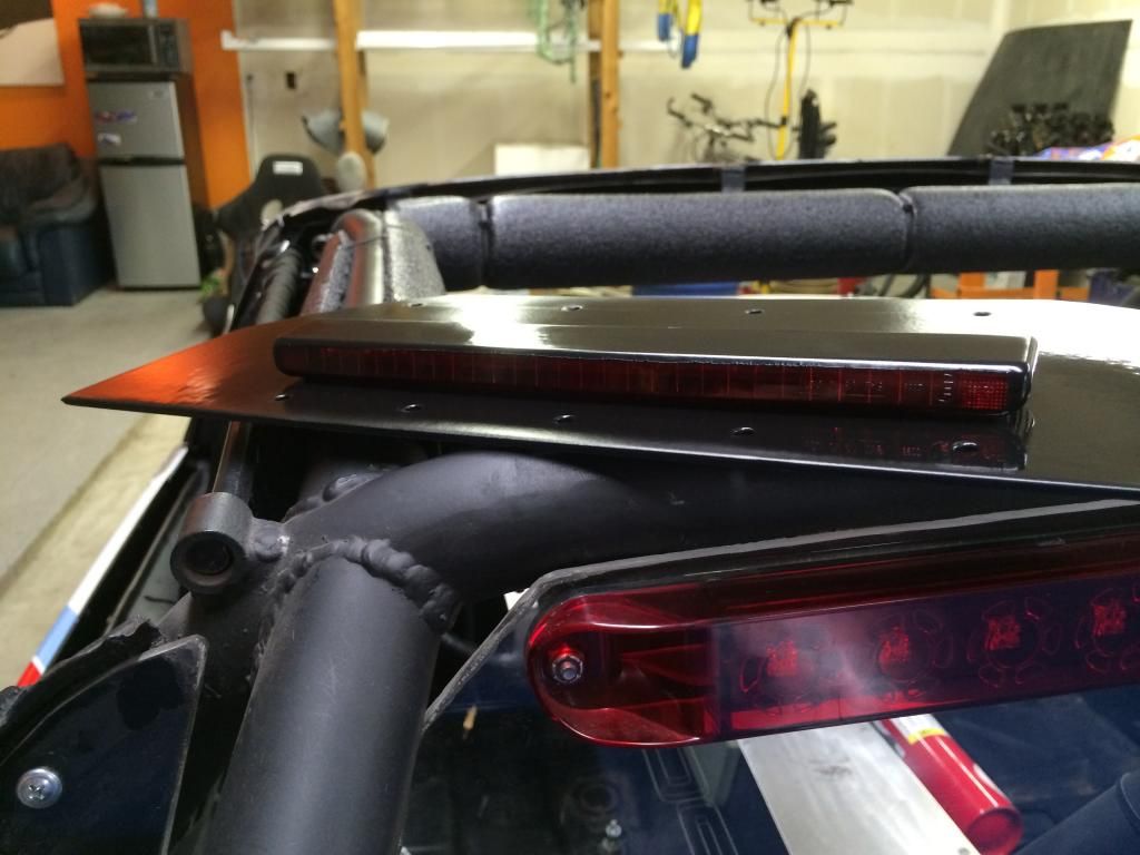

The last new mod for this season is a master caution light. Team Pontiaxed and I dreamed this up after watching them lose an engine to oil pressure when the light was illuminating twice a lap for the last half of the race. We decided that when driving in a race it is easy to focus on the surroundings and possibly miss the glow of the oil light or temperature light. This big red LED will illuminate when either the oil light comes on or the temp light comes on. I am also working on modifying the shift programming in the ECU and running this light through a rapid flasher to communicate the need to shift if a driver forgets (like I did when I got too excited passing a BMW on the front straight). I think this is an innovative addition and should be unmissable to the driver and hopefully save an engine and possibly a race weekend. I will keep everyone updated on how this goes and there should be plenty of footage of the shift light function working after the race, hopefully the other functions never trigger.
The light will be positioned right over the gages in the direct sight of the driver, when it illuminates it will be very bright and my drivers will be able to figure out very quickly what is wrong and if it is an oil pressure issue will shut down immediately and get towed in, if it is temp they can manually trigger the fan and probably make it back to the pits without doing any major damage.
Should have more this weekend as I rework the harness situation as well as paint and finalize the front splitter and complete the master caution light. Stay Tuned!
