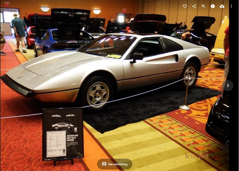

I went to the 35th Anniversary Show with the hope that someone would bring another Mera. Mine is the only one I have seen. The current owner of the 1986 prototype brought it to the show. I got to meet Drew, very nice guy and helped him push it out of the Poncho Perfection Hall of Fieros at the end of the show. He is doing a great job of taking care of it.
[This message has been edited by Larryinkc (edited 08-13-2018).]
solotwo AUG 13, 03:28 PM
My wife had not seen a Mera before. So at the show there were 2. Now that she has, on the way home, half of the 5-1/2 hour trip were questions about the Mera. LOL
