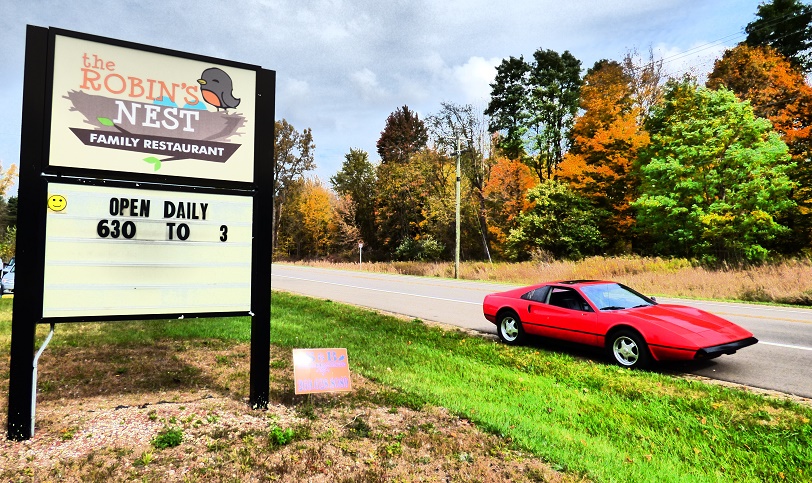

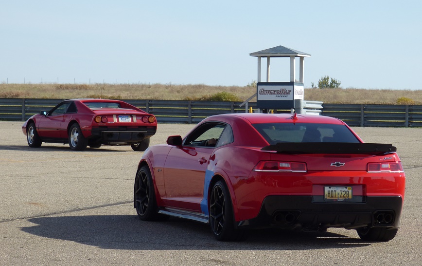

ye ole OP, Fiero In Paradise....Tommy, of get a kick out of this
found this coming back from Gingerman Raceway. did not track it.....which is kinda sad but, I did take tons of pics
