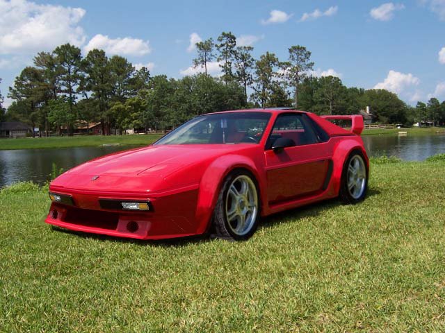

Rn2016 NOV 22, 09:05 AM
Originally posted by mera7:
this was done by another pff member and i like it. BMW M1 look
Are there more pictures of this car?

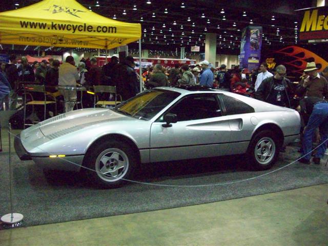

I say fake cuz there is only one 1986 Pontiac Mera..... this one
We hooked up once loooong ago \m/ good times!!

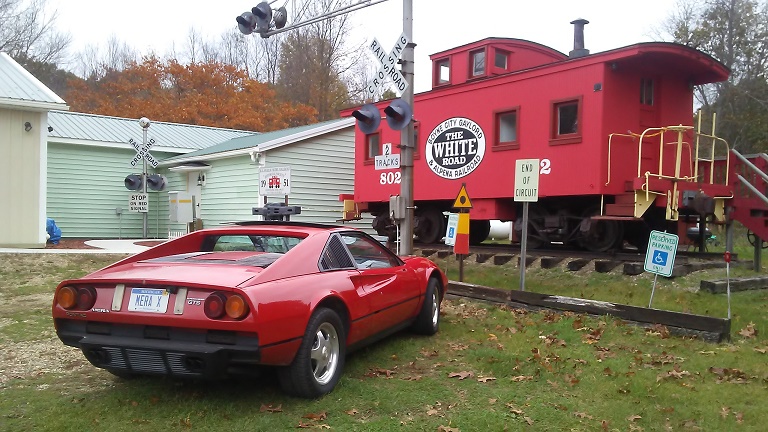

time to catch up.......lets see where did I leave off last??
broke it again. crank sensor??? not my fault, per se this time, eh? getting worked on this week hopefully.
ran over 1330 miles in 2 1/2 months. .......wish it worked now....its still warm(er) up here and we aint had any snow yet.....which is weird. thank the stars global warming is a myth.....i'd be getting worried after last years heat wave winter. \m/
this pic was taken at my Grandparents old house .........sweet!!!

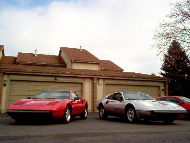

ye ole OP, Fiero In Paradise....Tommy, would get a kick out of this
found this coming back from Gingerman Raceway. did not track it.....which is kinda sad but, I did take tons of pics
