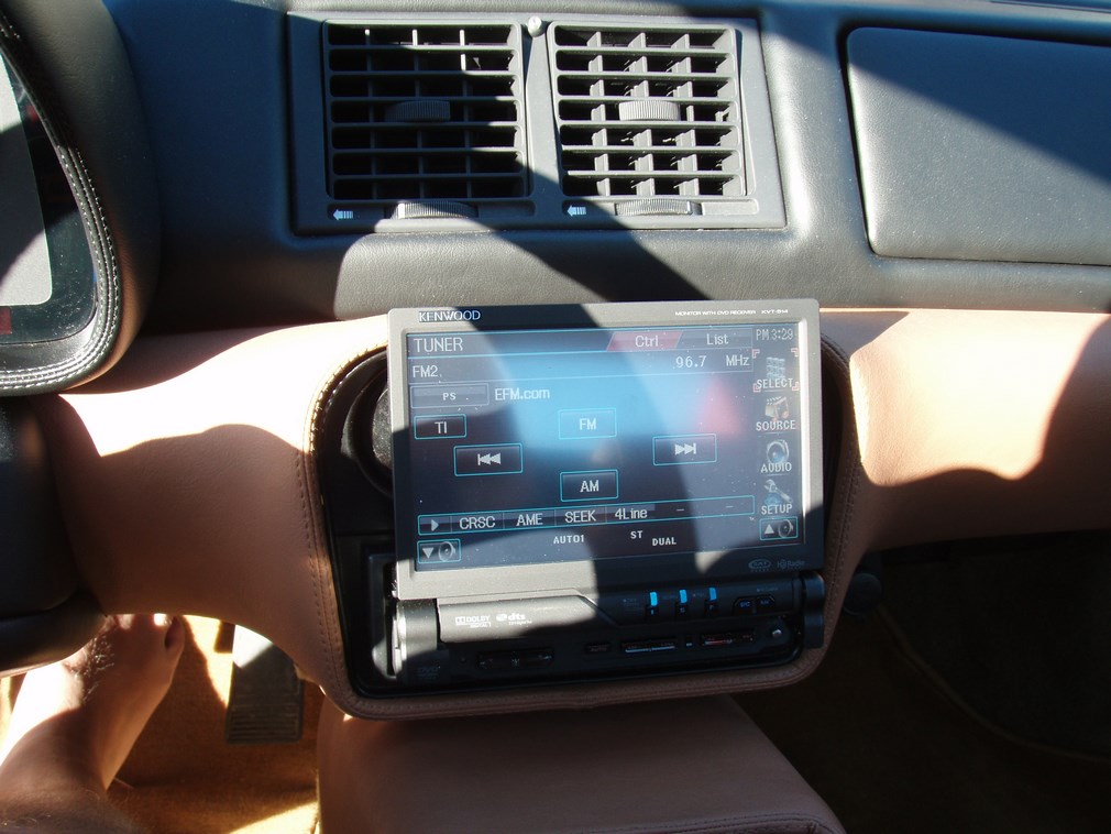

I have a Kenwood7" pop up screen installed in an 88 Mera that is my prime show car. I will be happy to supply the model number if you wish, but it is several years old and likely no longer in production. The other 88 will get a Pyle pop up head unit and I should be ordering it this weekend. I also have a rear camera connected to the head unit and can use it as a rear view mirror during the day or night.
These are not the best photos but will give you an idea how the pop up screen looks in a modern Mera interior.
BTW, the Pyle head unit will go in a stock interior 88 Mera that I am restoring.
Nelson
VanGTP5000 SEP 13, 08:36 PM
Is it the KVT-514?
hnthomps SEP 14, 08:39 AM
Originally posted by VanGTP5000:
Is it the KVT-514?
Yes it is and I added the NAV module (KNA G510) as well as a full time rear view camera.
Nelson
