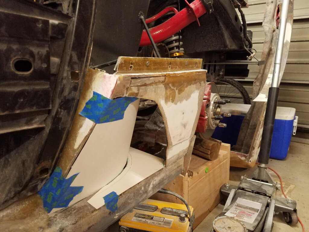

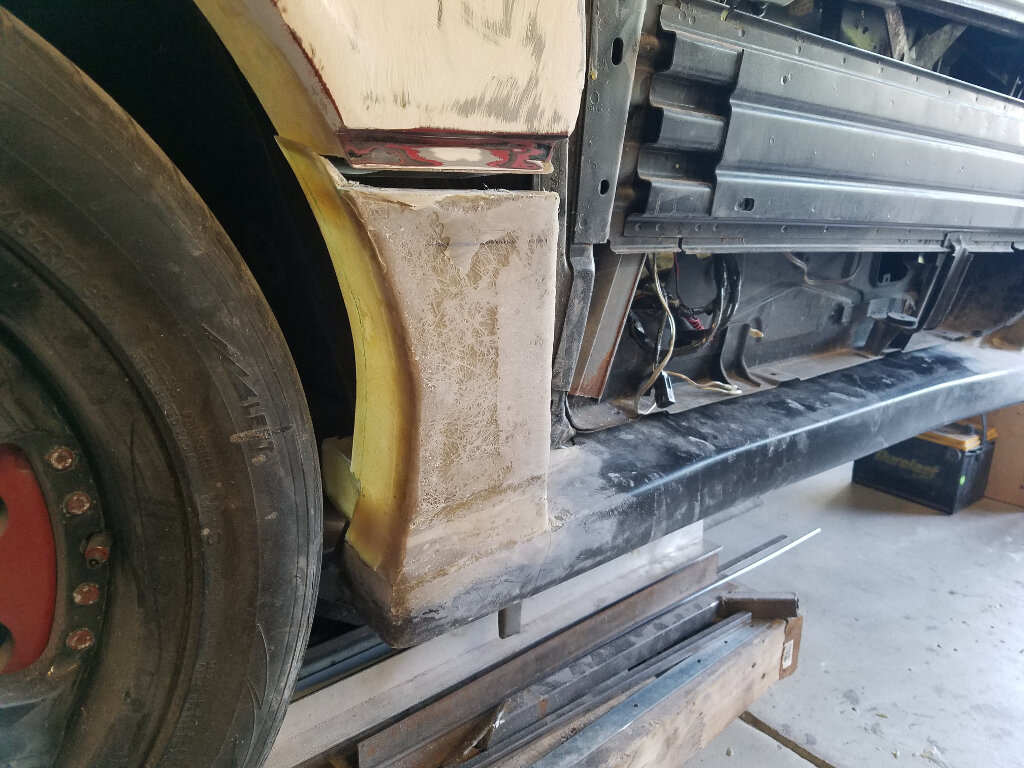

The long weekend afforded a lot of time for the car, so I continued with the rocker build.
First, break out the cardboard and make templates.

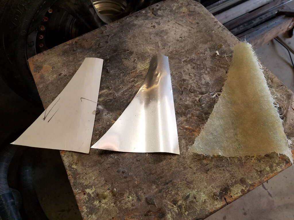

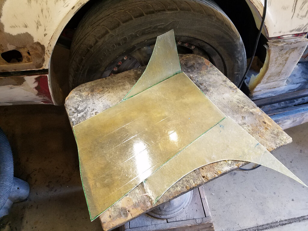

Make a glass panel (on glass)
Cut out the pieces.

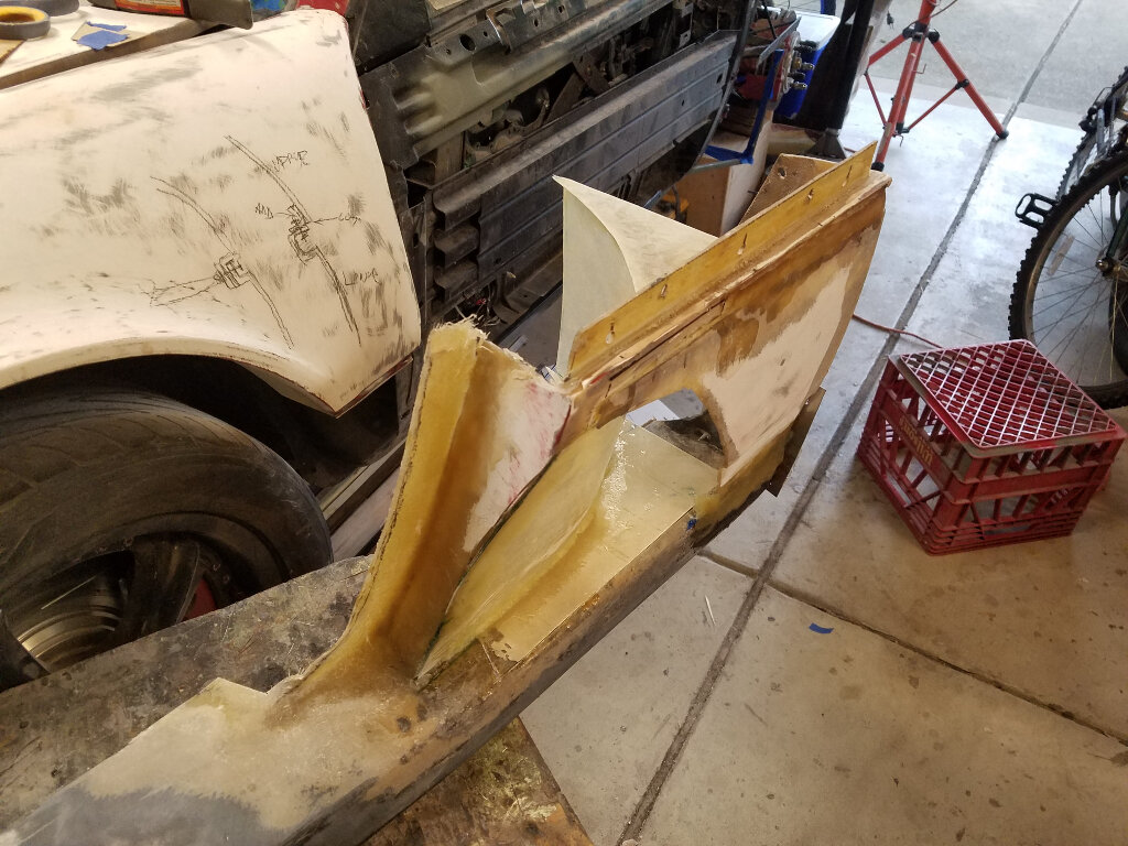

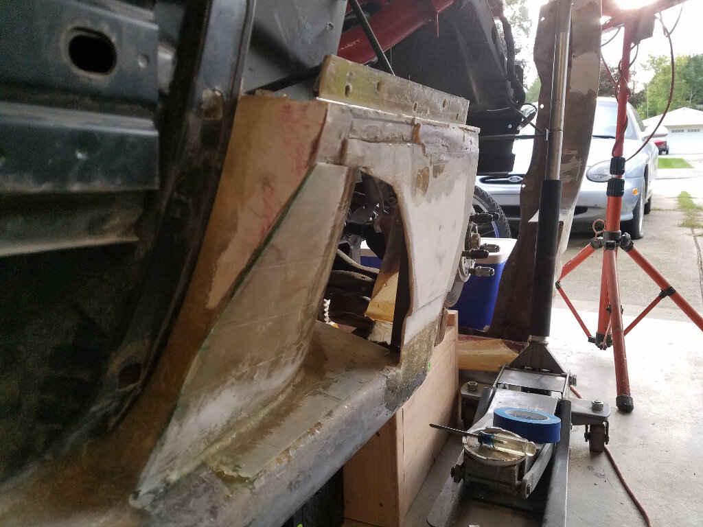

Doesn't show here, but I glassed the leading edge first, then started fitting it together.

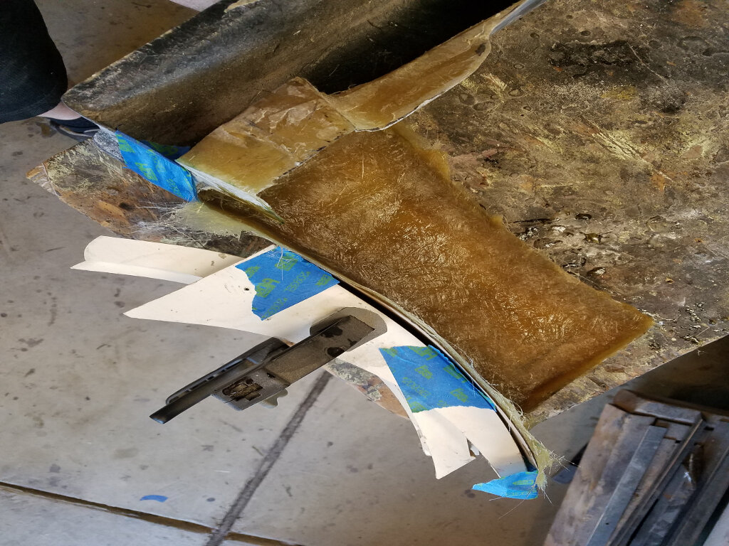

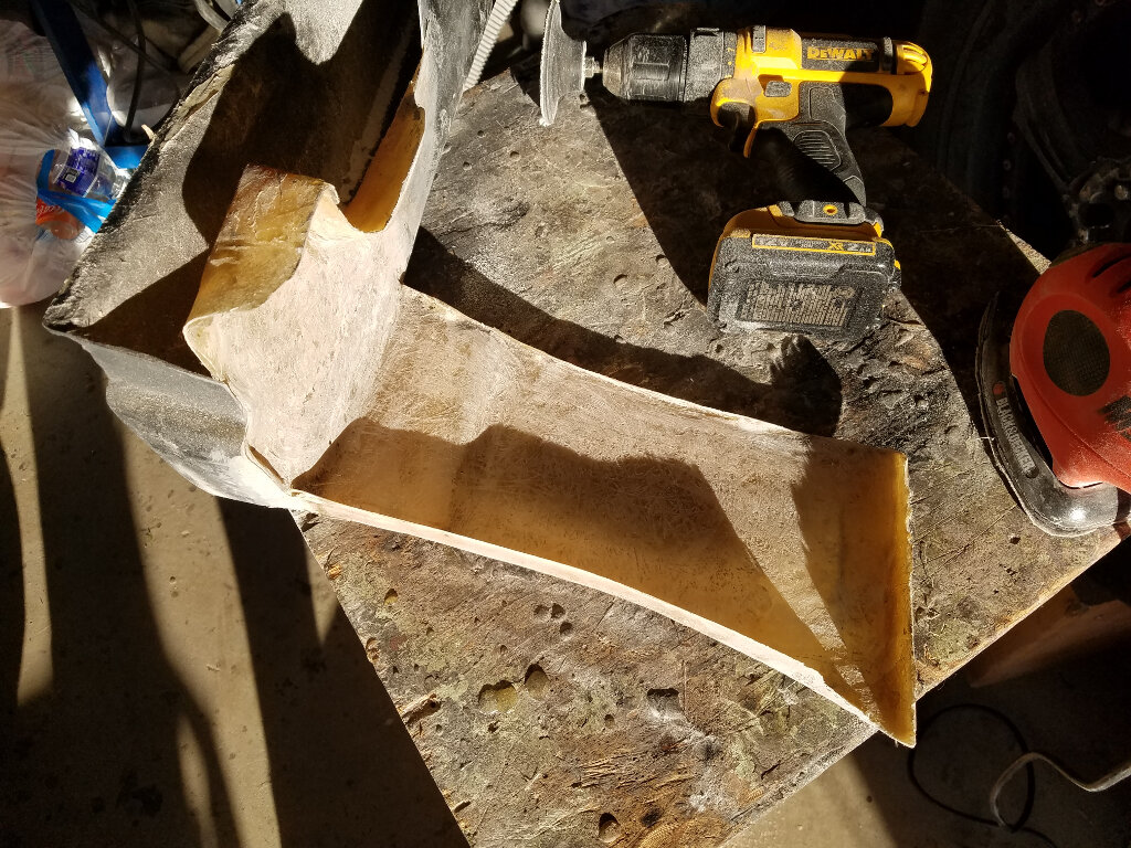

3 sides glassed together, now for the side that runs on the inside of the scoop outer panel. This piece has a s shape to it, so I made a cardboard template, transfered that to aluminum, then formed the s-bend. A layer of glass later...

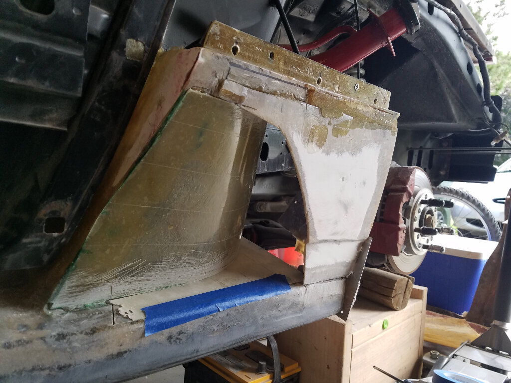

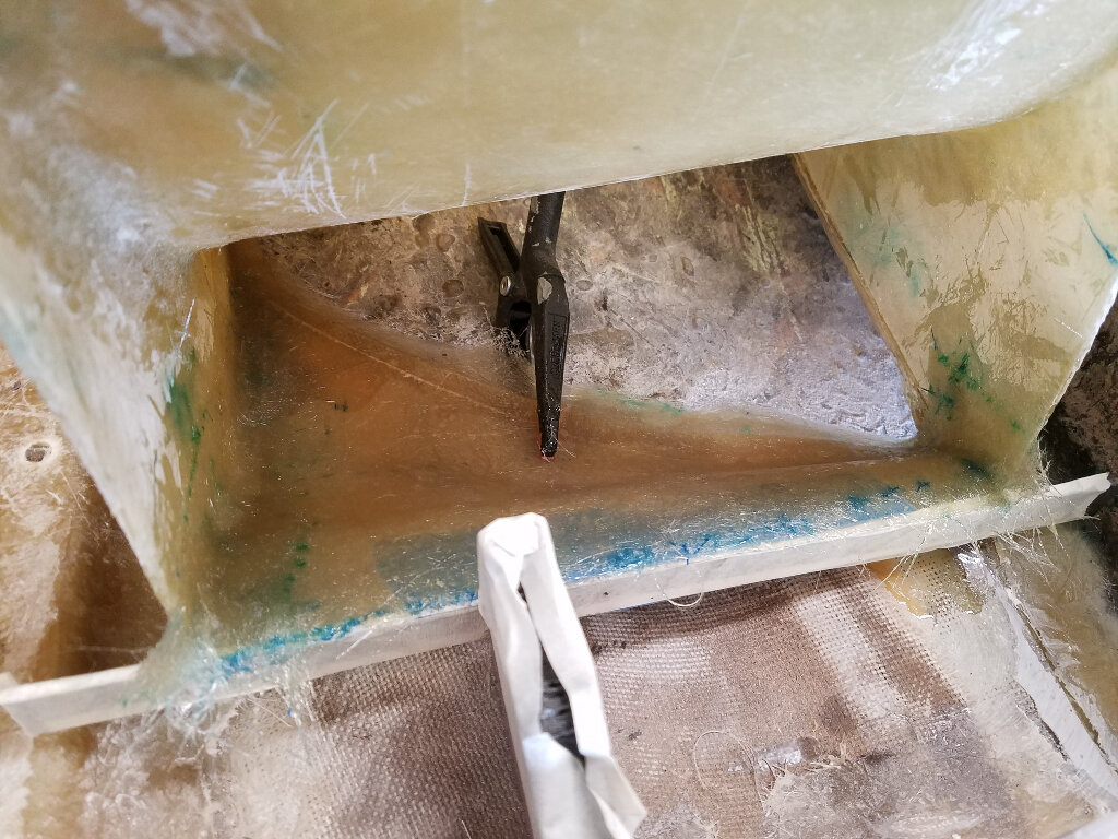

Here, the piece is being glassed into the vent.
Once tied together, 2 more layers added behind to strengthen everything up

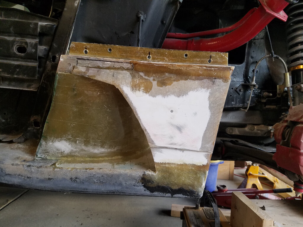

... I started back up on the front of the rocker. This piece has always been rough, since I made it from scratch after losing the original lower fender piece. I cleand it up with the grinder, then started adding some layers, including the wheel well flange.
I boogered up the mounting flange, so i'm in the process of redoing that.
