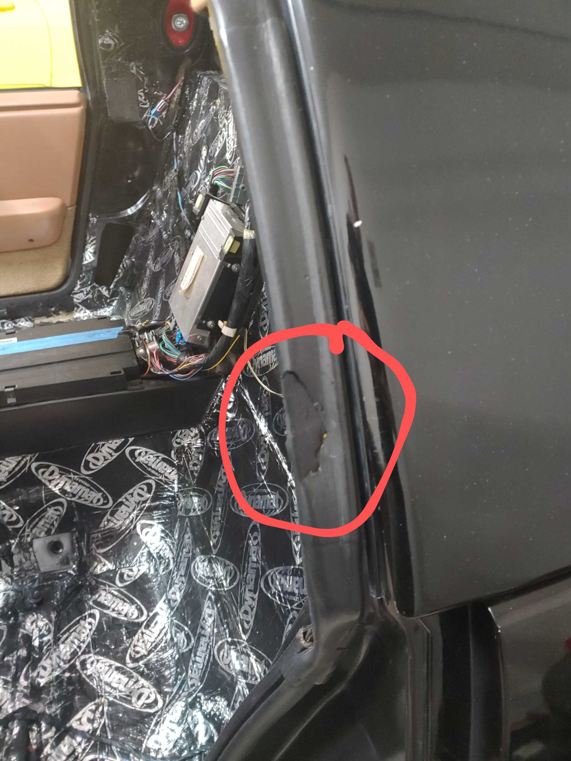

Since t top door seals are not easy to come by, does anyone have any suggestions to repair this?

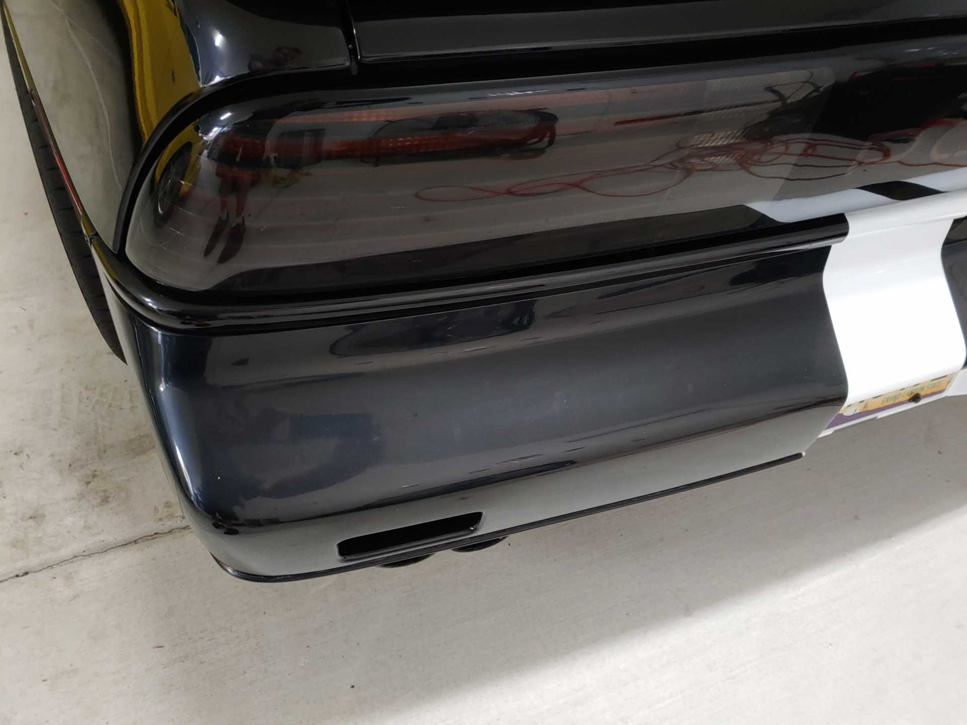

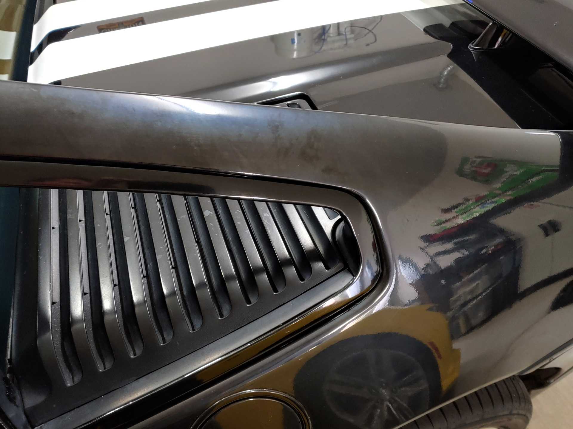

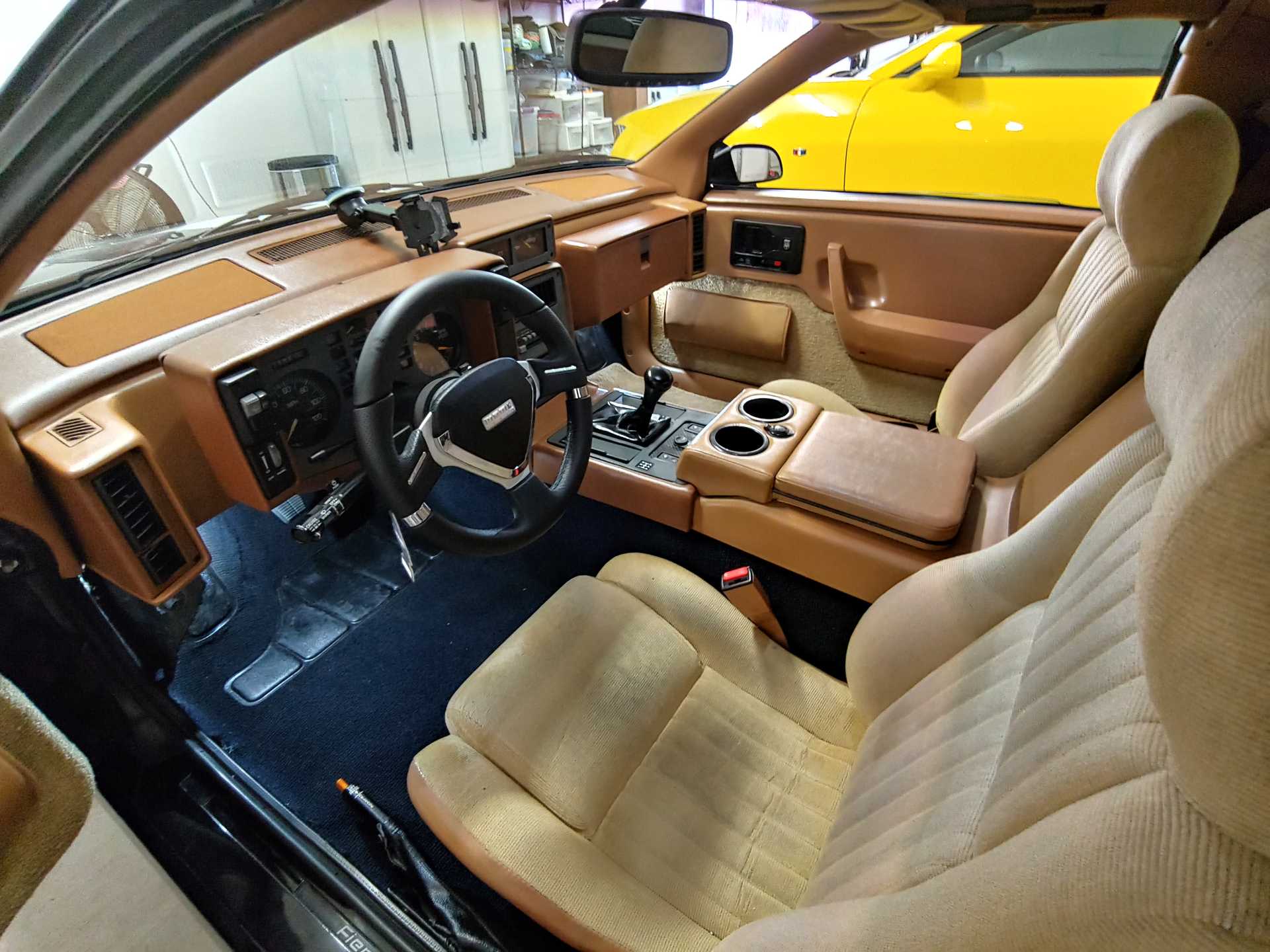

I finally got most of the interior put back in, I'm just waiting to get my seat belt back from service to finish up the diver's side.

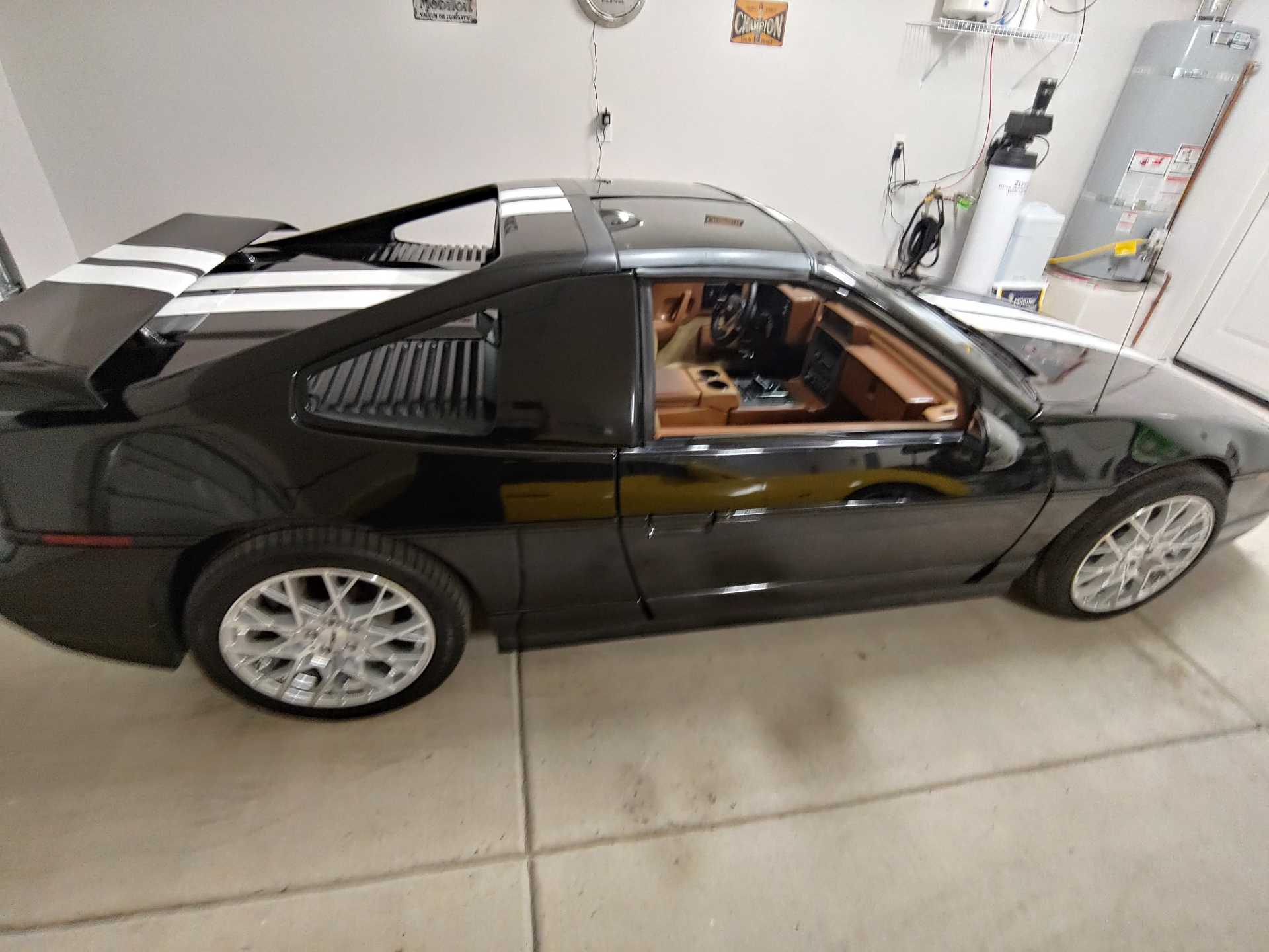

I also worked on the dull hazy paint with some compound and polish and now it has a mirror finish.
Before
After

I was able to use the stock steering wheel hub on my Momo steering wheel, and I got the horn wired up. However, now when I get the wheel mounted and tightened down, I can't snap the horn button into place because the shaft sticks out a little bit too far. I'm kind of scared to mess with the shaft, grinding, or cutting because I may not be able to get the wheel on/off if the end gets deformed. Any thoughts?

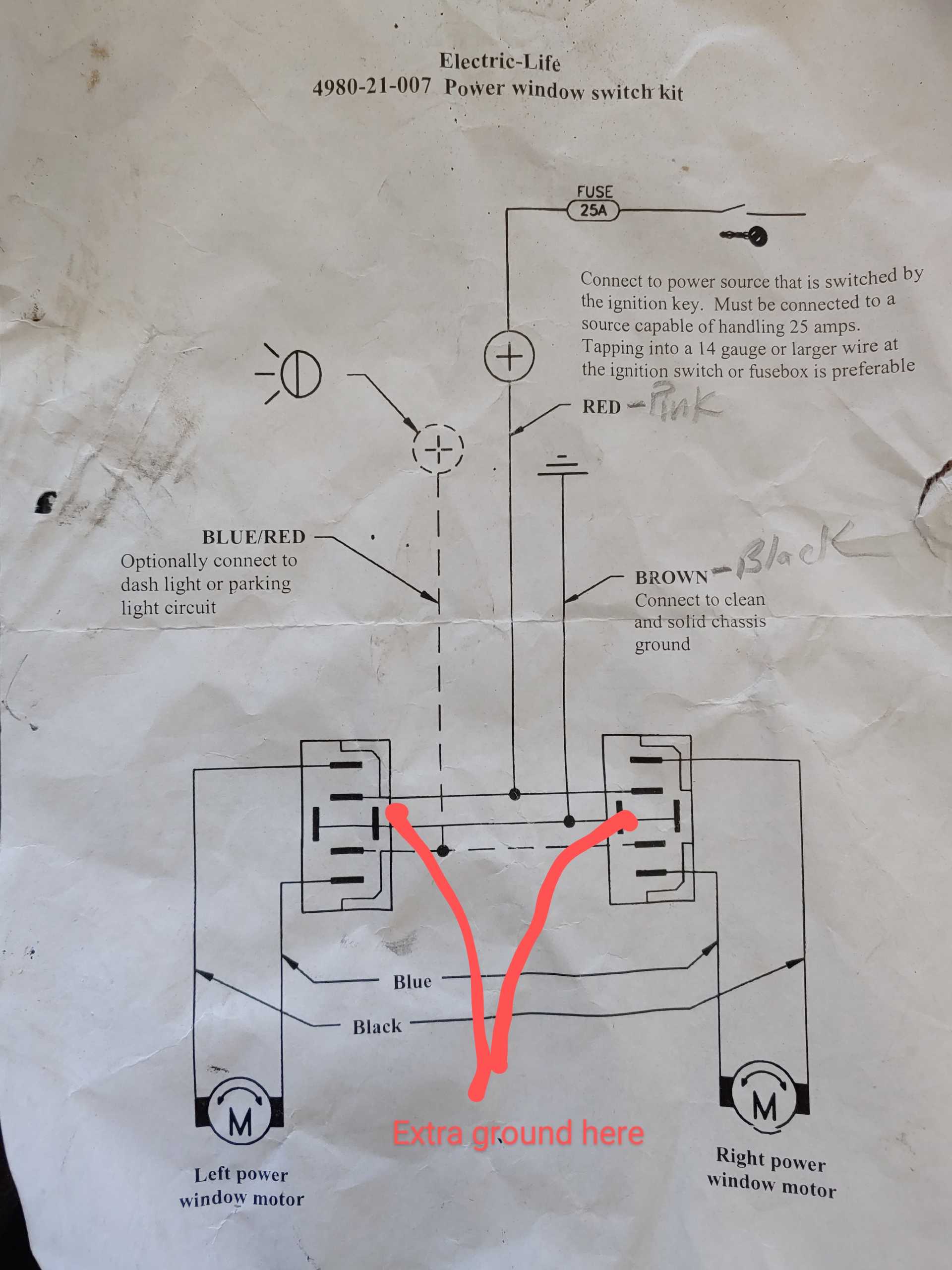

I like the switch set up for the mirrors and windows. Is that from the PO or something you did? And more importantly do you have any info on where the switches came from and what is needed to install them.
Car is looking good, keep it up.
Chief08 APR 17, 02:48 PM
I got the switches here https://www.a1electric.com/...uct_Code=4980-21-007
You will have to make the holes for the power window switches bigger for the new ones to fit with a dremel. Wiring is easy enough, connect up wire to up wire, down to down etc. You will need two grounds, one is already present in the car, the second one included in the kit, I ran to the rear of the console skeleton where there is a ground wire and bolt for something else. For the illumination wire, I tapped into the ash tray lights on either side. They work great, but I made my wires a bit too long, so they bunch up under the switches trying to push them up. I will address that when I get my new dash. I hope this helps. Let me know if you have any other questions.
