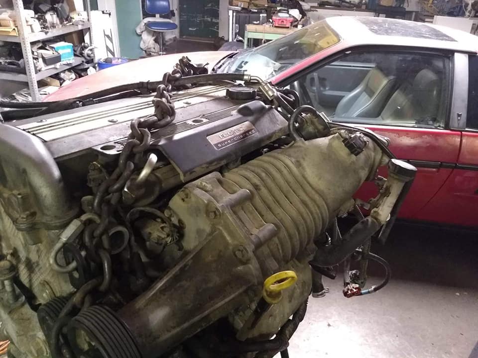

Sorry guys, it has been a while, and i haven't updated much being that it is winter. FINALLY GOT THE TURBO! Working hard on and off on the project, and the frame repairs are finally basically complete, we are moving on to building a drivetrain mock up bay, which is pretty cool. If you are wondering what this is, it is basically an 88 fiero engine compartment, that we can design mounts from the top as well as bolt the cradle and struts into, and test if exhaust fits. check it out here, let me know if you guys think its practical to do an engine swap.

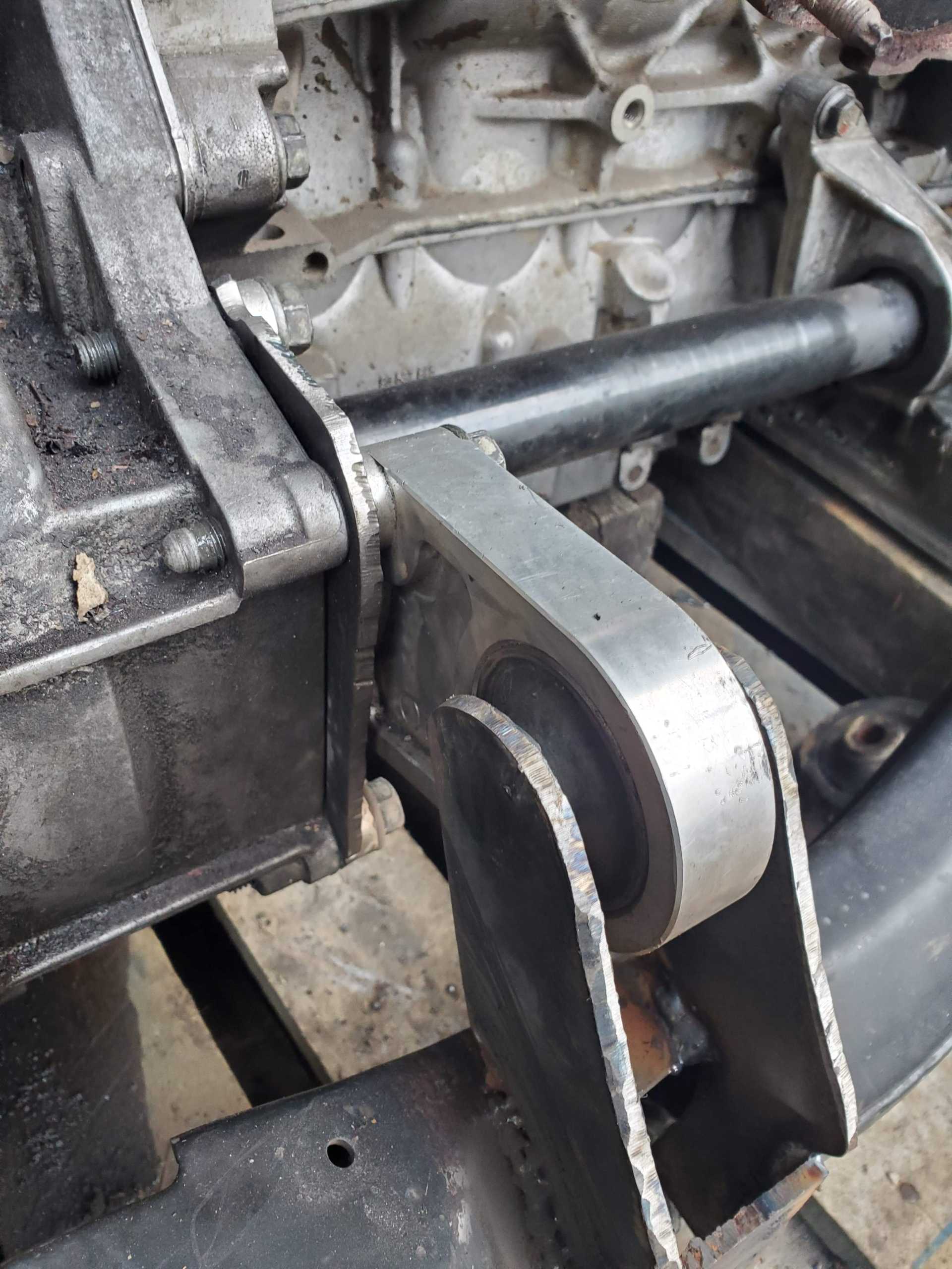

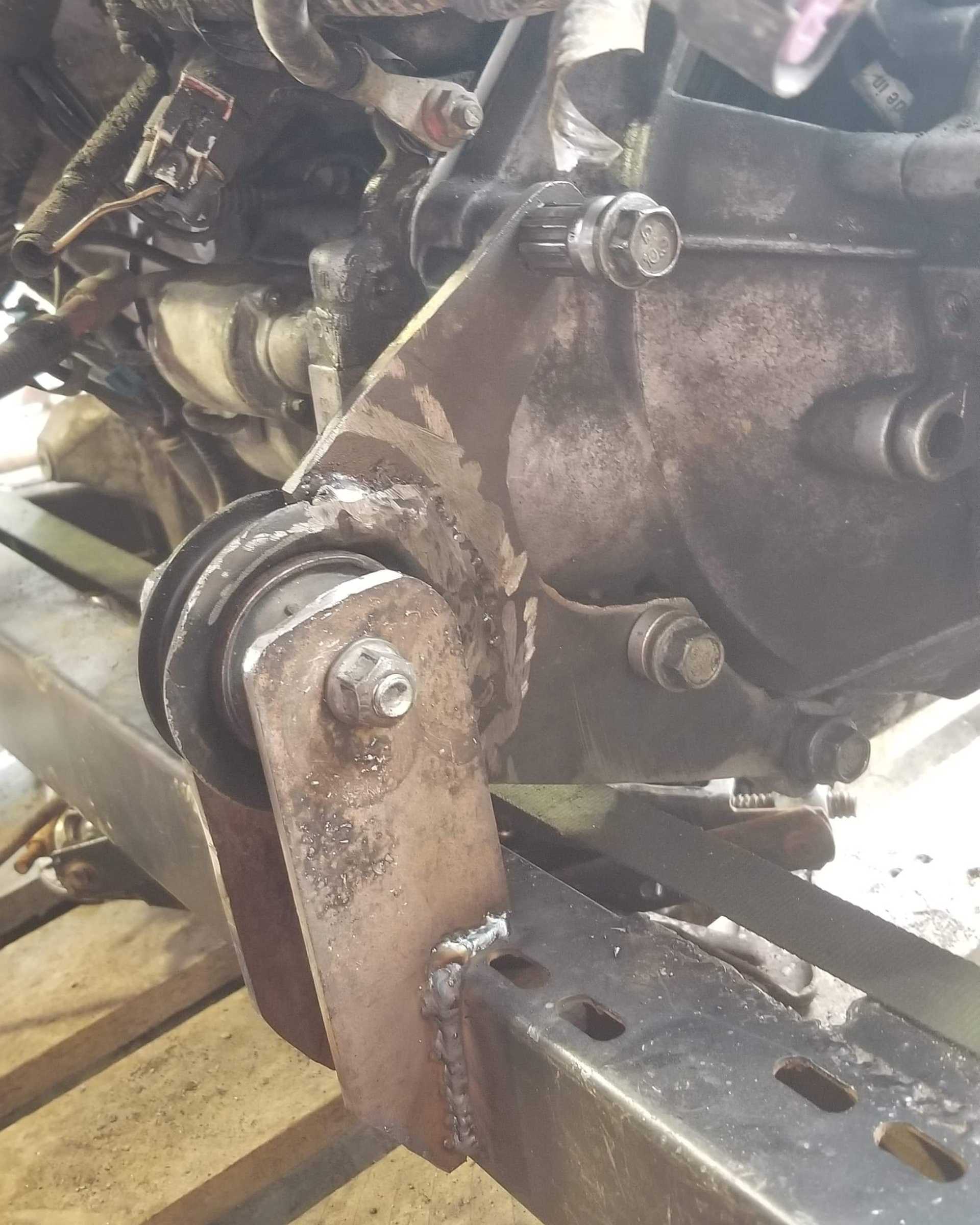

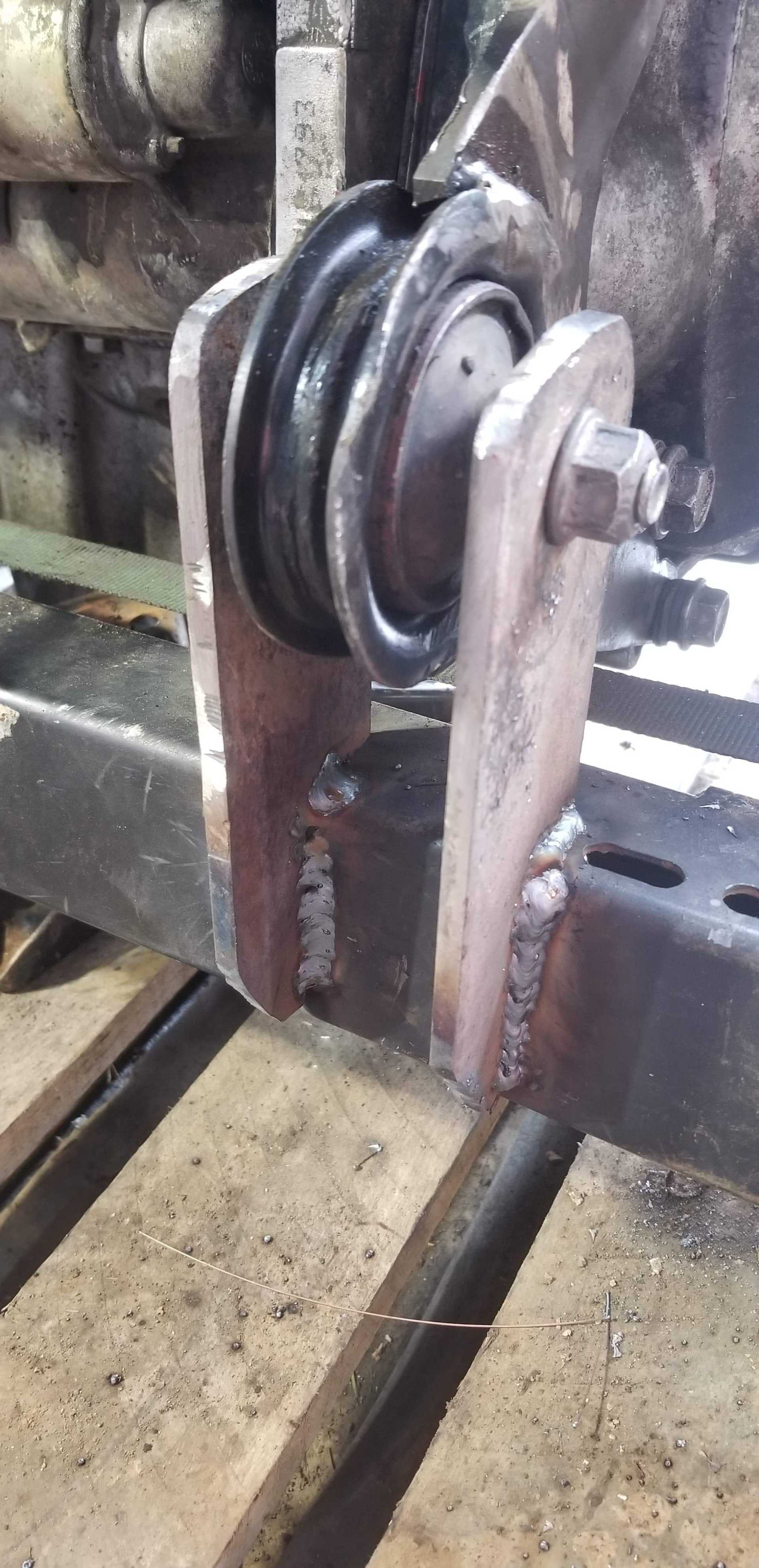

This car... we must finish it.
My front and rear mounts are done! I used bushings from ottperforance. Made them so the axles sit perfectly straight. Got a youtube video on it, at youtube.com/lightspeedfieros Ep14 Give me your thoughts
