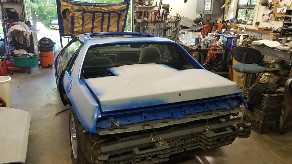

Thanks to the holiday weekend, I had some time to work on the car. I was working on painting all the body panels before reinstalling them, but they were taking up so much space I decided to put them back on the car and then paint them all at once. As usual, I underestimated how much time and effort it would take to reinstall them (you'd think I'd know by now).
I got the roof panels reinstalled, which feels like a major accomplishment.

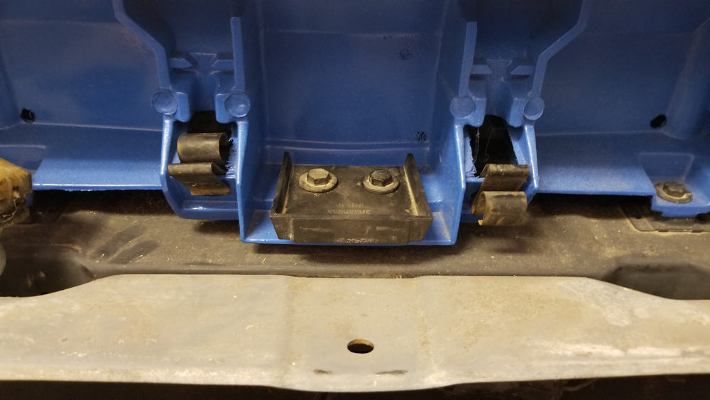

I've posted before that I accidentally deleted all the photos on my phone a couple years ago. They included all the pics I took of the disassembly process. So, while I have all the fasteners, not having the photos of where they came from really slows me down. When I found the metal clips that attach to the rear clip, I spent 10 minutes trying to figure out how they're oriented. Then I remembered that DKcustoms helped me out three years ago (THREE YEARS!):
Originally posted by DKcustoms:
I didn't forget! Just got busy.

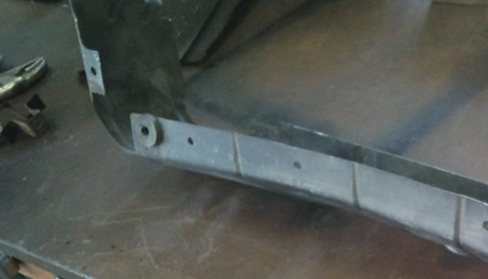

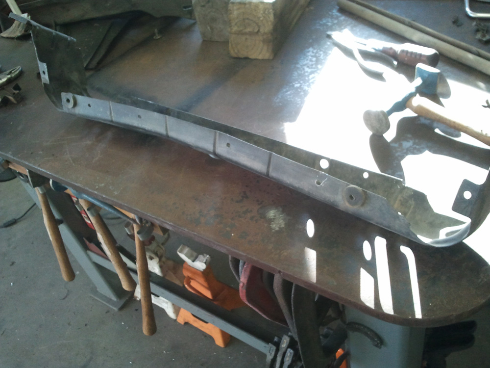

There are metal clips, both on the rear clip and taillights that are important for holding in the taillight screws.
Hope that helps
For the record, the correct way to install them is on the left:

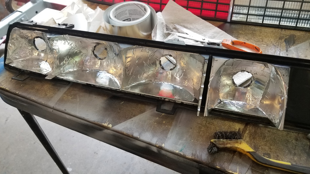

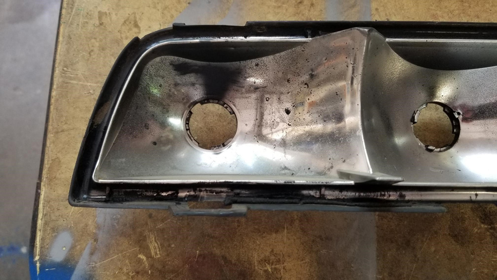

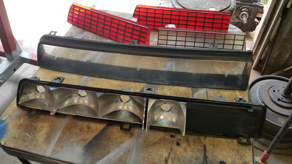

Both of my OE taillight lenses were cracked and broken. I bought a good replacement unit for the right one at the salvage years ago, but got just the lense for the left one. I've forgotten why I didn't get the whole unit for that side, but whatever the reason it meant I had to disassemble the stock one to replace the lense.
The plastic was brittle, but I got it apart without damaging anything. Of course, once I got it apart I found some of the reflective paint was worn off.
I checked the forum and saw that some folks repaint the reflectors, but others use foil tape because it resists heat.
A couple of notes if you go this route. One, the stuff is very sticky. It took me a few minutes to get the hang of using it. Second, there's no way to avoid wrinkles. At first I was disgusted by them, but then realized they don't matter. The idea is to reflect the light, and wrinkled tape will do that better than smooth plastic that's lost its shiny paint.

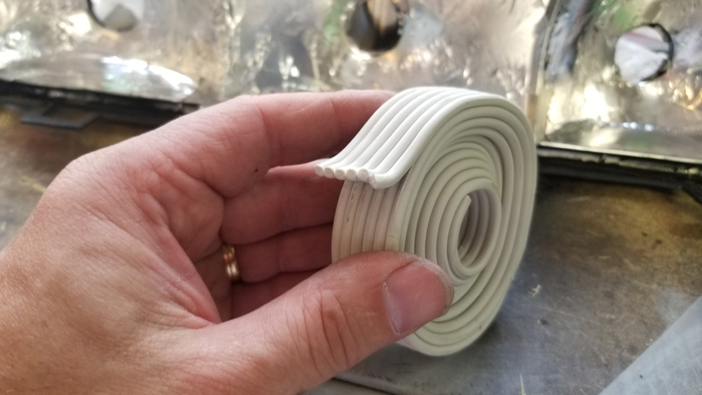

I pulled the butyl sealant out of the gap and replaced it with this 3M rope caulk. The stuff was less than $3 and was very easy to work with. I figured 35 feet would be plenty.
I used two strands of it, though thinking back on it now I realize I probably should have smushed the two together.

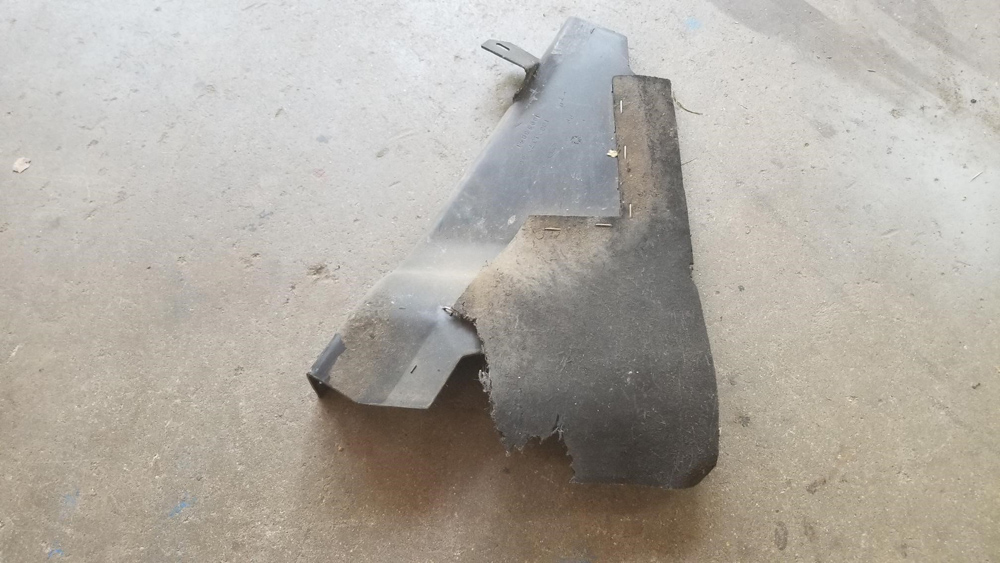

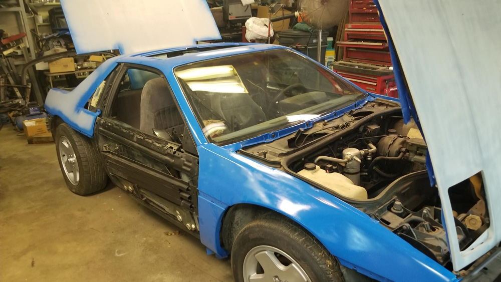

More progress to report. I'm working on getting all the body panels back on the car. Over the weekend I focused on the front fascia. The reinstallation process in general is taking much longer than I expected, for various reasons. In the case of the front fascia, there were a couple of problems. Years ago I removed the radiator and condenser to straighten and paint the mounting bracket.
I reinstalled the bracket and radiator soon after the work was done, but for some reason I didn't immediately reinstall the condenser and it'd been sitting in the trunk all this time. This weekend I struggled to get it to fit, then realized one of the mounting brackets had been installed backwards. I think the car took a pretty good hit in the front end in its previous life and whoever did the work took some liberties putting it back together.

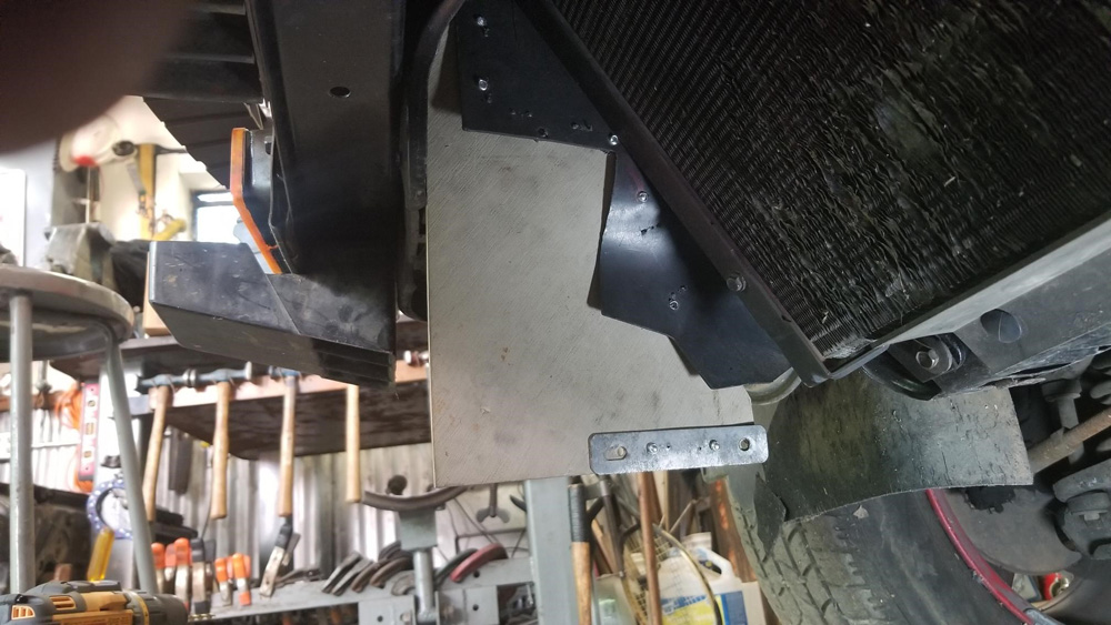

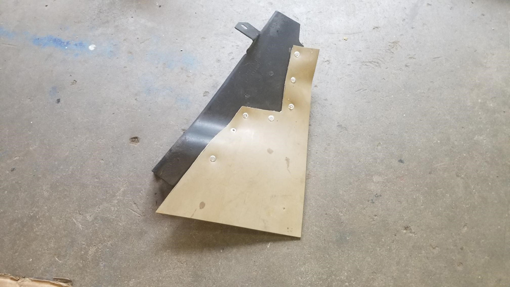

The other problem I rediscovered was that the flexible air duct material was ripped and the part that attaches to the fascia on the passenger side was missing.
I had some old rubber floor tiles lying around so I cut a piece to fit and used rivets to attach it to the plastic.
This is before I did the final trimming.

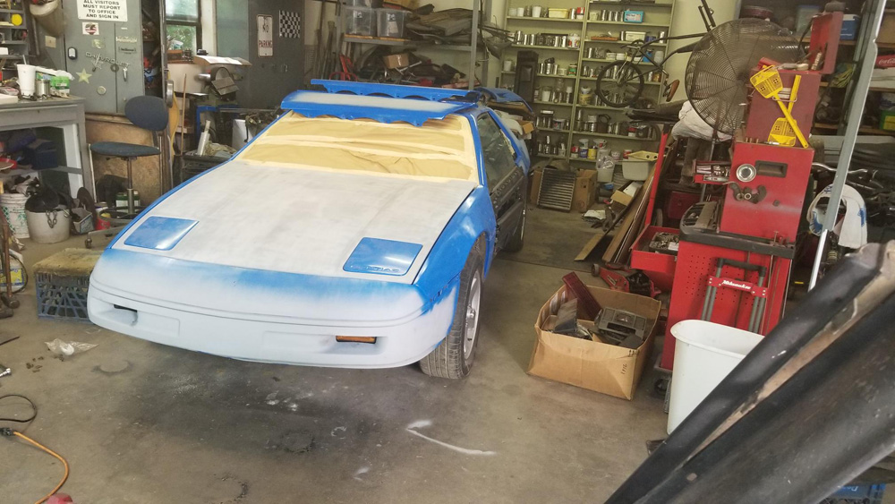

I have so much more work to do, but getting the front fascia completely reinstalled was a huge emotional lift. As my brother said, it's starting to look like a car again.
I also got the right quarter panel reinstalled.
