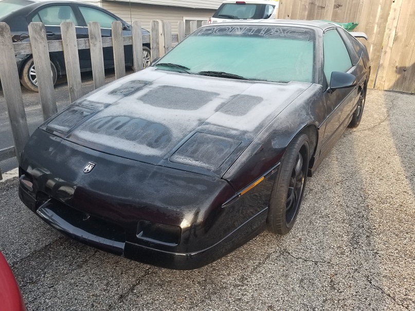

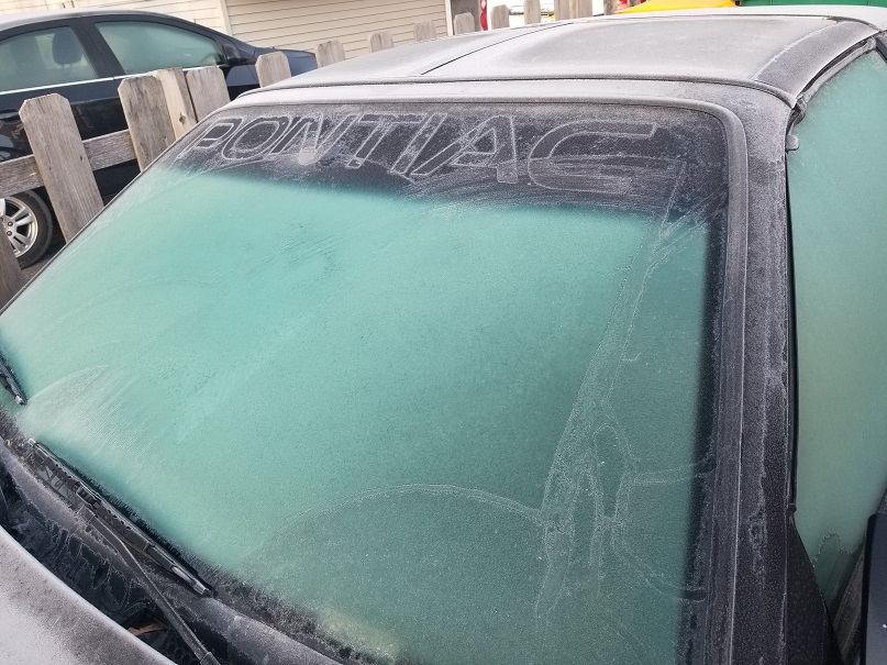

Fiero Thomas APR 26, 06:55 PM
Frosty Morning
