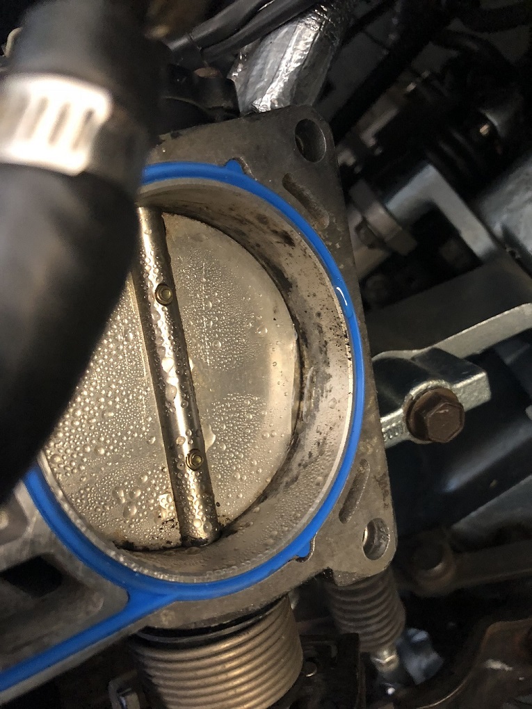

Buttt every project has its issues
on one of the first heat cycles the rubber hose popped off of the coolant tube. Apparently I forget to put the clamps on it. It took me way too long to figure out that one
https://www.youtube.com/wat...knY&feature=youtu.be
Although I blocked off the holes that flowed coolant to the stock throttle body, apparently I didn't do it well enough and I was getting coolant in the intake and leaking out of the throttle body. A little RTV fixed that

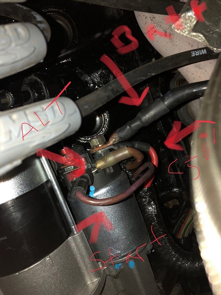

The brand new alternator I bought for this swap stopped working, so I had to swap that out. Less than a week later the brand new starter crapped out, so that had to be replaced.
This picture serves to remind me how the wires go in case I ever have to do that again and I forget.

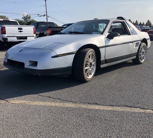

She spent some time at the local GM Dealer for her first alignment, she turned lots of heads and brought lots of questions. People love Fieros even if they don't know what they are

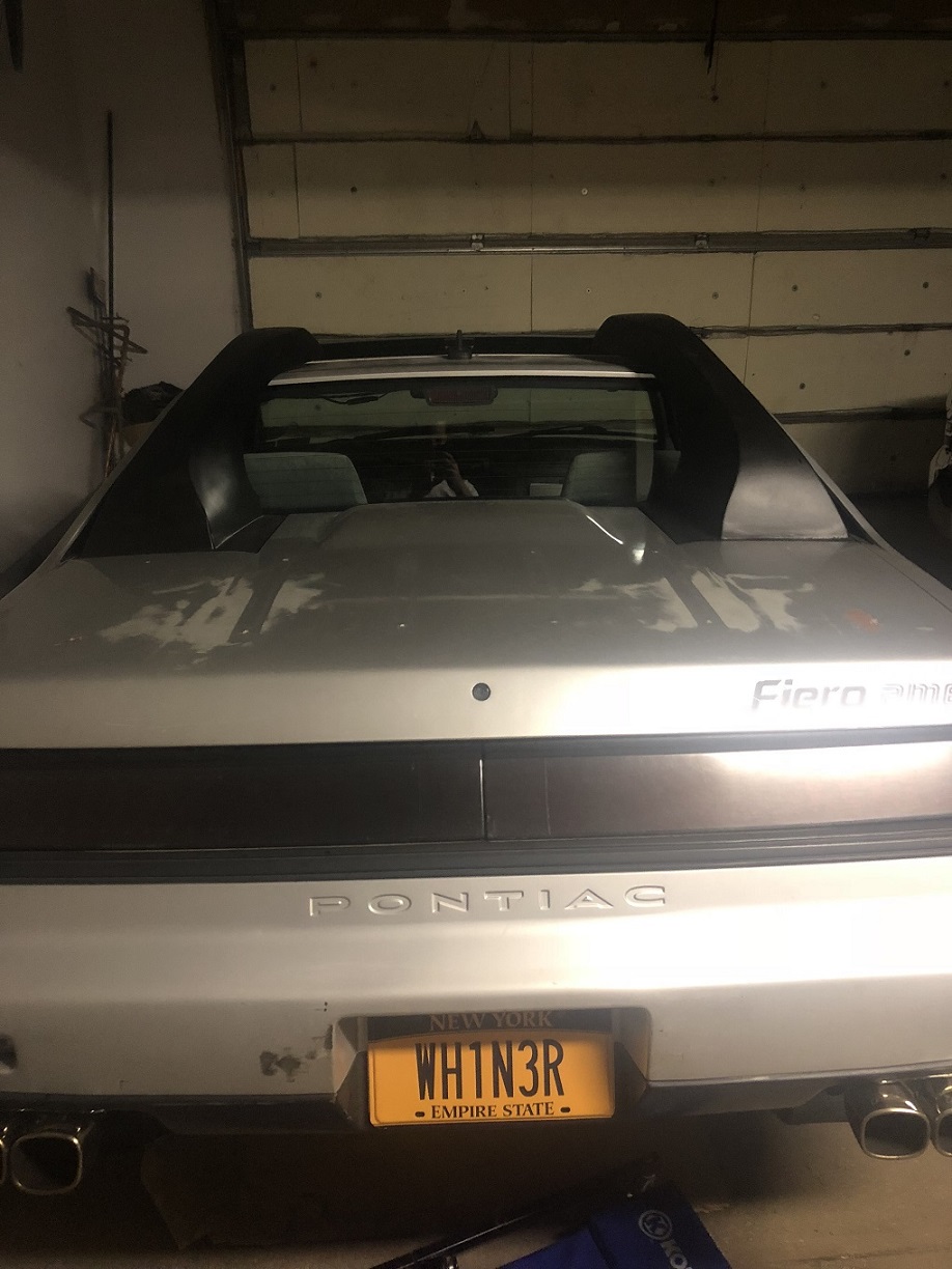

Then I got my vanity plate. Don't worry about the faded paint, that will be taken care of

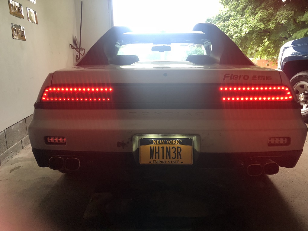

And of course my sequential led taillights courtesy of embrace racing, double_c4 on here, but I don't think he makes them still
She's coming along, the supercharger whine is addictive, and I can't wait to take my car to some shows this summer

Embrace Racing is still around but not as active I believe. I emailed him not to long ago and he got back with me.
Car is coming along. You going to the Carlisle event this summer? My son and I am planning on making it from New Mexico if we can. I have family out there which is a win/win for me!
BTW, you should also change out the license plate lights to LED's to go better with the tails.[This message has been edited by Spadesluck (edited 02-10-2019).]
