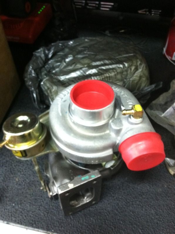

Spent some time yesterday replacing the turbo with a turbo from a Turbo Grand Prix. This turbo is bigger than the turbo that was on the car. I also ran some new hose to the PCV valve and hooked it up to the correct hole on the valve cover. Now all of my smoking is gone! Also all my leaks are fixed! Now to install all the brake/suspension parts I've acquired and find some way to run an inter-cooler.
Here's a picture of the new turbo before I installed it. Direct from Garrett, no china brand here.

Daaaang brand new turbo. How's it drive? That car looks like it would be so much fun!
FieroMaster88
APR 06, 08:12 AM
Drives good. Plenty of power. I've put 70 miles on it with the new turbo and the gas gauge has hardly moved.

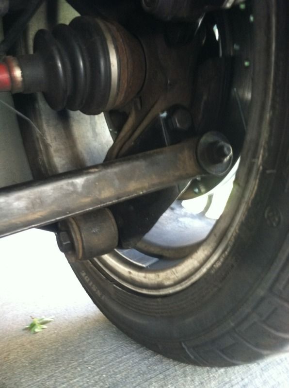

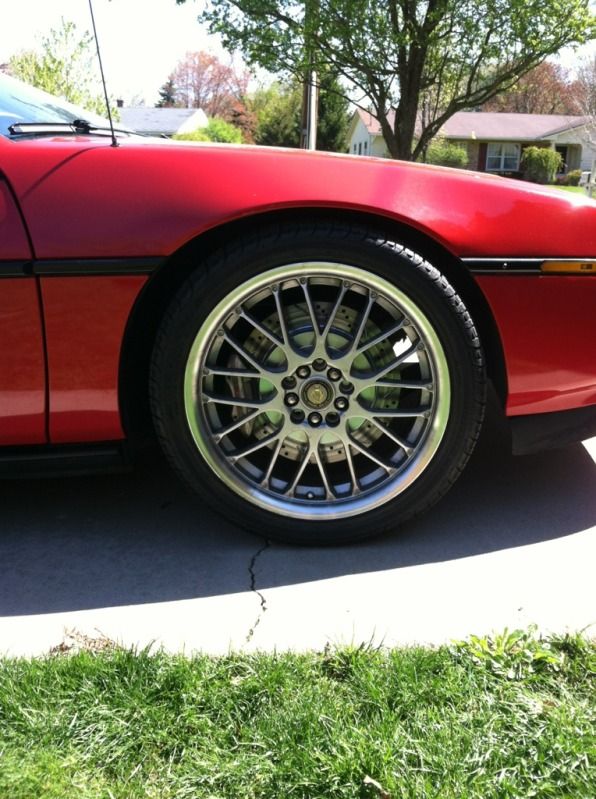

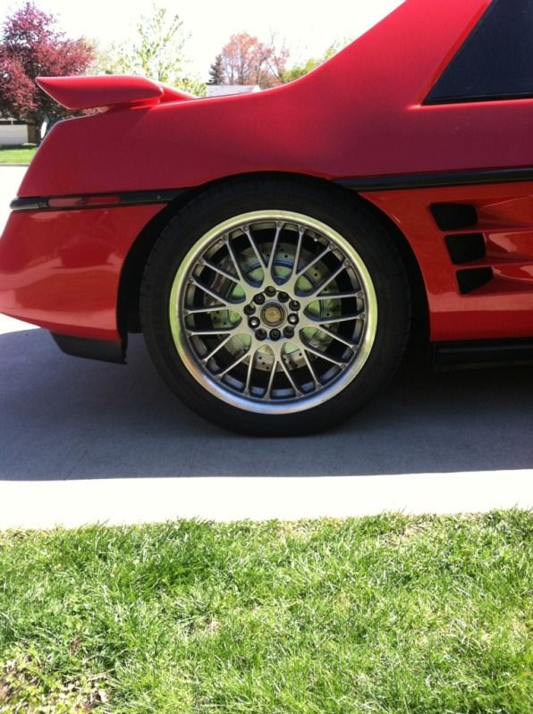

I installed all my parts Friday. Rodney Dickman 1" front lowering ball joints, Fiero Store front 1" lowering springs, Rodney Dickman zero lash end links front and rear, Fieroguru 13" brakes on all 4 corners and Fieroguru rear lateral link relocation kit. The car rides a ton better now that I don't have the cut springs up front. I need to adjust the rear coil overs up a turn or 2 to level the car out and I still need to hook up and adjust the parking brake. I also have a larger brake booster on the way which I will install when it comes in.
