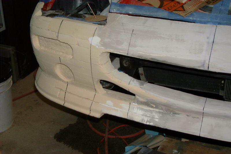

Threw a guide coat on the plaster to see where I was.This determined my switch to plastic.

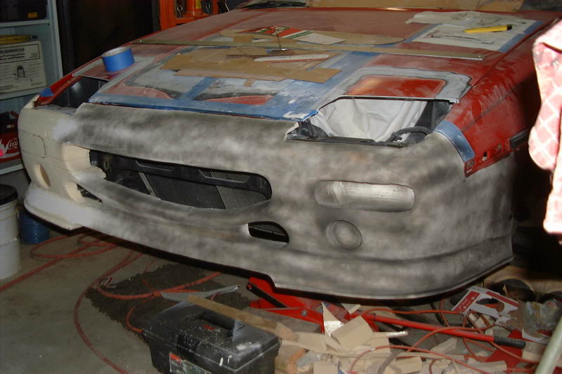

First layer of Bondo:
Added the ribbed molding to the front

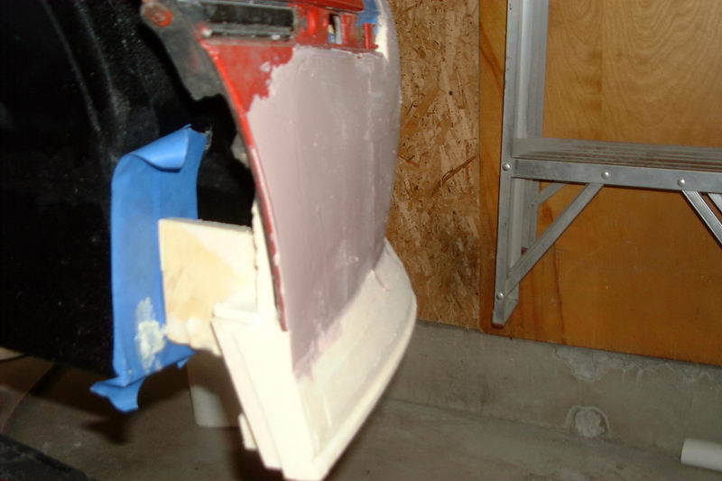

Started matching the passenger side to the drivers side. The lines show areas in which the profiles match

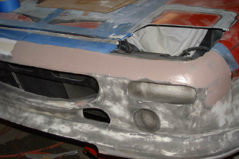

Adding filler to the other side
And the side panel

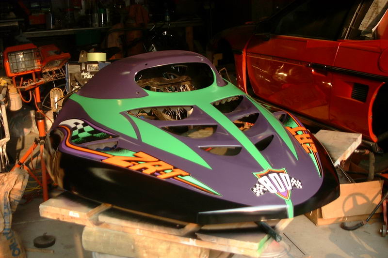

AUG 15, 07:00 PM
No update on the new front...I've been practicing on a snowmobile hood for my Dad.
Now I should be able to get back on it.
Bob
Amida
AUG 16, 09:42 AM
New idea for a front intake scoop?
