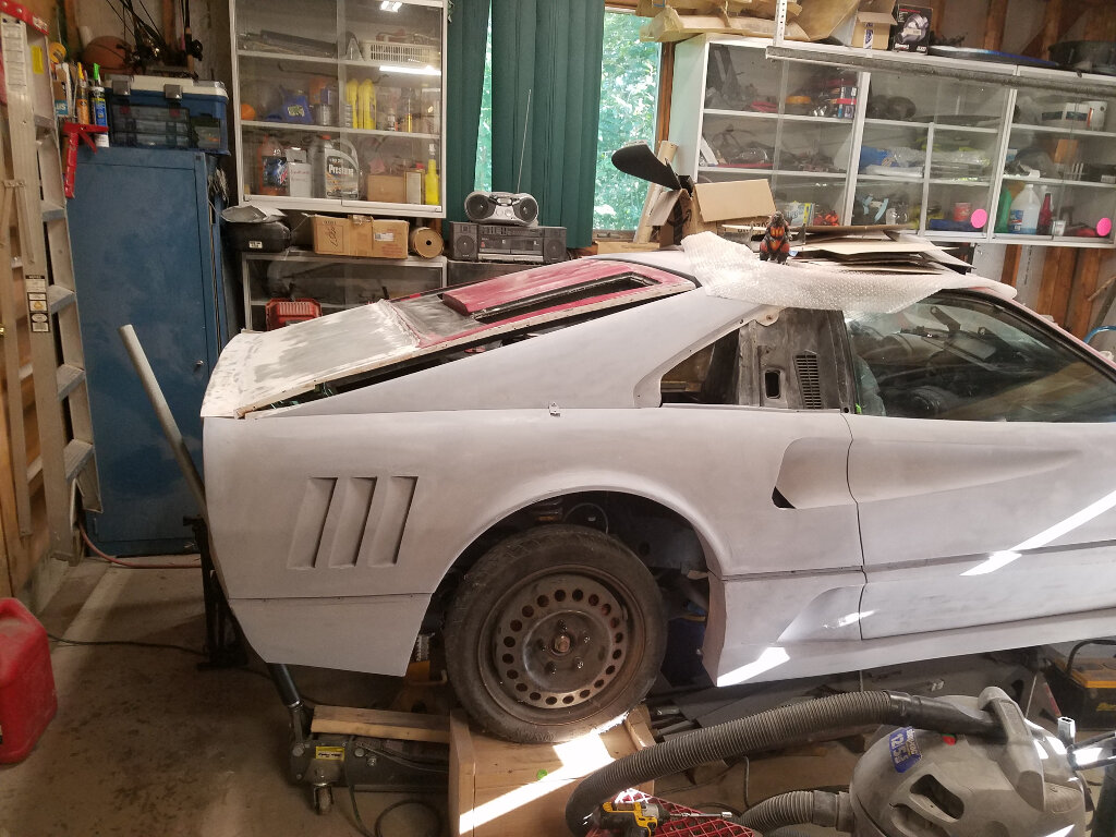

Hey Wayne,
Something like this?/
Bob
I forgot to mention this above, but short of the Stinger version, I think I have the only functional rear window of the Mera/308 clones. It made all of the work worthwhile.[This message has been edited by RCR (edited 07-12-2020).]

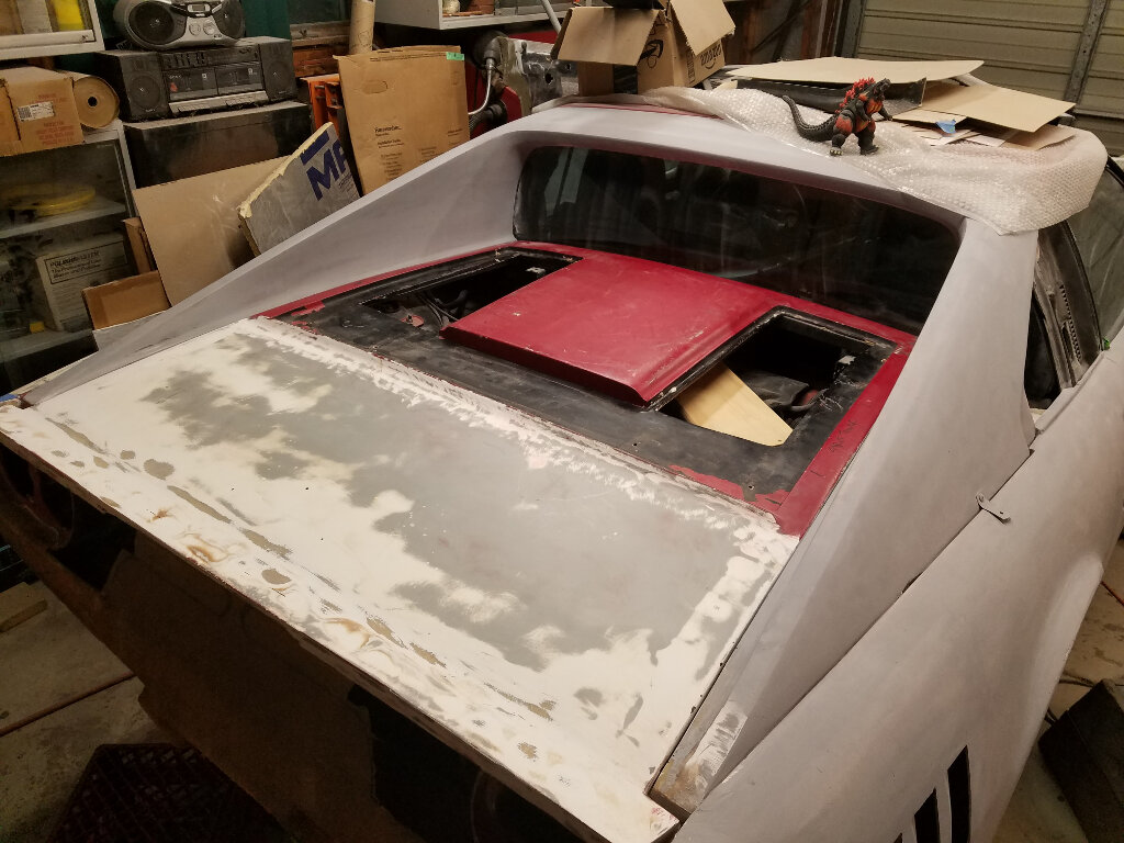

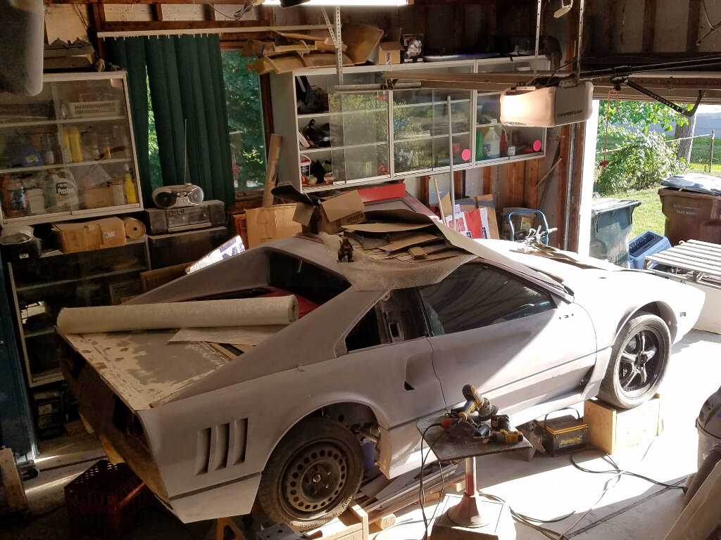

As mentioned, it was a little warm this weekend. Still managed about 10 hours of work. Doesn't actually look like much, though...
Worked on the rear decklid, namely, alignment and finish on the bottom.
I thought this was an interesting pic. Not going to move the decklid up, though.

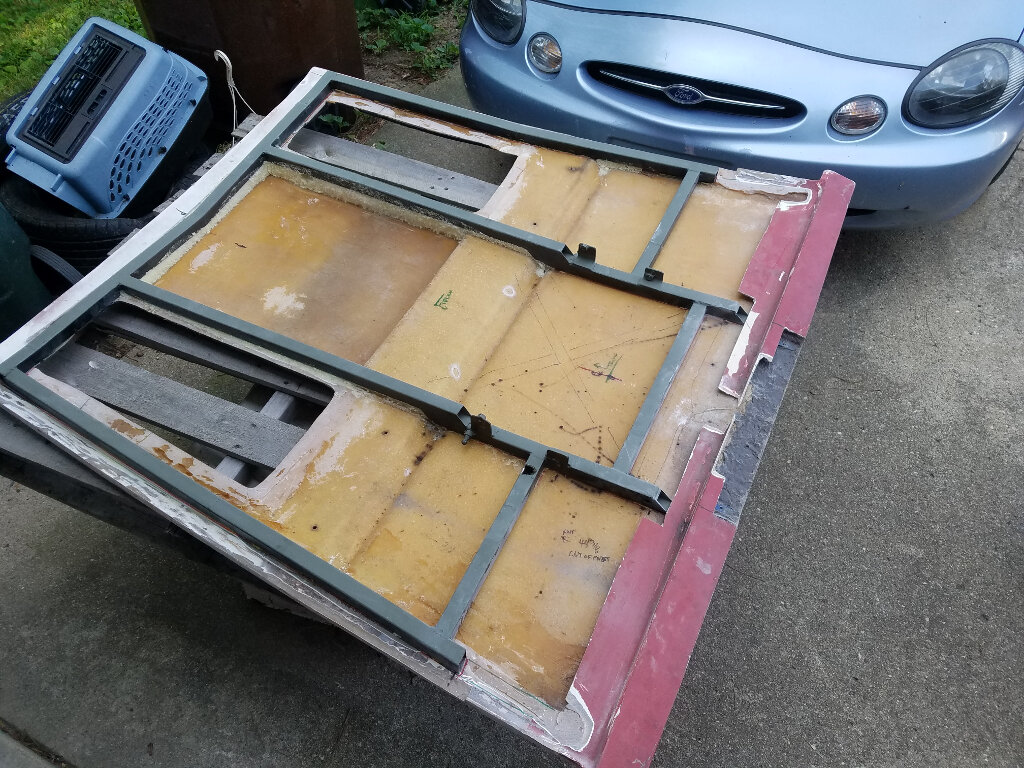

I started fiberglassing in the framework. I have all of the outer frame glassed and the top inner portion.All two layers of 1.5oz glass. I also glassed up the area for the brake light and cleaned up the area and glassed in the bottom sectioned that had previously been removed.
This is the top edge being glassed in.
 I thought the slats showing through looked kind of interesting. Might make a more modern look than the stock louvres.
Here I'm prepping the rear most area to glass to the spoiler edge, and glassing in the edge of the frame.
After pic.
Here's a shot of the area around the light being repaired.
Still need to finish the inner areas, but I need to make some decisions on the vents, so in the mean time, I bolted it all back together. The heat was exhausting, so I'm done for now.

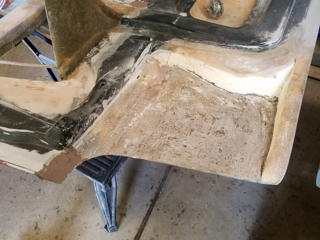

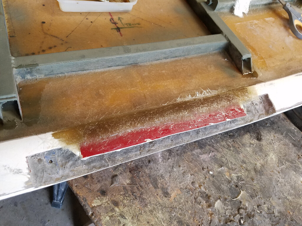

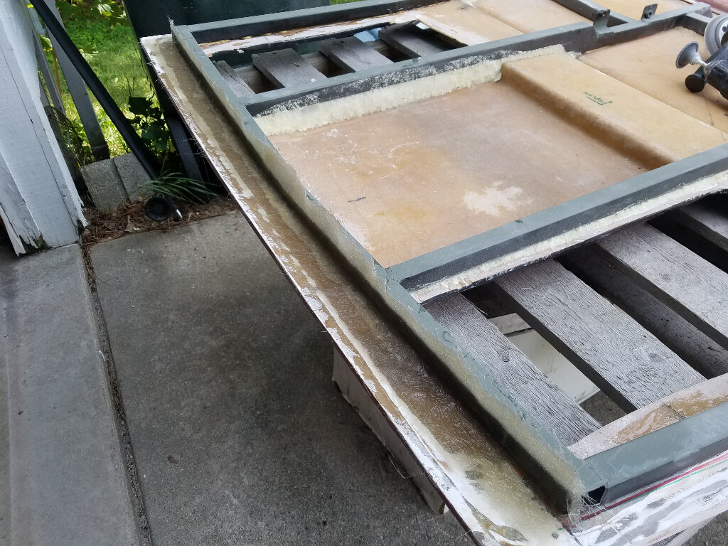

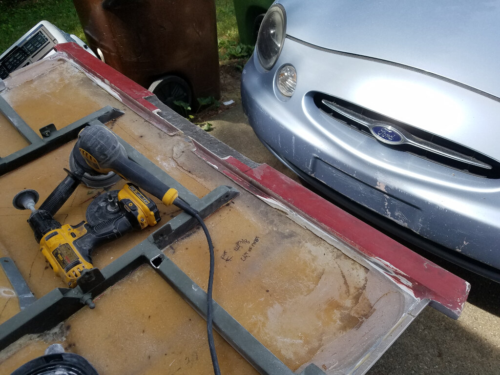

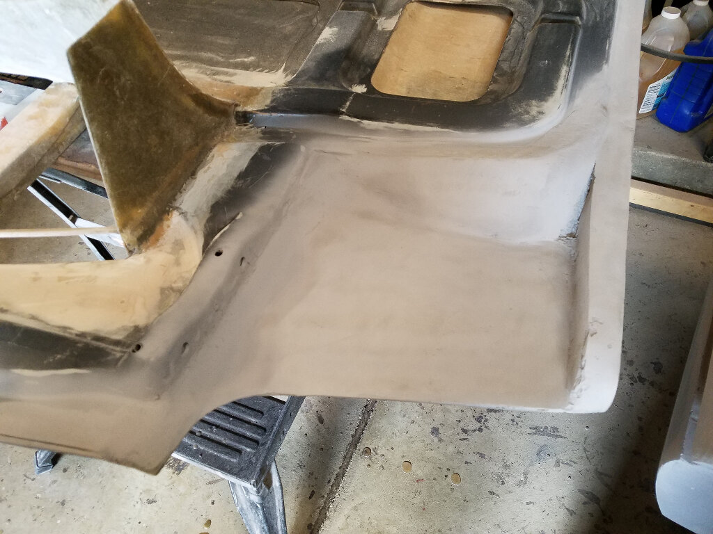

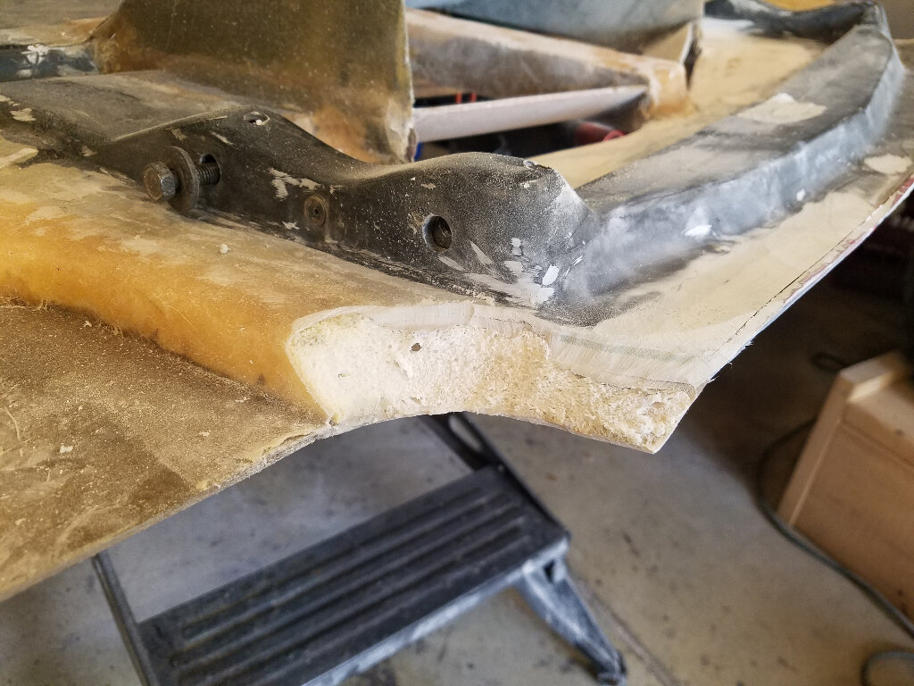

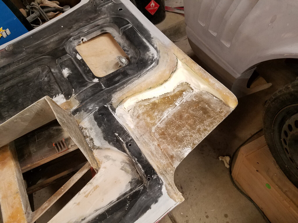

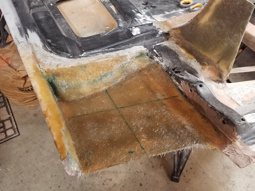

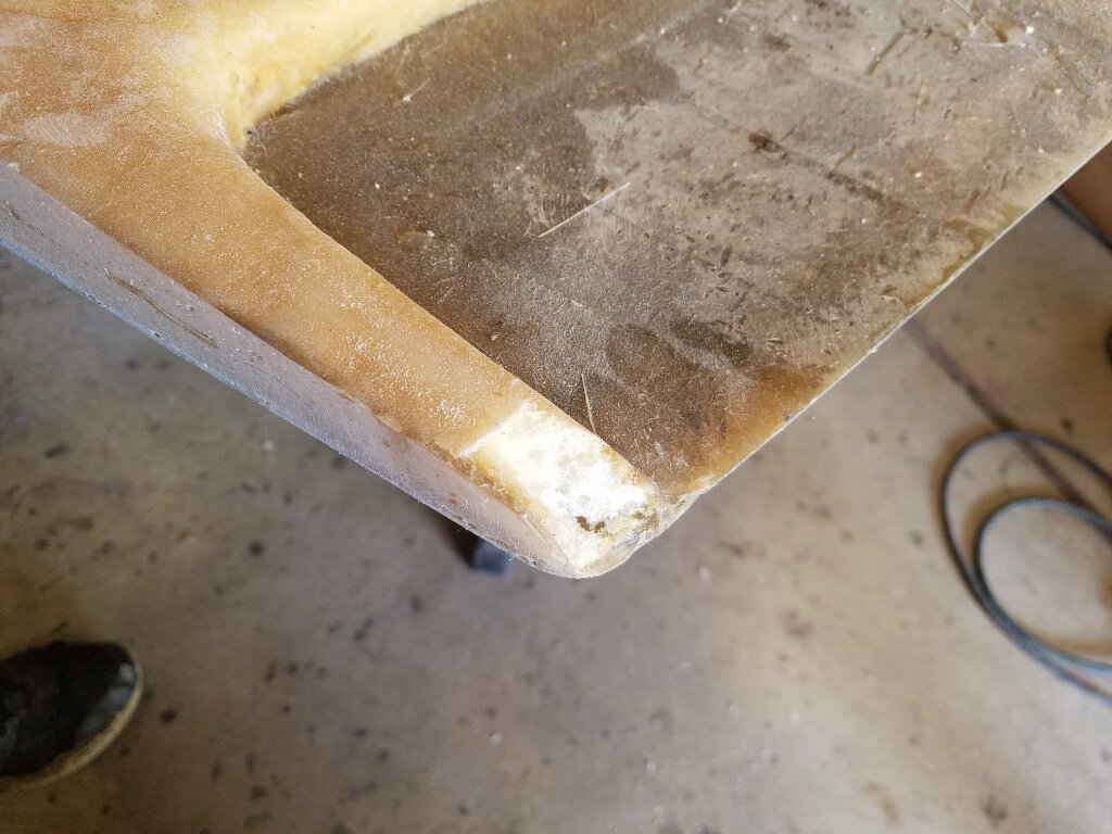

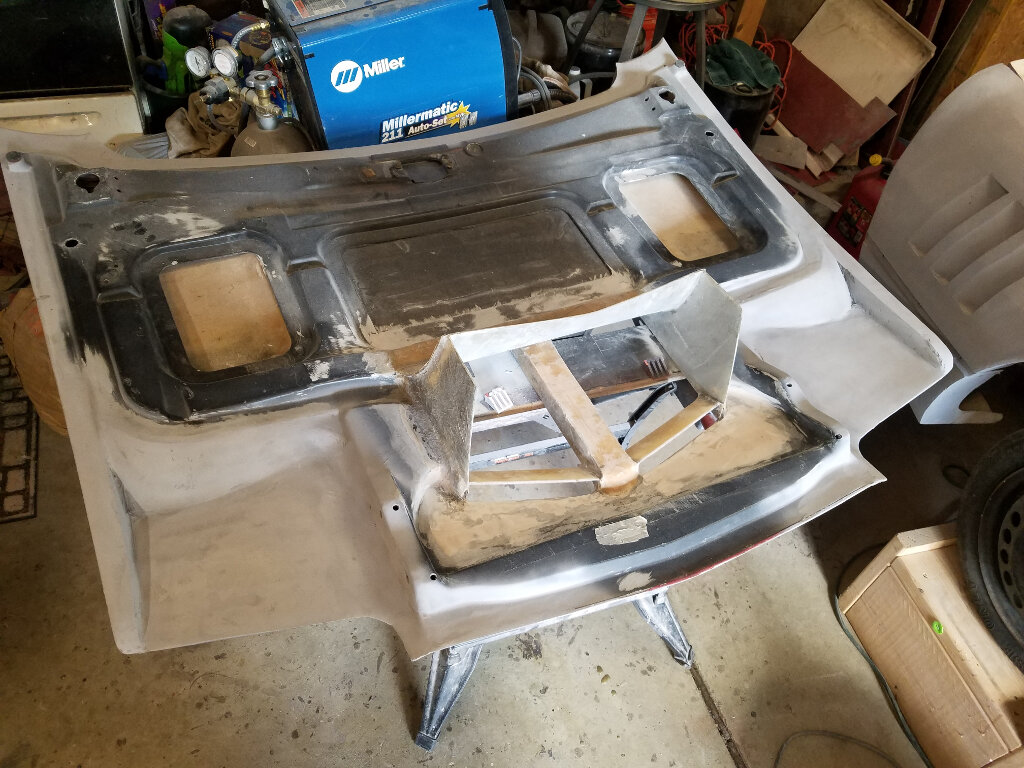

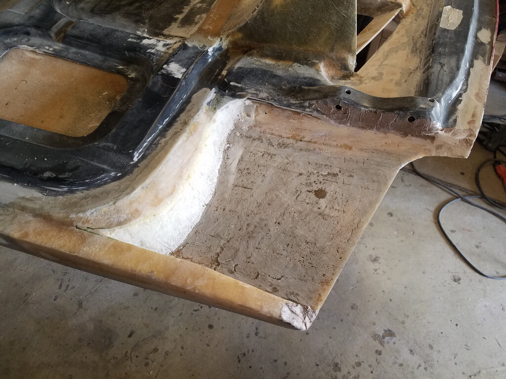

This time around, I moved on to the front hood. A lot of work to do on the bottom side. One of the main things is to finish to edges between the hood and the bottom. This was particularly bad at the rear edge, where I formed the little winglets. Then, I moved to the front edge that I created for the headlight pockets. Never quite liked what I did, so I totally reworked it.
How about the pics... Here's the rear edge, smoothed out and primed.
Front edge parts that needed reworking
How it looked when I started

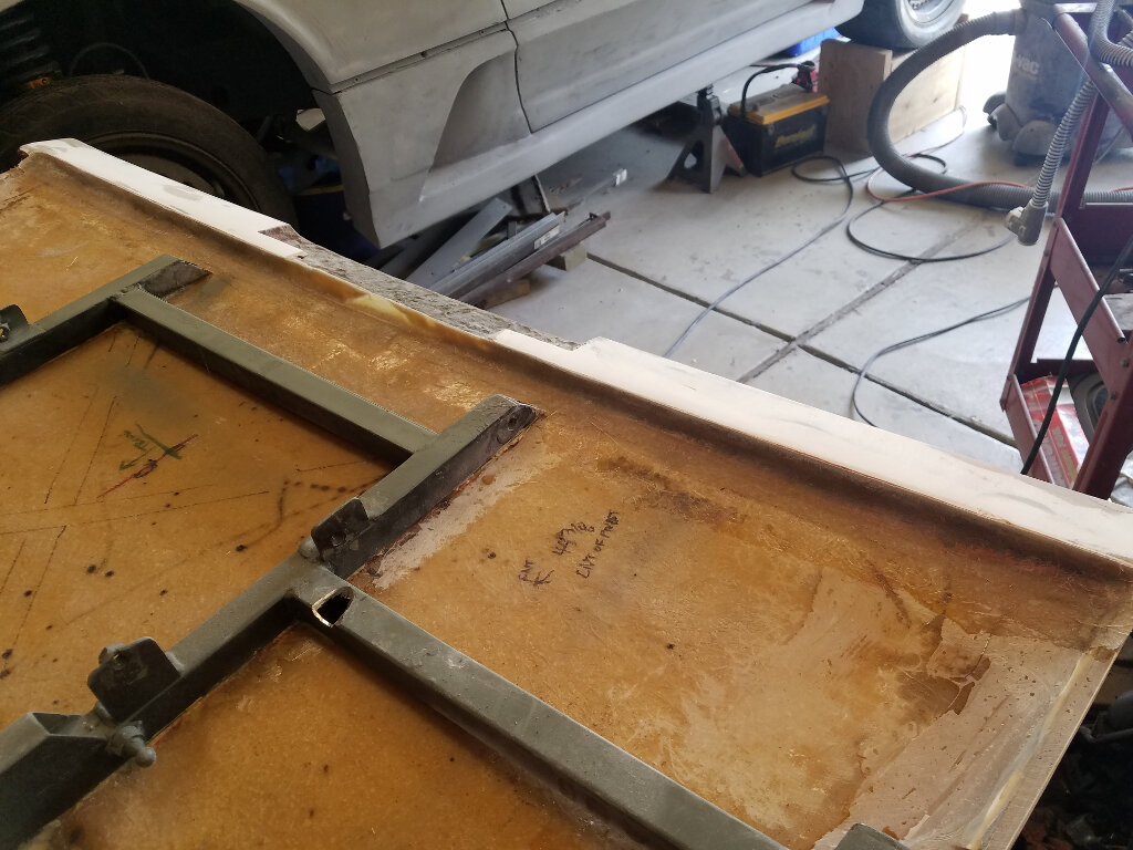

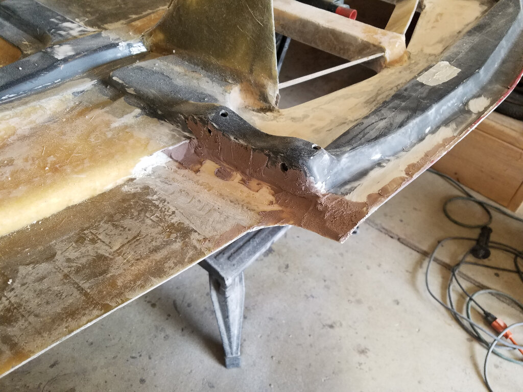

Here, I'm filling a gap between the hood bottom and top fiberglass. I'm using a concoction of SMC panel adhesive with some fine ground glass mixed in. It has the consistency of toothpaste, and fills the gaps well.

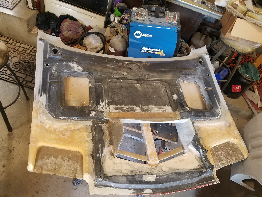

After doing that, I realized I didn't like the way I built the foam up, so I cut it out and reformed it.
Once reformed, glass was placed over the whole thing. I concentrated more over the foam, to build it up a bit.
The other side

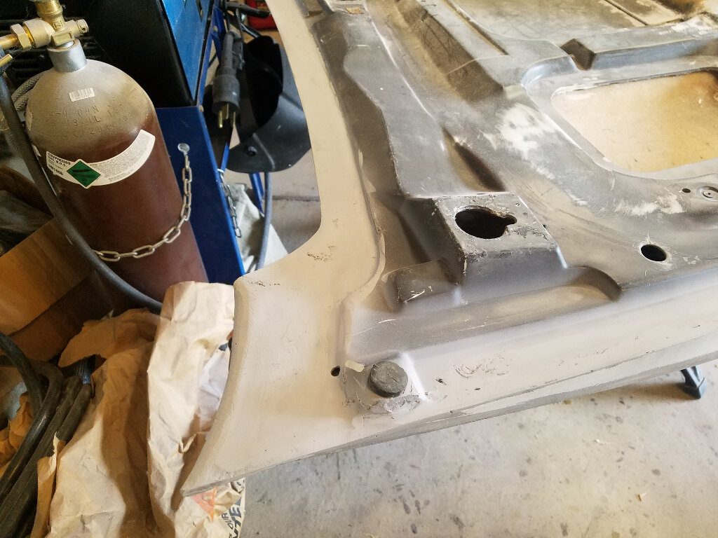

Now, onto smoothing it out. A couple treatments of bondo-glass and a bit of primer to see what 's left to be done.
Hood back on. Resting for next time.
Stay cool my friends. Take care.
Bob
