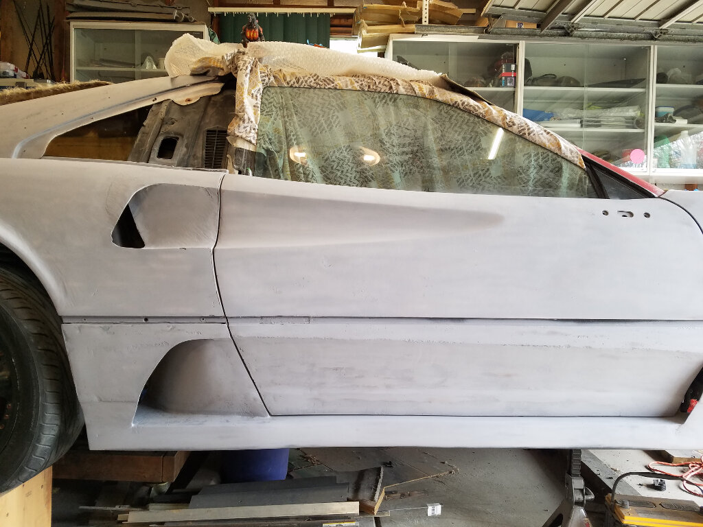

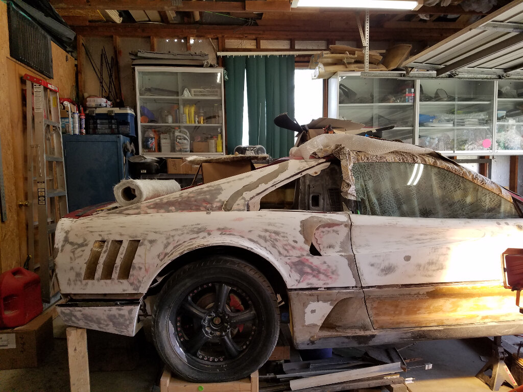

Ok, more for today.
Cleaned up the cove a little bit. Still needs a little more glass, but it's close.

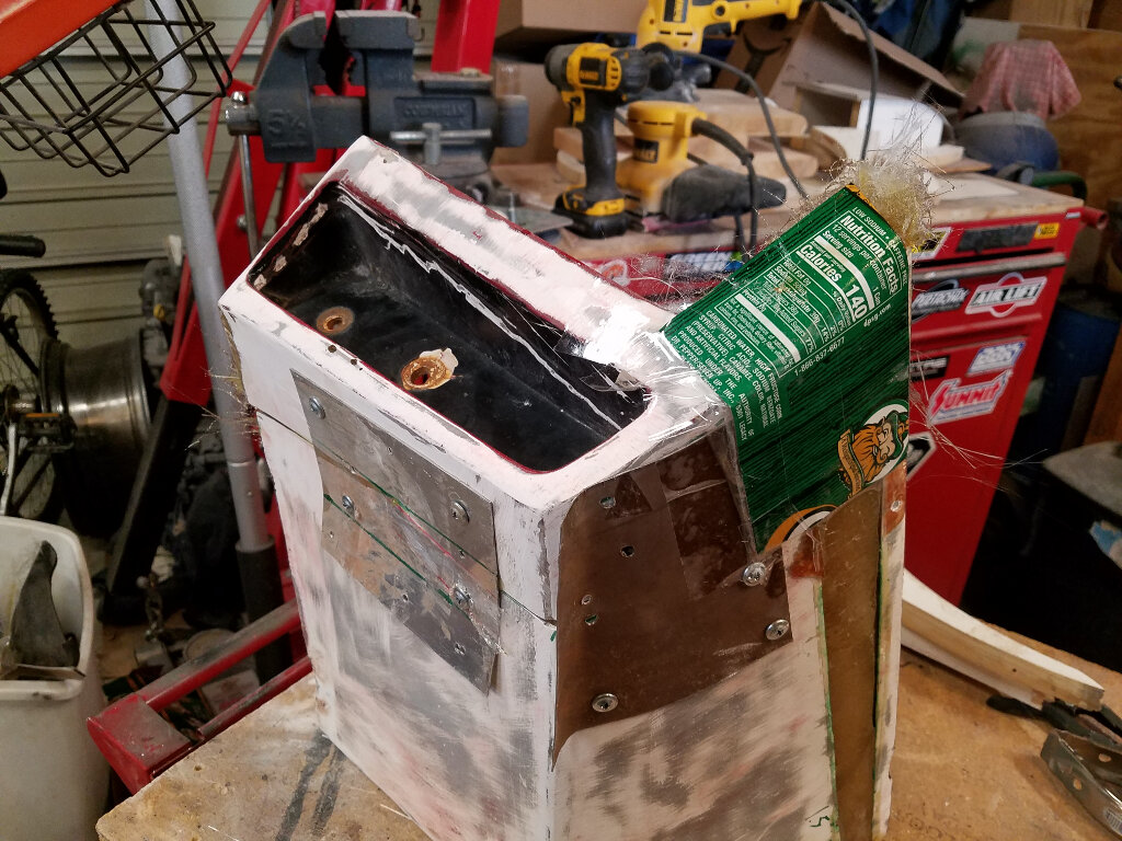

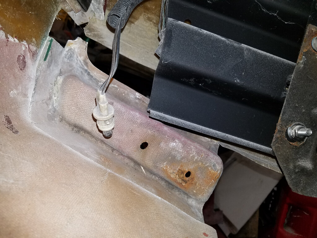

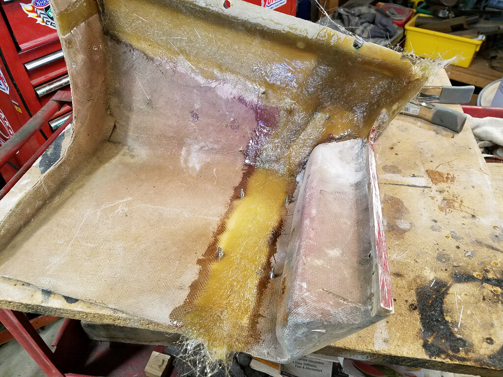

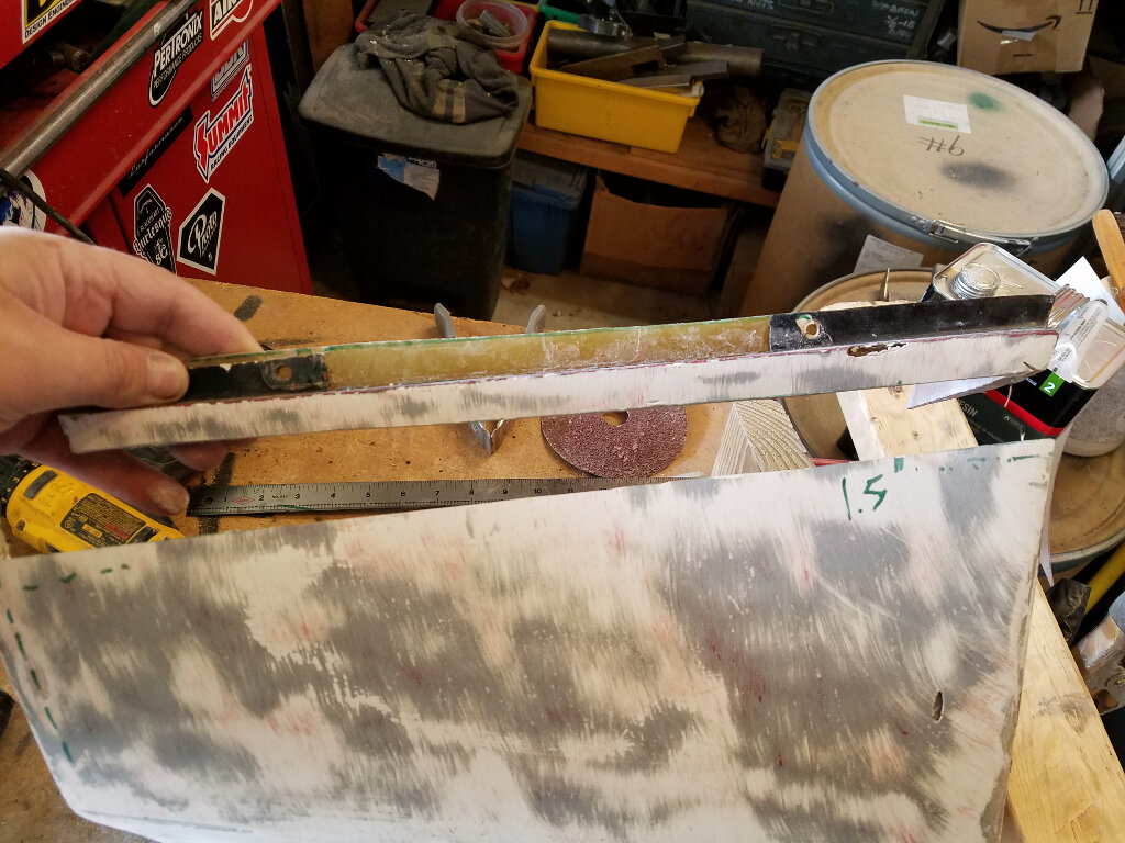

Also started working on the rear valence. First I knocked off that red paint, then I needed to fill the hole where the side marker light was.
That requires grinding the back down and adding 4 layers of glass. My template comes in handy for building the mounting flange.
A little trimming and voile.

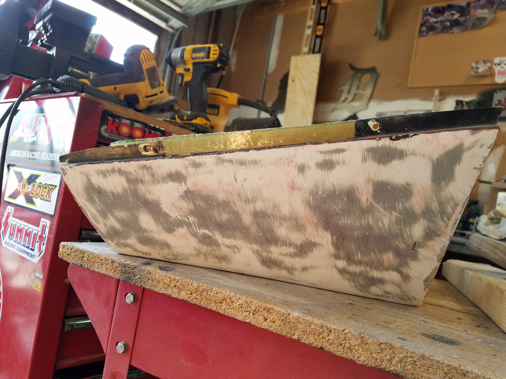

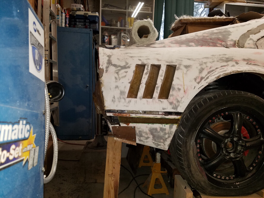

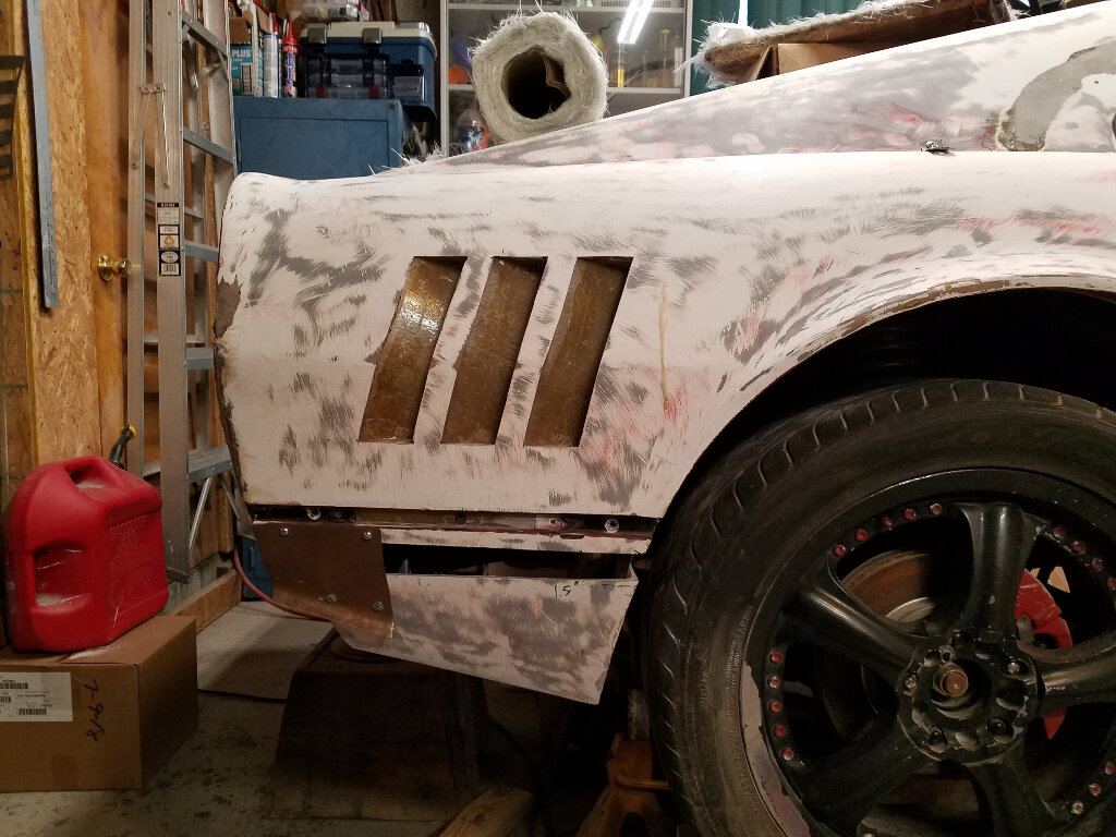

Now the fun starts. I decided the valence needed to be lower. To accomplish this, out came the Dremel and I cut the valence into three pieces.
The main thing was to use the existing mounts, so that gets mounted to the body. Then start positioning the lower part where it looks right.
Grabbed a couple more pics:
I was tired, so that was it for the day. More to follow.
stay healthy friends.
Bob

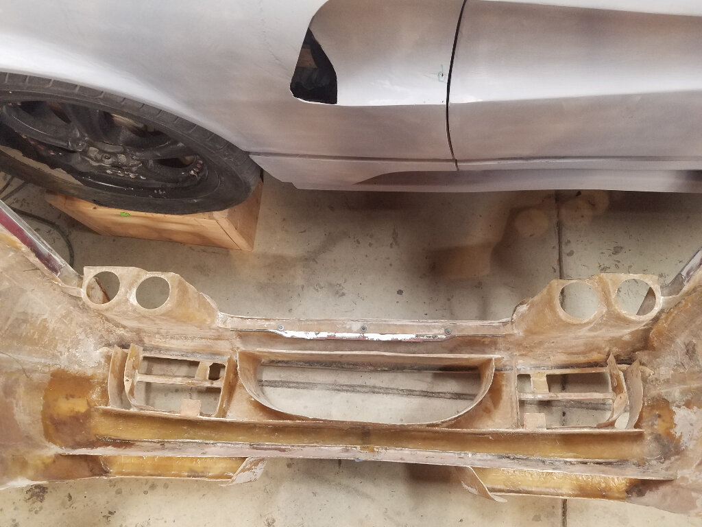

Rebuilt the corner valence this week. All pics...
Filling holes
Holes filled
Well, it kind of hits the bumper now.

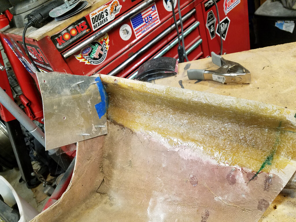

Cut-off saw, problem solved.
Now to reattach the back piece.
attached

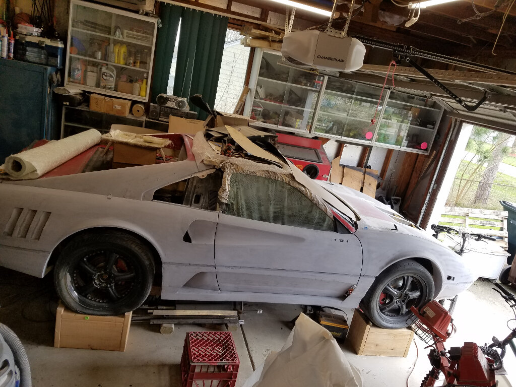

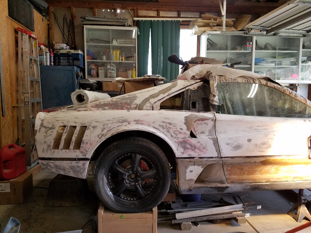

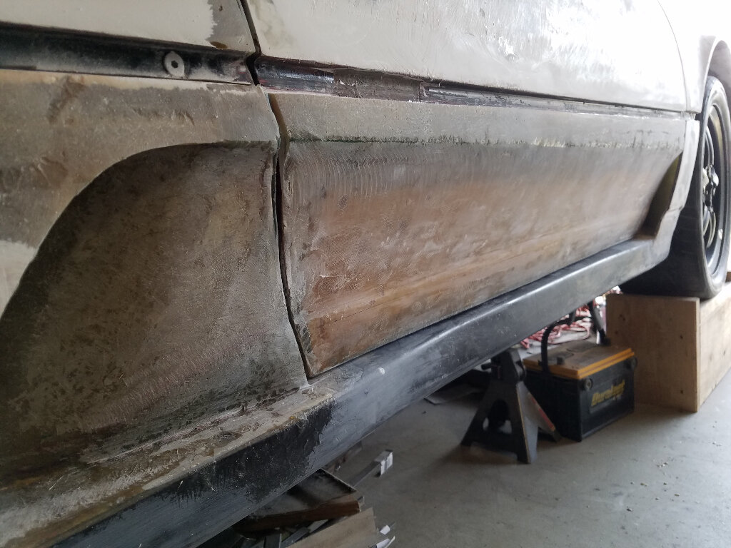

RCR MAY 09, 01:39 PM
Worked the rocker panel over a bit. Should have taken a pic or two.
Decided for good or bad that it was hard to see what needed to be done with all of the colors, so I rattle canned it one color.
Pretty stoked...

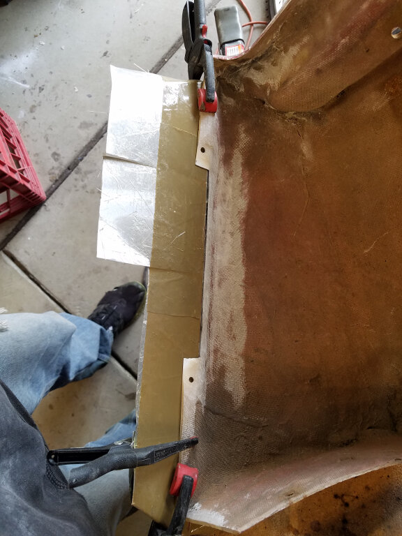

Decided I needed to finish up the front next (so I can turn the car around). Started adding glass to the back side and shaping the outside.
Pic of the inner works

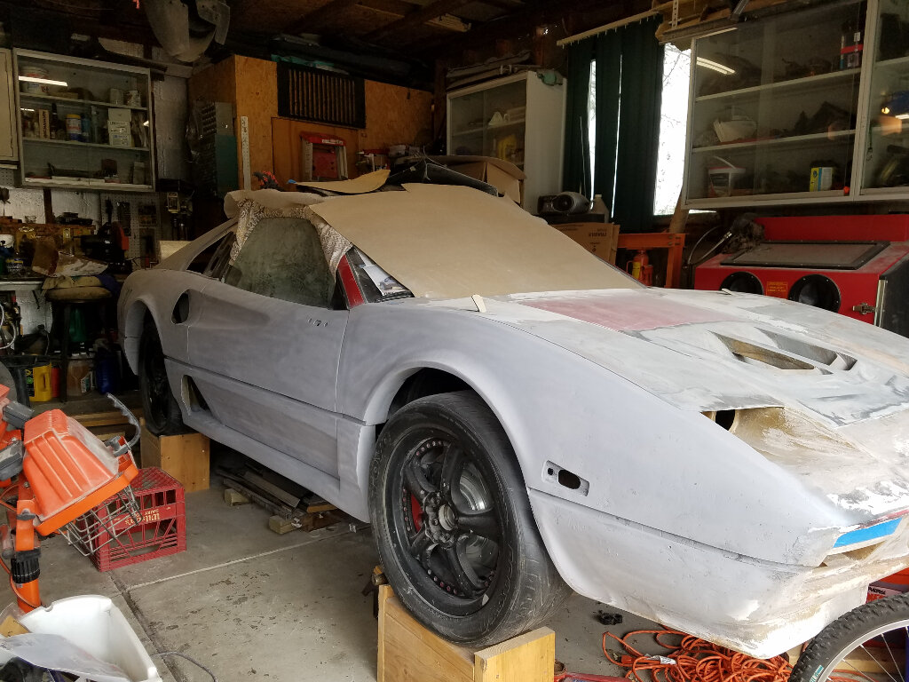

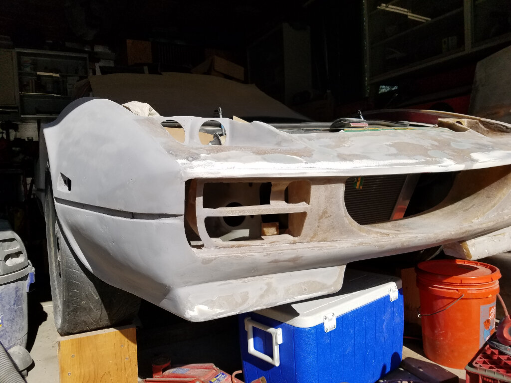

Thanx Wayne. Not a whole bunch going on. It got ridiculously warm all of a sudden, but I have been moving the ball forward ever so slowly.

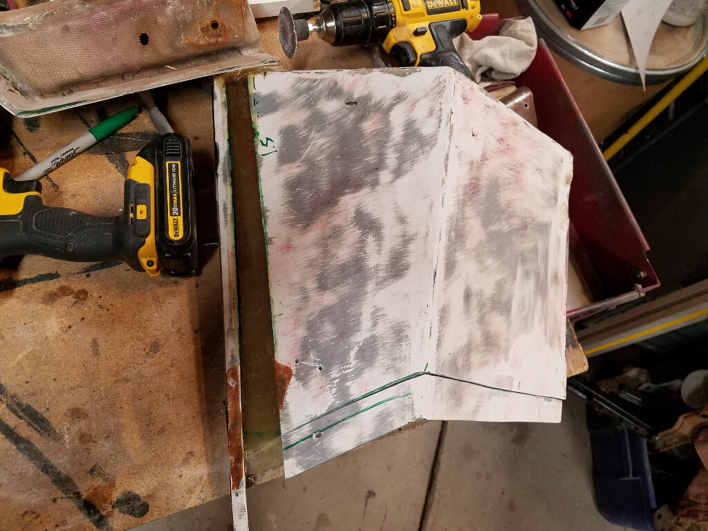

I've been concentrating on finish work on the glass, filling, smoothing, and sanding. I'm working on the front right now.
A few pics...

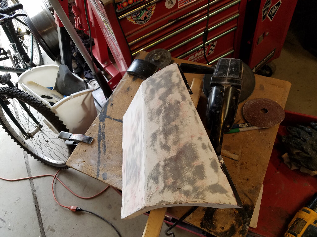

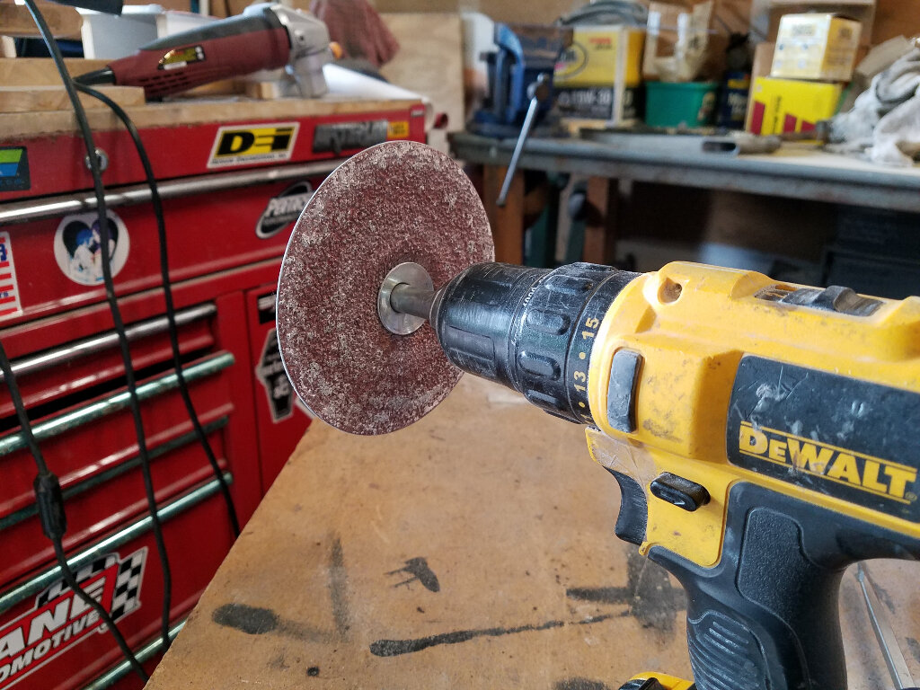

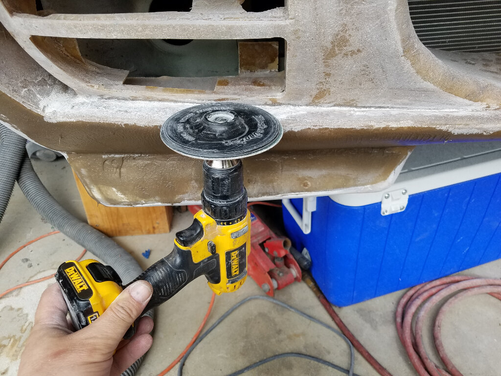

One issue i've struggled with is how to sand the sharp inner edges. necessity is the mother of invention.
Works like a champ.

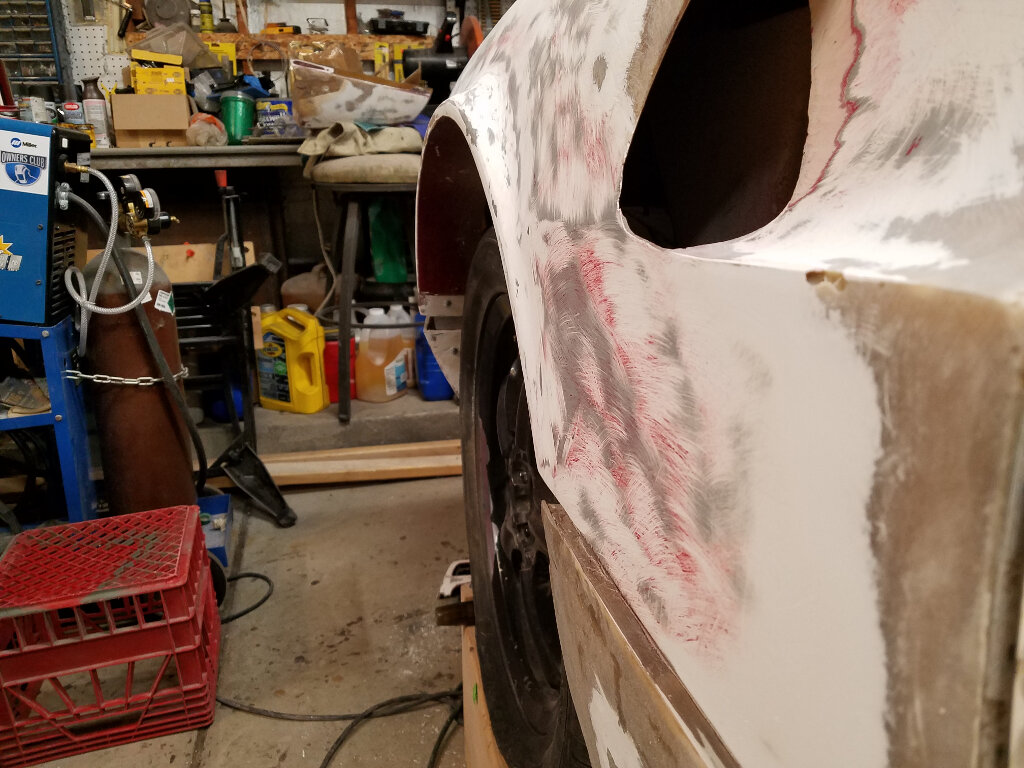

Pretty much where I'm at right now (as I sit in the AC). I've finished shaping the nose to fender transition and have been filling the top panel and grill openings.
