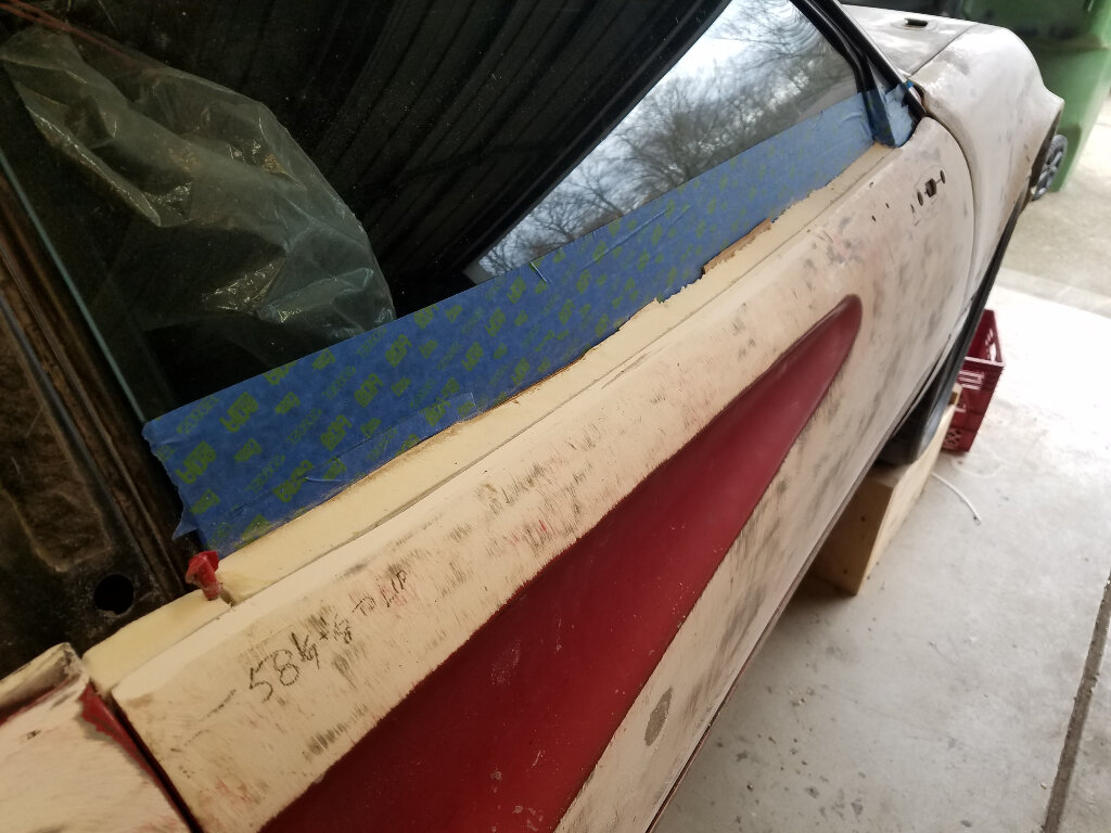

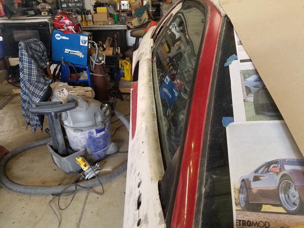

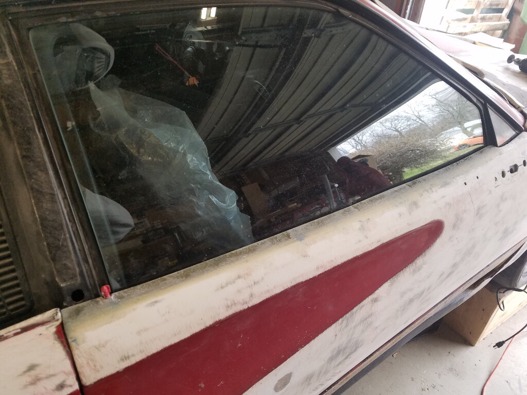

For all of the home time, still not a bunch of time to work, and supplies are low (damned gloves), but I've been tinkering and have a few pictures.

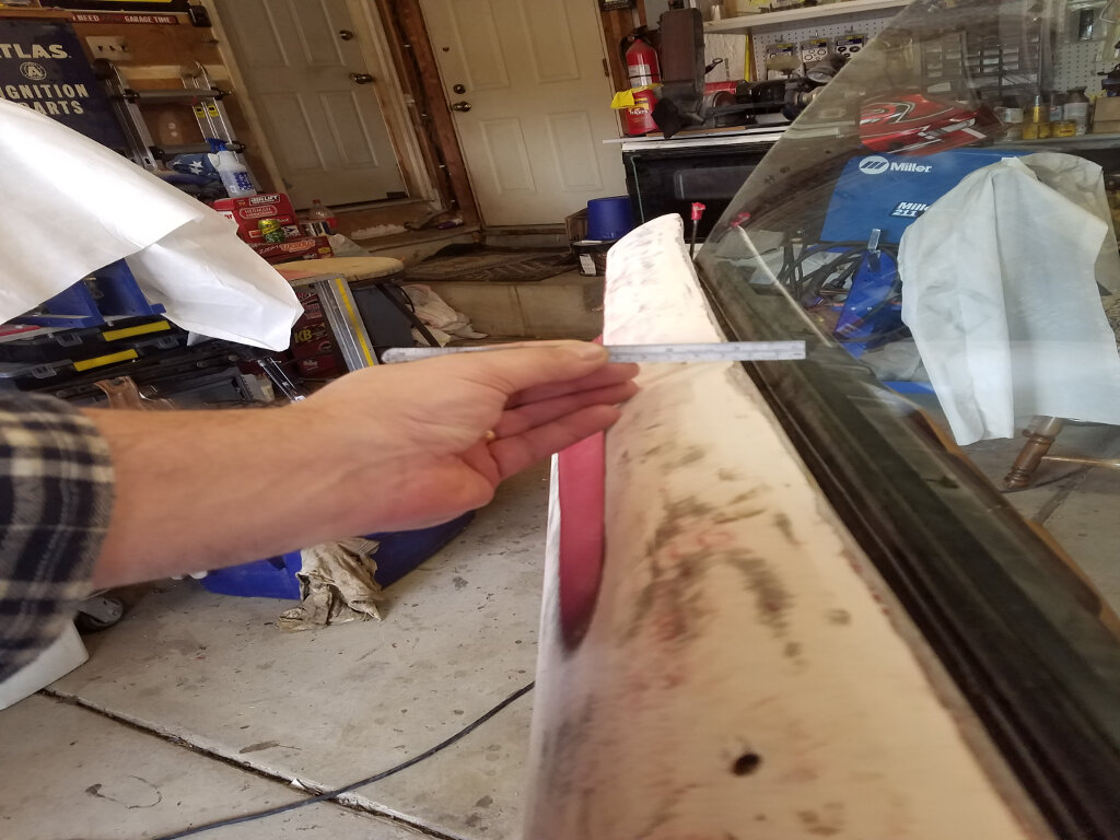

First off, the door skins have a big gap on top near the window. Really makes it look like a kit, especially on the passenger side where the gap was nearing 1".
Here's how I corrected that.
I began by taping up the window, then filled the gap with foam strips. The sanded to shape.

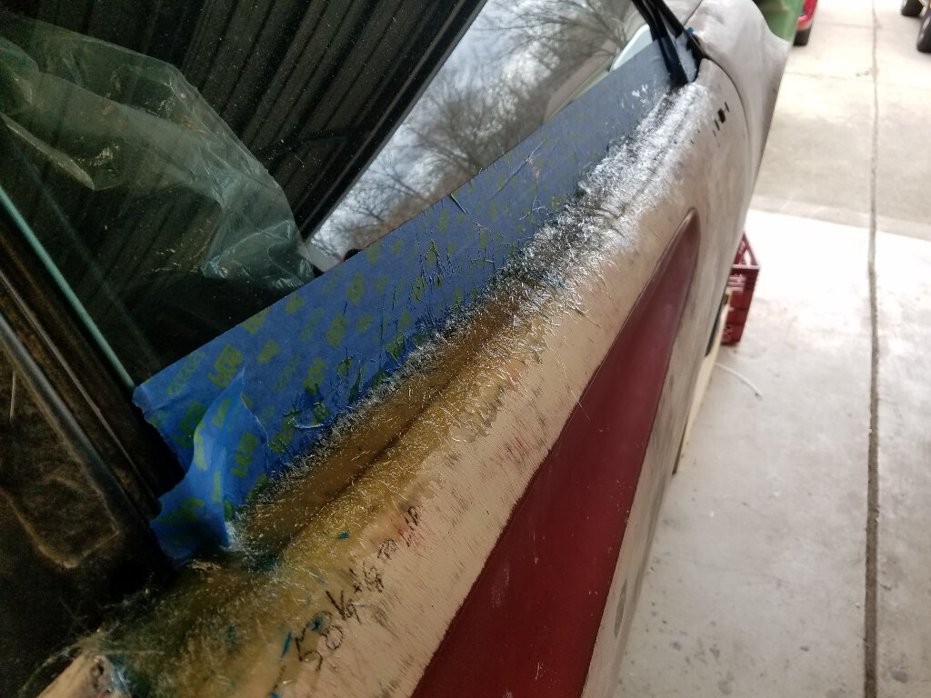

Time to get itchy. Couple layers of glass on top. Took the panel off and applied several layers below.
A little trimming and sanding, and voila, Small gap. I think it looks soooo much better. Now the other side needs to get done,

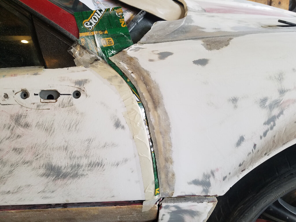

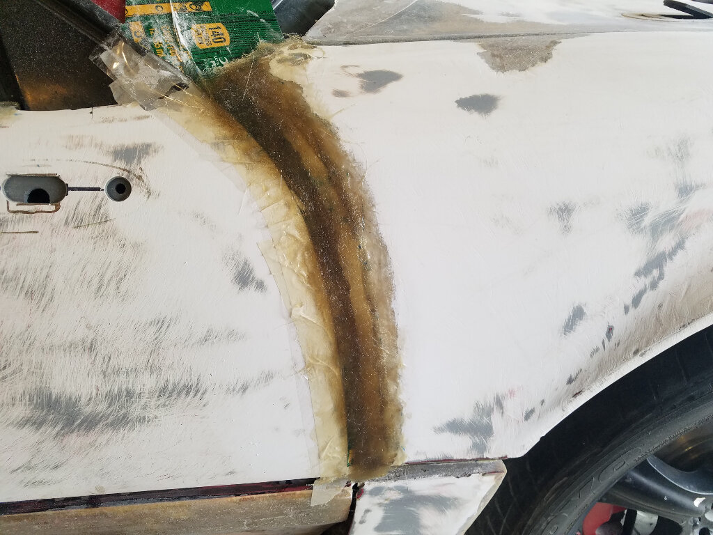

While I was at it, I started messing with the gaps a bit. I filled this door gap once, and it looked pretty good, but with all the finagling over the last few years, the gap grew. So, I guess it's time to fix. Just started, but here's acouple pics.

Bob It’s good to see you back at it! I’m surprised at the gap on the Top of the door panel did you modify the panel that much or was that The way it was molded?
I had to do a lot of work on the front door gap as well!
Keep at it and stay safe. Wayne

Hi Wayne. Thanx for coming by. Yes, it came that way. The passenger side was worse than the driver's side, probably by 3/8".
Bob
