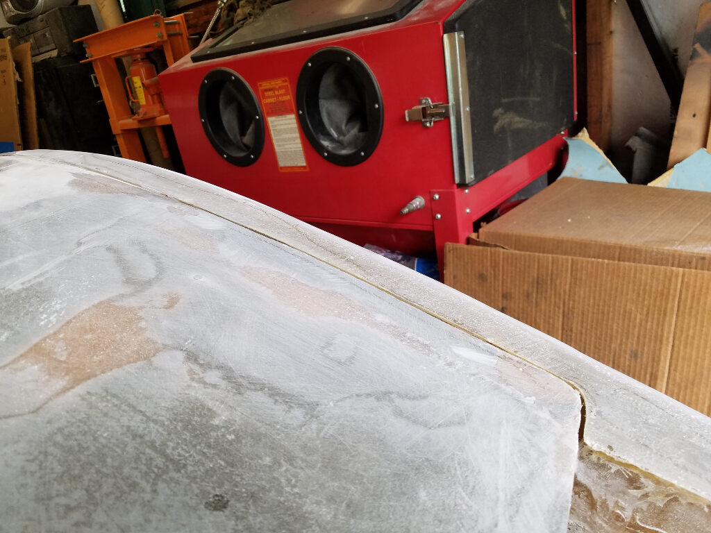

No pic update. The weather is good, but the going is slow. Laid some glass down for the first time this year. I'm filling some low areas on the nose, getting it flat.
Having nothing but trouble trying to get the hood to line up with the fenders. I knew it was going to be an issue, but I didn't think it was this big a deal. Damned those 3 dimensions  I think I have it close, but it will require grinding and filling.
Pics to come.

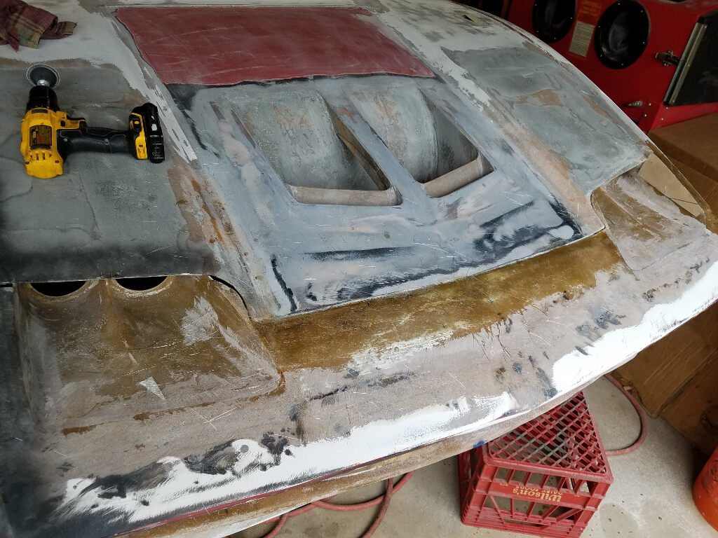

As mentioned above, I'm working on setting the hood position and fixing the gaps.
Here's where I started, filling some low spots and starting to fix the height differences.

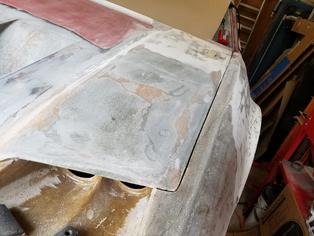

After screwing with the hood some more, I finally got a good gap and z-height along the passenger side.
But that left the fascia low, so I had to rebuild that back up.

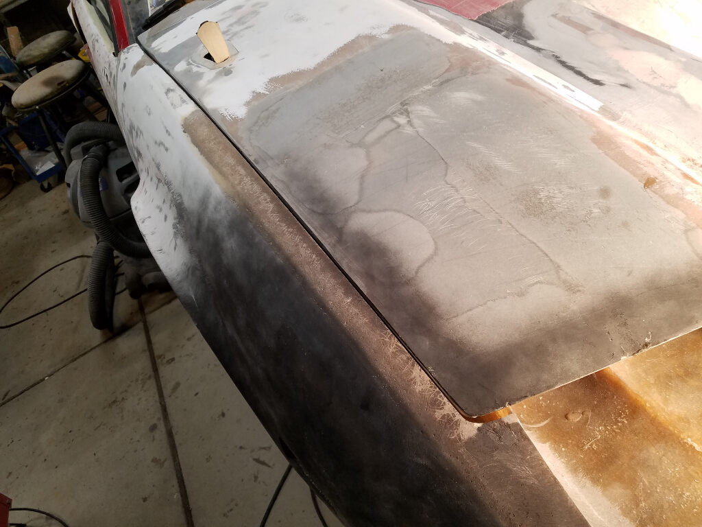

It also helped line up the driver's side, but half was low and half was high. I ground down the high spot and filled the low spot. Also taking the opportunity to fix up the head light pod.
Where it's at when the storm rushed in.
