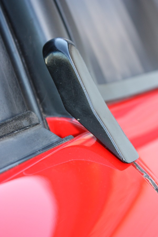

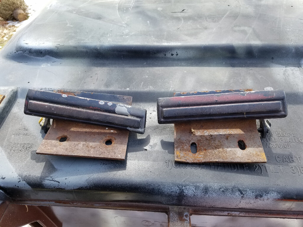

Nothing yet to relay, but I wanted to post up some info for a fellow 308 builder, and one of the items to finalize this build season is the door handles/latches.
My style kit uses hidden latches built into the body line on the door. It uses the Fiero door handles mounted to a plate that gets glued/bonded to the door. There is a hole in the body line to allow one to grab the handle with one's fingers. I thought it was cheesy and I preferred something more like the 308 door pulls, or maybe something off the 355 or newer.
(edit): After thinking about it and seeing the pics again, I don't think the plates are actually mounted to the door skins, but screwed to the door itself. That makes much more sense, but must be a bit#@ to line up with the door skin.
Here are the handles that came with my body panels.
More soon...
Bob

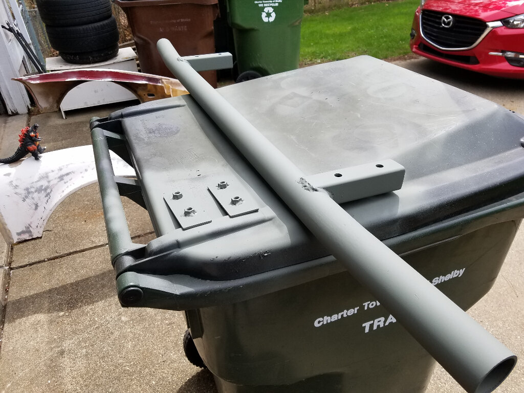

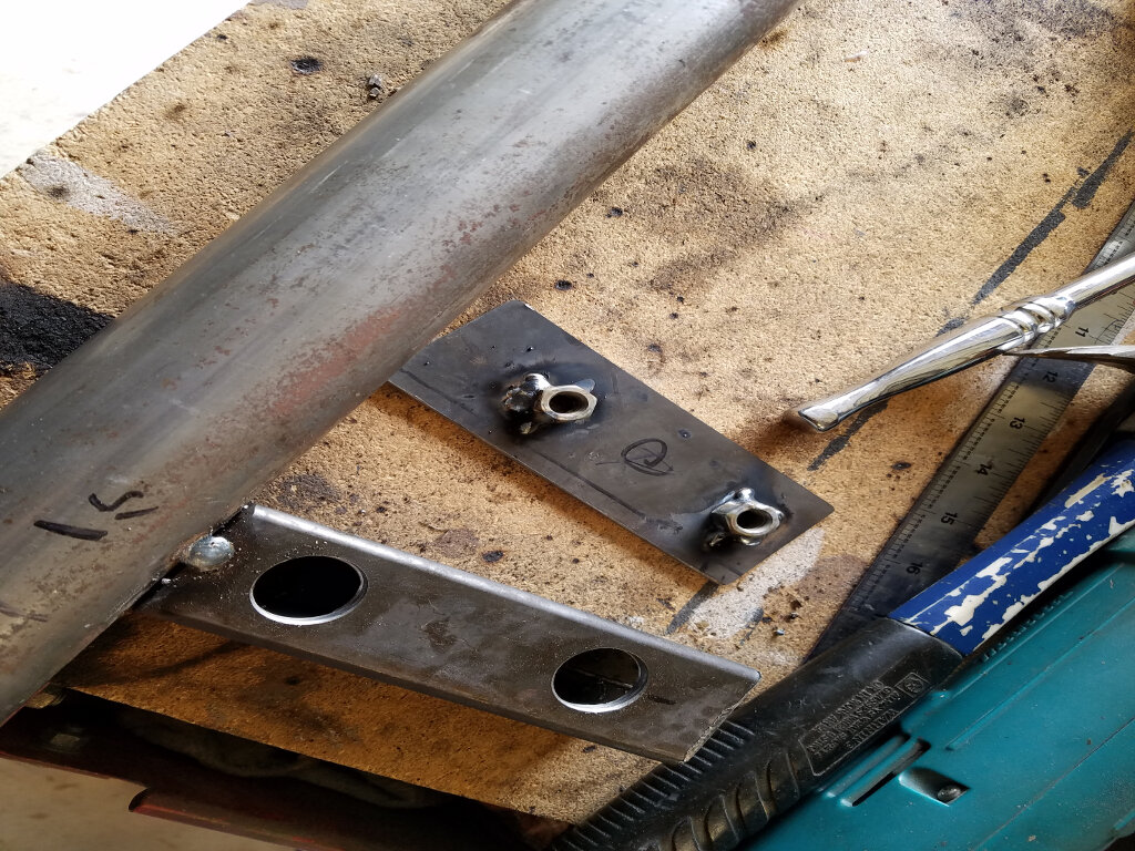

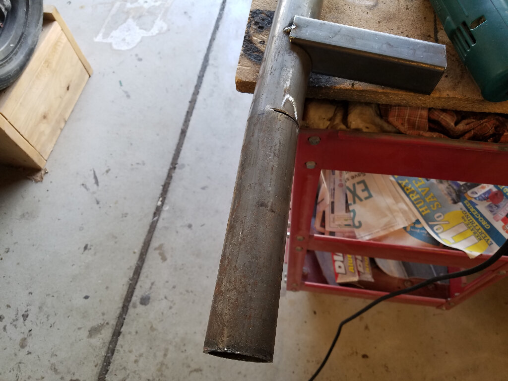

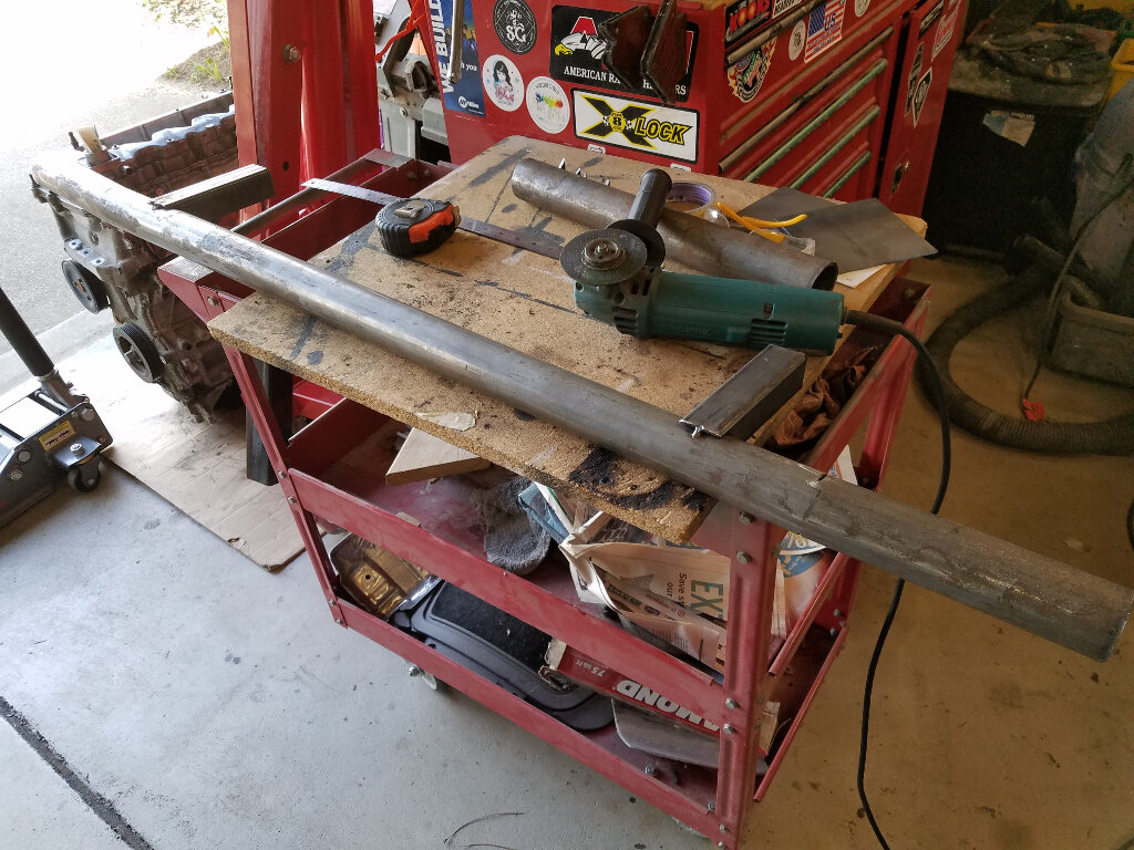

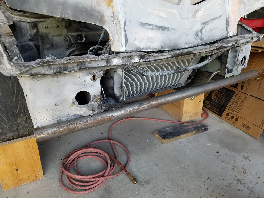

It's been slow getting back at it. But, today I got something worth posting done. I made a front bumper. I'll let the pics speak for themselves.
In a nutshell, I used some 2" x 3/16 round stock for the bumper. The ends were hitting the fascia, so I cut some slots about a foot in on each side to fold the bumper ends back a bit.
I welded some 1.5" 1/8' square tubing to the bumper to make the mounts. Then made nut plates to sit within the frame rail to bolt it all together. Grade 8 hardware holds it all together.
Now, I have less worry that in the event something goes wrong, the first major stopping point won't be the firewall. Plus, now I have someplace to mount a tow ring.
Bob
dobie1 MAY 04, 04:48 PM
Bob are you using the OEM bumper attachment points to secure to? And are you using the original kit fibreglass bumper cover over the steel ?

RCR MAY 04, 06:20 PM
Always nice to be moving forward. šŸ˜Ž
I’m busy prepping the dash pod mold to produce the the piece I need to complete the dash , sure is time consuming!
Wayne
Ain't that the truth, Wayne.

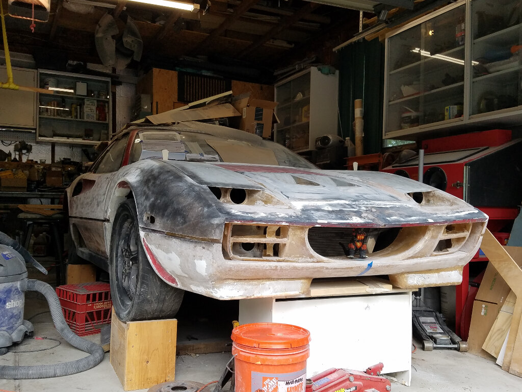

No, the new nose design doesn't use the original bumper cover. It's much lower and pulled back 3', so the bumper is slung underneath the frame rails. Not optimal, but I didn't want to move the rails back, nor block the big air intake opening.
The bumper fits behind the fascia, under the lights, air intake opening, and godzilla's feet.
Bob

dobie1 MAY 04, 08:21 PM
So now that I look at the picture I can see what your doing.
So are you going to mold the lower facia so that if you do crunch the front you can repair or replace it?
