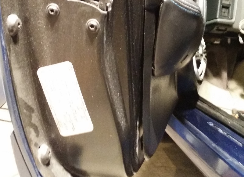

I really don't want to start another thread about this matter. I don't need to beat up your company over things that you MAY NOT have control over. But these are the simple things that can make a good sale go bad. This is the panel with NO fastener installed. The mount is pushing against the door creating the gap. Add the fastener and it adds probably another 1/4" to the gap. To have your vendor correct this may cost more than it's worth but the vendor should have tested this before doing a mass production run and shipping them to you.

With regard to the door panel picture IMSA posted, that doesn't appear to be his car, so we're assuming he has no first hand experience with our door panels. Regardless, we're happy to address the issue. Our door panels are not injection molded, mass produced pieces. Tooling for injection molding would be financially unfeasible, so we're forced to use vacuum formed plastic, which requires a great deal of trimming by hand. This absolutely leads to minor variations in fit and small gaps like the one shown in the picture should be expected. In order to make door panels that fit perfectly, the cost would be prohibitively high ($100k+). We made a conscious decision to accept that gap since it makes the panels more affordable and since very few people look straight down the door at that angle. On the bright side, the gap may help those planning to wrap the door panels in vinyl, suede, or any other material.

As someone with a tool and die & Mold Making/machining background, I can appreciate and understand that creating tooling to produce stamped or injection molded parts (which make up most of our Fieros).. would be cost prohibitive and never turn a profit. So sometimes we have to "make do" with vacuum formed parts.
