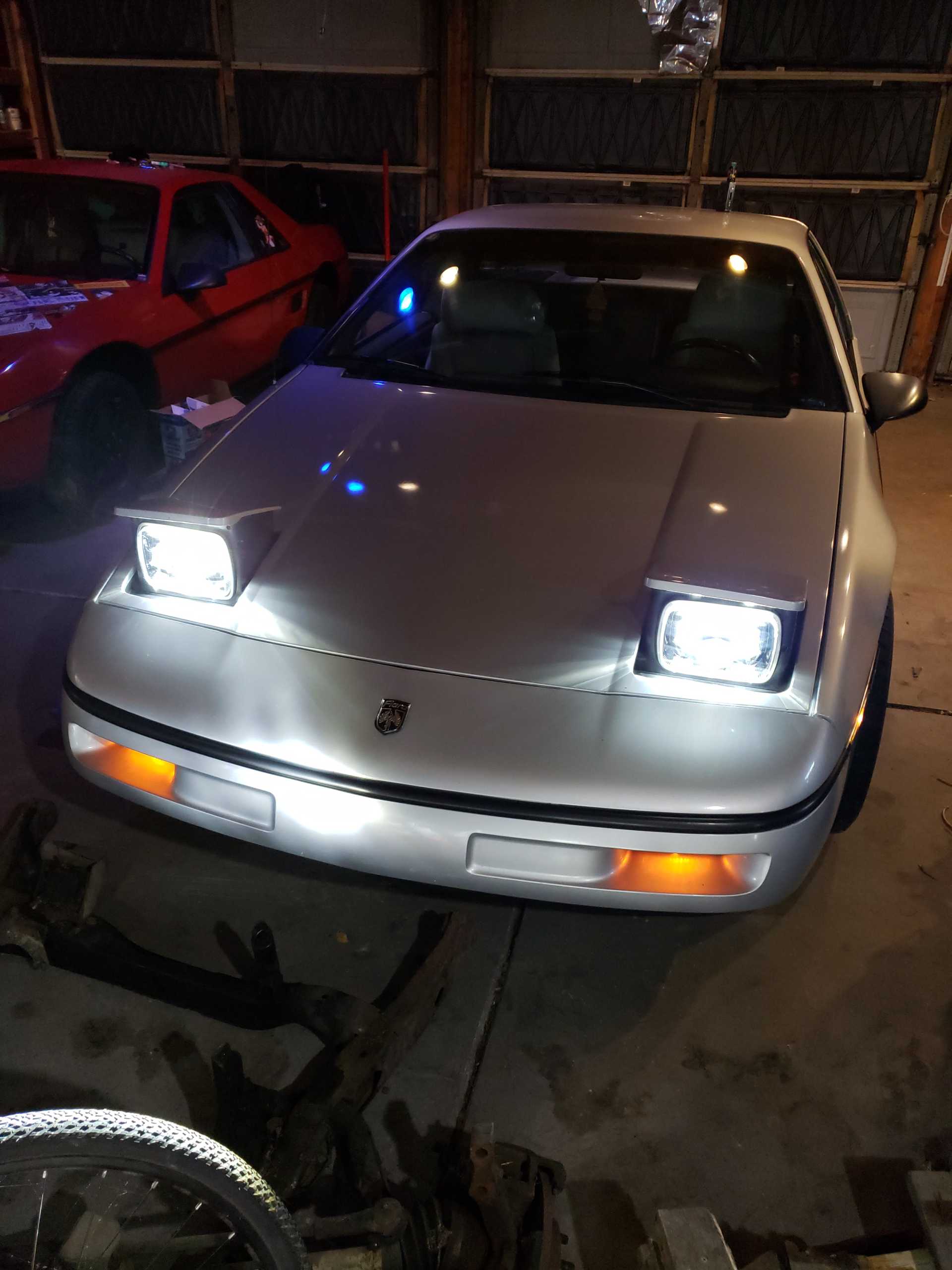

I just installed mine on my 85 GT and love them. DOT is all important for legal reasons and for proper cutoff design. I bought mine from Amazon. Grinding out the metal headlight bucket shells was a major pita, at least for the brand I bought. This is why every Fiero mechanic needs a Dremel in his toolbox. See pics... Kit [img]http://images.fieroforum.com/userimage s/Kitskaboodle/50BB0880-4270-4DD8-92DF-041F65869777.jpeg[/img]
Kitskaboodle
FEB 20, 10:28 PM
Sorry, forgot to include a pic of the buckets after grinding and painting.... Kit
