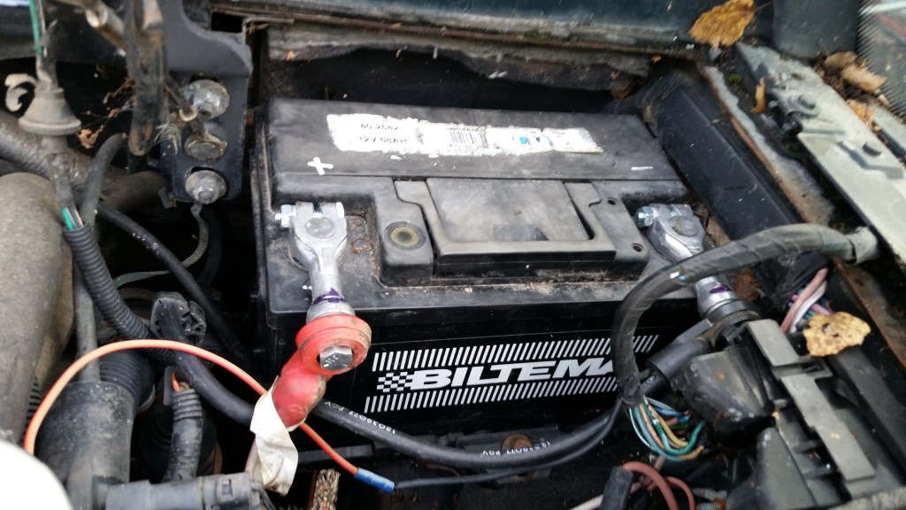

I was going to remove the weels (to bring them to the tyre-guy and let him put new tyres on them) , and to dot hat i needed to move the car.. and it was impossible to push it, so I decided to start it.. to do that i had to put a battery in, and to do that I had to fix my adapters with the imperial screws I bought last friday..
It wasnt very easy but finally the battery was in place, with adapters..
.jpg)
No, its not a new battery, its a old battery that i reversed polarity of.. partly to get a new life for it, partly because I needed a battery with the plus pole to the left, seem to work fine.
..Just have to put something to protect the battery adapter at the plus pole, dont like that it can cause a short so easy..
Then I started the engine, and Wow, to my surprise BOTH the oil-gauge AND the radio suddenly worked, yay! ..I asked my dad a while ago if the oil pressure gauge was broken when he had the car and he said no - it worked, but then he also said that when the old battery went bad "all the gauges went funny", so I guess that was the problem, probably the same for the radio ? ..when I tried to get it to work the last time I had put it on max volume however, so I got a bit surprised when i heard a LOT of sound suddenly when turning the key

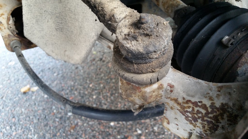

I noticed a few other things.. first of all the rubber on the links where not very nice..
.jpg)
Not sure how expensive those are, but they should be replaced..

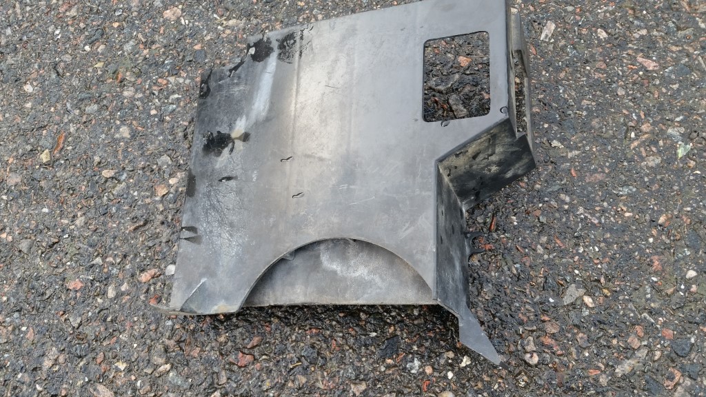

Some questions.. first of all, i found this in the car, where is it supposed to be ?

The plastic piece in your pic is used to keep the heat away from the battery. The piece fits between the battery and deck lid hinge. The 2 large holes go at the top near the positive terminal. The one most visible in your pic is where the positive cable passes through. The one on the small surface is to access the terminal with a tool. The leg at the lower right should have an eyelet in it. It accommodates a small metal screw and washer that holds it to the battery tray. At the top left should be another small leg shaped like a hook. That hook supports the back corner of the insulator. The arched area was for clearance of a pulley. Since the same shield was used on all Fieros, it was probably for a 4-cylinder. That piece is in rough condition but it could be installed to give some protection to the battery.
