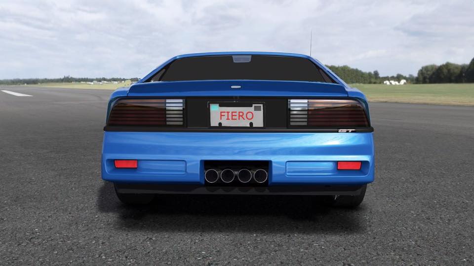

Now that the hood is done its on to the mods to the rear. Our plan is to do a center exhaust system on a coupe bumper, shave the existing tail pipe holes and move the plate up to the tail lamp panel. The lights will have to be a custom glass panel with some built in leds.

Ok so its been awhile and not much progress has been made but I do want to drop a couple things here on the page. Thanks to Terry Ray on the facebook page our vision on the rear is now starting to take shape. This is not an exact match but pretty close. The hips on the rear of his vision aren't quite what we have but other than that is a pretty good vision of where we are headed with this build.
