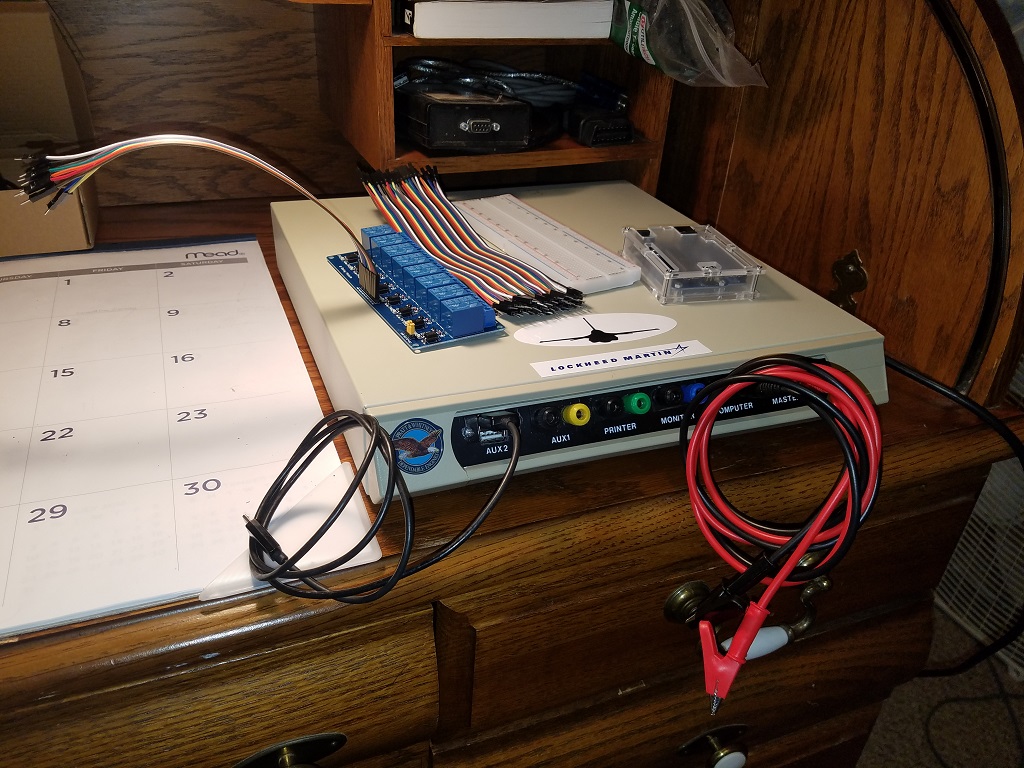

I'm curious to maybe just splice into the lights from a single point in the cabin if possible. This would of course mean isolation diodes to use the original harness. I have my Arduino and relays now, I am going to start proto typing on the bench for now with a bread board and some diodes. I built a really cool power supply from an ATX power supply for a computer. I put it in an old computer surge suppressor switching thing. The labels on the face of it were the switches that controlled the outlets on the back of it which I removed.

It might be possible, but I think the problem is that all the lights are connected together on each side so power to one will light the other. Also on post 84 models only the outer 2 lights have the running light and flasher light. The inner one has only a running light. So you will need to find the socket with the flasher and running light (can find used or at auto parts store) and put that in. Which will require messing with the harness already. I cut the wires (which I normally do not prefer) and then put connectors on them, so If I ever want to switch back to stock I can just disconnect my harness and reconnect the originals. If you figure out a simpler or less obtrusive way to wire it up, please share! I would appreciate it for use on my other Fieros and I'm sure others would like it too. Some judicious studying of the wiring diagram may reveal a better way to go about wiring everything up. I skipped that part and regret it as it was sort of trial and error to get it working.
Anyway, your testing setup sounds cool! Looking forward to seeing what you end up doing!
