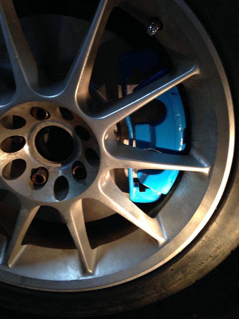

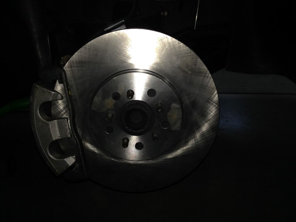

Almost by luck, I stumbled across RCR's 13" brake kit for the 88 fronts, you can find it here.
Bought the camaro calipers (2002 z28), and 3 sets of rotors trying to find the perfect match, but I ended on the 2004 Mustang Cobra rotors, just had to redrill them to our 5x105 bolt pattern
Bolts are not tight in this pic, that's why the caliper is way out there
Finally mounted up properly
They are actually exactly the same color, just the lighting is different.
Barely clears the stick-on wheel weights!
12.85" rotor with calipers and a 17 wheel.

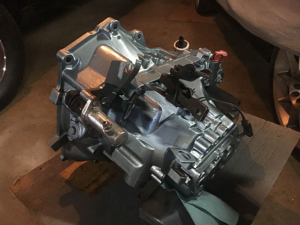

Got the 5 speed cleaned and painted, then reinstalled
(Ignore the beat-up slave cylinder, it has a new one now)
Also new axle seals to replace the leaking driver's side
