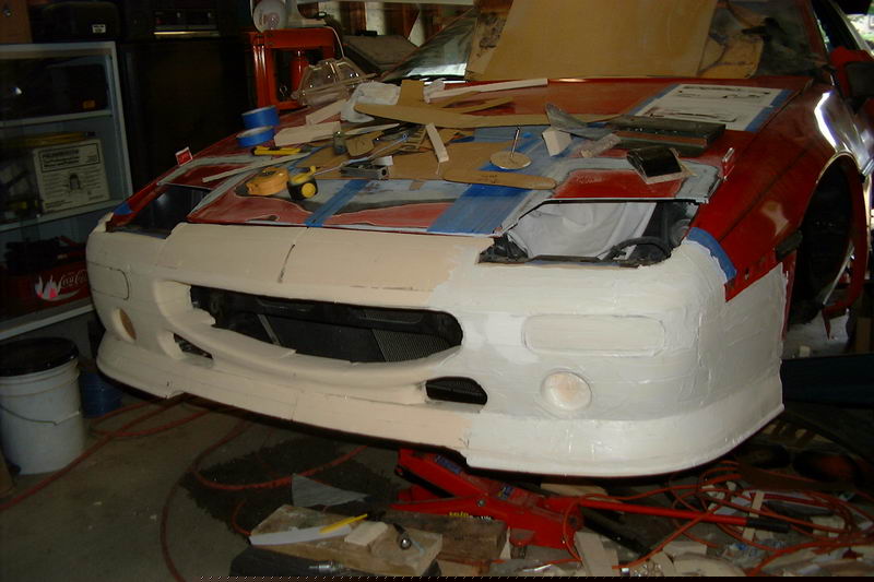

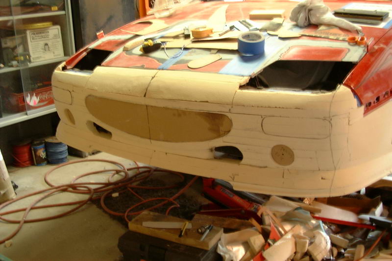

Here's another shot of the front coming along
I'm going to use drywall compound (mud) to finalize the shape and smooth everything out. Here is my first attampt, starting only with a portion of the driver side.

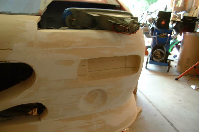

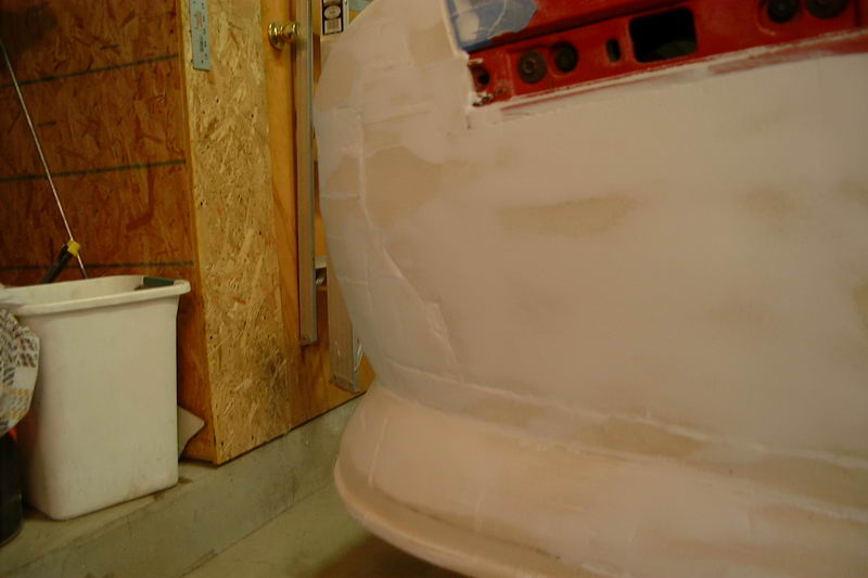

Closer shot of the side, showing some of the seams.
I thought I would try to make it even harder on myself, so I made a pocket for the light.
Although the mud is easy to work with, it's proved to be a very slow process because it takes a day to dry.
That's it for now. I've got 5 days to work on it (vacation) so hopefully I'll get some progress. Still need to match the driver and passenger sides better and there's a whole lot of mudding and sanding to do.

RCR, Are you using setting drywall compound? It's much faster.

Much too slow; I"m glad I used bondo on the Fi355 nose. I must have re-applied bondo dozens of times to fill low spots. If I had to wait a day for each application I probably would still be working on it.

You are absolutely right. After putting the 500W lights in front to help expedite the drying, and it still didn't help in this 100% humidity, I've switched to good ol' Bondo brand filler. Now, back to sanding.
