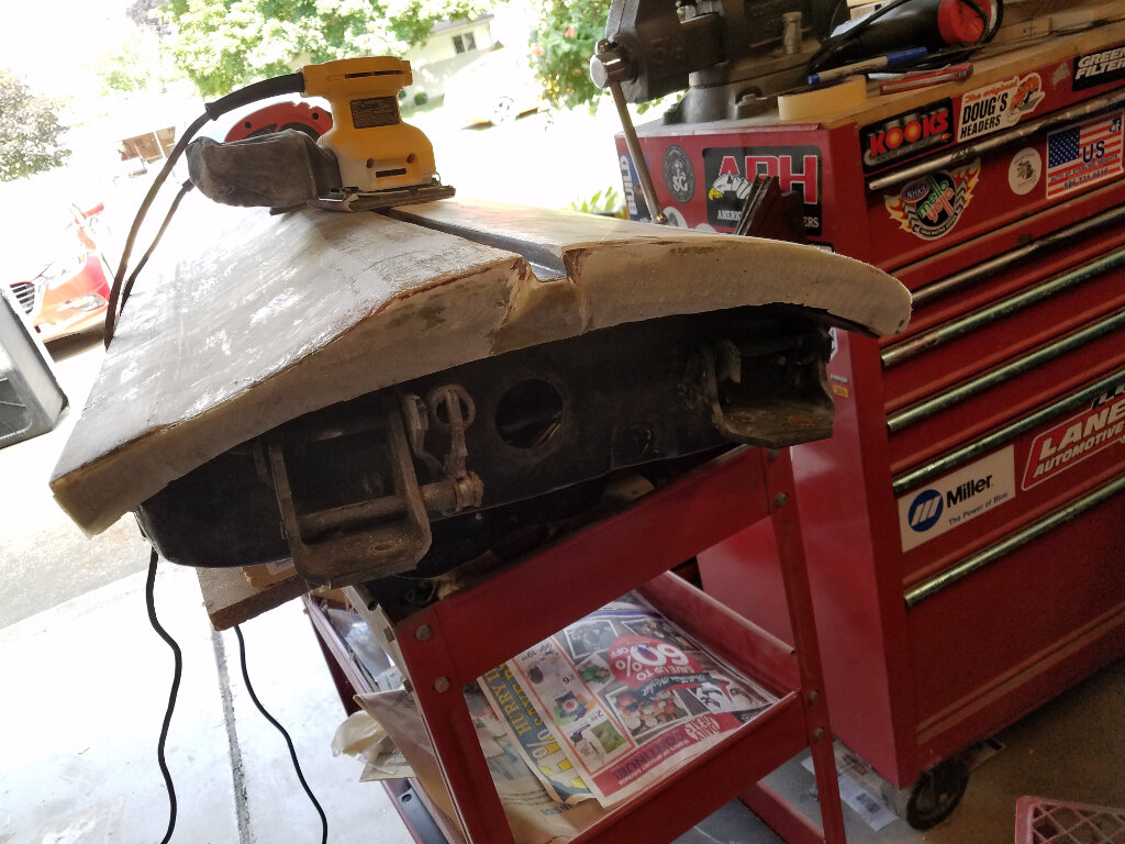

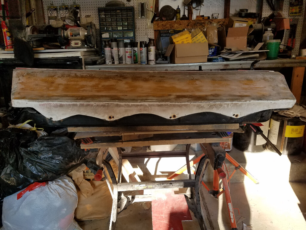

So, we left off with the rocker panel. Next on the list was door panel. It needed a lot of cleanup: mounts needed to be finalized, the bottom flanges needed repairs, etc. I started with the bottom.
Here are the bottom mounts before the rework
And after
Then I reworked the front edge and the top most panel mount.

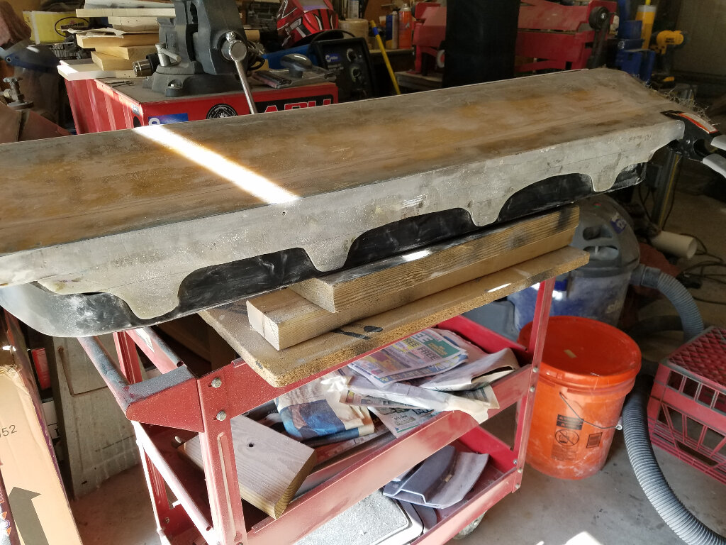

Then I tried to make a blockoff plate between the top of the panel and the Fiero door. It didn't work well, but here's a pic.
Turns out the angle was off, so it's not really blocking much. Maybe next time around.
Also, had to find a way to fix this.
Turns out the top portion/edge of the door is more gel coat than fiber glass. When I glue the blockoff panel in, I filled this hole with SMC adhesive. So far, it looks good.

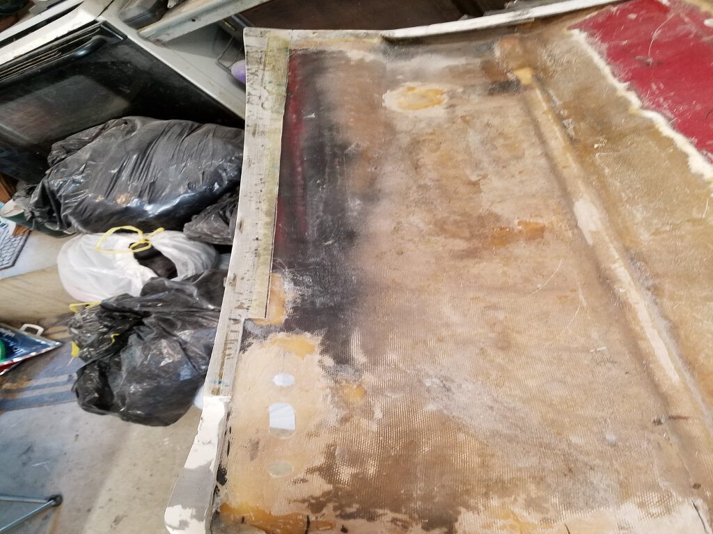

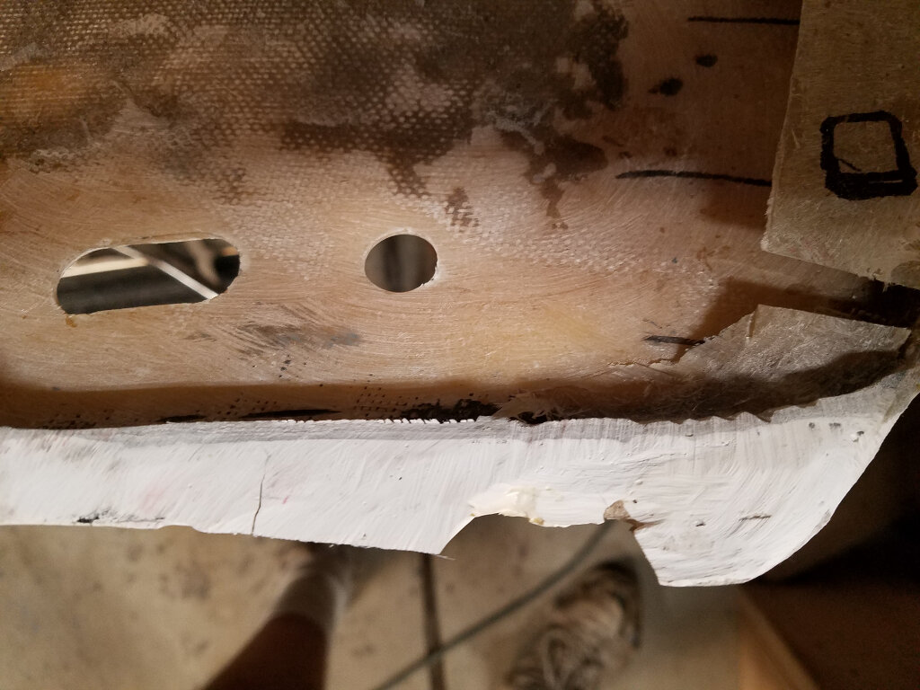

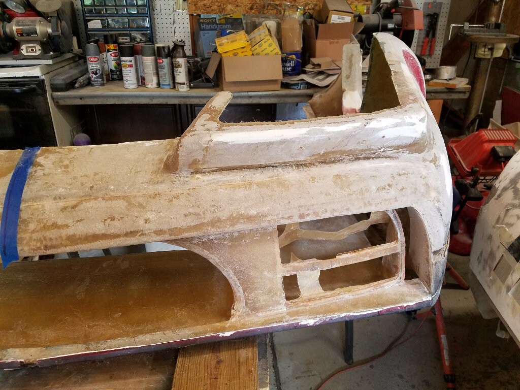

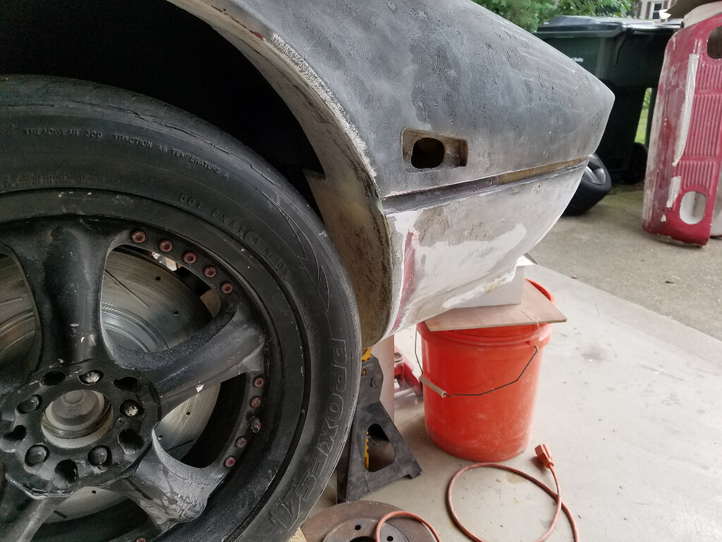

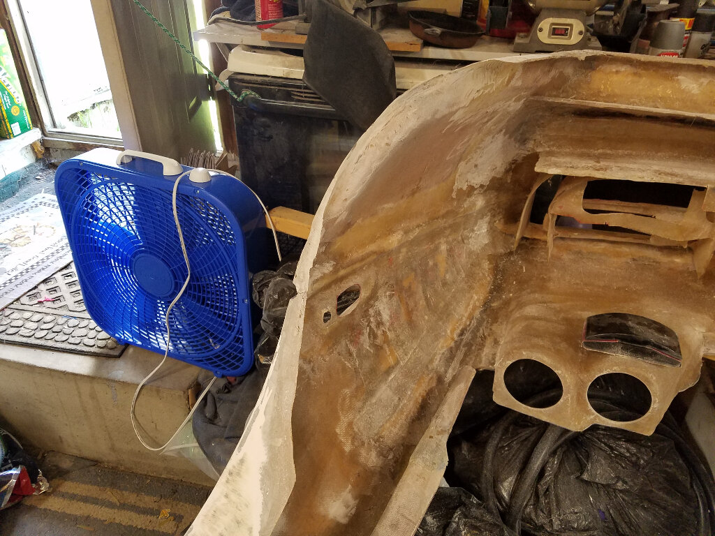

The previous owner had worn off the bottom edges of the fenders. The front portions were missing part of the fender flare and wheel well support. The backs were missing the wheel well support. So, I had to create all new pieces.
This picture show the area ground down and ready for the facelift. The flare had to be added first.
Then the wheel well area.
There were areas between the fender and the light pods that needed to be filled. Cleans it up and adds some strength.

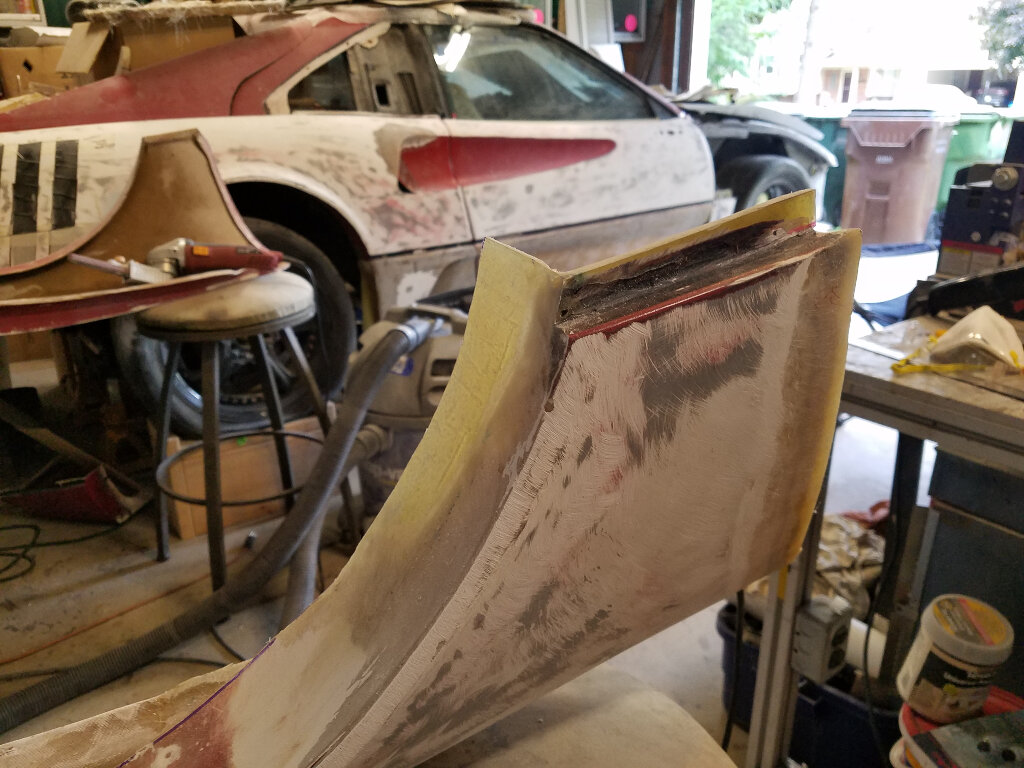

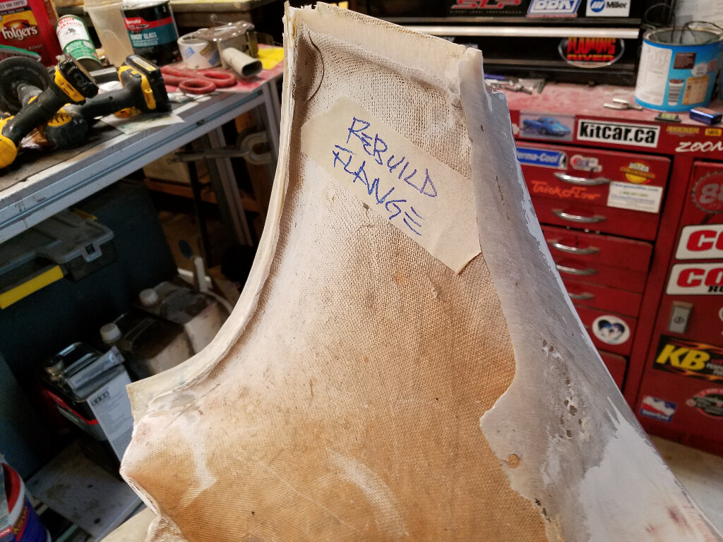

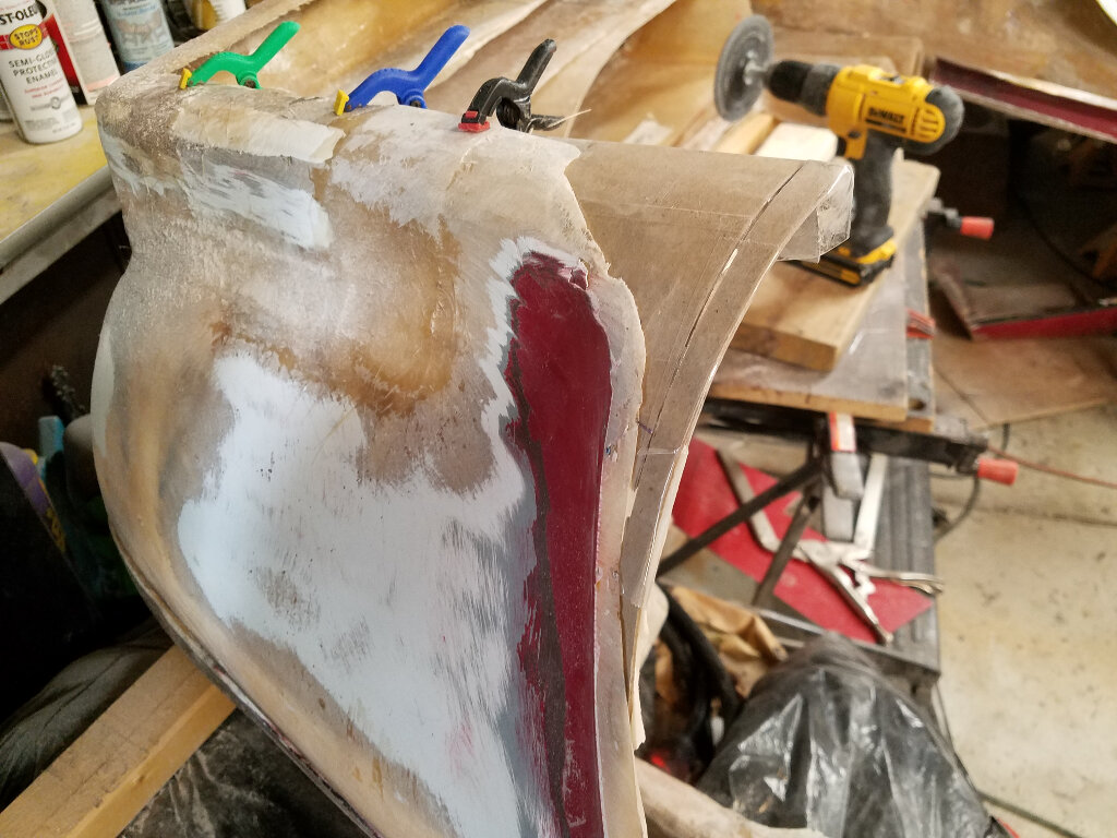

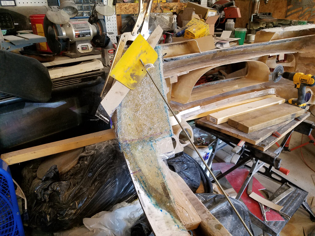

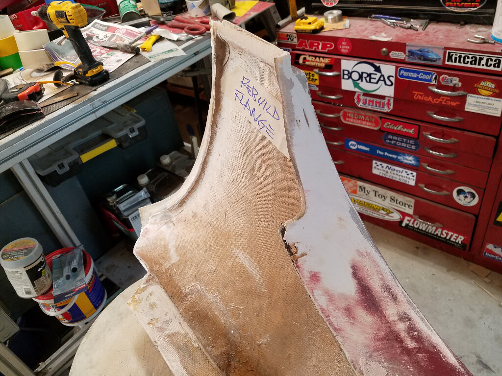

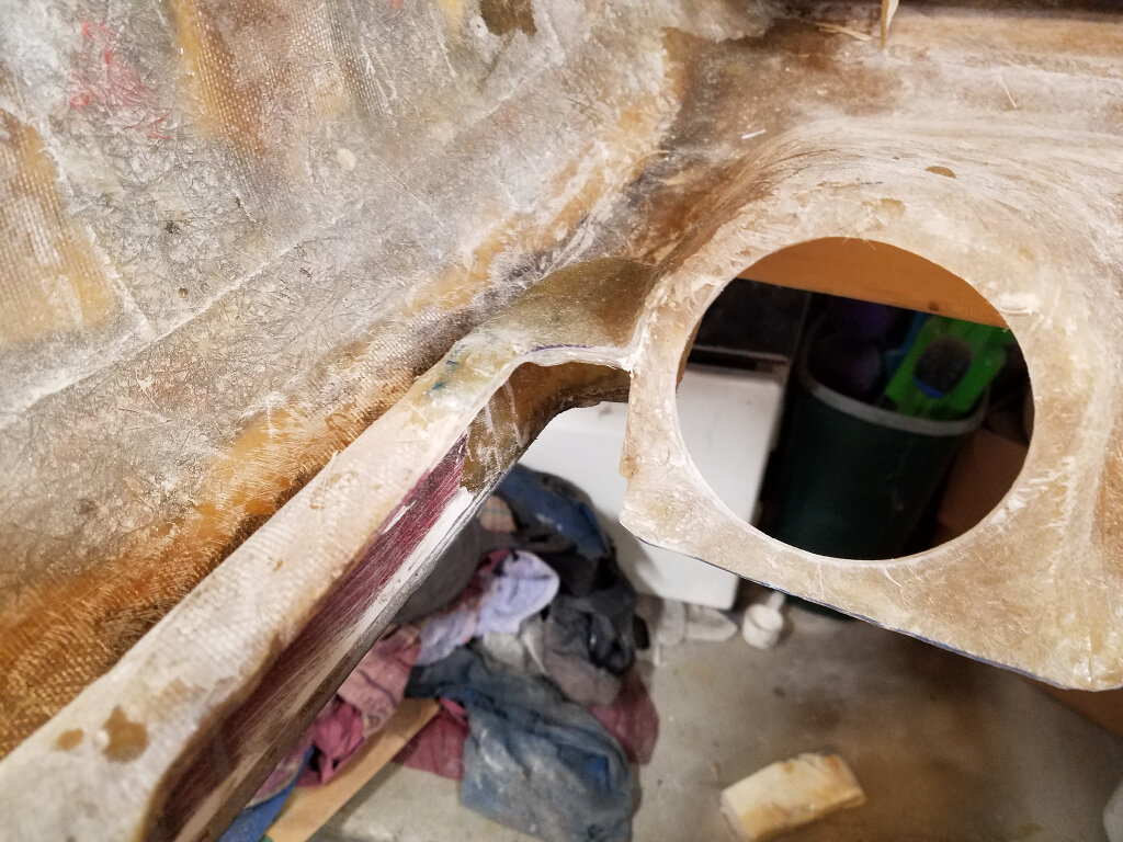

Then, moving back, the wheel well arches needed to be repaired and the fender flanges needed to be repaired. Here, I took a little more care with the pictures to give a better idea on what I did.
Here's the offending area with the red paint ground off,

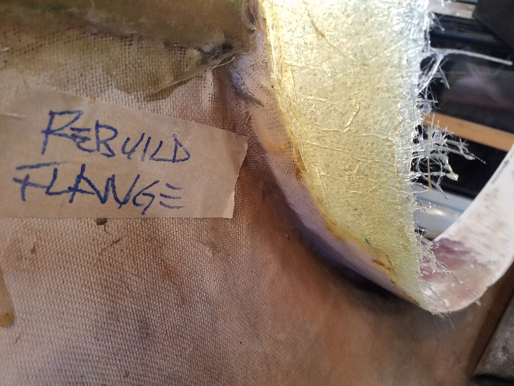

Then I grind the area back, tapering the edge so that the glass is very thin. I stuck the notes all over as a reminder of all that needed to be done.

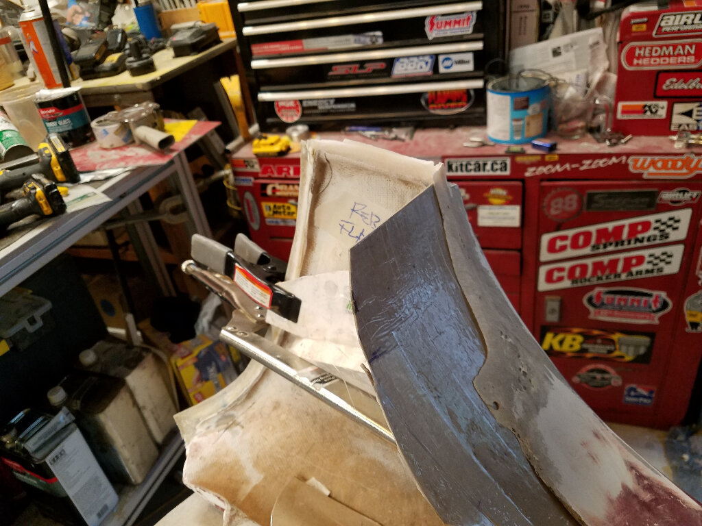

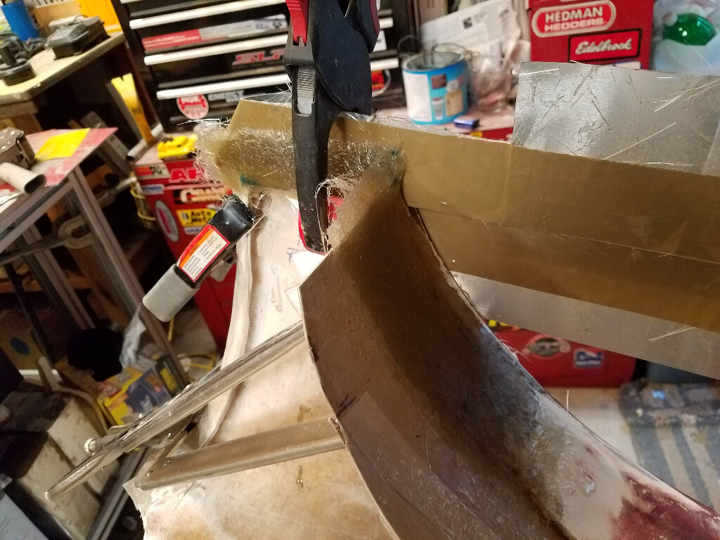

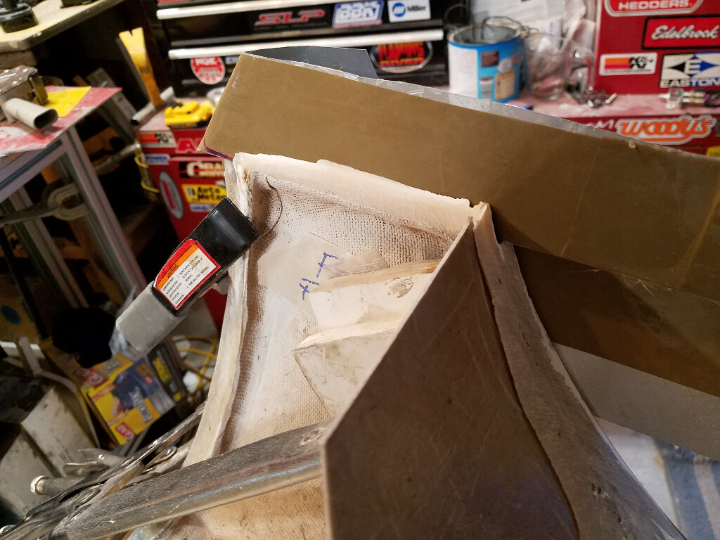

Once satisfied with the cleanup, I made a pattern out of heavy stock cardboard. Once the fit was good, I cover it in packing tape.
Then I added the flange template I made a while back to create the flange between the panels. It too is covered in packing tape.

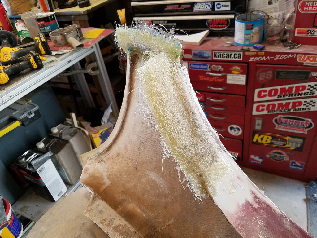

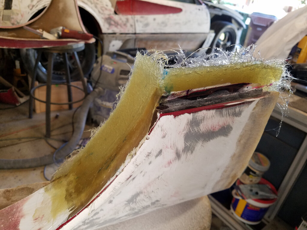

Once the templates are supported (clamps, wedges, tape), 4-5 layers of glass added.

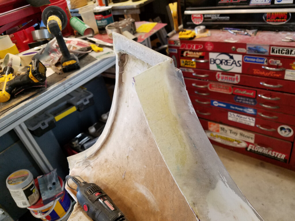

That was enough work last night, so this is what it looked like this morning with the templates removed.
Then, everything is trimmed and rough sanded.
Rinse and repeat (x3).

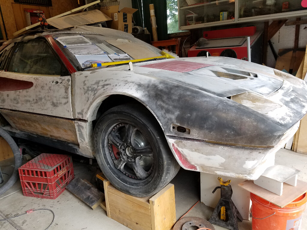

Front fenders placed back on the car. The wheel wells do look better.
Money shot.
Now, the next bit of fun time. The nose. Time to get to that and clean it up.
Front back off. Working on the lights for the "I lost count"'th time.

Wish we were closer to each other...I think we might work well together....we seem to use similar methods.....the shot of doing the well opening where you have the squeegee, the scrap of glass, the vice clamp and the prop rod.....priceless!....and something I'd do and have done in the past! Got a good chuckle out me!
