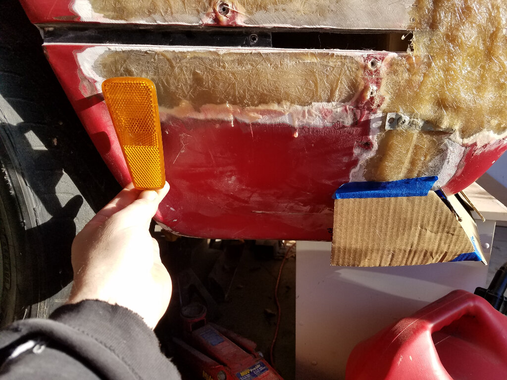

Starting to look at the mods for the front so I can button that up. Still a little cold for glass, but CAD works.
Here's what I'm thinking. Any thoughts?
Also bought some HHR side markers for the front.

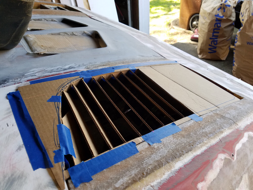

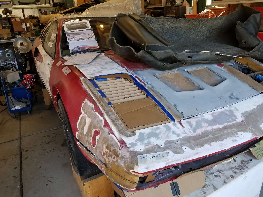

Playing with the CAD some more. May be changing up the hood and lights a bit.
And the possible view through the louvers.
I also had a few thoughts about the nose and valence.

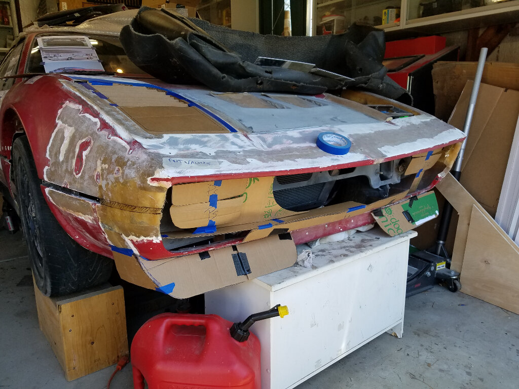

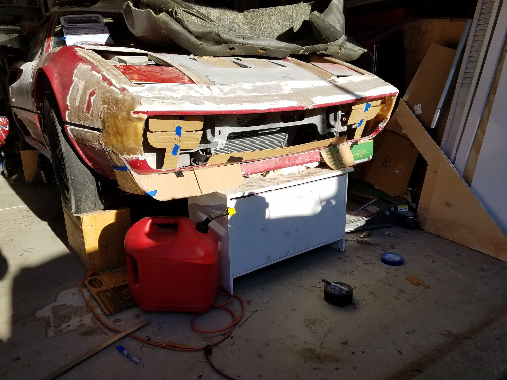

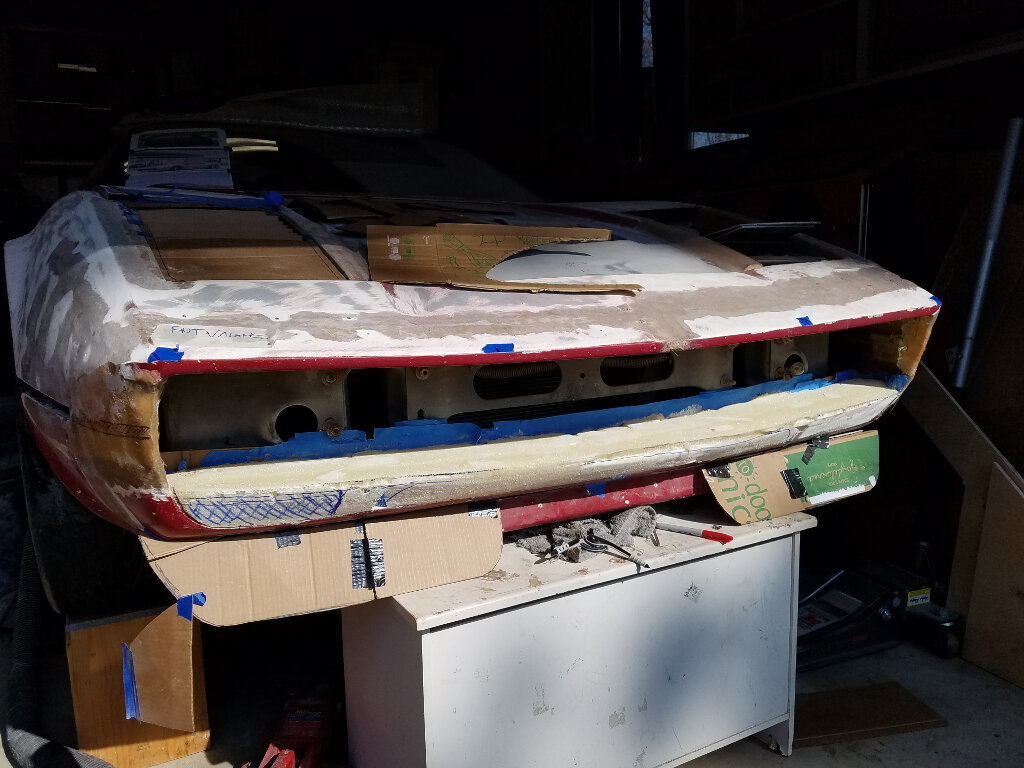

RCR APR 14, 07:00 PM
Had some fun today.

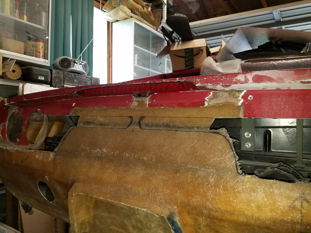

First off, I roughed in the third brake light. It's a Subaru piece, although I saw a Nissan piece that was identical.

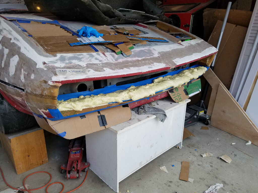

Then I started working on the front. I decided to break out the foam to create the shelf for the lower valence. Then a lot of sanding and measuring. Tomorrow I'll work on the profile and if the weather permits, break out the glass.

That spoiler brake light looks great! Excellent job fitting it. :thumbsup

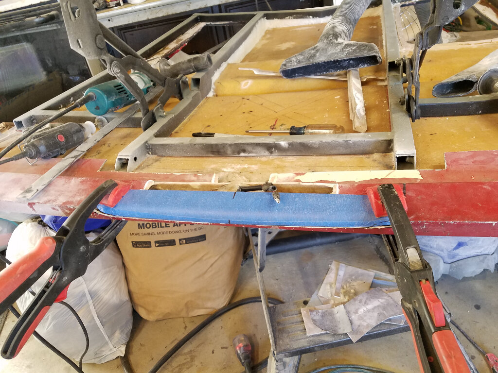

Lots of work, small update.

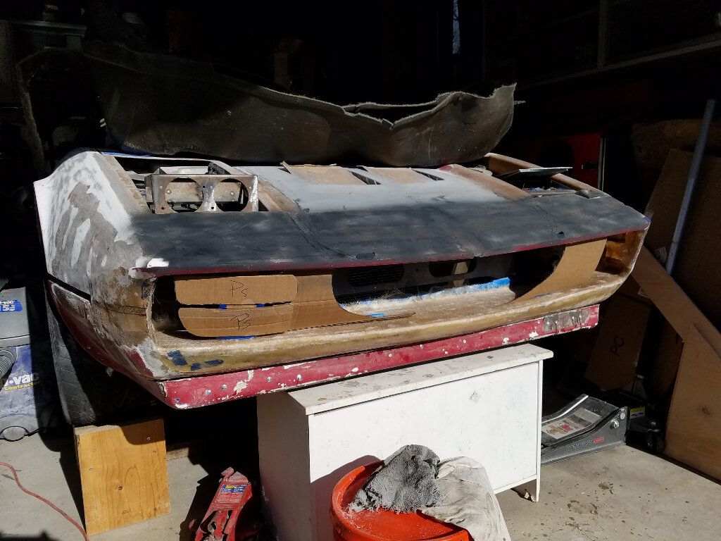

The new shelf is glassed in as far as I can go on the outside. Once the front comes off, I'll pull the foam and reglass the inside. Now I'm working on the lights and re-configuring the front a little.
I think I'm going to center the lights on the head lights. This will move the brake vent from the bottom under the lights to the side of the lights.
We'll see. I change my mind often
The next challenge is figuring out how in the heck the lights mount. No Preludes in the local junkyard. Hmm???

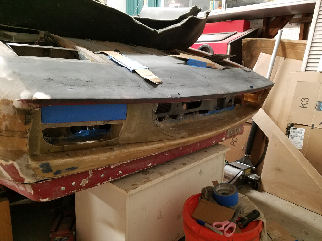

Well, a lot of work went into it the last couple weekends, without a whole lot to show for it. I think I'm on my 4th iteration of running/fog lamp mounts. What a PITA. I have no clue how Carlo and Amida have done this in the past. I'm just trying different things until it works.

Thanks for the encouragement. I've been watching your trials with that spoiler. I wish I had something to add, but a meager rear deck took three iterations. I told my wife about the lights and she sincerely said "no wonder it takes so long.". And she's absolutely right, because I (we) have to make it right.

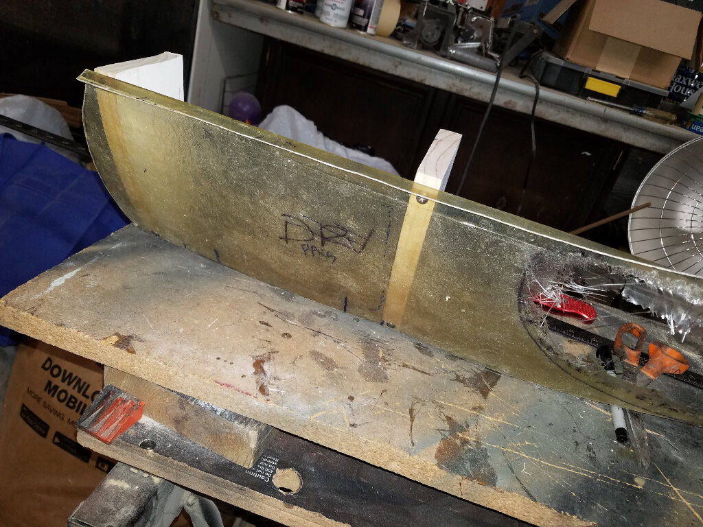

So, here's a couple pics...

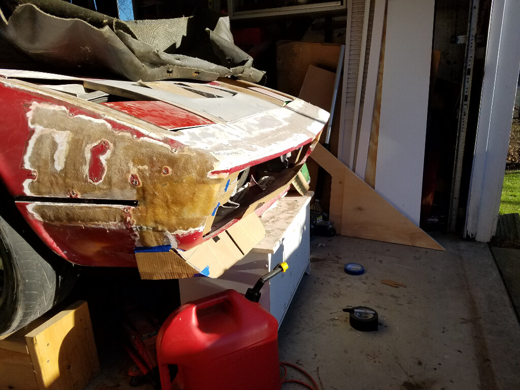

Forming the front of the lamps/fascia to the right curve. My first use of wood for shaping something.
^^ note that panel was meant for the driver side until I realized the flange was in the wrong direction. Oops
Here's the panel roughed in with the turn signal. I think I'm going to pull it back a little to give it a deeper look.
