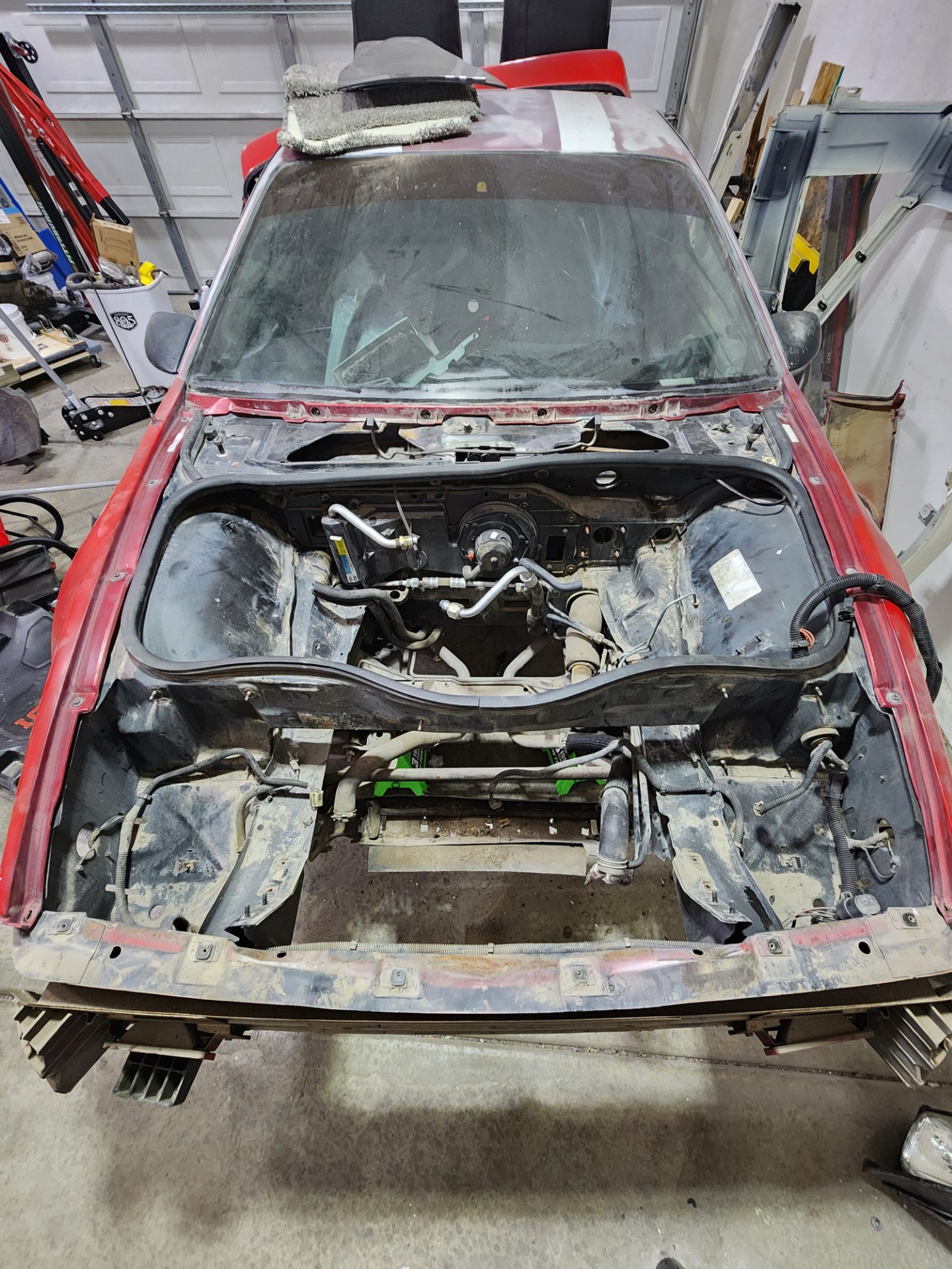

I haven't fallen off the face of the Earth (completely)! We've had a lot happen over the last year, and my Fiero has taken a bit of a back seat to more pressing issues/projects/demands. I'm back in the saddle, so update time!
The engine I sourced ended up being blown. Check compression I guess? I'm keeping it to pick the peripherals off of, but am working with Milzy to source one now...I paid the ignorance tax once already. I also found a very low mileage F23 with the right bolt pattern and it is arriving next week. I also have just about everything ready to do my front end, so that's where we're starting.
Coincidentally, AJ's most recent videos are all Frunk restoring how-tos, and they are REALLY good: https://www.youtube.com/watch?v=QiuOvzlN7Fo https://www.youtube.com/watch?v=KHlaJByPkw8 https://www.youtube.com/watch?v=nvgRJyys2Vk
Getting the Frunk torn down seems like a great way to get started, so following along the tear down got me here last night:
Todd, please pass my thanks to AJ for doing those. She saved me hours of time and tons of frustration. It is VERY cool that you two are doing those together.
In the meantime, I'm working with Guru to put together a plan that makes sense for my rear suspension!
I'll get some more pictures taken...there is a ton I've missed in this update.[This message has been edited by NewDustin (edited 12-18-2025).]
