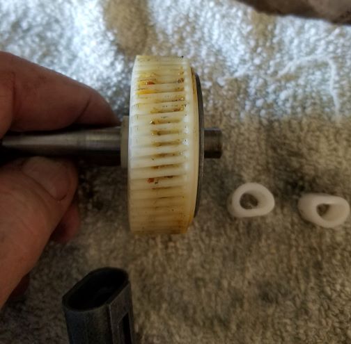

Whenever I get my hands on a Fiero that has sat for a while there are just some things you have to assume need work and with 113K miles I felt like the headlight motors would be one of them and I was right. The new pucks are on top and the original ones just below them.
You need to check the gear teeth as well, if any are damaged you will need to replace the gear. I got lucky and both are fine. a little white grease and it can all go back together.
Next is a little clean up of the headlight assembly and put it all back together.

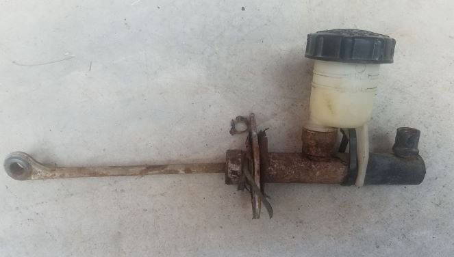

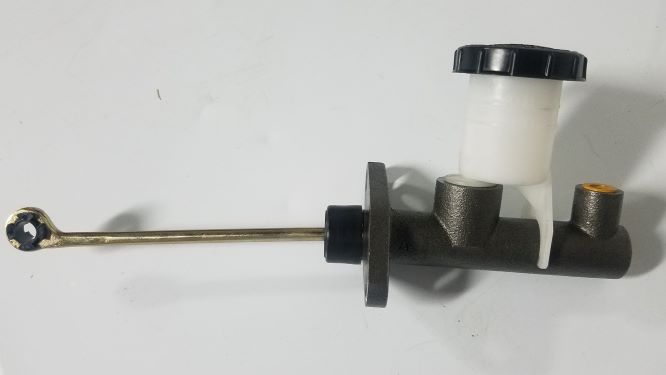

The original Master Cylinder from the donor car is not much to look at. Also, rebuilding it is not much cheaper than just replacing it so out with the old
and in with the new. I prefer cast iron to the original thin steel. If you want to, you can paint it for a clean look but the cast iron is stronger and thicker than stock.

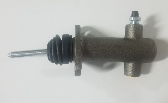

That goes for the Slave Cylinder as well
