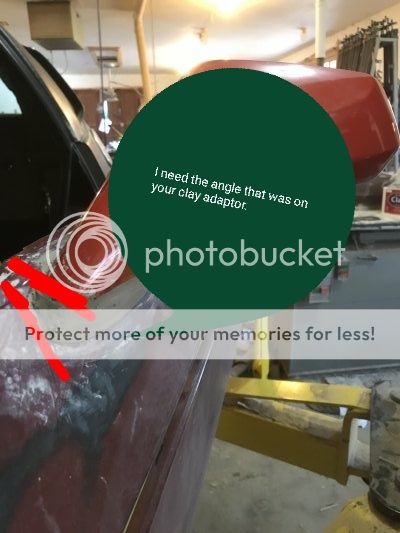

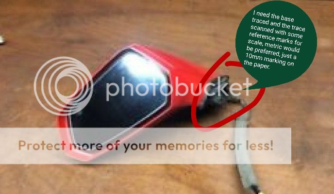

jmbishop DEC 17, 04:11 AM
I'll take a crack at making a file for you if you want.
The first thing I'd need you to do is trace the opening on the mirror where it mounts to the car. A picture of the trace would be ok and measurements for reference but it would be much better if you could scan it for minimal distortion with markings for scale.
I'd want good pictures of the mounting of the mirror. as well as mounts on the door(i don't plan on taking my mirrors off to take pictures or measurements)
I'd need the angle of your adaptor, you can do this with a smartphone but an angle gauge would be better.

The clay I used is a hobby clay that is supposed to dry hard and I am hoping one can get any measurement as one needs from this model. This morning when I examined it it had shrunk just enough that the adapter is separating from the door. I was surprised as I thought this would be the hard part!
To get the angle of the adapter I used a sliding T bevel and then transpose that to my compass.
[This message has been edited by kgoodyear (edited 12-17-2017).]
kgoodyear DEC 18, 07:57 PM
the modeling clay was a major flop. back to the drawing board. (

jmbishop DEC 19, 09:48 PM
kgoodyear DEC 20, 05:58 PM
I printed out a 1/4" graph and traced the base of the mirror housing and included the gasket. The gasket is slightly larger than the tracing.
I still have to figure out the angle of the mirror to the door. That will come tomorrow.
