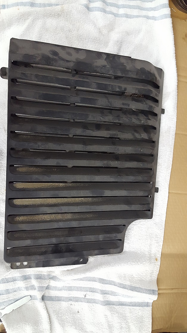

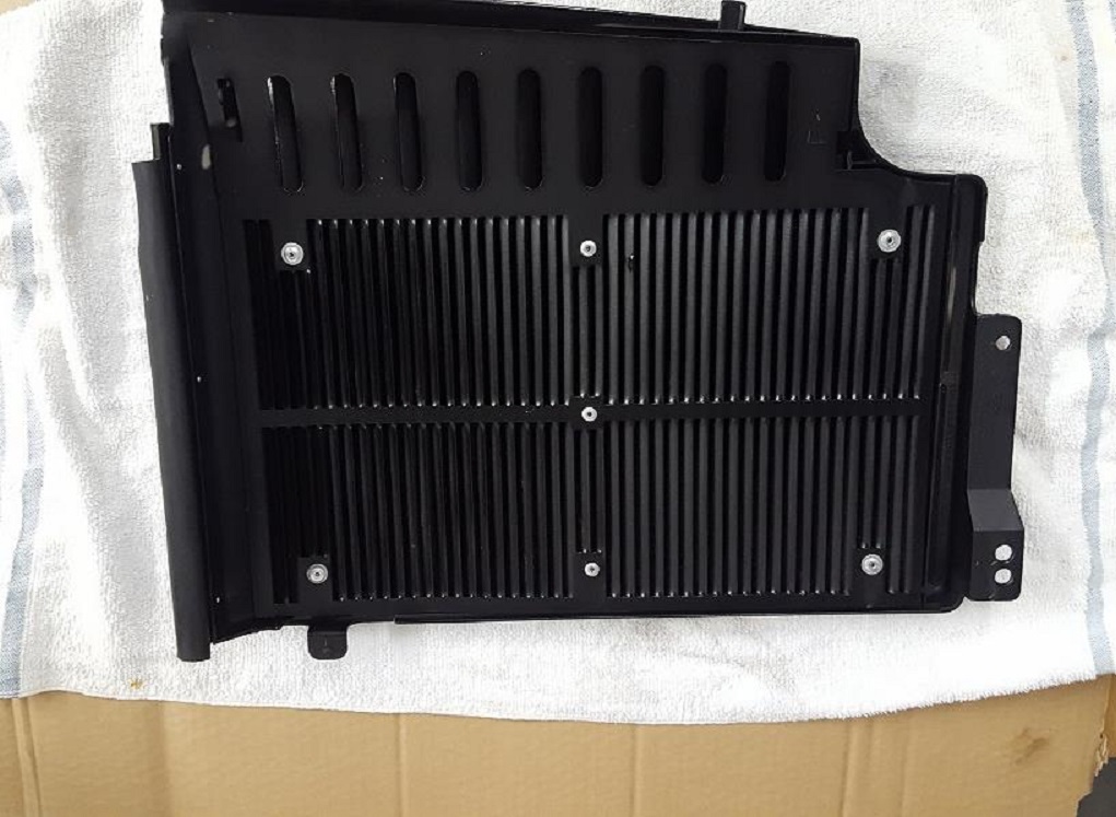

I was able to drill out both parts, the one set in the body just requires small bit and patience, then you can just rivet it back together for the correct look... Can believe anyone wants to go through all the prep work on these ( I think i spent 3-4 hours on mine?) and just spray bomb them after all that. Do the prep work and then find a local powdercoat place, or send me yours all ready to go and I'll do it!

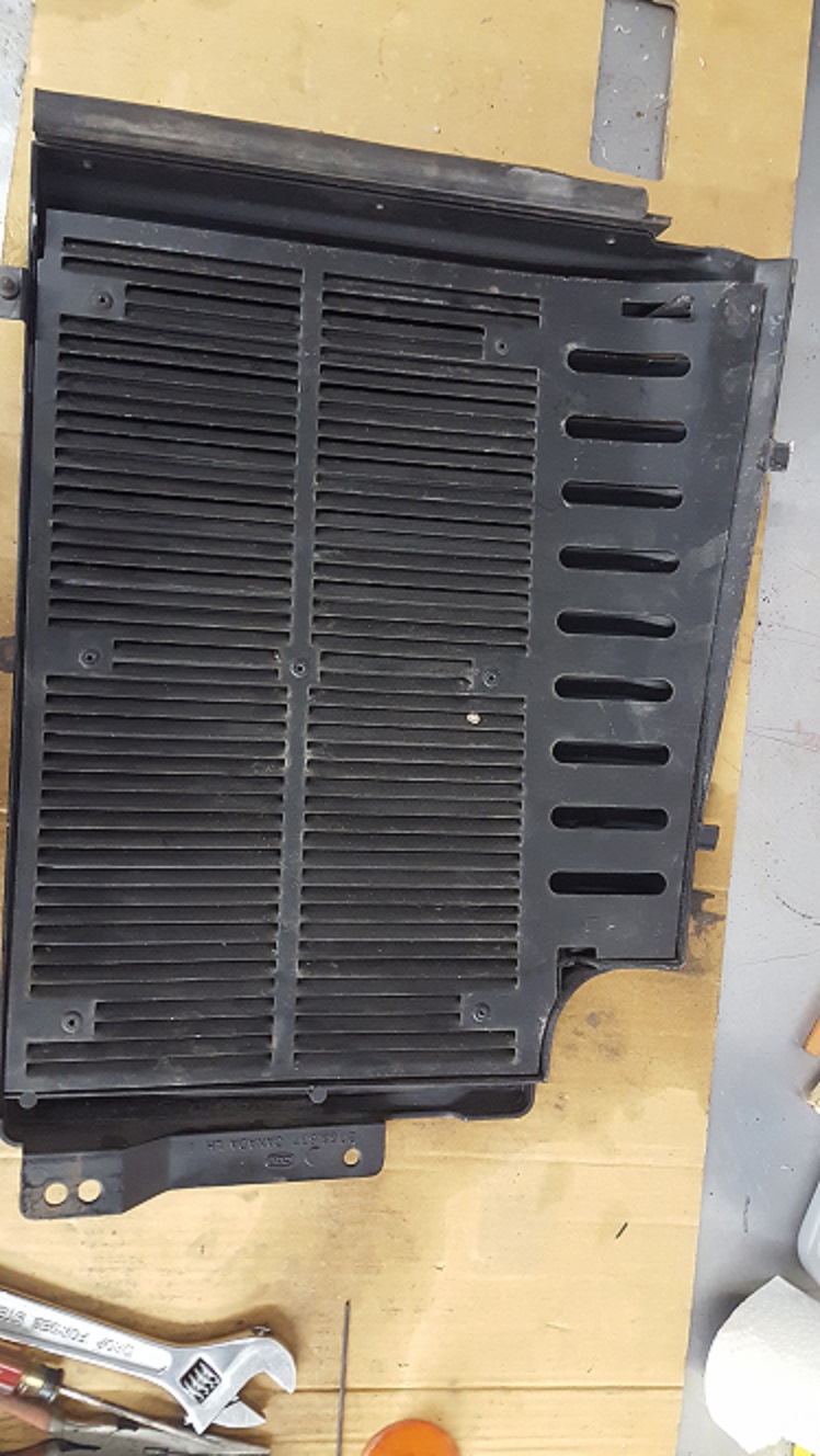

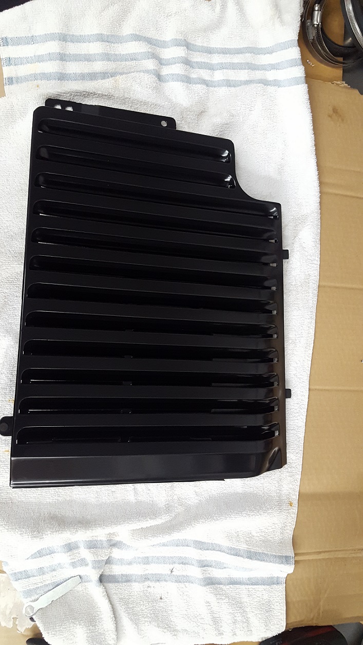

Thanks for the inspiration here guys I've been meaning to work on these and since i have a home powder coating and blasting setup its just time. Got the 1 side completely redone in about 3 hrs which included cooling off time while i went out to buy rivets. The OEM finish on the top part is definately powdercoat and the under tray I think is possibly just a spray paint as it comes off much easier. Did both on mine in semi gloss black not sure what the new OEM part would have been after looking at the finished product i wonder if the undertray was more of a flat finish to make it less visible.
Before
The factory finish is definitely not powder coat, it is a painted surface. That is why it wears off and gets weather beat.
I must say that with the exception of the rivets not being black, your finished pieces look NOS.
