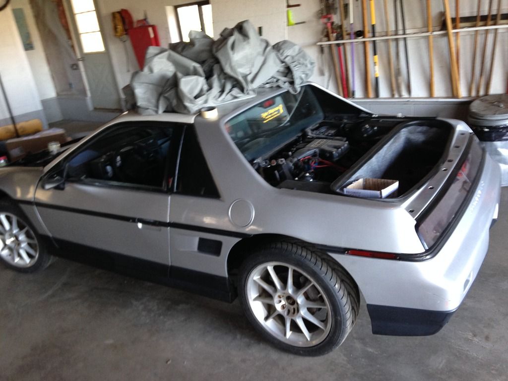

Finally getting around to updating this thread
The 88 had a knock when I got it, ended up shooting a rod through the block
That was back in March.
Just removed the motor this Labor Day, the 7th.
And of course the obligatory standing in the engine bay shot.

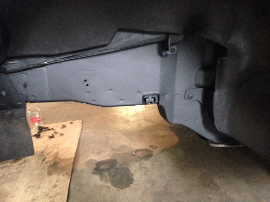

Got the bay degreased, going to start wire brushing and painting soon in preparation of putting in the 3800

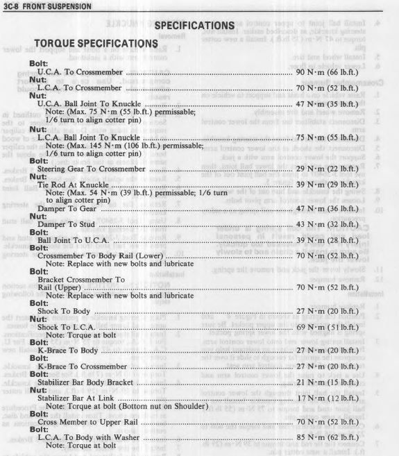

DKcustoms NOV 09, 05:30 PM
Seeing how I've switched to an 88, it was necessary to find the torque specs for the 88, obviously.
Front suspension (only torqued once the suspension was fully compressed, will check after a few hundred miles)
