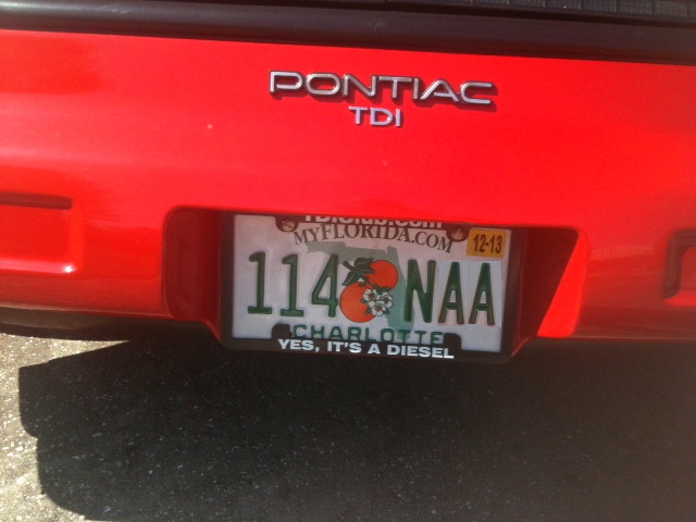

I joined another Fourm, www.TDIClub.com , So I could get some ideas about the TDI engine upkeep & other info.
Found they had some tag holders for sale, I just had to get one !
