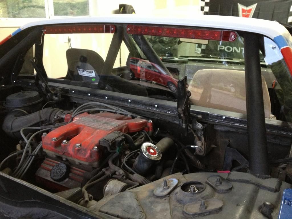

The next step was preparing for Fierofest. We were still not sure if we wanted to take the car on a 600 mile road trip but I started working out some of the details. This started with installing a rear window.
It took quite a bit of trial and error to get it in and fitting well. I also mounted and wired our new LED aux. brake lights. These will ensure that if the car gets hit in the rear and the brake lights get wiped out we are still legal to keep racing.

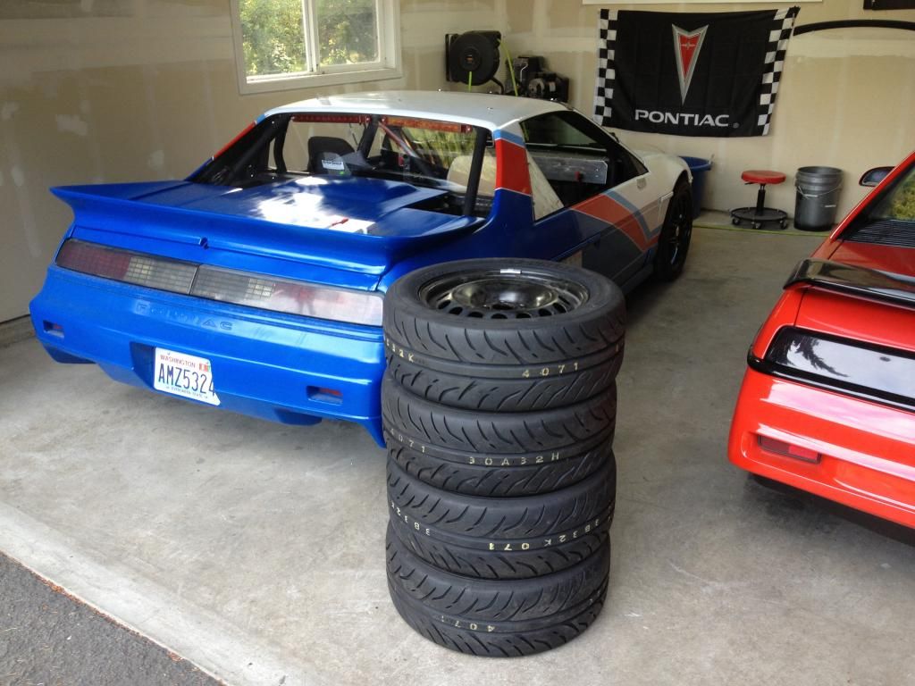

After much debate and research we decided to go with Dunlop Direzza ZII tire in 225 50 r 16. We will not know how they work out till the end of October but I think this tire is one of the best available at the moment for what we want to do.
Just a comparison between the old Dunlop Direzza Z1 that I have been autocrossing with my red car.
First time on the new shoes. She looks good!

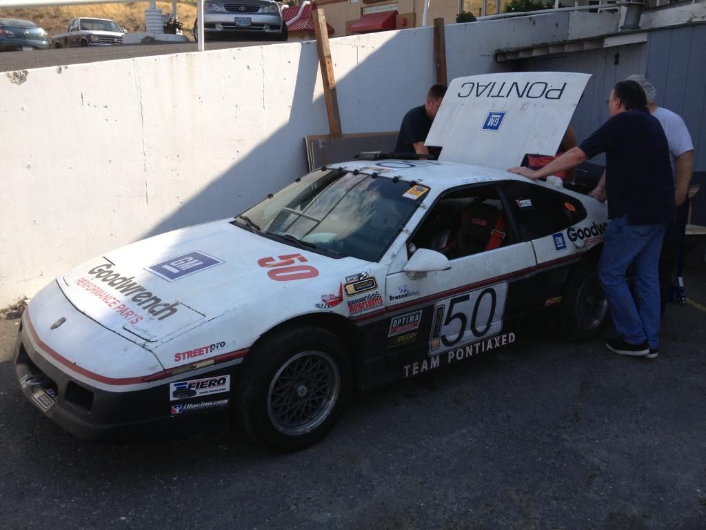

Emergency alternator replacement. Justin just got that car running at around 7 in the morning just a few hours before after pulling an allnighter getting the engine buttoned up. Truly a heroic effort and it was fun to cruise with the #50 car.

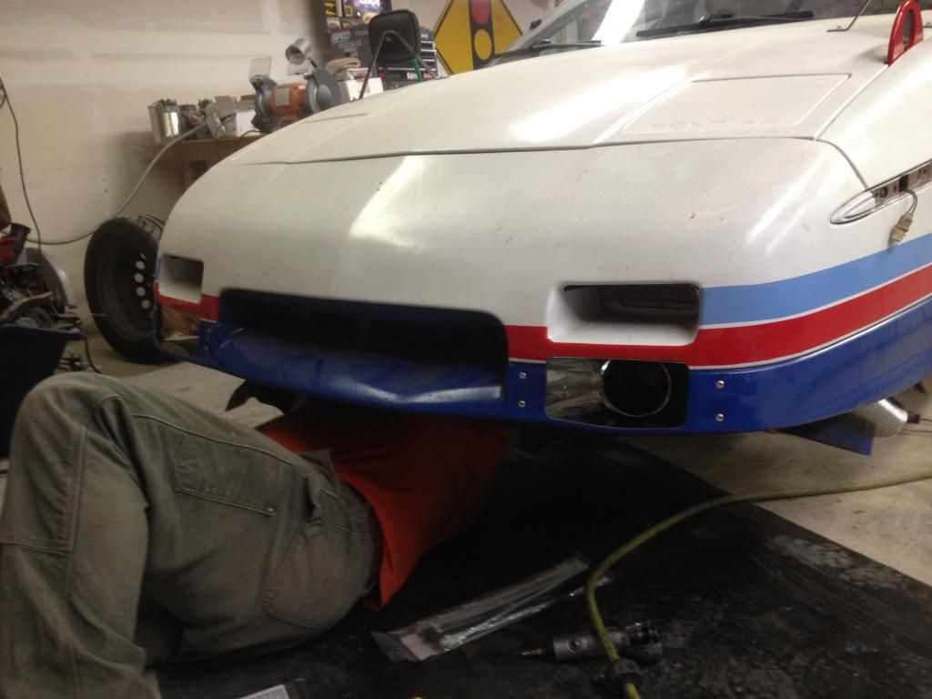

I tried to avoid it but I did a quick cradledrop to fix all the exhaust leaks, had to extract 2 broken studs. I also replaced all the radiator/heater hoses, the alternator belt and the cradle bushings. I removed all the insulation as well as a few extra brackets and stuff we do not need.
I had the engine back in the car and running less than 48 hours after I removed it.

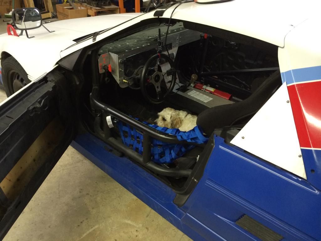

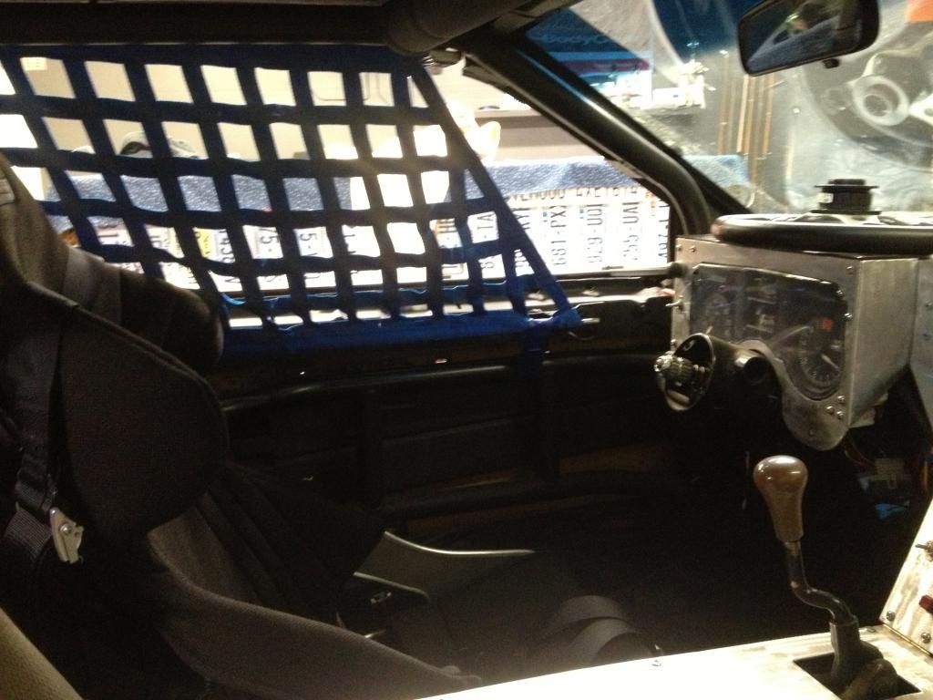

As raceday approaches I got around to installing the window net.
Not a bad office!

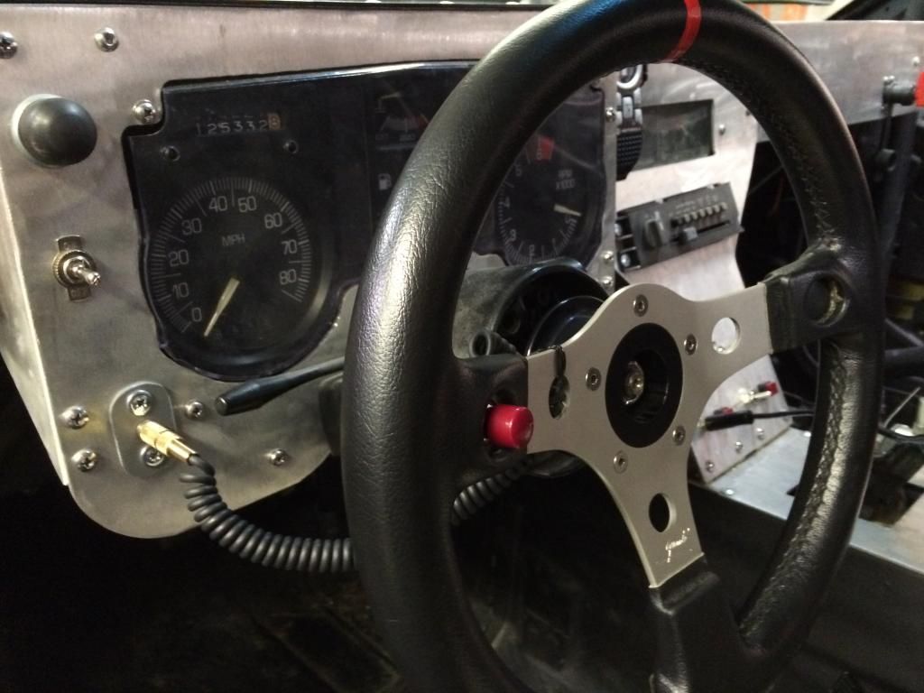

One thing I have needed to deal with is setting up the radio system. I bought a couple 35 mile Motorola 2 way radios and wired them into the car so we can trigger the push to talk with the left hand on the steering wheel and plug our helmets into the dash for the mic and headset. The radios are battery powered allowing them to work regardless of the health of the car. I used an old phone charger chord for the curly bit. Works great behind the steering wheel and does not get in the way at all. Allows the wheel to be placed on the dash or roof without unplugging it, of course if needed it unplugs easily as well.

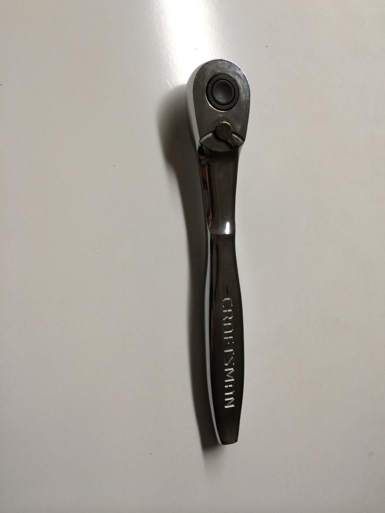

I had to warranty my favorite ratchet after it locked up on me. Years of abuse have taken its tole...
