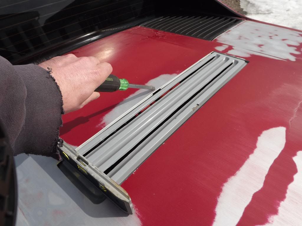

Well I been reading up and what not and I'm 100% positive the PO used acrylic enamel cheapo spray paint cans. I understand that this paint will probably react to any real paint that goes on. Thus I'm just going to remove it all. More sanding. Almost there. I just been doing a little here a little there. No hurries.
So I need to start thinking about several things real soon.

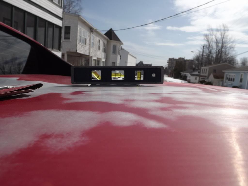

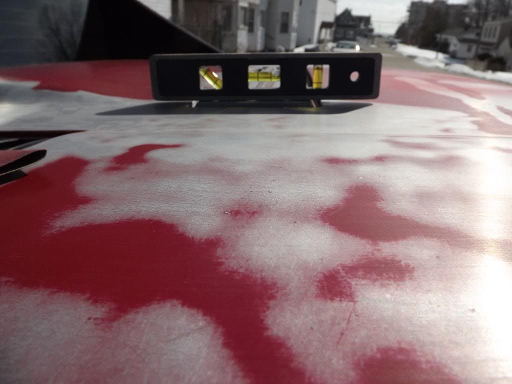

1. Finish height of the top of the Kahines vent. Should I put it flush with the decklid or just slightly higher? The Kahines vent actually matches the curve of the decklid perfectly so it doesn't flash or look out of place. Most non Fiero people that see it don't even notice that it's not factory till I tell them about it.

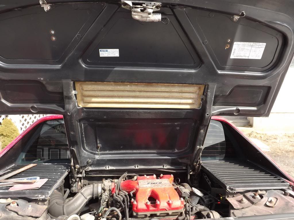

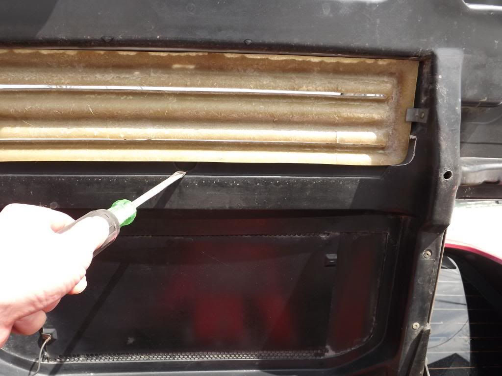

2. Next I need to address this round cut out. It's a luggage rack mount hole. I'm pretty sure it's on every decklid. It's part of the under layer of the decklid sandwich. Next time your poking around under a decklid look for it. You will see what I mean. Also the edges show the two layers and I need to figure how to clean that edge up. I could simply trim the inner layer around the vent cutout further back but then the vent might stick up to far. I will have to think some before I do anything drastic.

I've removed spray can paint with either acetone or paint thinner. Sure beats sanding.... And when is sanding EVER fun?

I been considering doing this. I have some paint stripper that I may try. I'm worried about any residue this stripper may leave behind though. Sanding for now. At least finish sanding the back edge under where the wing would be, dreaded PO put it on thick here. Then I will pull the decklid and set it on some saw horses for the real fun! If only I could talk Momma into letting me sand in the living room.
