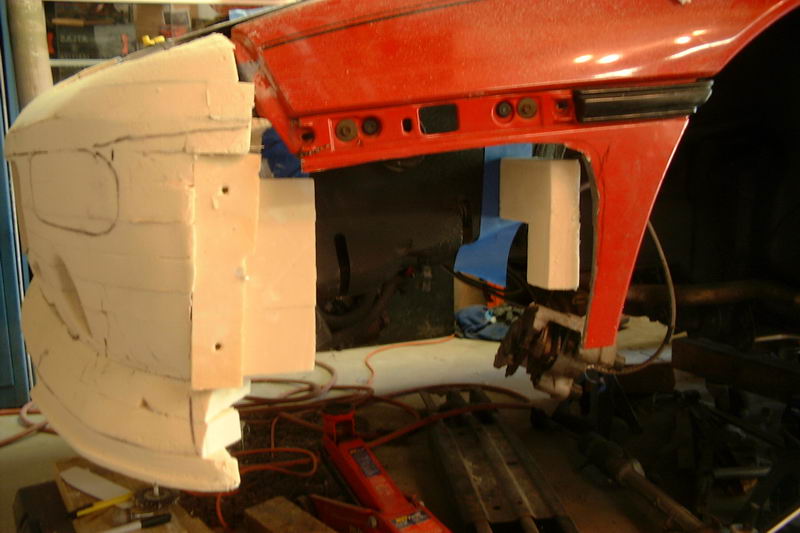

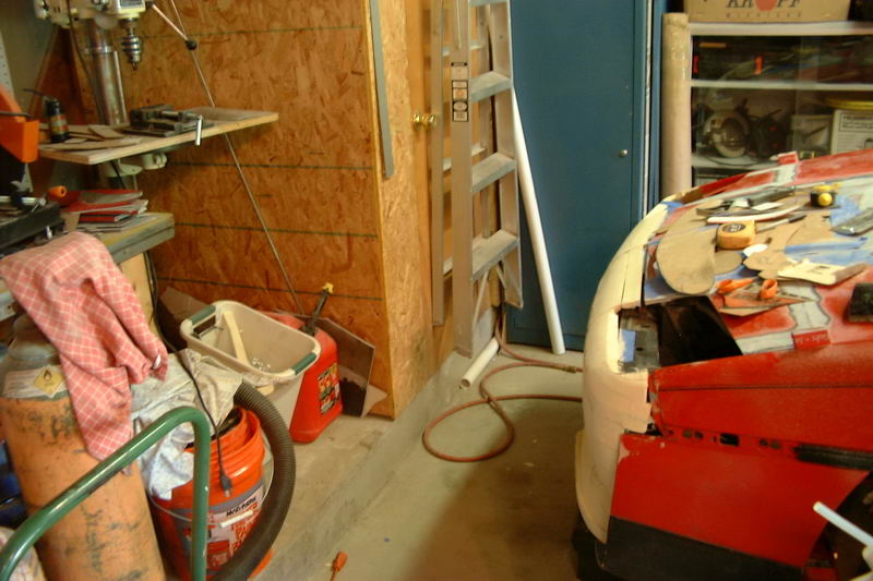

It sure doesn't look like a whole lot has occurred, especially in the pics, but I've been cutting, glueing, and sanding a whole lot. I know, I know...Here are the pics. Let me know what you think.
Driverside corner didn't match the passenger side, so...
Starting to map things out a little better. Trying to match the shape of both sides.

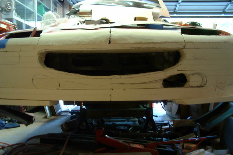

Tough shot to take, not a lot of room. No smiley face here (at least not yet).

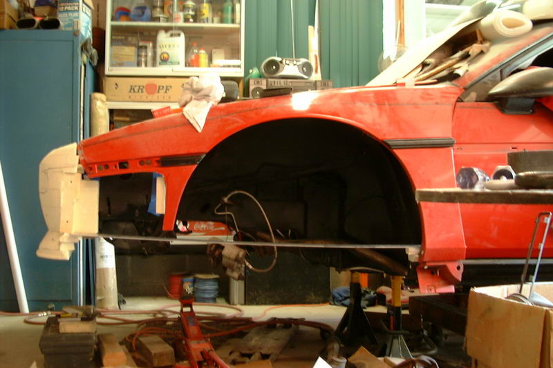

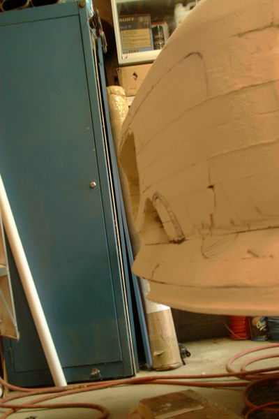

Speaking of room...
 I wish I could have turned the car around to face tthe garage door, but it has not front suspension or wheels.

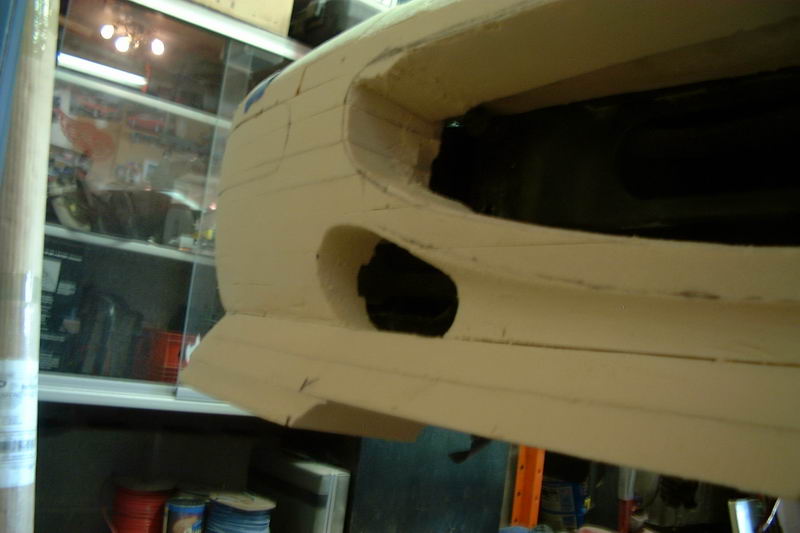

Closeup of the passenger side lower vent

Front profile

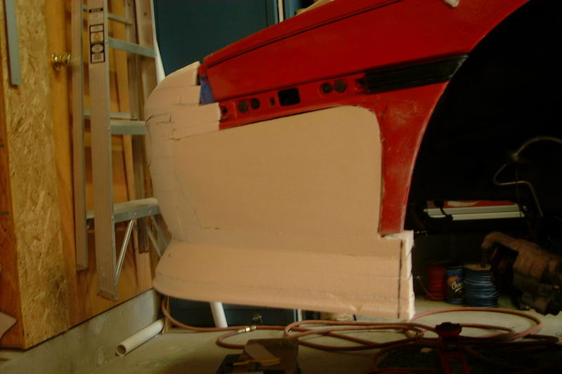

Starting the sides. I cut the front flat so everything tied together easily.

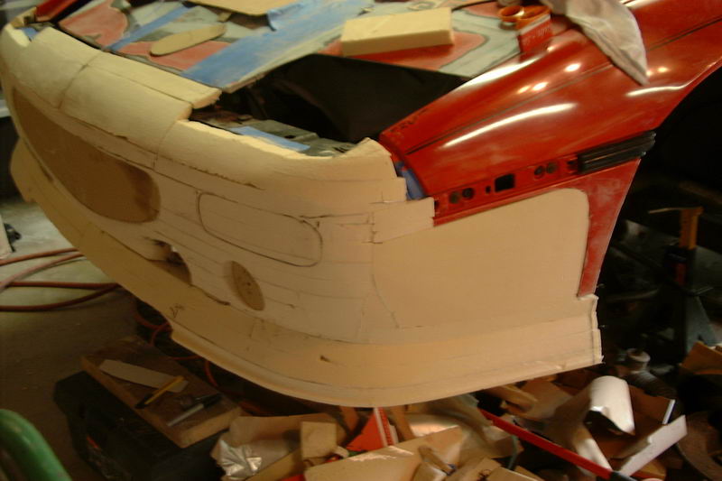

Then started building up. This time,I tied the side to the chassis (better than I did the front) to make things maore stable. I also cut up the remaining GT side to use as a guide for the wheel well and interface for the upper fender.
I used the slight bow in my straight edge to advantage to line up the front valance with the side ground effects/body line.
Filled in and sanded smooth.
Just need to trim the wheel opening and on the the other side.
Well??
