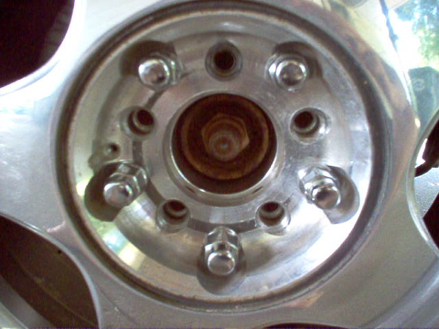

good point. SPACERS!!!! this is the spacer on my car now.
deeze.....mugs are big hunks of aluminum. offset right here.
 wonder if these will work on them T.A. rims?thanks for that idea, Man. more investigation is a foot. indeed.
What kind of wheels DO i have to use with a engine swap? need a "z'' rated tire for sure.'tis gotta handle and hold on to them horsies. HEY Mike! hook a brother up. stick your head in, please. What kind of wheel/rim combo should i use Guys? hello, any body out there, Tom? Nelson? I bet Fiero X knows! Later D[This message has been edited by batousai666 (edited 11-19-2009).]

for my engine swaps you will need a y rated tire. mike

I am using the Chromadoras on two of the MERAs (88s) with 265 x 50 x 15 tires from Dunlop. The 87 has aftermarket wheels and the same size tires. I would love to get some equivalent size tires in a T or higher speed rating but have not been able to locate any. Let me know if you manage to find some.

nelson go to the tirerack.com and plug in your specific size and they will bring up all brands that apply and the different speed ratings as well. mike

right on Mike, that is good info. thanks. Y rating. i'll have to read up on tires. as far as the rims go. what would you suggest, for the high h.p.? i read bad things about spacers and horsepower? will do more seeking on the net. thanks again- Dan[This message has been edited by batousai666 (edited 11-20-2009).]

Unfortunately, this yields zero tires found for my stock size (265 x 50 x 15). Even if I drop to 245 tires, only one is available and it is a track tire (Hosier) with no warranty. They make very little in wide 50 series tires with 15 inch rims.

Going to tire rack is a waste of time. They only sell a average selection of tire sizes. Google the tire size and you will find plenty.

BFG TA's come in 265,275, and even 295/50/15's if you really want to fill up your rear wheel wells.

Your spacers look to be adapters also since there are two different size bolt patterns on them. Get any stock GM A or F body wheel to see it they will bolt on. How wide are the spacers, and do you tires rub?
