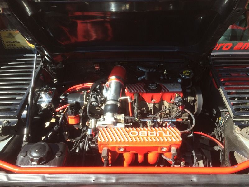

Some more toys for the car:
Not pictured is the adapter for the bov and a couple more intake elbows. Going to change and shorten the pipes from the intercooler to the throttle body. Next up is upgrading the throttle body to a larger a Fiero throttle body and a tune. |
I just noticed you have some Big Wires! I like big wires. They look better on the engine than stock wires! I have ZZP 10.5 wires.[This message has been edited by solotwo (edited 04-28-2016).]

| quote | Originally posted by FieroMaster88:
That engine fits in there so nice. Looks like you change TBI's? You went from 2 to 1 is that correct?
FieroMaster88
APR 28, 09:34 PM
Yes, went from 2 to 1 larger throttle.

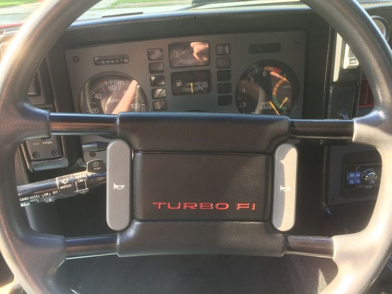

Today I replaced The timing belt and tensioner. The old tensioner was seized and I found the intake camshaft was off one tooth. I got it all back together set the ignition timing and it runs much much much better now. Idle is smoother too. I gave it a bath and installed a steering wheel center pad I've had laying around.

Jims88
JUN 15, 06:28 PM
Steering wheel cover looks good!
