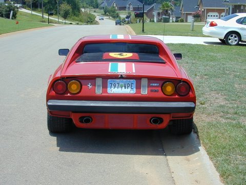

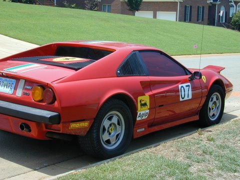

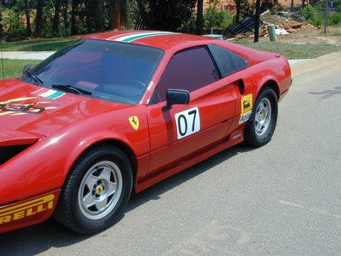

While I am on a roll, here are pictures of the project MERA (1988). It is currently partially disassembled and will be sporting a 383 V8 when it is completed. I also plan to change the interior back to Beechwood (original color). The new interior will come from the other 88 Mera plus the spare parts that I have on hand. Maybe in a couple of years you will see a black or British Racing Green MERA with a decent interior.

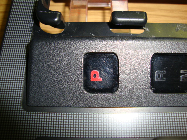

I was able to find a nice 88 dot matrix shift plate bezel to replace the one I have with the cig burn.
However, the orange shift indicator paint appeared to be all worn out, so you could not tell what gear you're in. So I used my dremel and a cone-shaped grinder to knock off two of the melted pins. This was enough to lift up on the white plastic piece and allow the indicater piece to slide off (the clear plastic "thingy" on the right edge of the pic).
I then sanded down the tip of the indicator and painted it with some red paint I had handy. I reassembled everything and put a small drop of crazy glue on the pins that I had ground down.
So now, I can easily see what gear I'm in! Just like new.

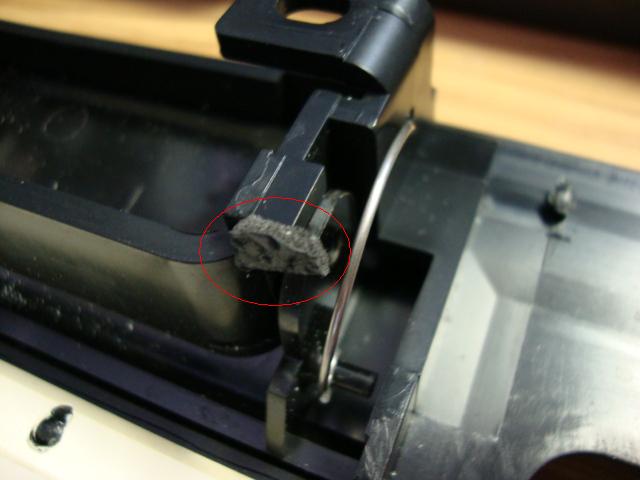

Next, I wanted to paint the ash tray doors a satin black. However, the problem with painting ash tray doors is that when the doors are snapped open, they bang into the edge of the bezel, and thus would ruin the paint.
So what I did was to cut very small pieces from some stick-on, no-slip dots I had handy. I then stuck them underneath the ash tray doors at these locations:
So now, when the ash tray doors are snapped open, they will hit on these stick-on pieces, and the top of the ash tray door will never touch the edge of the bezel. Here (looking from the bottom), you can see the ash tray door open, and its resting on the stick-on piece.
So from the top, when the ash tray door is snapped open, it won't even touch the bezel area (in the red rectangle), thus saving the paint job.
